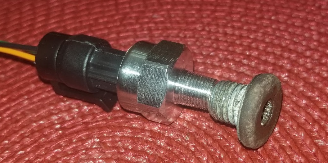

Of course my new oil pressure sensor is a different thread... but at least I have a oil hole to work with.
Oil Pressure Sensor Thread Adapter for Chevy LS Engines will change the M12x1.5 plug thread to the 1/8"x27 NPT thread on the sensor.
Well that adapter didn't fit.
I need a M12x1.75 plug thread to the 1/8"x27 NPT thread adapter... $27.35 at Summit, here in 5 days, or $13.37 on Ebay, and here in 6? weeks. Yuck.

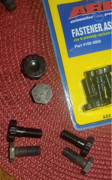

Edit: Recommend these bolts rather than the ARP ones. Long discussion follows:

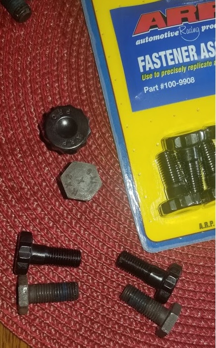

The heads on the GM bolts is 4.5mm thick, the ARP bolts (209-2801) are 6.5mm.
The GM bolts are 24.9mm long after the head, the ARP bolts ar 25.3mm..
The threads are the same. ARP bolts came with .5 oz of the Fastener Assembly Lube with is perfect for correct torque readings.
The ARP bolts have an 8mm shoulder before the threads start... better for the flywheel to rest against, my flywheel is 9mm thick at that spot.

Will the ARP bolts fit? Well yes and no. They are very close. Here I compare the ZZP "OEM GM upgrade for the '05-07 Cobalt" which I think is the GMPP clutch, as GM only has 1 upgrade clutch for the LSJ, AFAIK.
The bolt circle is 0.2mm too small if the ARP bolts are rotated point to point, but if they are oriented valley to valley, they miss by 0.2mm.
So even if they hit by 0.2mm, they hit on those 8 little tabs that poke thru on the clutch center plate, so it would rub that off pretty quickly, as it isn't much metal in those little tabs.

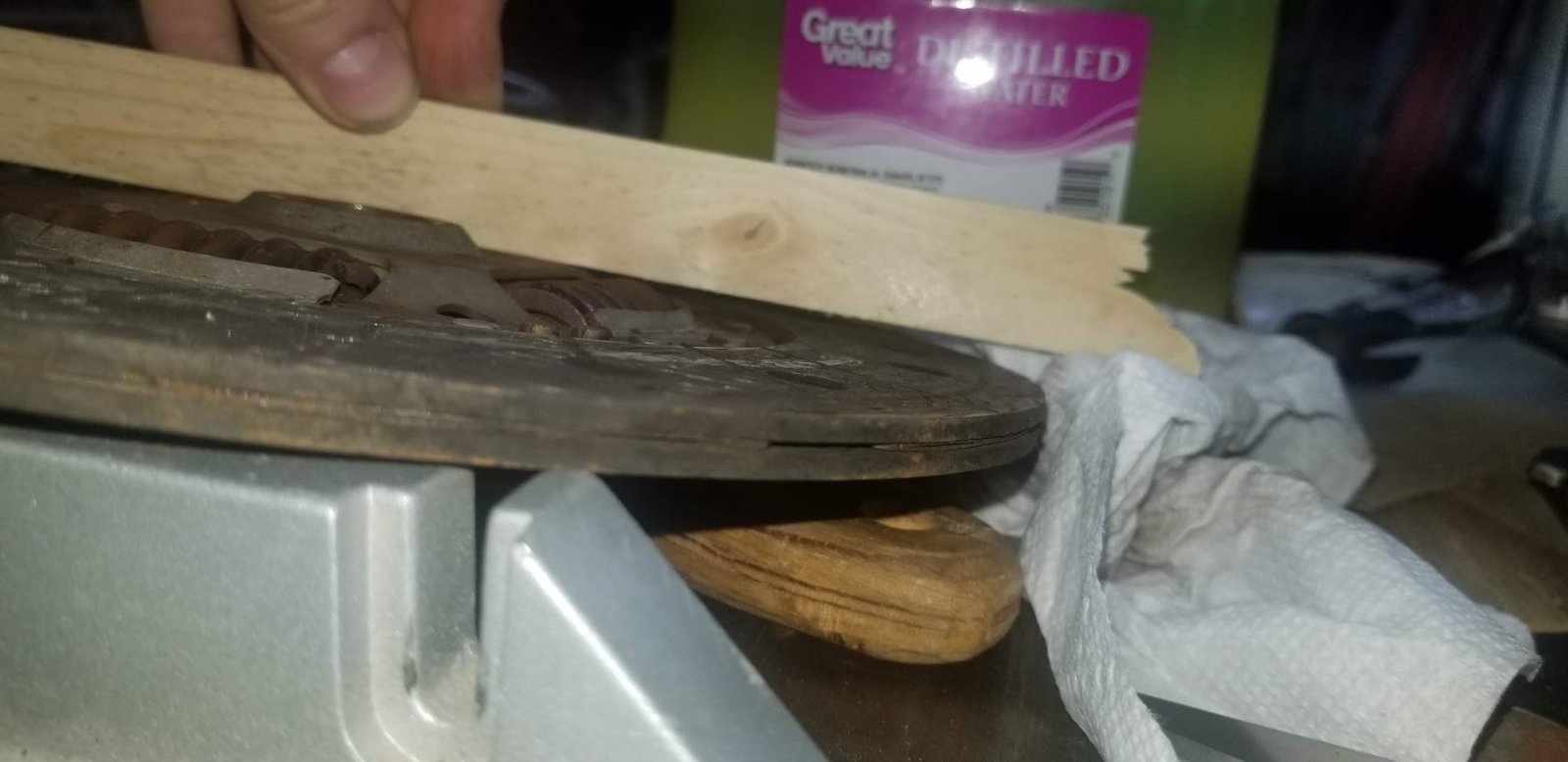

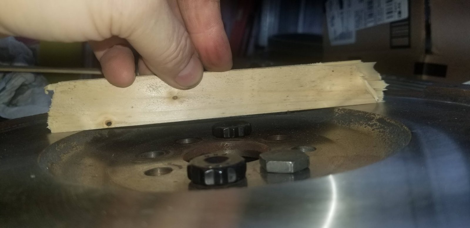

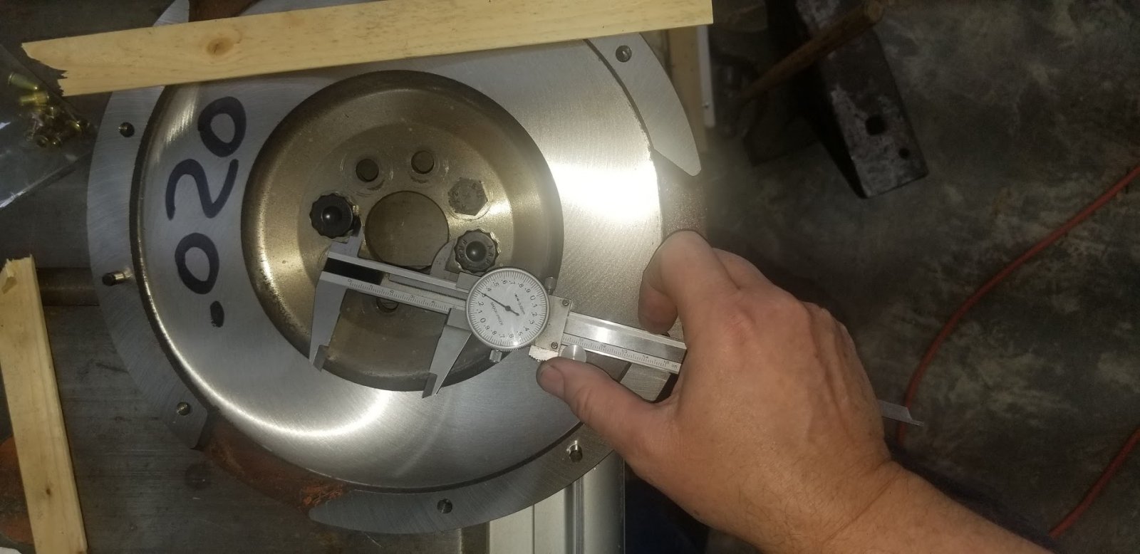

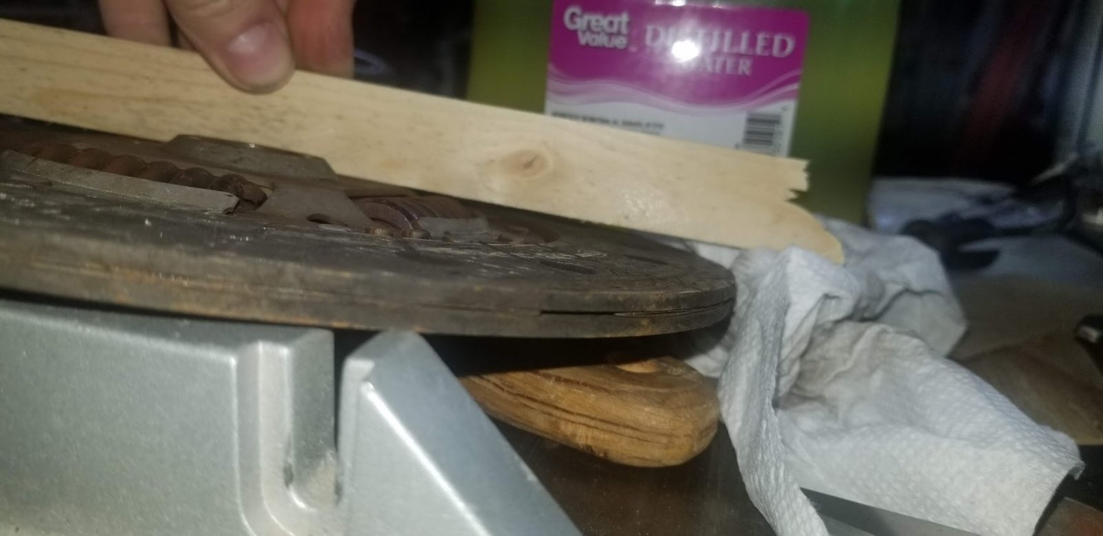

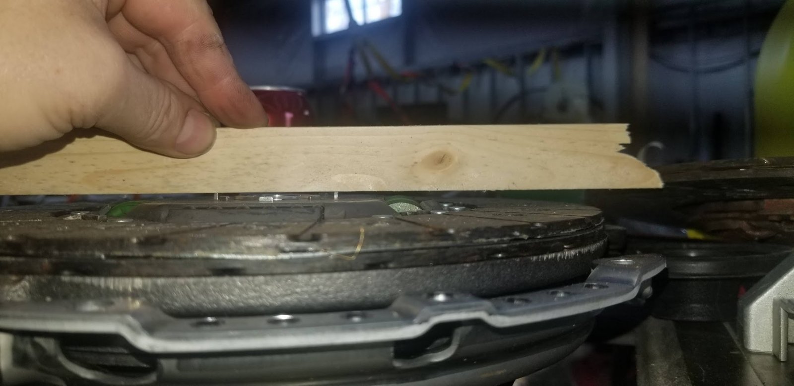

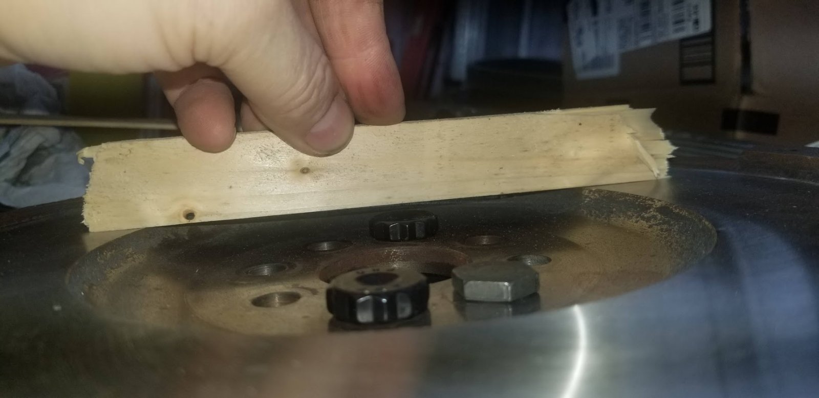

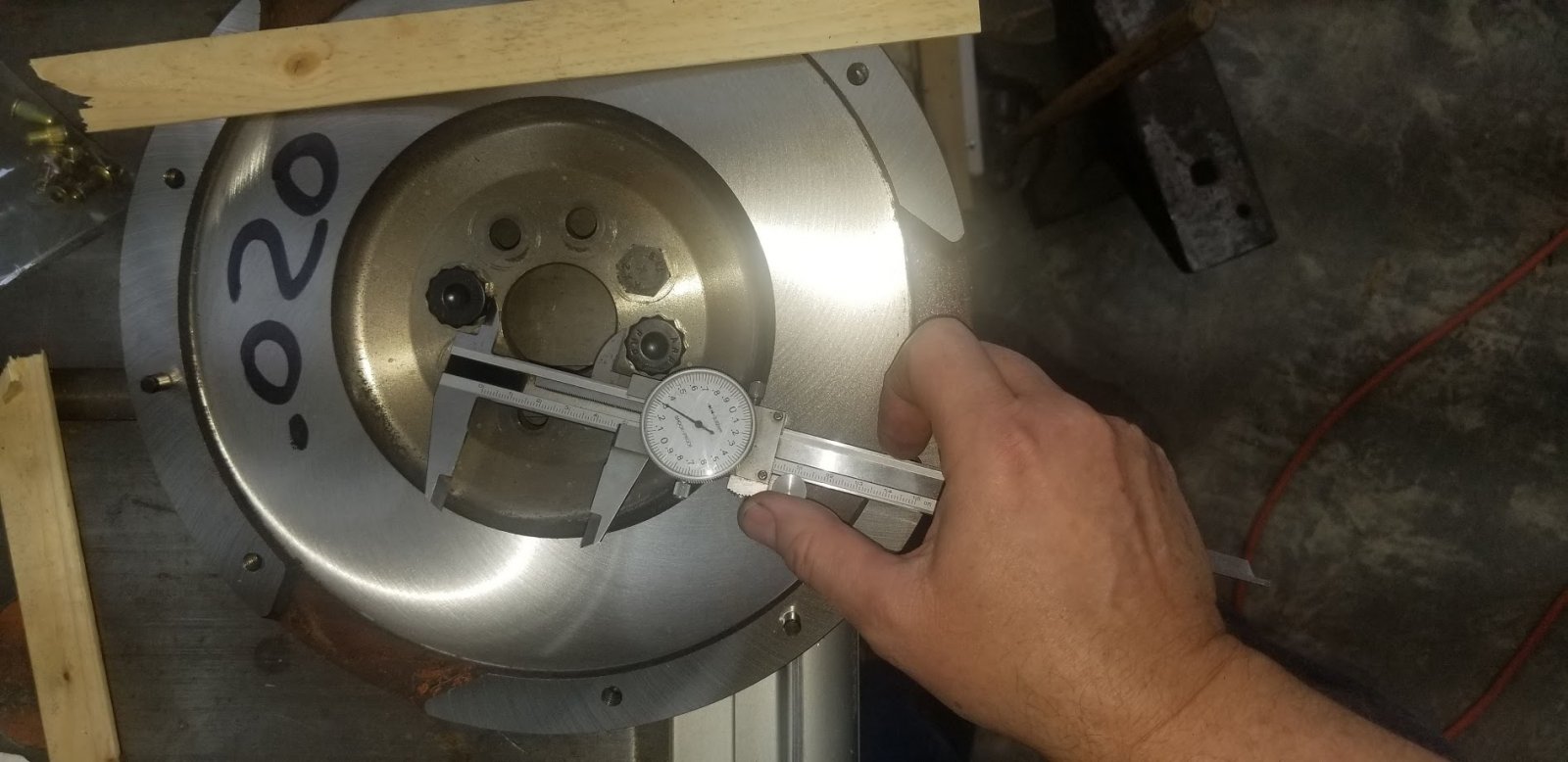

Will the center plate rub on the ARP bolts? The plate rises 4.5mm above the friction material, and the ARP bolts are 5mm below the newly ground flywheel surface (-.020 inches, which is 0.5mm thinner than the stock flywheel... and I could use that extra 0.5mm ). So the ARP bolts don't hit with the brand new clutch friction plates... but the old clutch is 0.7mm thinner on each side, so eventually the wear will allow the ARP bolts to contact the plate, and rub away 0.3mm of metal. Which might make a bit of noise, but will probably not be noticed. (New flywheel wouldn't rub, and I don't know how many times my flywheel has been resurfaced)

The old clutch plate had a different profile. It wouldn't rub on the inner bolt circle, but it would rub on the plate.

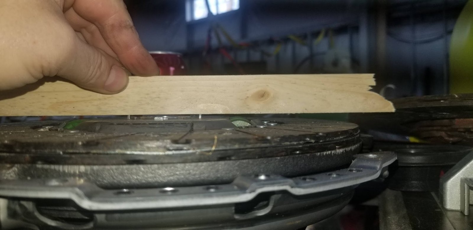

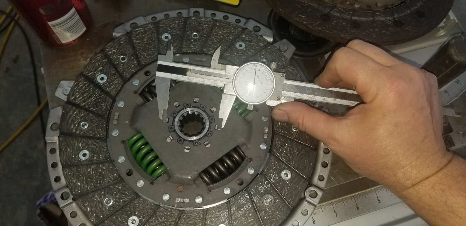

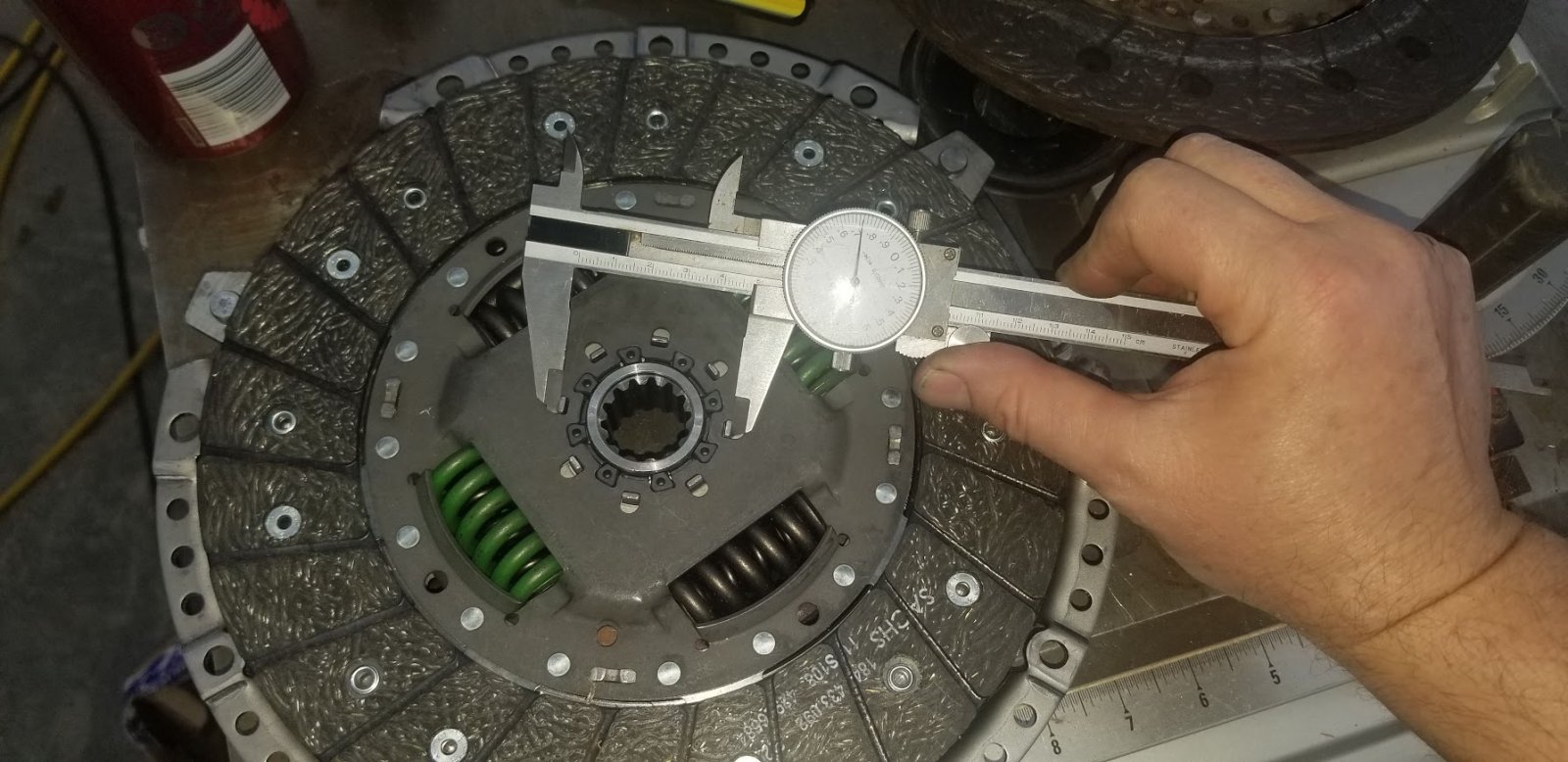

Hey Ross have you installed your clutch? I am curious what the thickness is I have about 300 miles on mine and its 5.7mm contemplating changing it since I had to replace rear main seal anyways.
My new clutch is 8mm thick. The old one is 7.3mm, and tapers to 7mm at the outer edge. I needed to replace the clutch slave cylinder but decided to do the clutch while I am in there, not because it was worn out.
Thanks Ross I replaced the pressure plate, clutch, and slave last time I looked at the clutch disk again it looks like it has a good amount left I am going to roll with it.

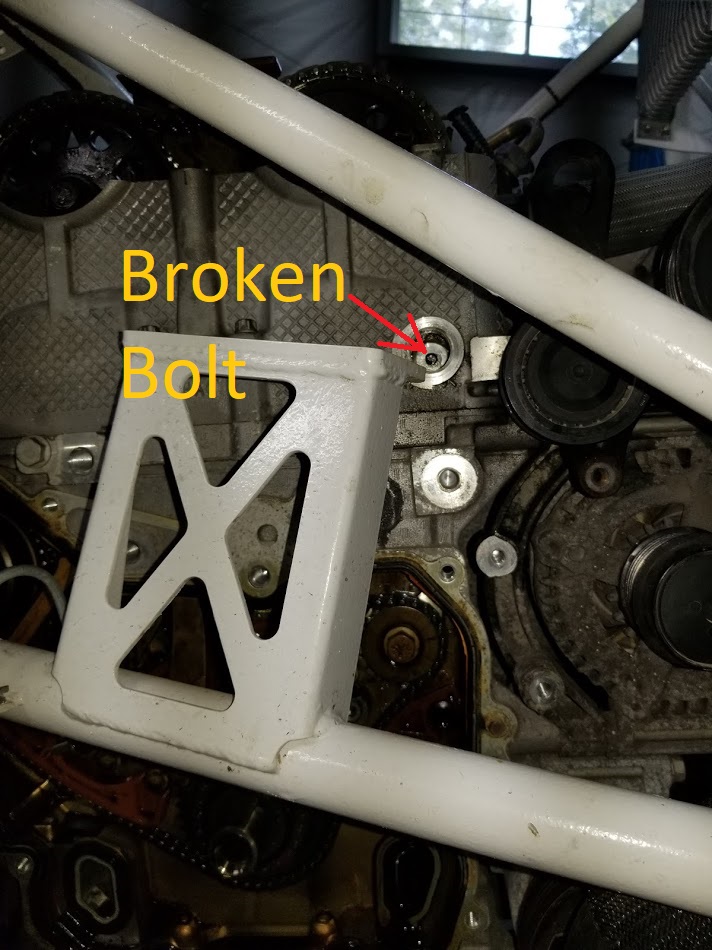

I bought a new timing chain tensioner, which should be an easy replacement,
but I found a half a bolt in my head, that should be holding a timing chain guide.
Drill, (never) easy out, wish me luck. (Update: Don't remove the broken bolt, just buy the updated Dorman part to fix this)
Looks like the chain guide has no wear marks on it, so it either broke right after it was replaced, or the last owner left it this way.
I don't see the other half of the bolt anywhere... but I'll run a magnet in the oil pan.

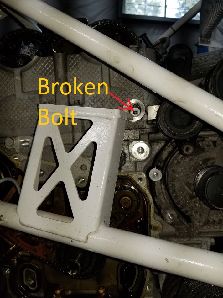

Just got around to checking this and It turns out I have the same old broken bolt. I see in this picture you pulled the cover off did you find the missing bolt head in there ?

I looked, ran a magnet on a wire thru the bottom of the oil pan, never found the bolt head...
I am planning a engine rebuild next winter, maybe I will find it then. In the interim, fingers crossed.

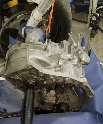

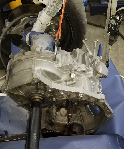

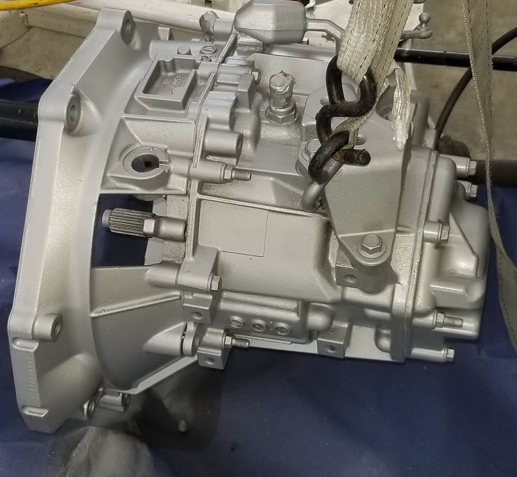

If you happen to rotate your transmission (to paint it) without the clutch slave in place, it will leak transmission fluid all over your floor. I should have plugged the holes with 3 bolts. :( Guess I will be changing the transmission fluid now.

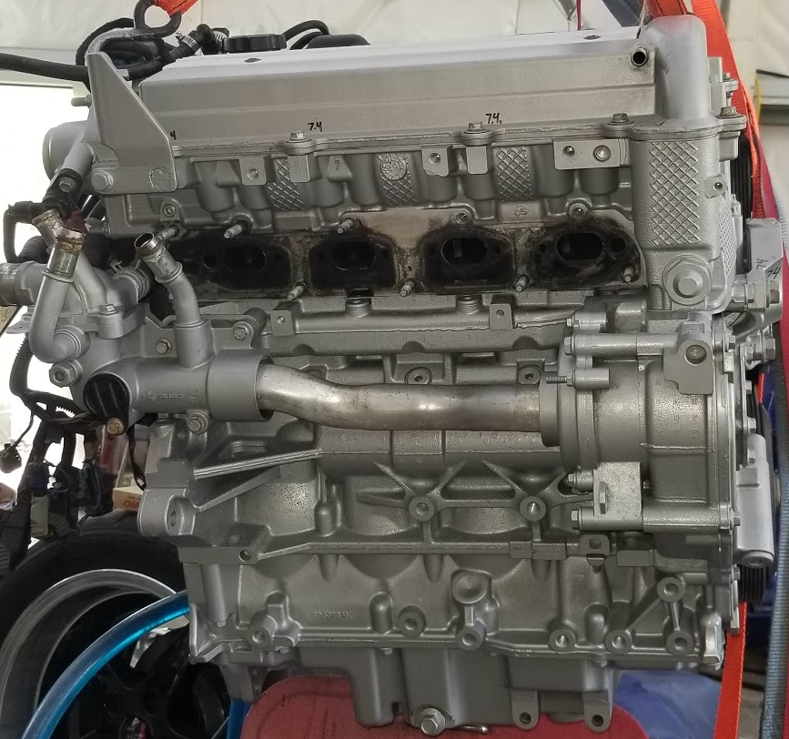

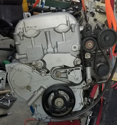

Finally getting around to cleaning & painting the engine. A shorty chrome header will hide the exhaust ports.
13333

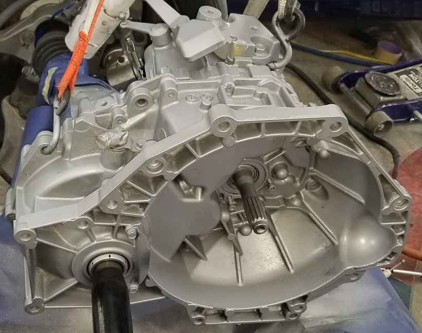

Painted the transmission
13334
13335
This side was painted after I replaced the cam chain tensioner and put the Dorman chain guide bolt in.
13337
I still have more to go: AC pump (idler pulley), supercharger, intercooler, etc.
its not the bolt holes that leak, if you look at the slave it has an o-ring that seals around the input shaft hole.

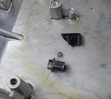

Chris's (ccannx) oil pan finds have me convinced I better dig the debris out of my oil pan, as I know that I am missing a timing chain guide bolt head.
I found it, and some plastic off that same chain guide, and a curly of chrome plating that came off of some mystery item.

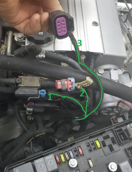

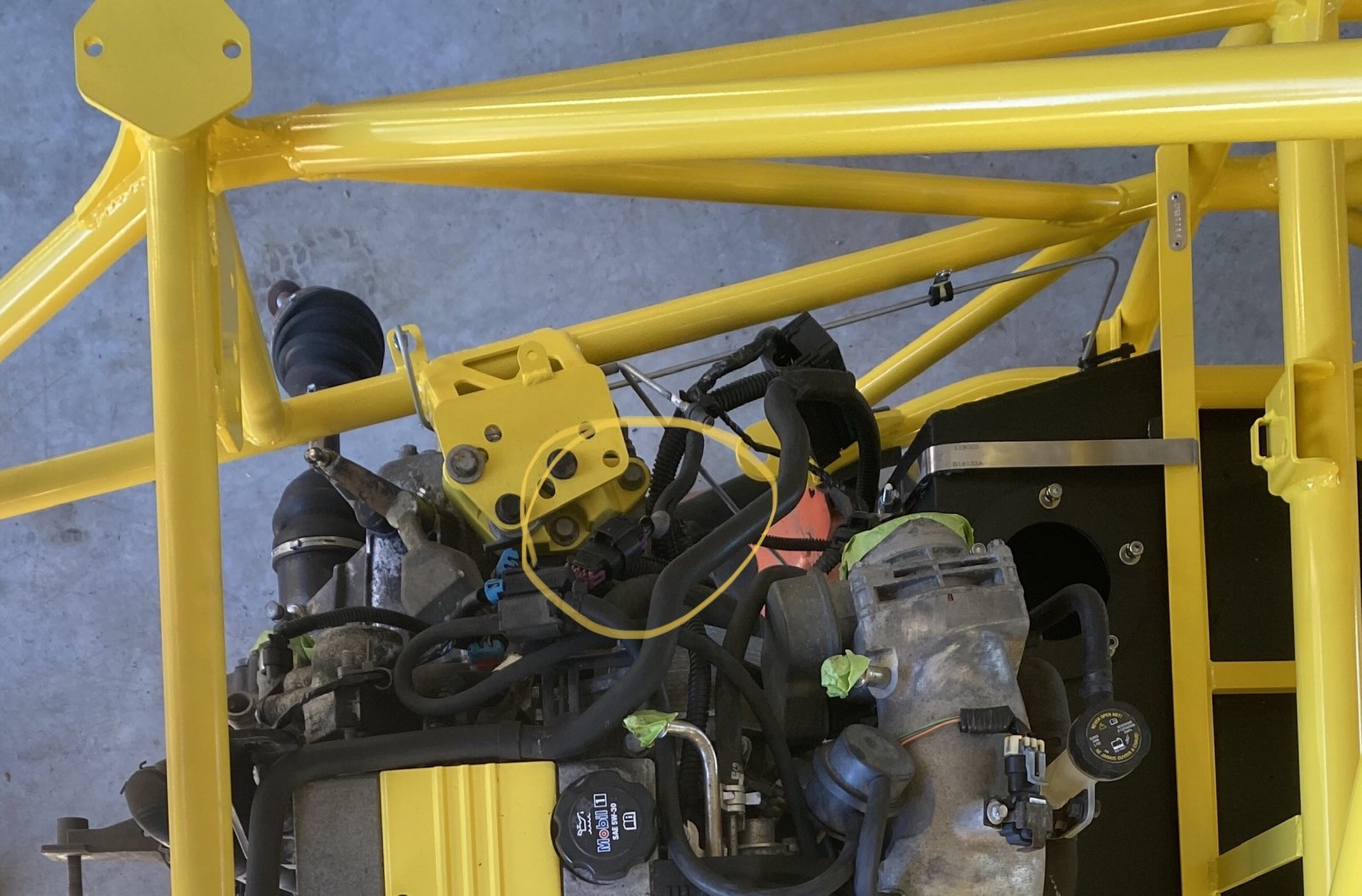

Putting the engine back in my Goblin, and I have lost track of where connector #3 goes.
The wire goes to #1 which is the supercharger bypass vacuum hose solenoid thingy,
then #2 which is labeled "Old Evap Solenoid" and then #3, the 8 pin purple connector that goes where?
14135
