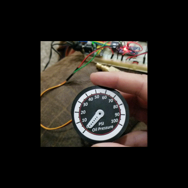

Spent today playing with GIMP software to make the faceplate match my stock SS gauges.

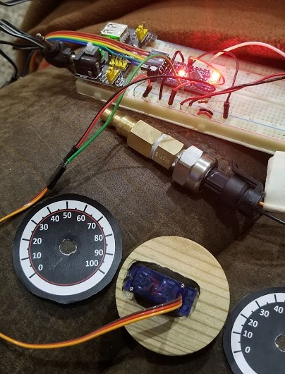

I calibrated my oil pressure sender using compressed air and 2 tire gauges,
then wrote a small program for the Arduino controller to read the sender, and send the signal to a servo.
It is surprisingly accurate (about .2 of a PSI if I used a digital output).
19832

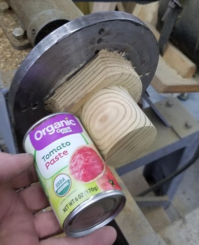

I used my old 3D printer and some wood PLA for the servo frame, and the can is the right size for a 2" gauge faceplate, an Arduino, and a 12V to 5V converter.
19833

Ross, do you find that your Arduino board does not make great contact with the guts of your breadboard? I've used three different breadboards and with all three, an excessive amount of down force is needed to make proper contact, and it's still somewhat spotty. One of the chief reasons I have not yet implemented my keyless start..
I have had that issue with a worn out board. If you use wires that are too big, it will spread the the contacts in the board, wreaking it.
Buy a new board, start again.
Everything seems to fit snugly. My wires and the pins on the Arduino seem to be the exact same size as the holes on the breadboard. I'll revisit it at some point. Thanks for the pointers.

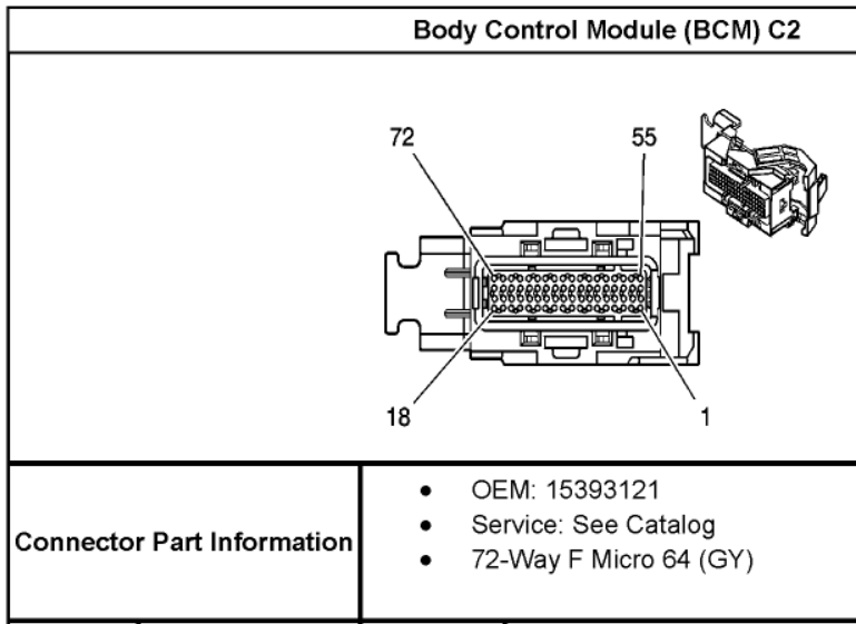

AllDataDIY has the plug listed at:
19862

Ah yes, you're right, that one is different, I only redid the pins on mine. So didn't notice that before. Now I'm glad I didn't order one. Sorry about that, I'll edit my post to reflect the pins only. Id order from mouser using the actual oem part number I think it was only $1 more. :D
edit 2: checking back, that one matches my pcm plug c2 though, I just got my plugs mixed up. Got the bcm and pcm plugs mixed up, oops lol kinda weird efi connection doesn't have the 72 way ones. but i know a few of the BCM connectors even on mousers website, they are listed as "obsolete" and no longer for sale. luckily i think the 72 way ones are still available.

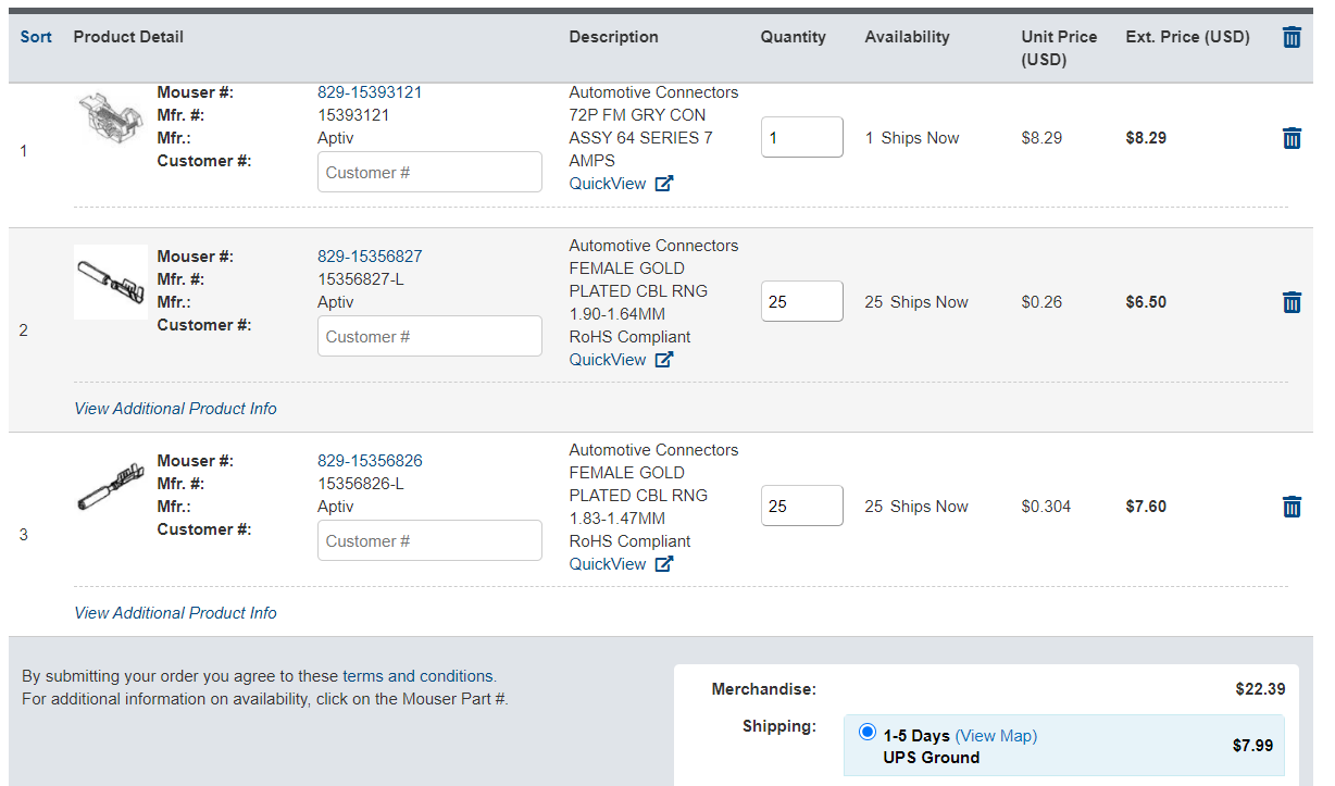

Mouser had the BCM C2 plug, like you said. Also better prices on the pins.

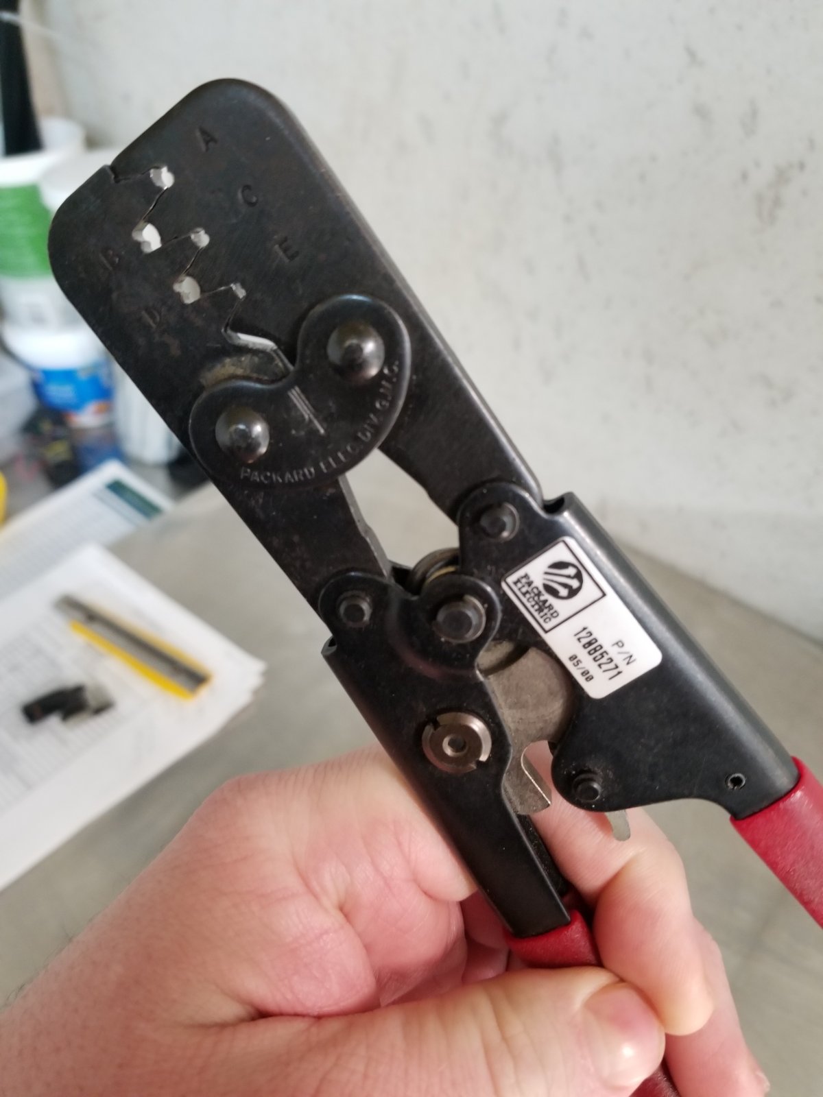

i paid alot of money, I spent about 1.5-2k on crimping tools to get everything i needed for ALL the wiring sadly, this includes tools for mil-spec bulkheads and other specialized connectors i plan to use. The prices on OEM tools can definitely make you sick though.
the tool i used earlier today when i crimped is in the previous post there, u can see the part number on it.
my cheaper Iwiss tools from amazon, also worked, allbeit not quite as nicely. but the entire set is only $135.
you could likely buy the single tool for cheaper instead of the entire set.
Here is the link for the single crimper from iwiss.
the packard specific tool i showed above locks as u crimp though, and made a much nicer crimp.
crimp the wire with the best one that makes a tight connection u cannot pull out, then crimp the insulation with the next up 1 size larger.
