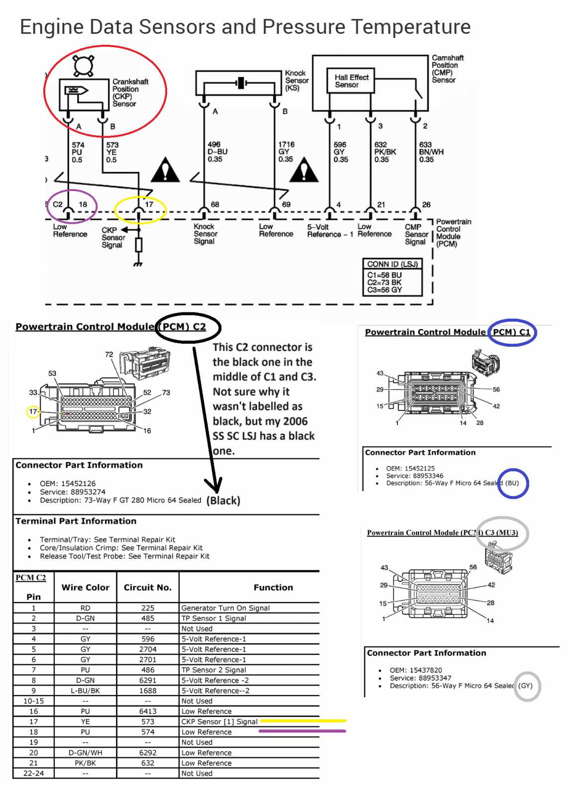

So I pulled the codes, and and followed this testing guide for the P0335 diagnostic trouble code.
Found out my purple wire is not connected from the PCM to the Crankshaft Position (CKP) sensor.

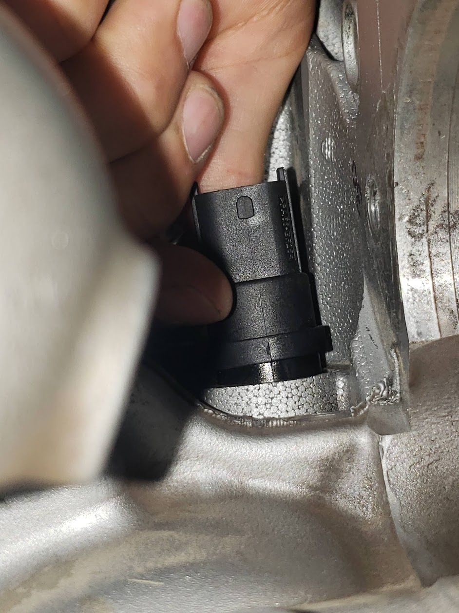

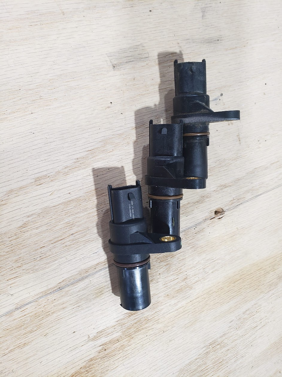

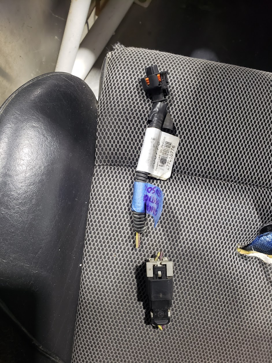

My goblin runs so much better, now that the purple wire in the CranKshaft Position (CKP) sensor is repaired.

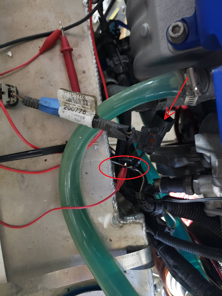

I used my wife's Singer sewing machine needle to probe the middle of the purple wire, and found that there was electricity getting to the PCM C2 connector, but not to the CKP connector.
I think Chevy switched the CKP connector sometime in 2006, as my car had a part# 200776 adaptor that changes the CKP connector to a different style one.
47714
Since my purple wire was broken just before the adapter connector, I decided to cut the extra connector out, and solder my CKP connector straight to the engine harness.
47715
47717
Lining up the new CKP sensor, and pushing it in the block was a PITA, but a 2 foot long metal bar was able to push it the remaining 1/8" from under the car. Put the starter motor back in, installed the intercooler pump, connected the battery ground, used HP Tuners to tell the PCM to relearn the CKP sensor, and then took it for test run, logging data just to make sure everything is good.

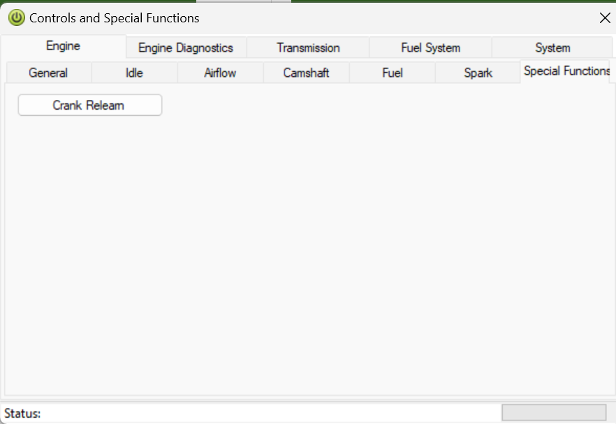

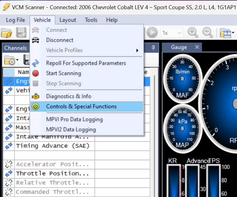

VCM Scanner, connect to your vehicle.
Then Vehicle / Controls & Special Functions.
47718
Then under Special Functions, there is a Crank Relearn. I pressed the button, slowly rev'd up the engine until I hit engine cut off, then waited until the engine died down to a low idle. No confirmation that relearn was done, but I cycled the key, and it seems good to go.

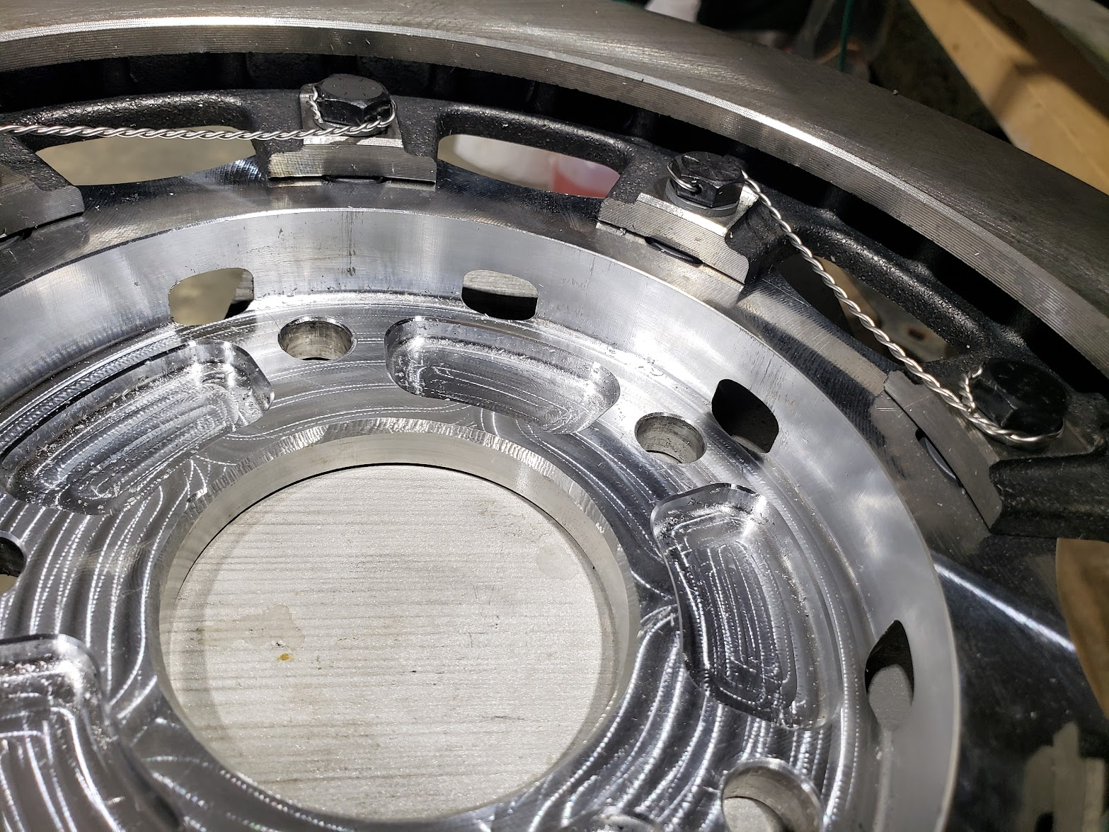

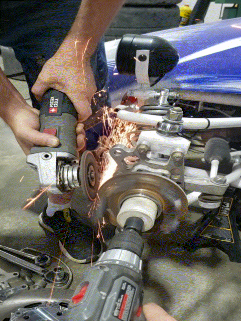

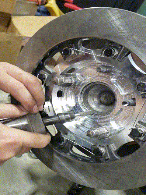

The brake hat on the Full Floating Race Brakes was about 1.5mm too small in diameter to fit my hubs.
So the hubs lost a little metal using my precision lathe grinder.
47846
The brake hat also needed a bit more of a chamfer to match my hubs, so some more precision work was done.
I mounted the new aluminum hat backwards on the hub, and used some spacers behind it to expose that inner edge that needed grinding.
47847
Here is the finished chamfer.
47848

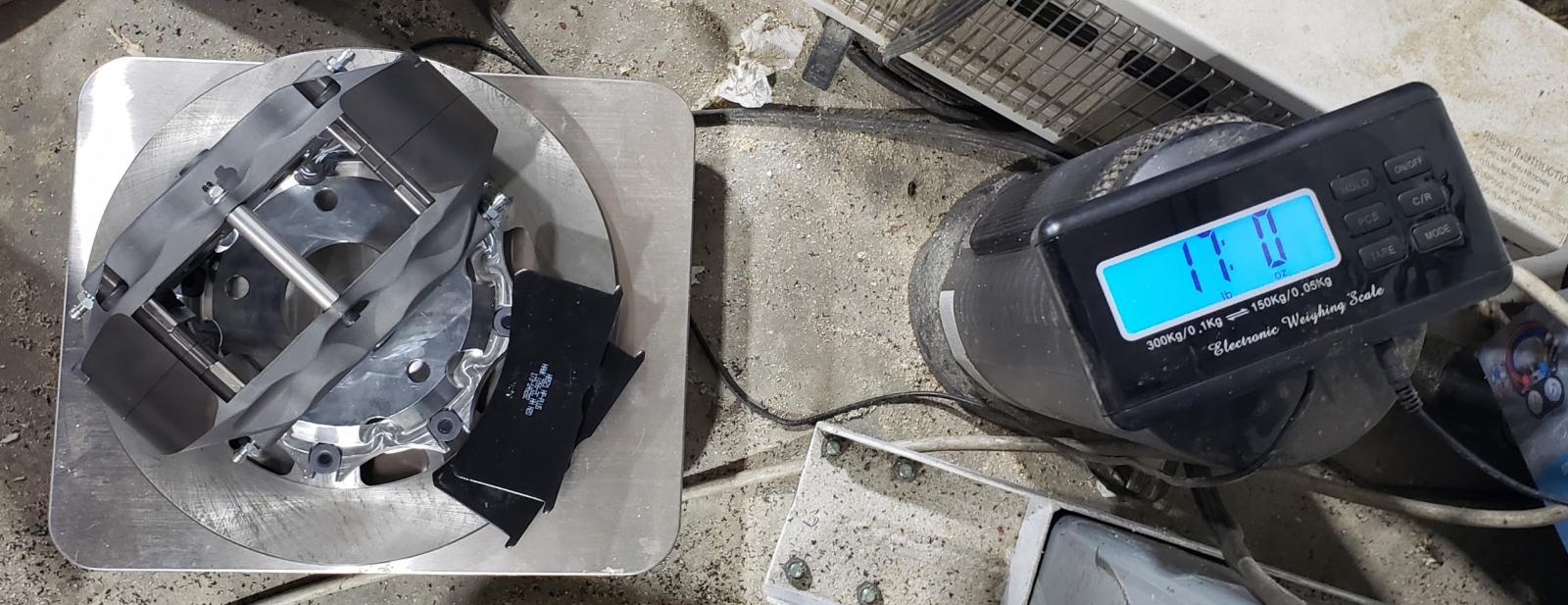

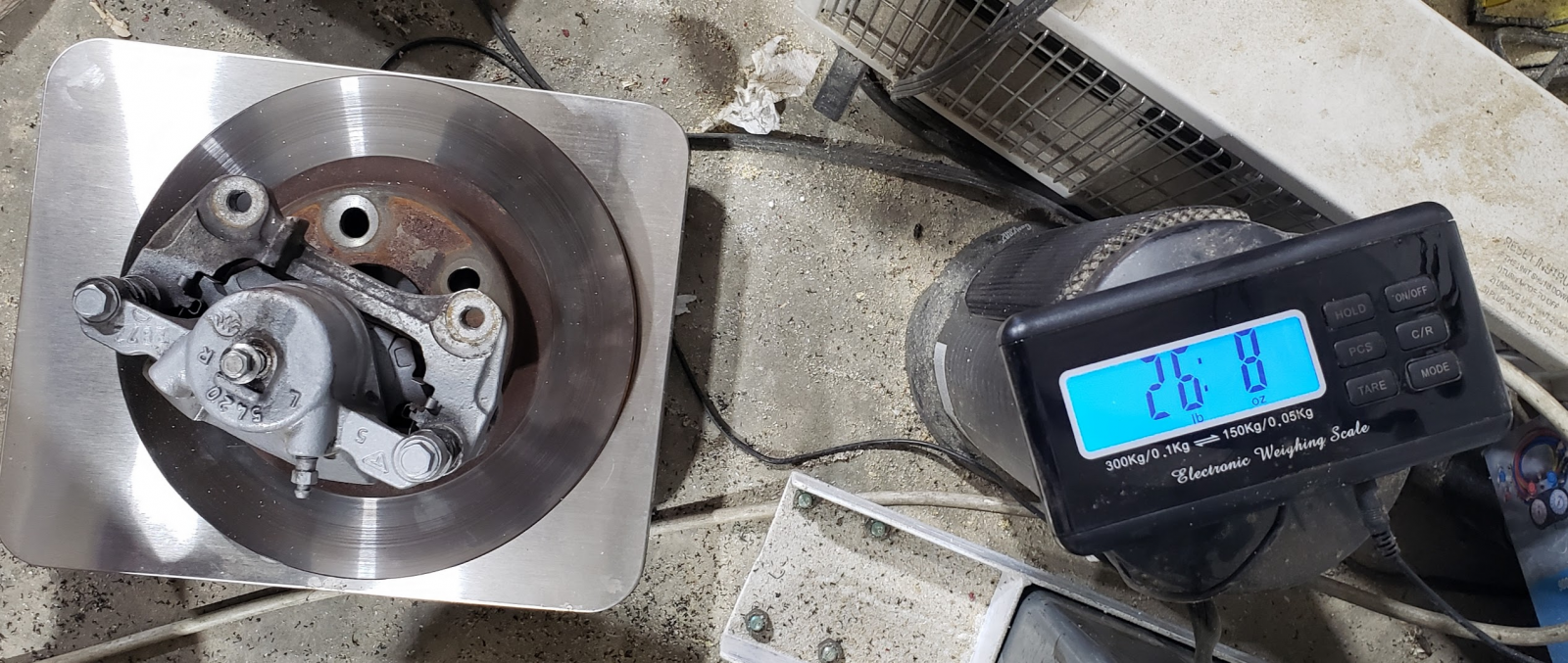

The old front single piston caliper, used brake shoes and brake disk weighs 26 lbs, 8 oz.
47849
Here it is with full floating brake disc, 4 piston caliper and new brake shoes.
47851

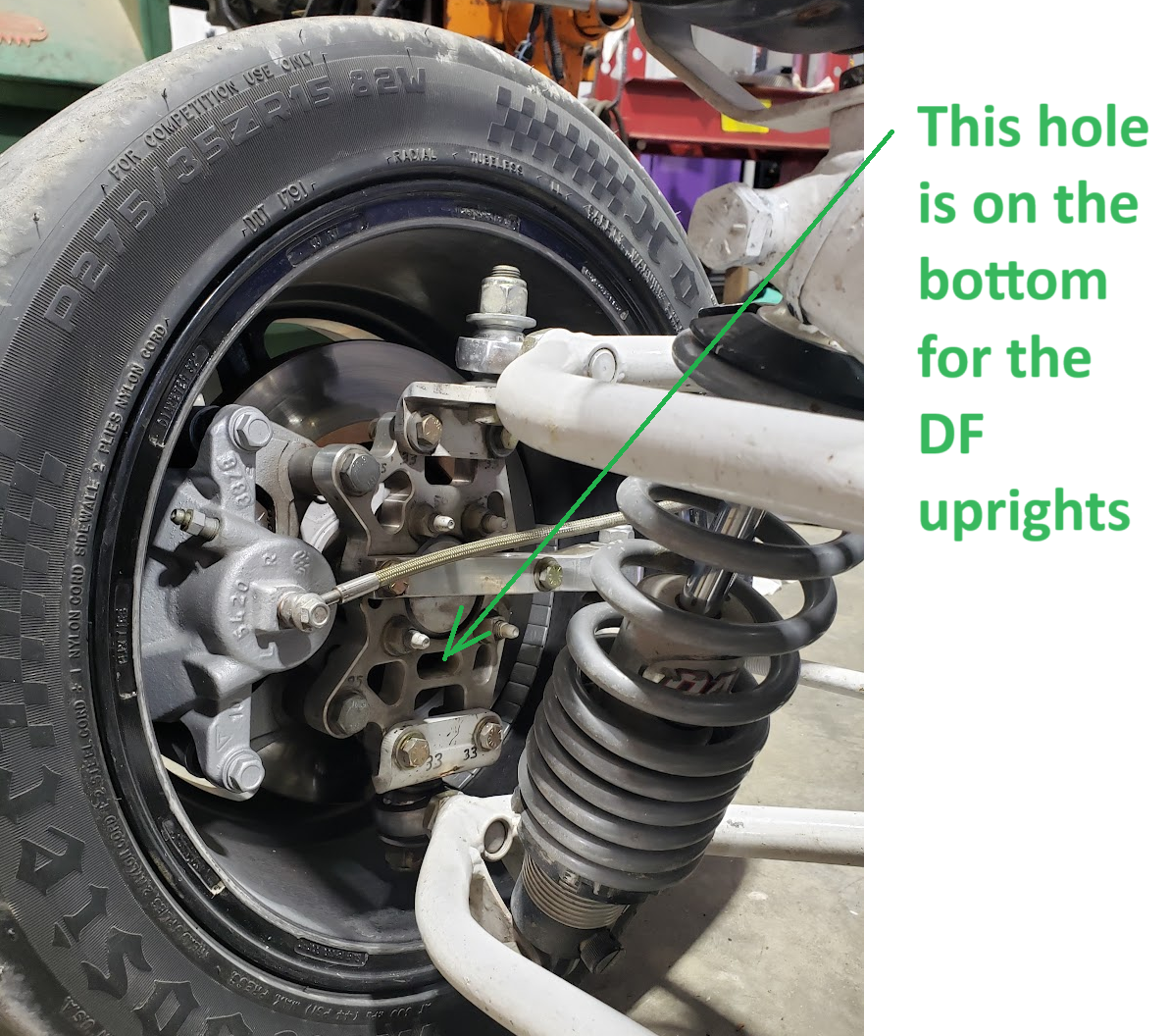

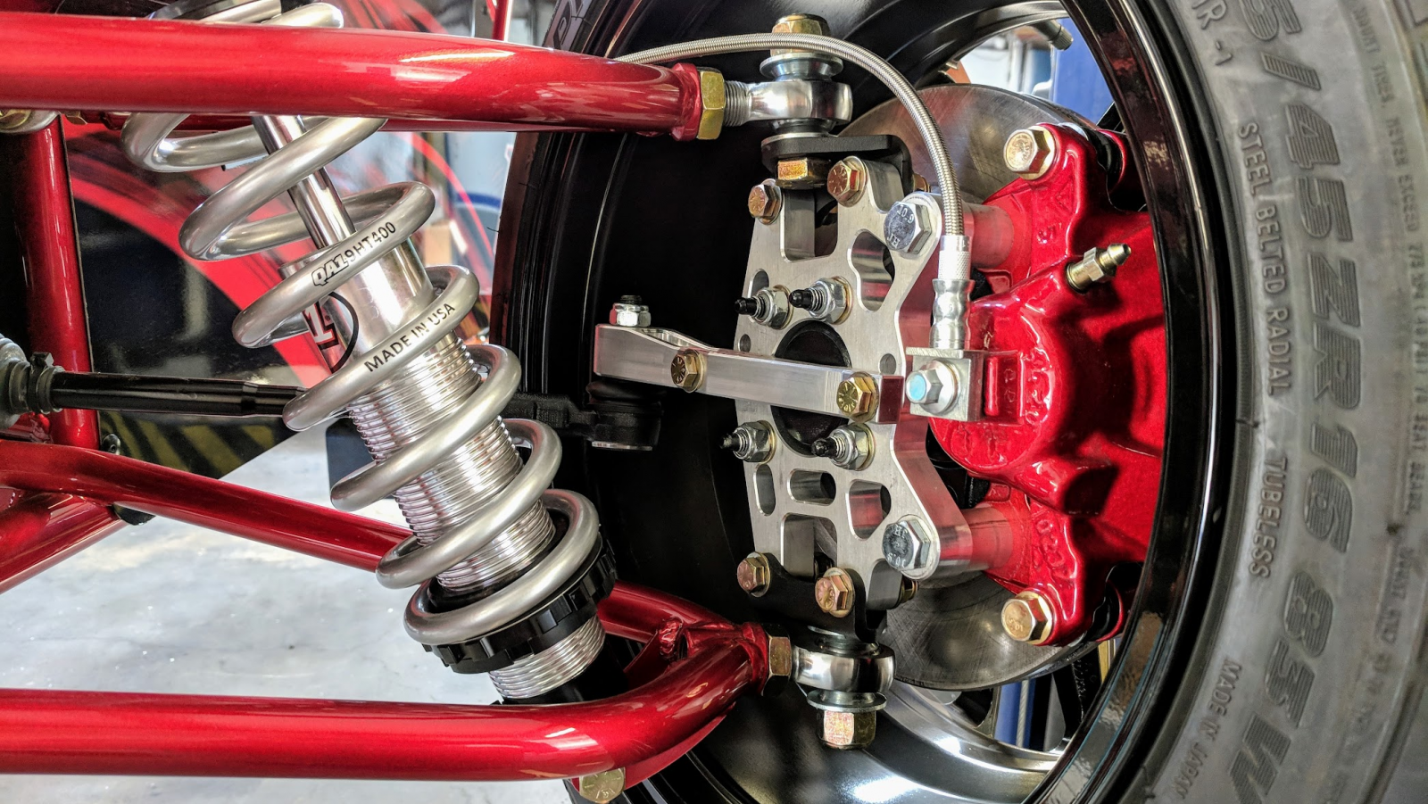

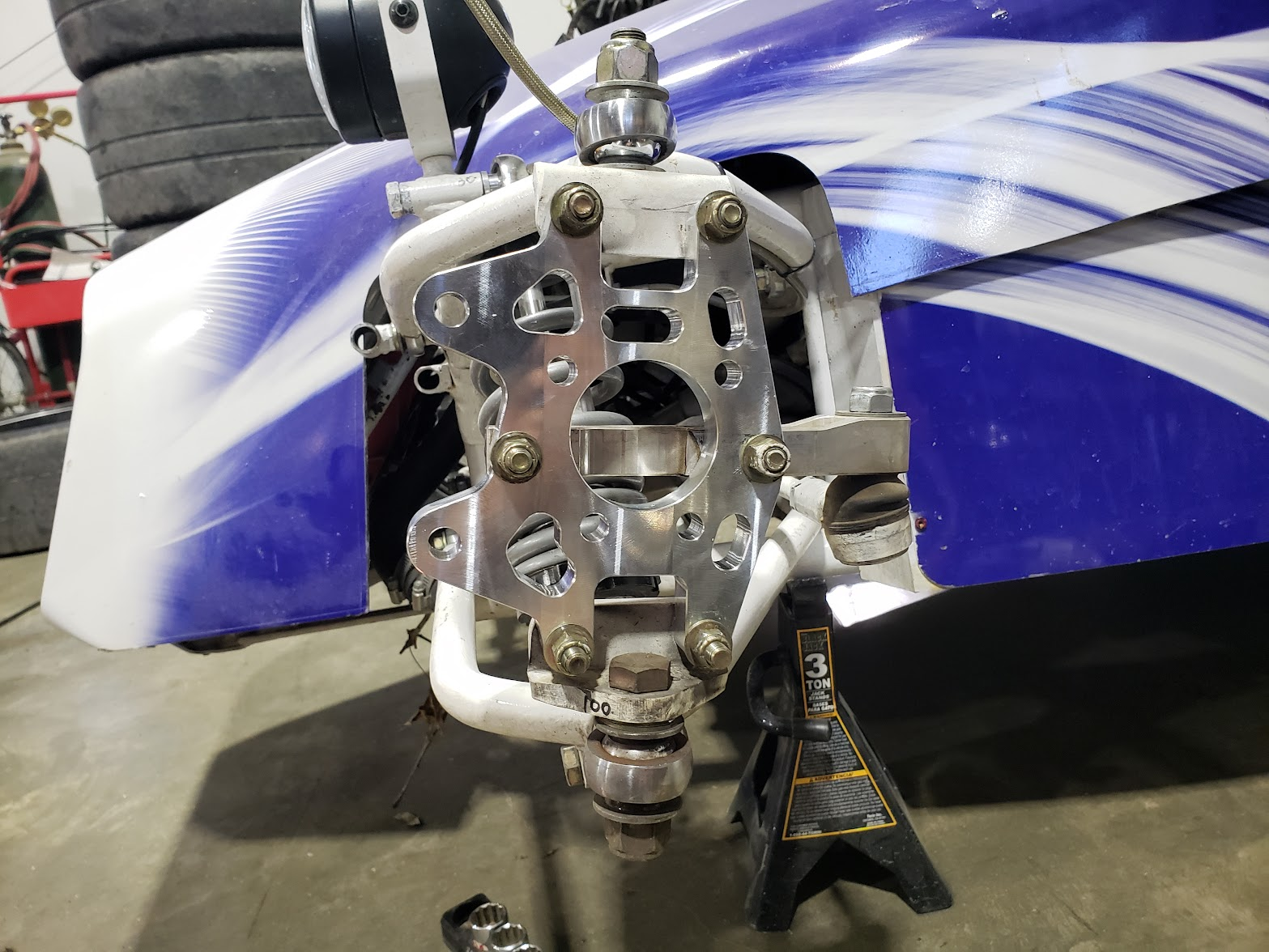

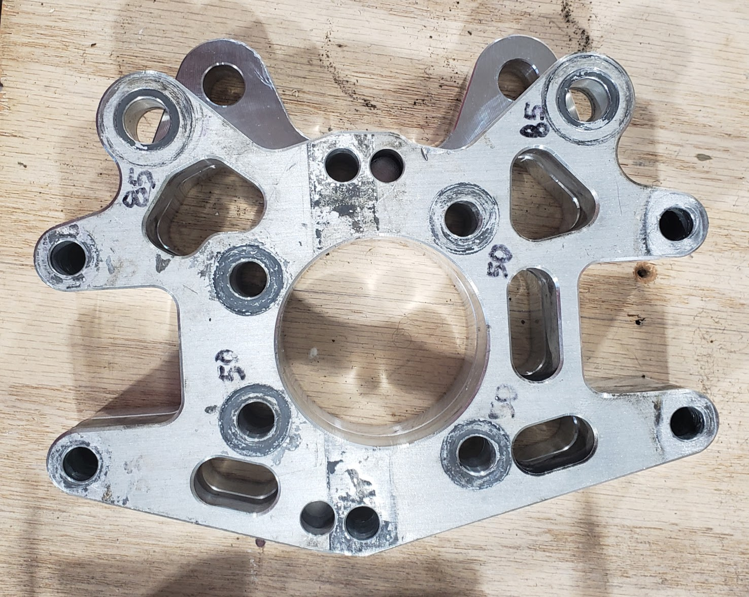

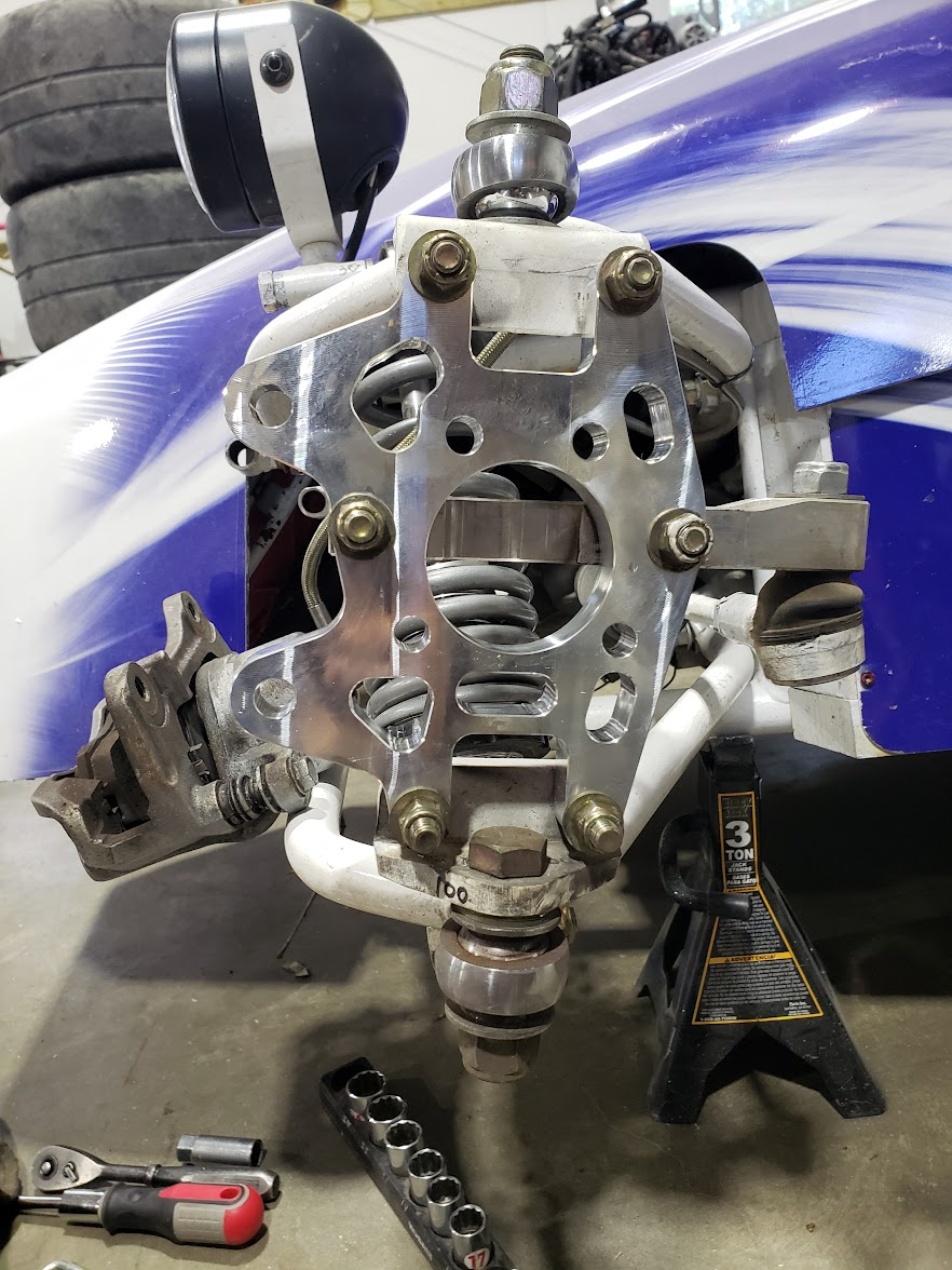

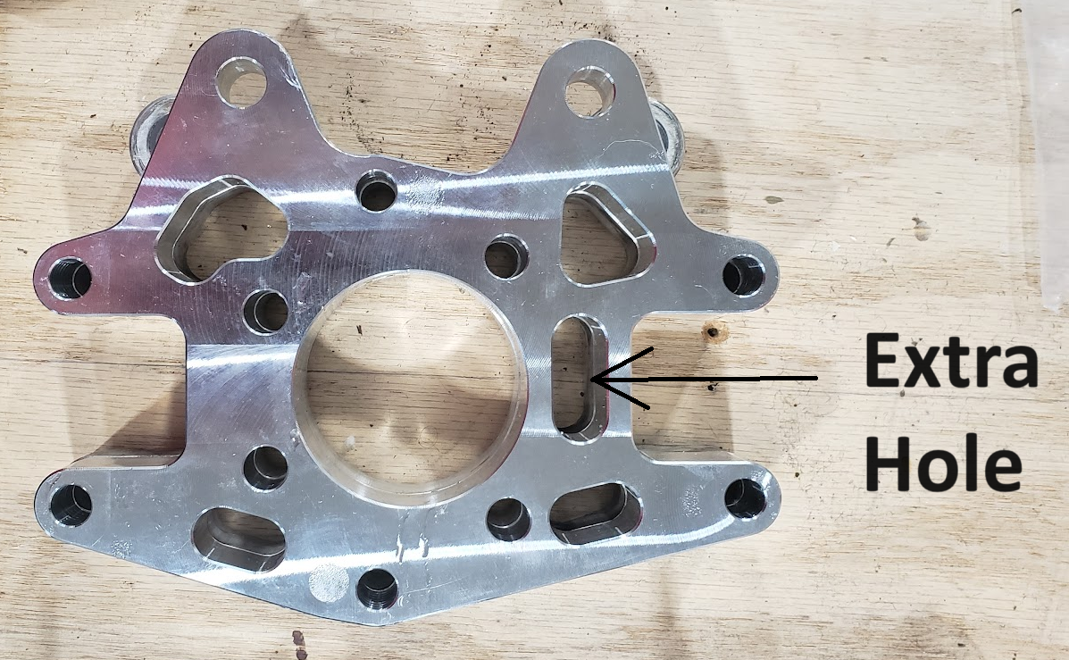

I mounted the new Justin Reed uprights with the hole on the bottom, like the stock DF uprights, but then noticed that the steering arm was too high. I checked JR's pics, and I have it upside down. The correct orientation is with that extra hole on the bottom.
47852
47853

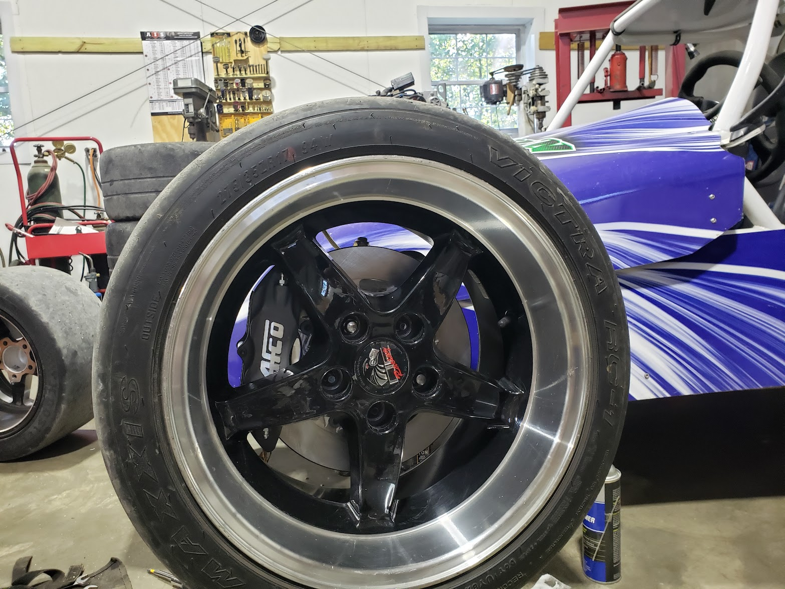

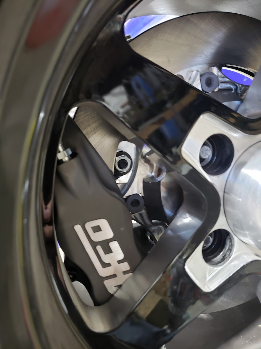

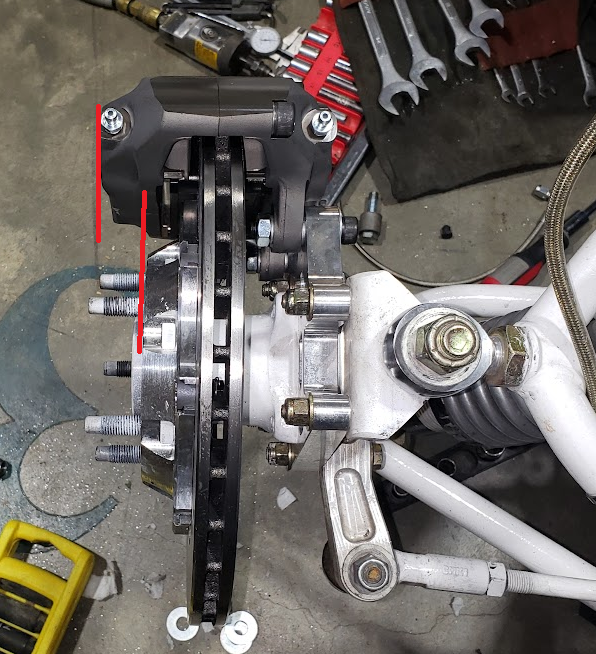

The distance between the top of the hat, and the new brake caliper is too much for my 15" wheels, but it fits good with my 17" wheels.
47855
I need to add a 15mm spacer for the 15" wheels.
47856
These wheels fit.
47857

Now I am confused. I overlaid Justin's front upright over the DF front upright, and the only difference is the 2 brake caliper holes.
47862
47863
Adam's pic of his car has the extra hole on the bottom
47860
And Justin's car has that same hole on the top. I'm not sure which way is correct. Adam's car is correct.
If I remember correctly, when Dale E and I were checking front bump steer, the lower the tie rod attached to the steering arm, the less the bump steer.
That is what got me looking for a bump steer kit for a Cobalt.
Maybe Justin Reed has found a way to lower the steering arm, without using a bump steer kit, by flipping the billet upright.
I would need to tape a laser to my front brake disc, remove the front shock, at test the bump steer again.
I'm really confused on what you are indicating for the "extra hole", but I redrilled my knuckle for a lower position of the steering arm. I used a clamp to move the steering arm into position for virtually no bump steer and redrilled one of the holes.
I'm really confused on what you are indicating for the "extra hole", but I redrilled my knuckle for a lower position of the steering arm. I used a clamp to move the steering arm into position for virtually no bump steer and redrilled on of the holes.
Do you have some photos?
