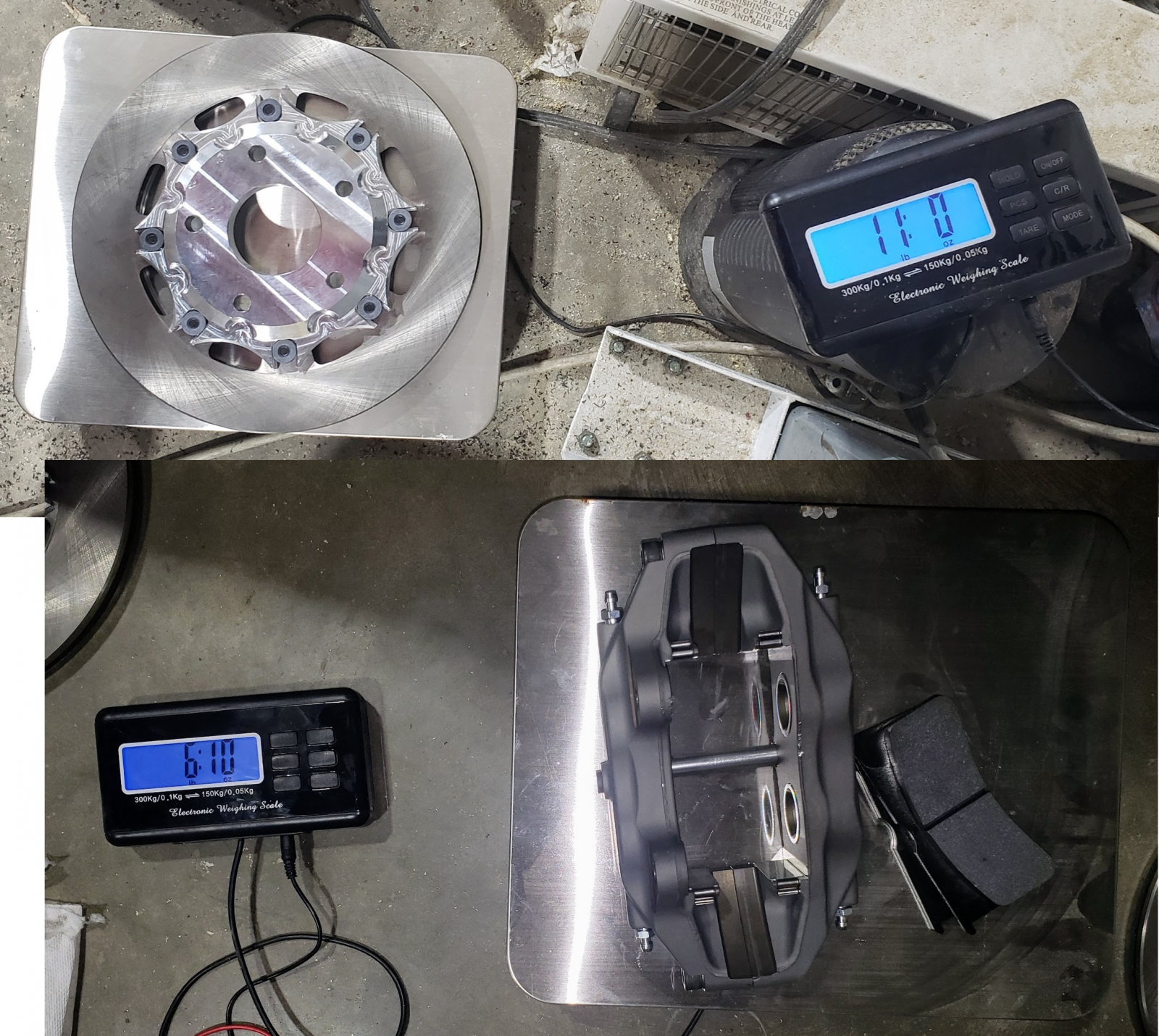

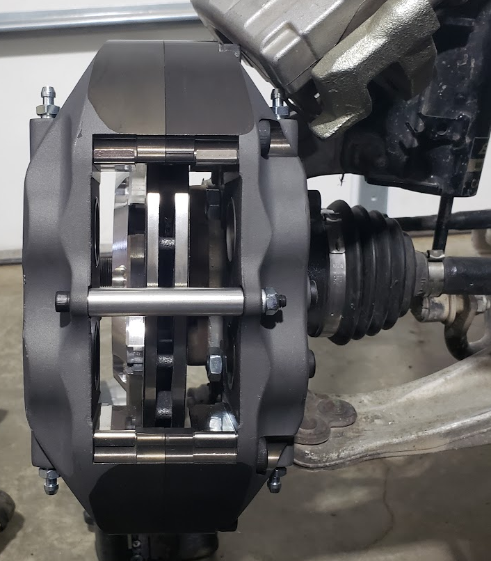

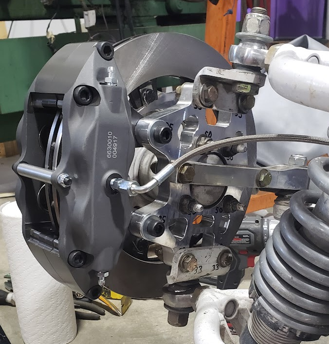

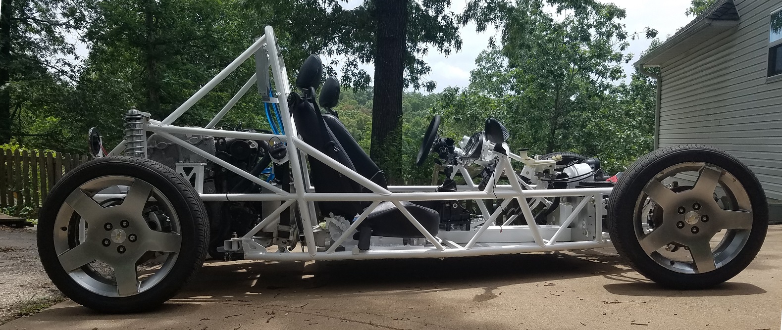

The rear full floating vented rotors are 11 lbs, and the 4 piston calipers and pads are 6 lbs 10 ounces. So 17 lbs 10 ounces total, give or take a few ounces for the scale's accuracy.

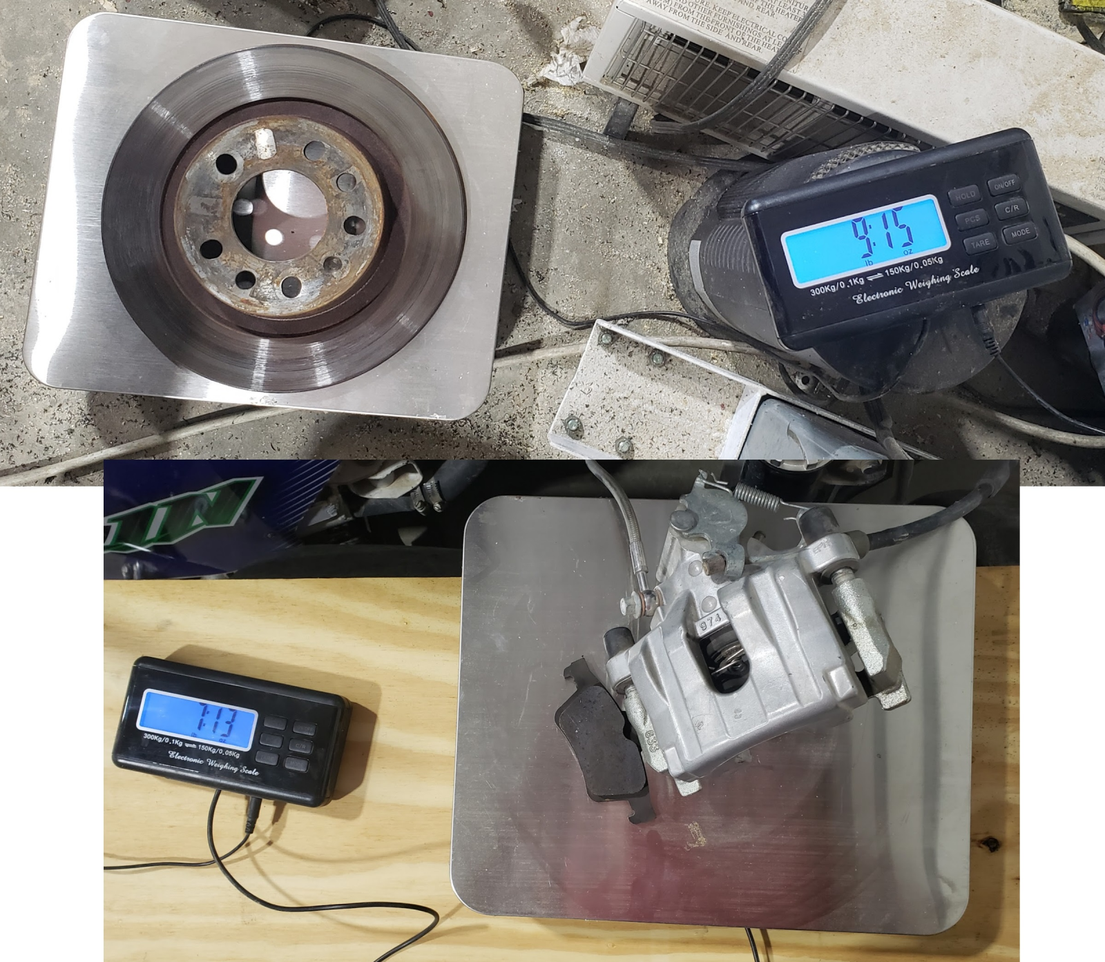

The Solstice single disk rotor is 9 lbs, 15 ounces, and the caliper with pads is 7 lbs, 13 ounces, for a total of 17 lbs, 12 ounces.
