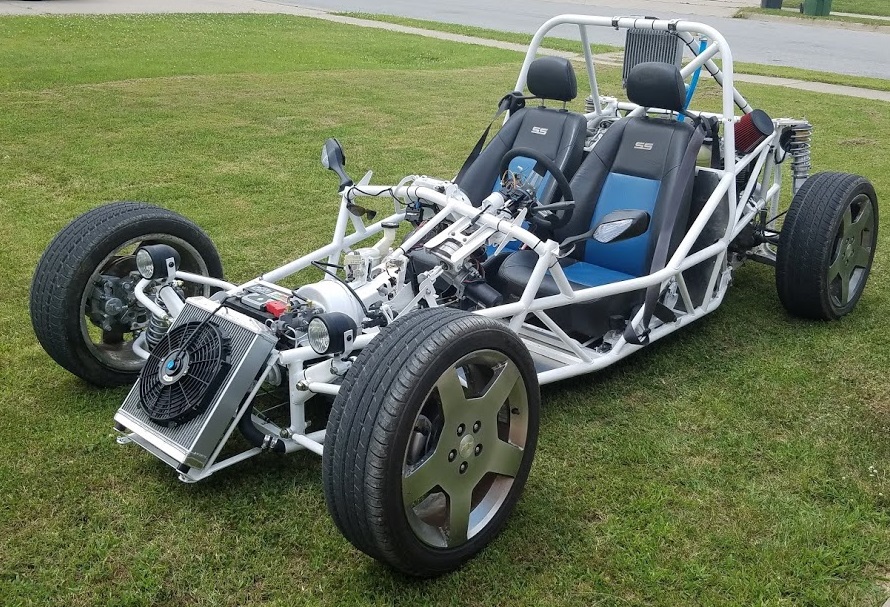

I need to debug why the front fan is never turning on. Fuse is good. Fan is tested.
Maybe relay, maybe the ECM, maybe a different temp sensor? The dash shows 180-208F, depending on when I checked it.
I soldered a long wire from the fusebox, black engine connector, light blue heavy wire, all the way to the front radiator fan. Ground is good.
Any suggestions?
Any suggestions?

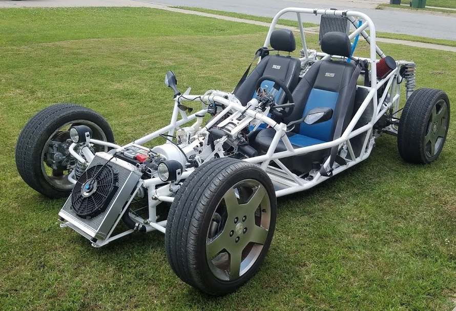

The best way to test is to jump the fan relay just like you did with the fuel pump relay. If the fan works then, your wiring is correct and it's up to the ECM to control it. And like Lonny said, it may be that it has to get a lot warmer for it to turn on. I have NEVER heard ours kick on. As far as I know, it may not even work.
You decided to go with a pusher setup????? They are not nearly as efficient and usually only use when there is no other alternative.
I was stealing George Bradley's engineering design, and planning on adding a torsion anti-roll bar up front.
Since the bar uses the space where the fan should go, he moved it to the other side. I just started with it there.

Looking at HP Tuners, I think they fan in the stock form is set to come on at a lower percentage at like 196 degrees. I put it to 100% on all, but the table doesn't start until 196, so I assume that's where the relay kicks in. I can also set the relay to kick in just on "key on", but that's probably way overkill, even for AZ. I haven't had any issues keeping it cool.

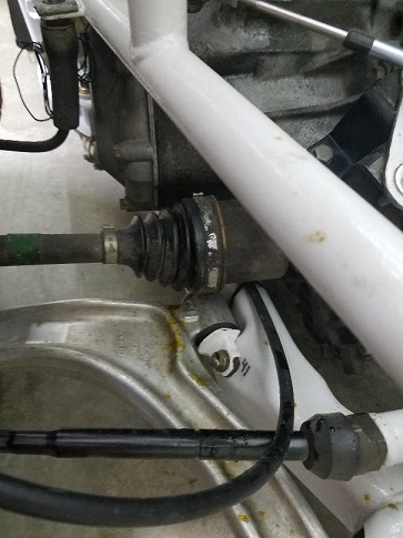

Where is the oil coming from?
9262
It looks like engine oil coming out of the CV joint, but there isn't any engine oil in the CV joint, right?
The transmission gasket is in line with the oil drops, but I don't see any oil drops on it...
It only leaks when driving - no drops on the shop floor.

- I ran a jumper in Fan1 relay, and it turns on the fan, so I guess it is the ECU that is deciding if the fan will run. I will watch the temp...

Odd question, but what's it smell like? Maybe the thicker grease inside the CV axle is separating itself from the thinner components and dripping out through a small tear in the boot.
I think you are right. Need to buy a new boot, or maybe the whole axle assembly. I found a small cut in the boot.

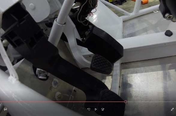

My brakes are getting worse...
The pedal won't return unless I hook my foot under it and pull it up.
Bad master cylinder or brake booster?
The brakes stop well. They just don't release well.

The master cylinder has the spring to return the pedal. It's usually pretty stout, especially if you have ever tried to bench bleed one. Either the pedal box and associated linkage is in a bind not letting it return or there is something up with the spring in the master cylinder.

Sounds like your binding problem for which you put in the spacer, when you did your pedal box re-align, might not be resolved. Possibly pushing on the brake pedal is putting it in more of a bind and that's why you're experiencing a worsening condition. You may try loosening all of the bolts and see if that frees it up.
