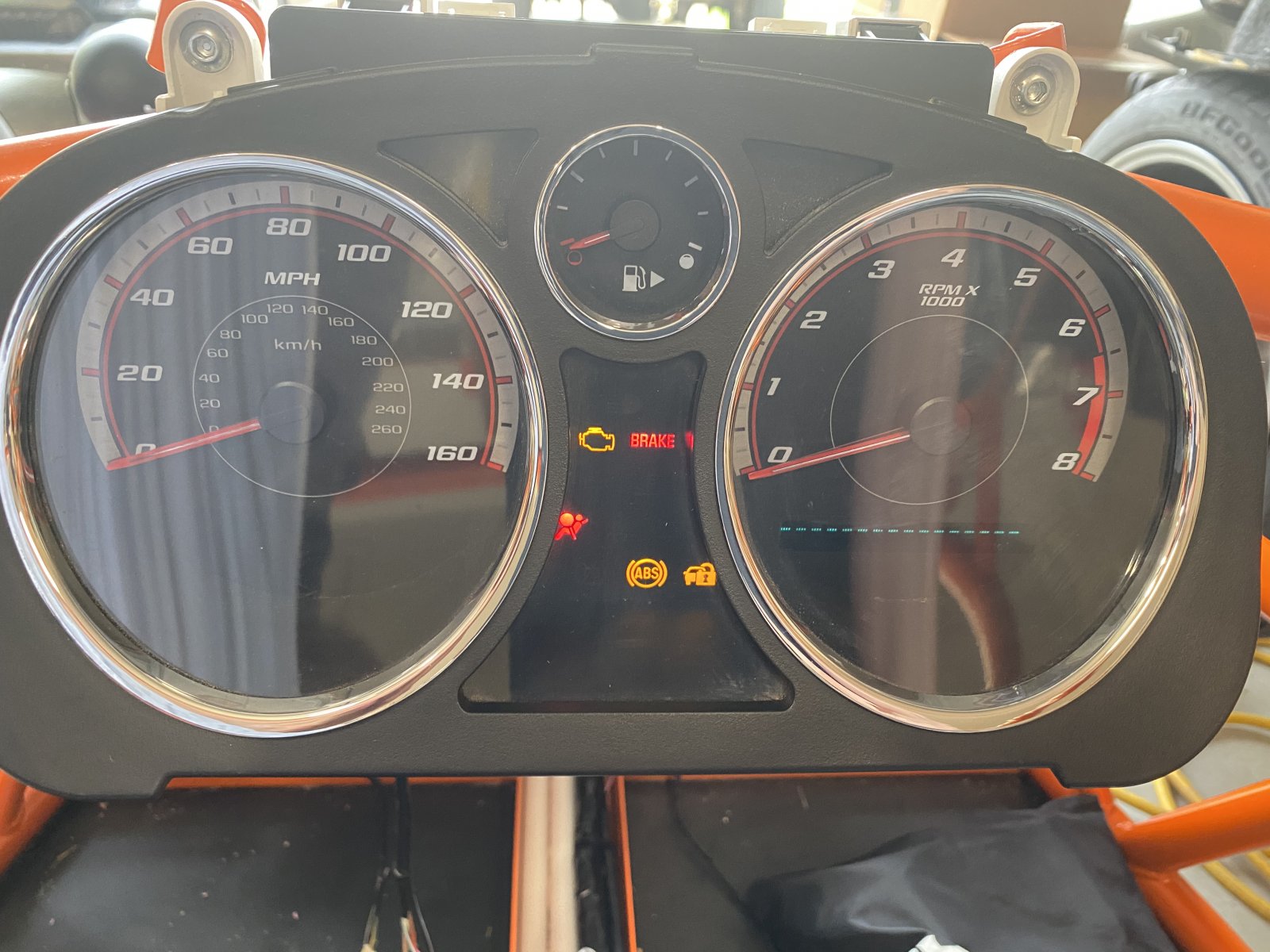

In going through the forms I found that someone had the lines on the dash read out as well but I did not see exactly how that was resolved. See the picture for what I mean. When I power the car it will show mileage and then go straight to this.
Can one of you guys with a lot more knowledge than me put me in the right direction?

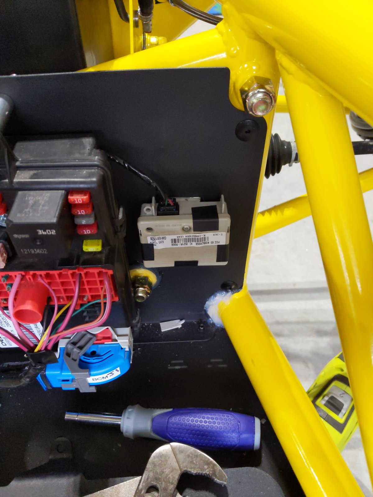

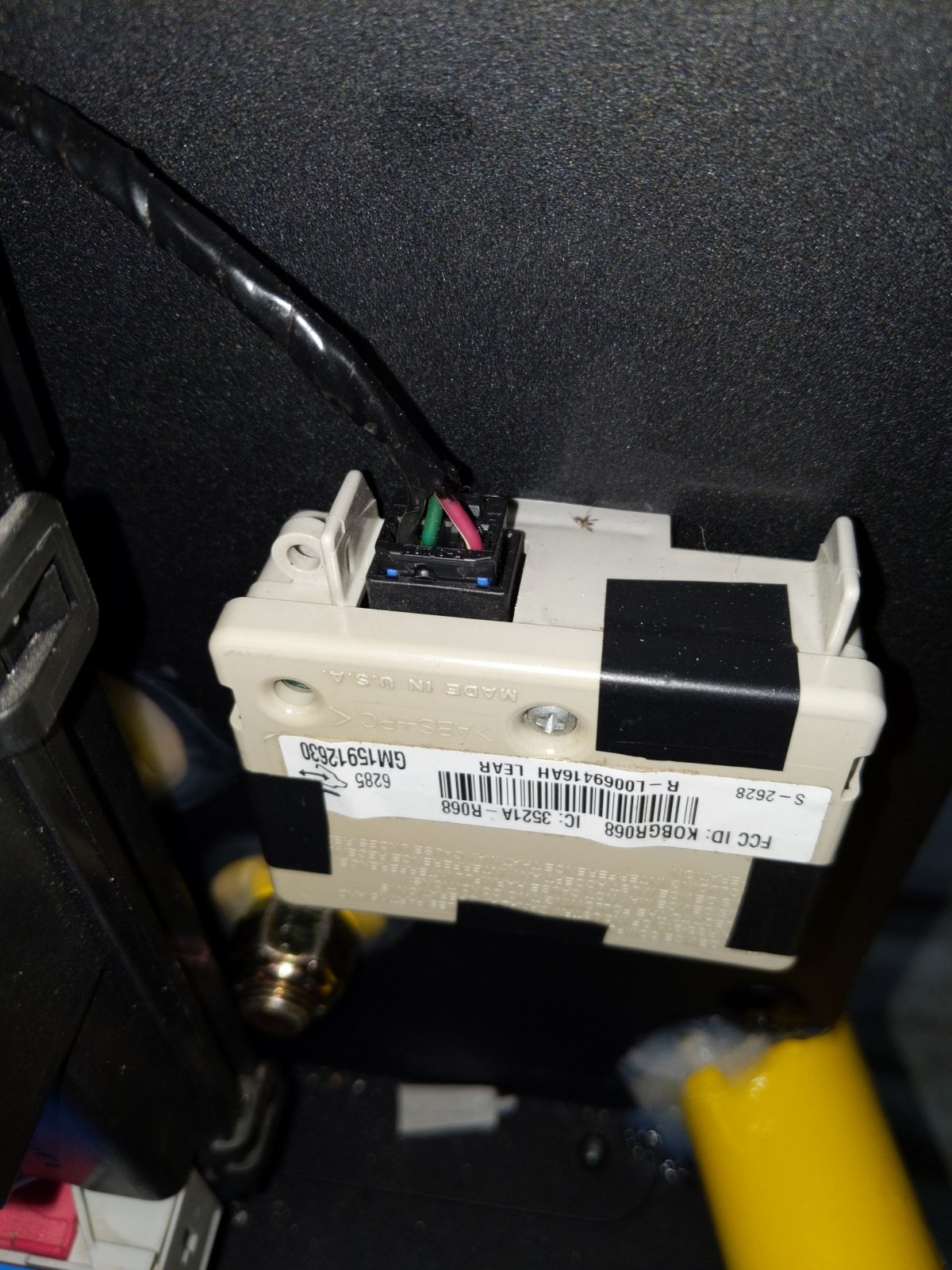

Do you have this little module plugged in?
