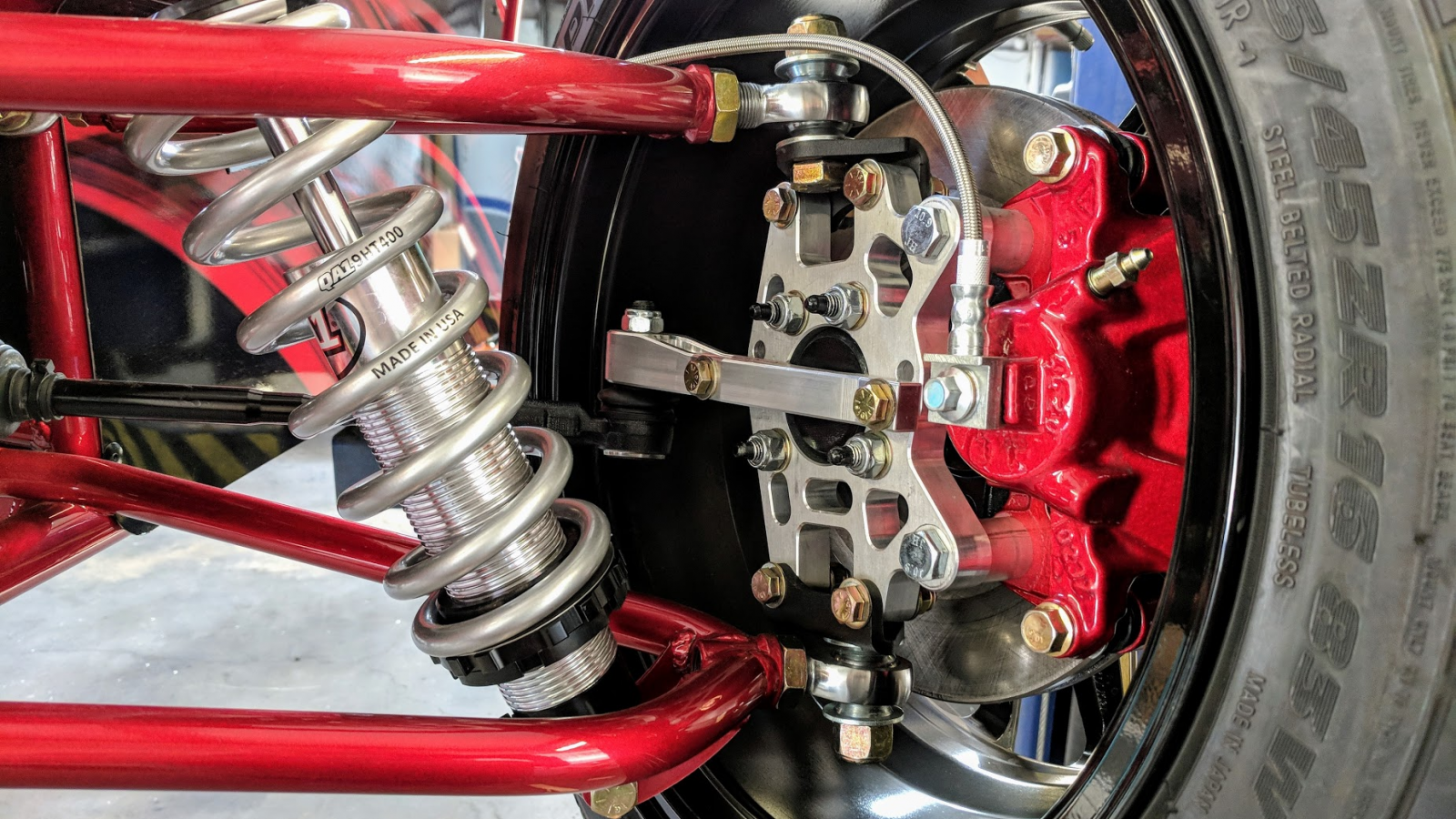

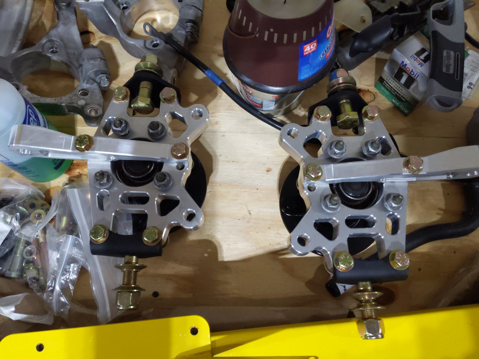

Maybe I haven't gotten that far yet but what angle brackets are you taking about? I need to know what to look it for
They are the brackets (rod end mounts on the video) that hold the front uprights to the control arms. They are different than the brackets in the videos. The top one attaches to the outside of the upright and the bottom goes on the inside. If you put them on the same side your front wheels will have a lot of negative camber.
https://photos.google.com/share/AF1...?key=Y19FbDQ5dE5uVlNrV3dwVFgyVkxJM3h5WHZwSHZ3
The stock rod ends go on the rear and I will probably have an extra set. The DF supplied ends are shorter and are too short if you set up the uprights wrong. I ordered another set before I was told that I had them on wrong.

Ahhhh, I put this together as I was waiting for the sheet metal to arrive. They aren't tightened down yet so if they are wrong, I can correct pretty easily.
SACTX
Those are correct. The steering arm needs to be attached to both bottom holes though. At least that's what I was told...

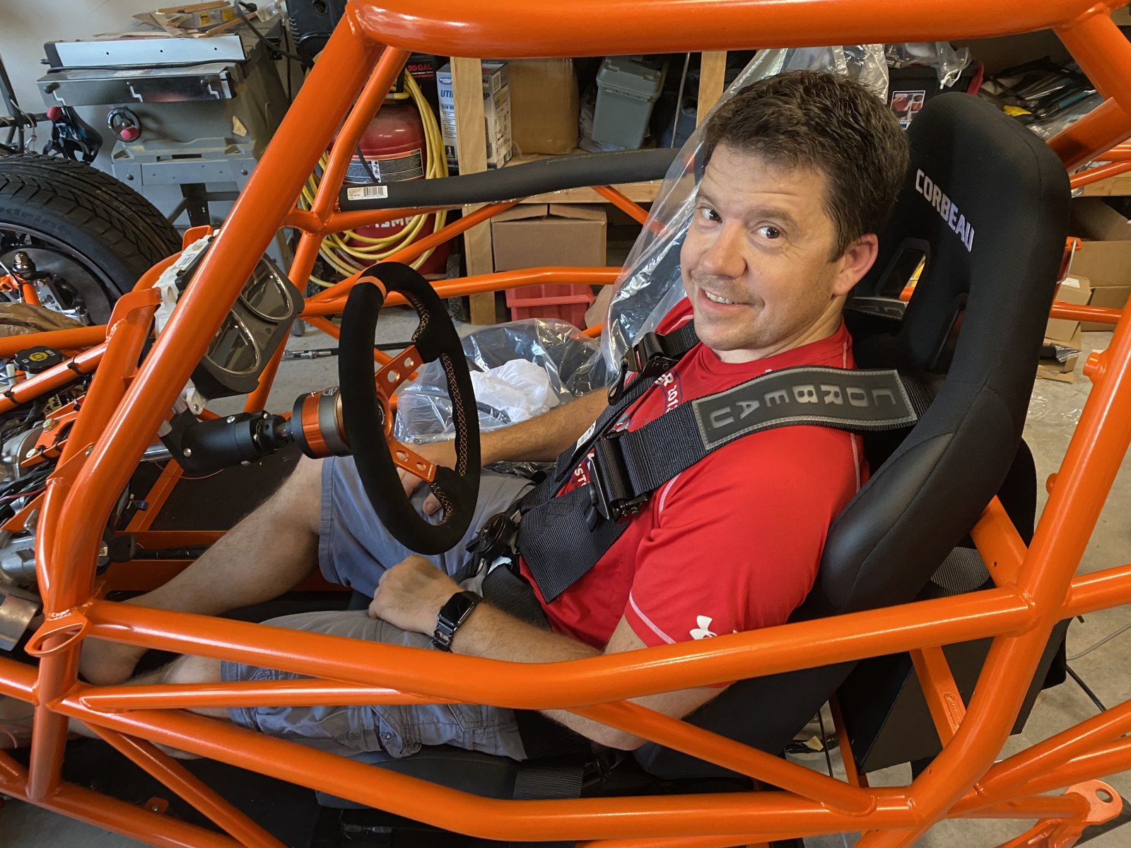

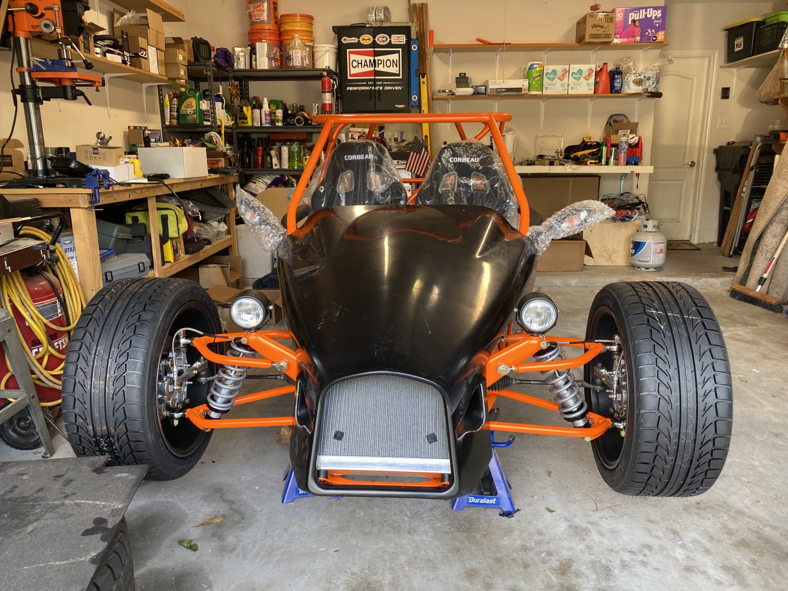

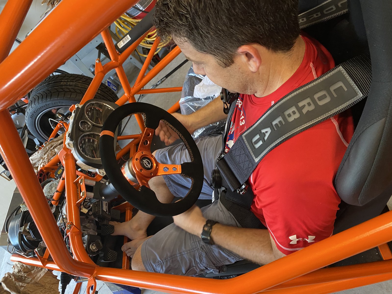

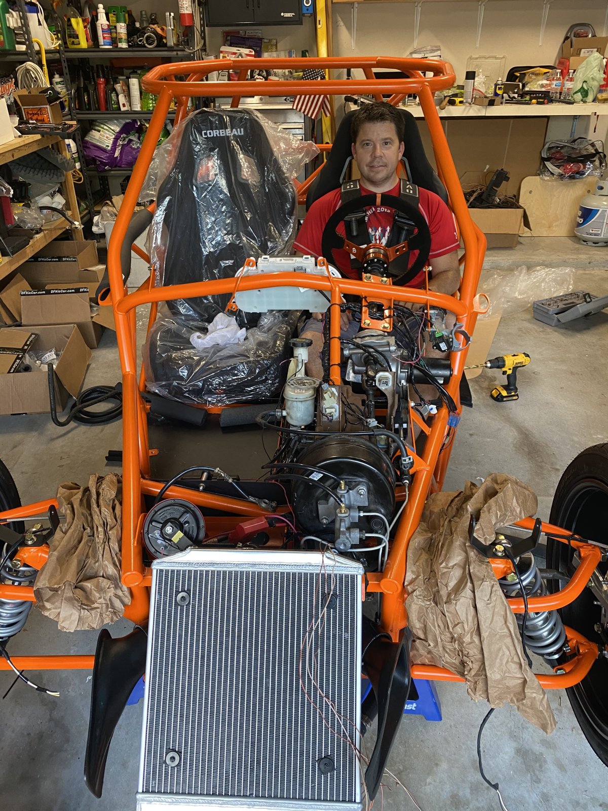

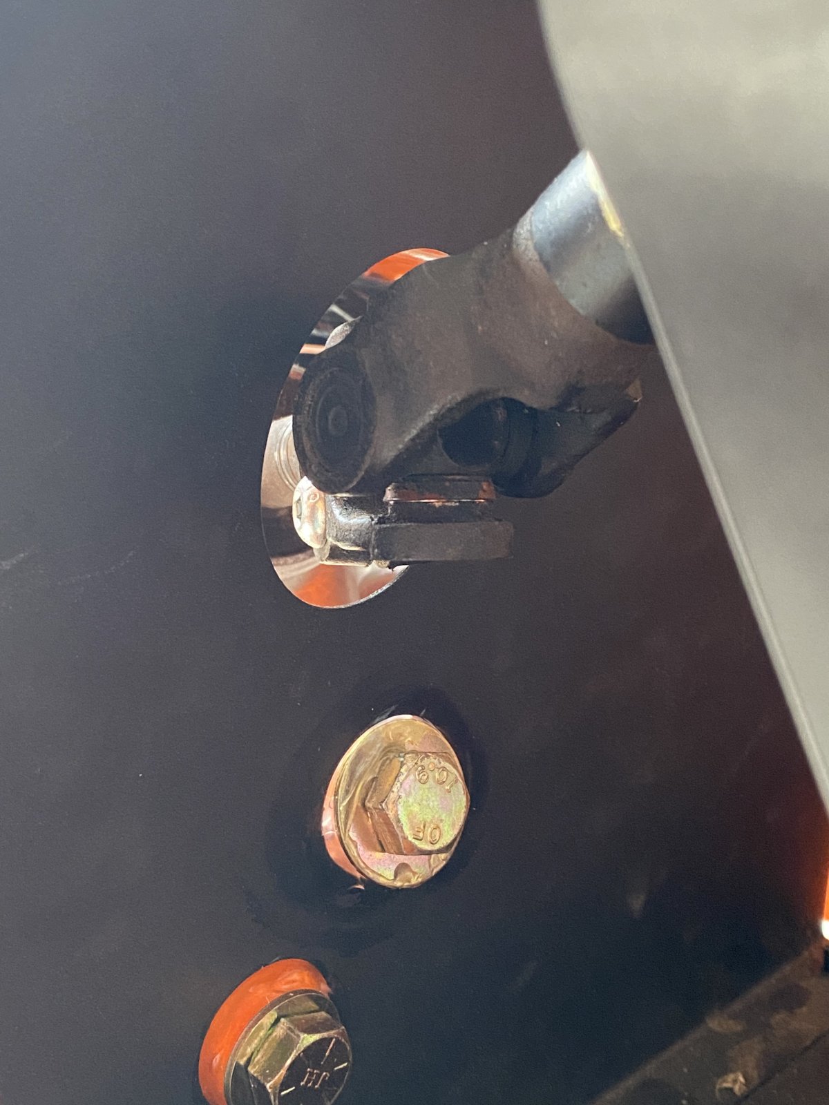

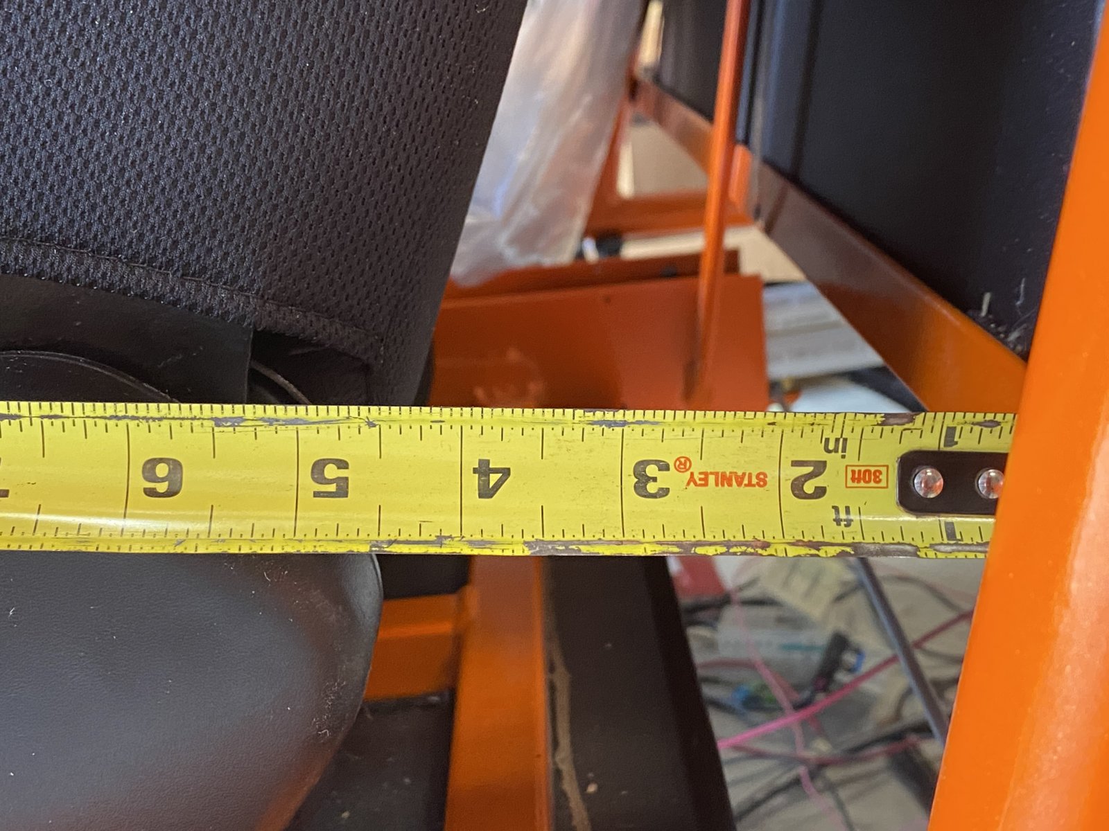

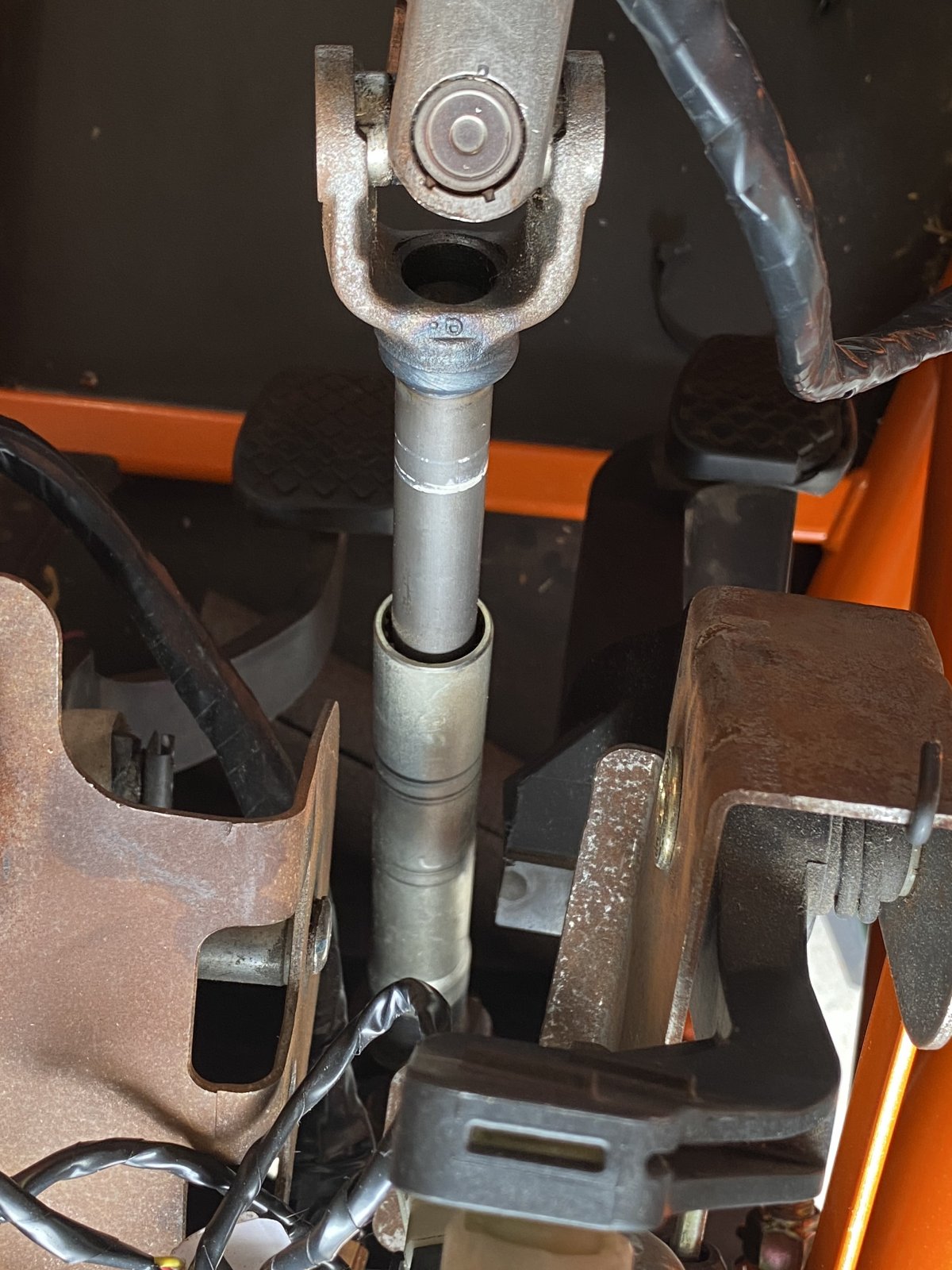

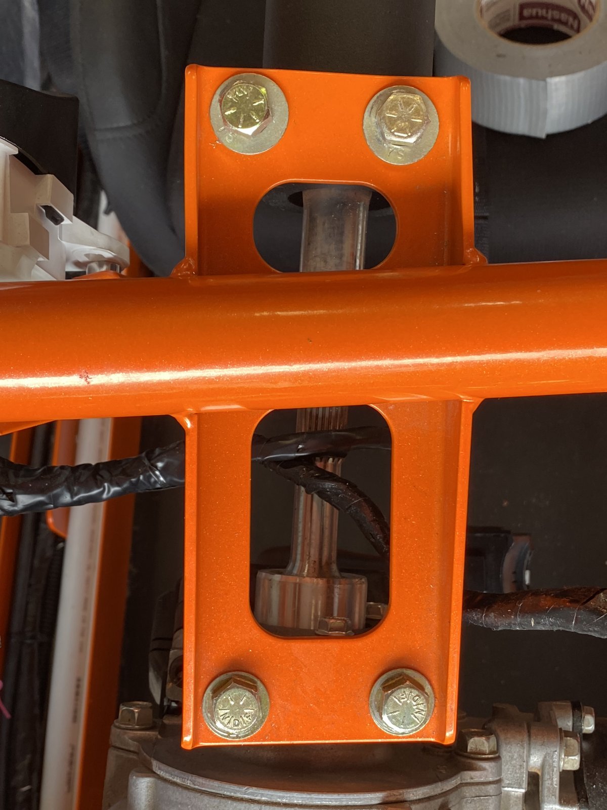

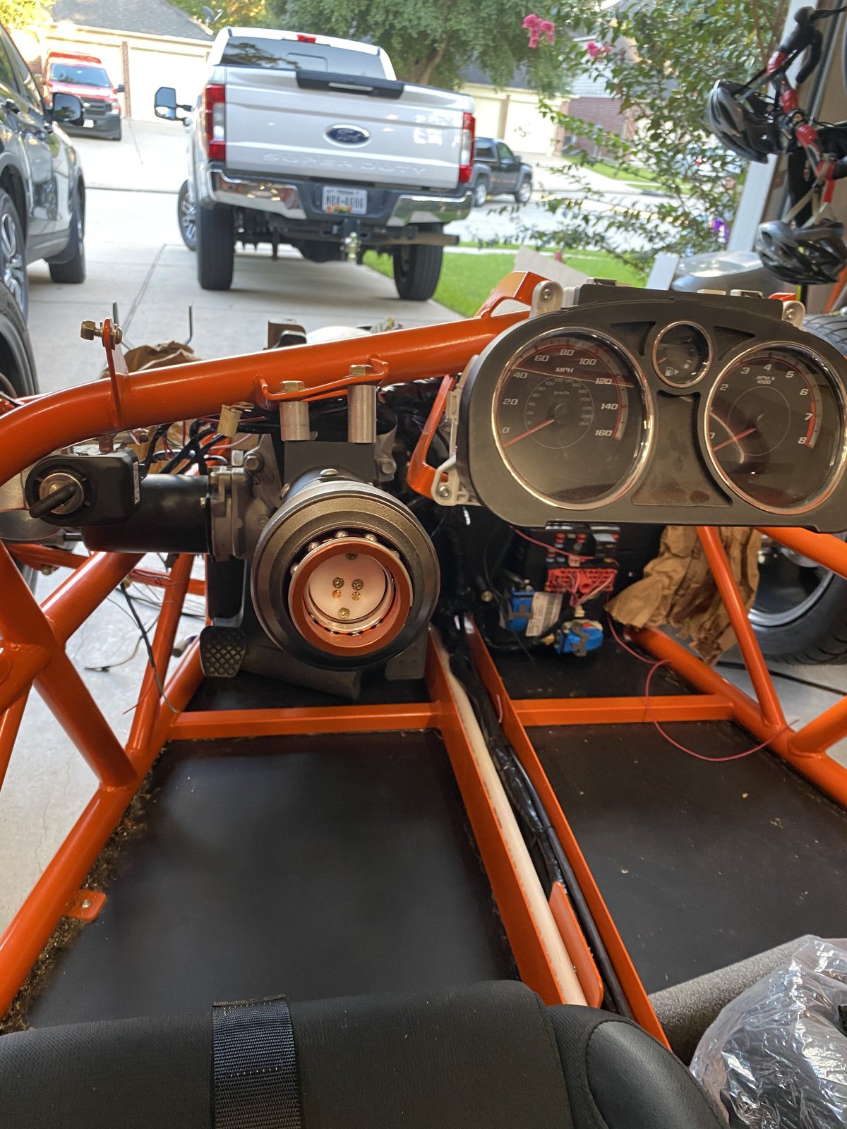

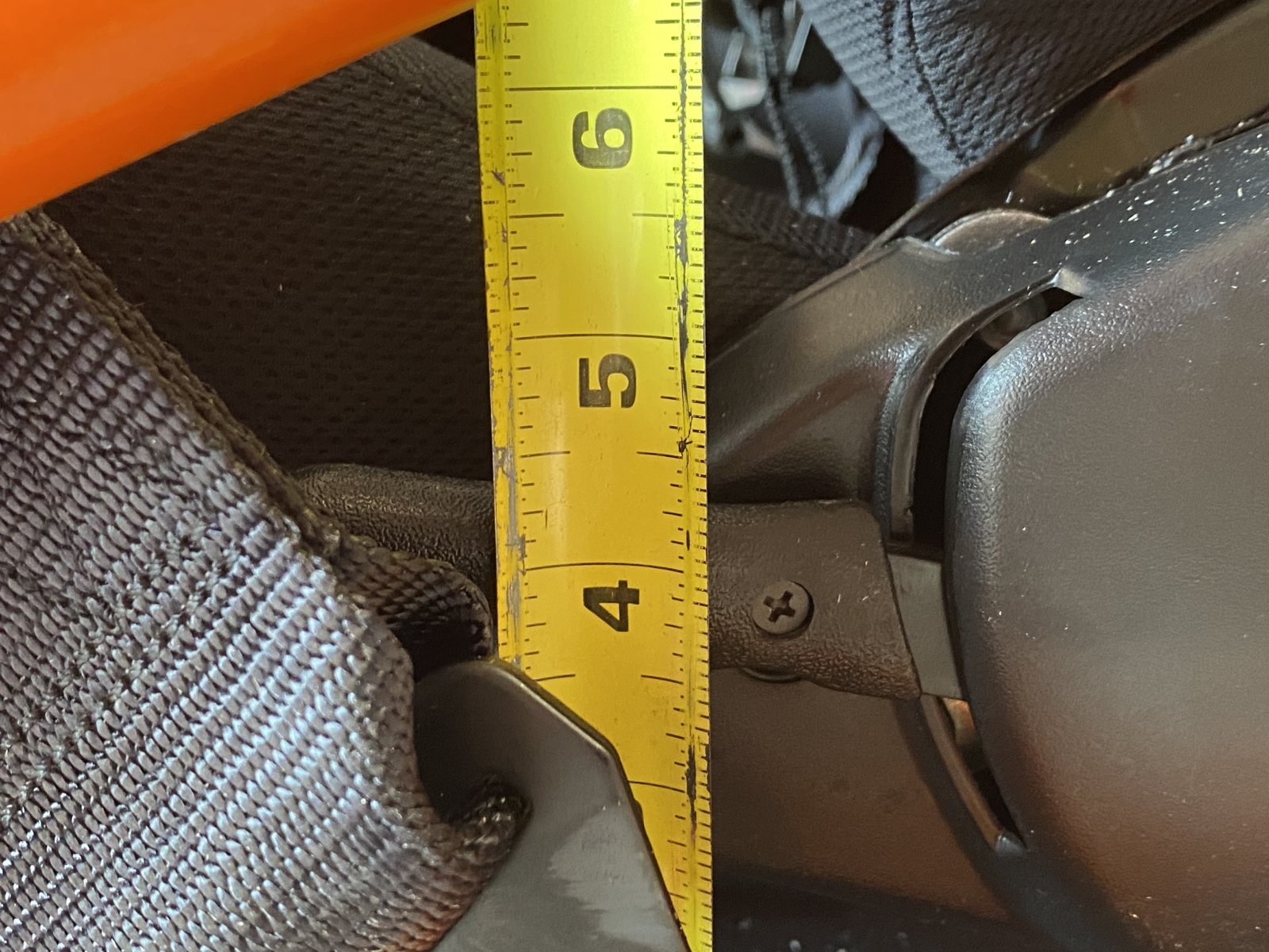

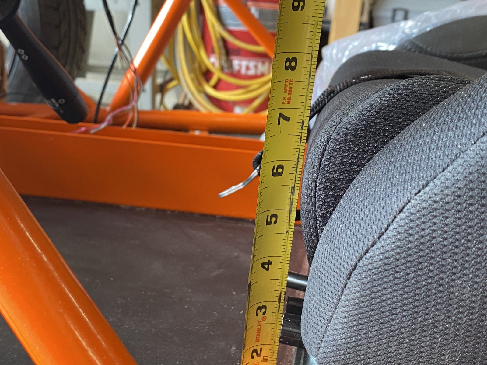

The front end is complete with the exception of some very minor things. The driver's seat, seat belts, and steering column is all assembled and done. The passenger side is ready but waiting for the shifter and hand brake install. The pictures from the shimmed steering column are from the other thread but I wanted them here also.

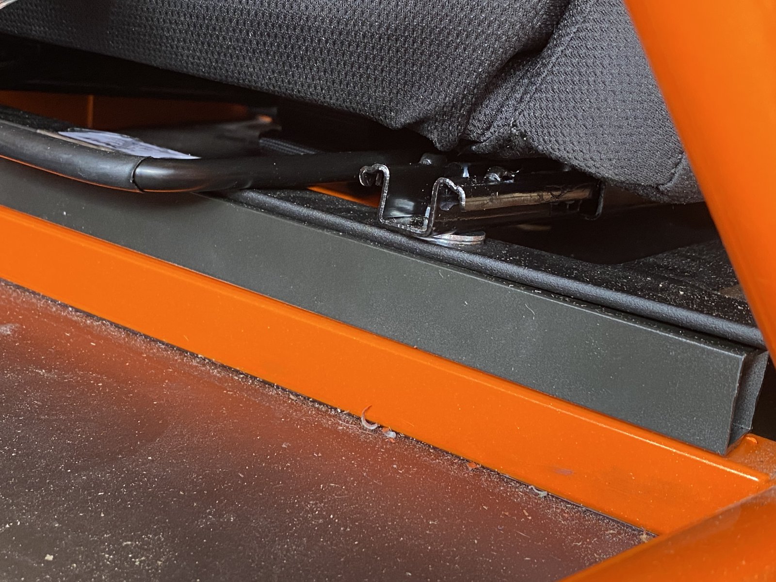

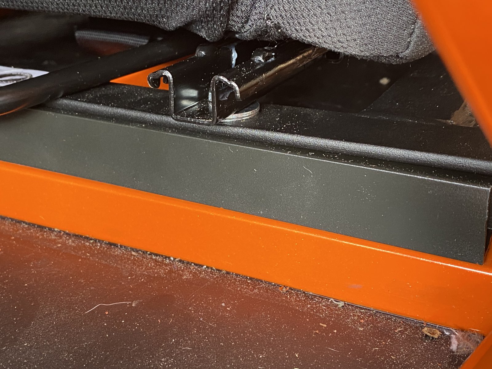

Also for posterity, the Corbeau A4 seats can be installed using 1" square tube shims on the front being bolted straight to the seat mounts on frame. It does push the seat further forward a it's pretty low.

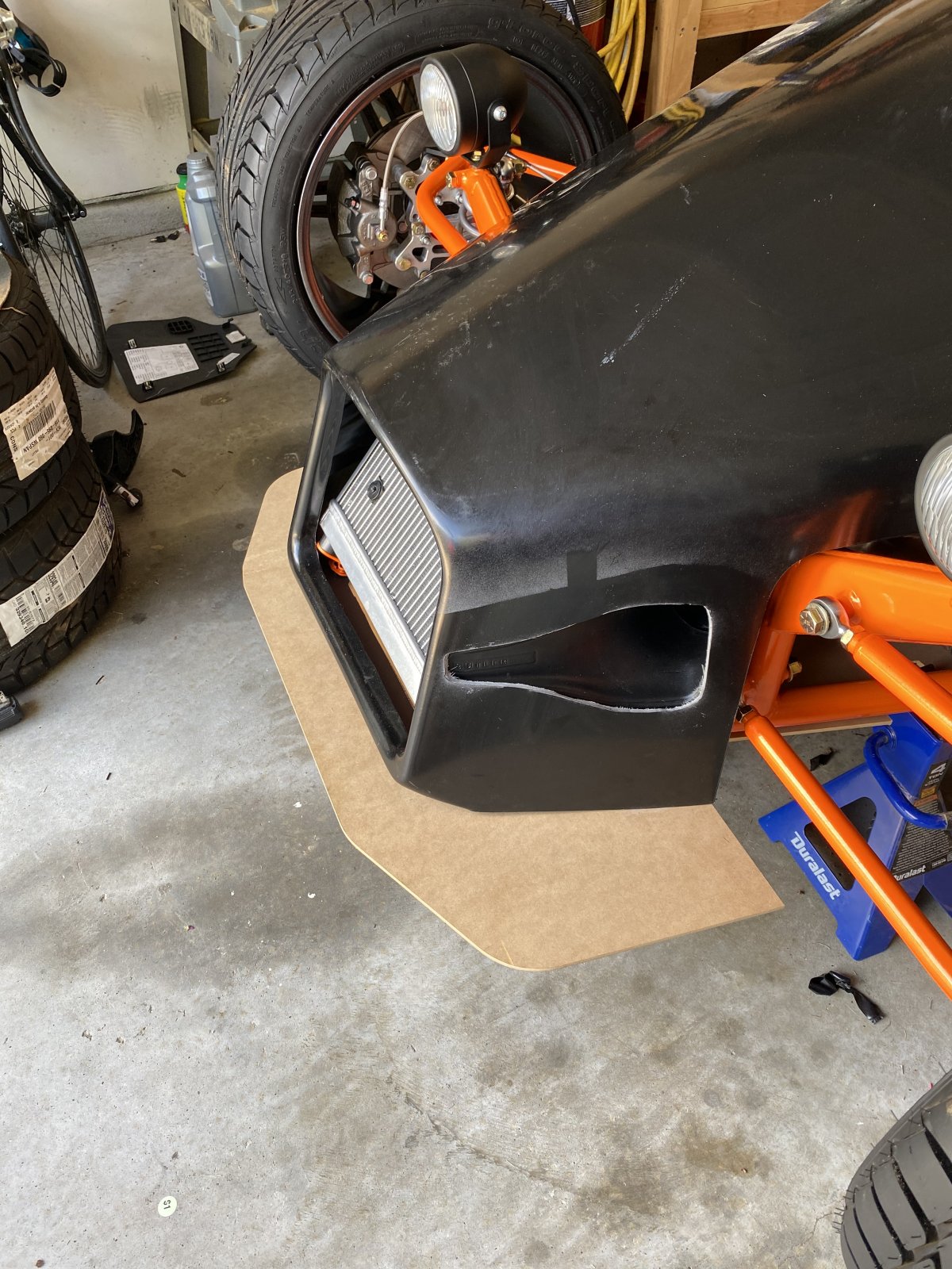

I'm working on a full front bottom plate with some winglets. It's still in the works and I've cut 3 templates. These are pictures of the second and don't have the end plates or sloped ends done yet. Alan likes it!

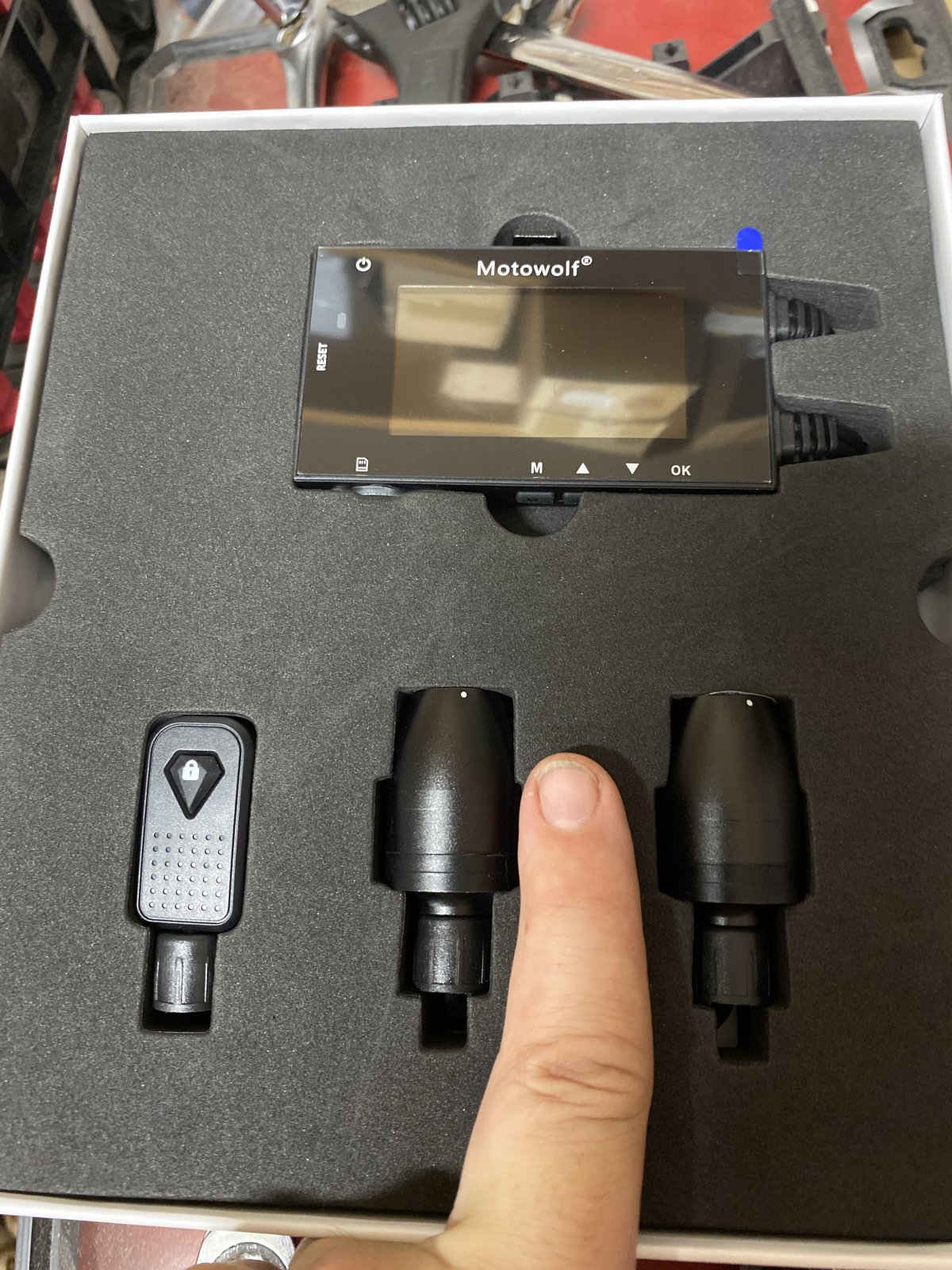

Next will be wiring in a front/back motorcycle dashcam set up with the monitor mounted below the button panel (I think). I also have a dual dashmount USB power port that'll be mounted next to the dashcam monitor.

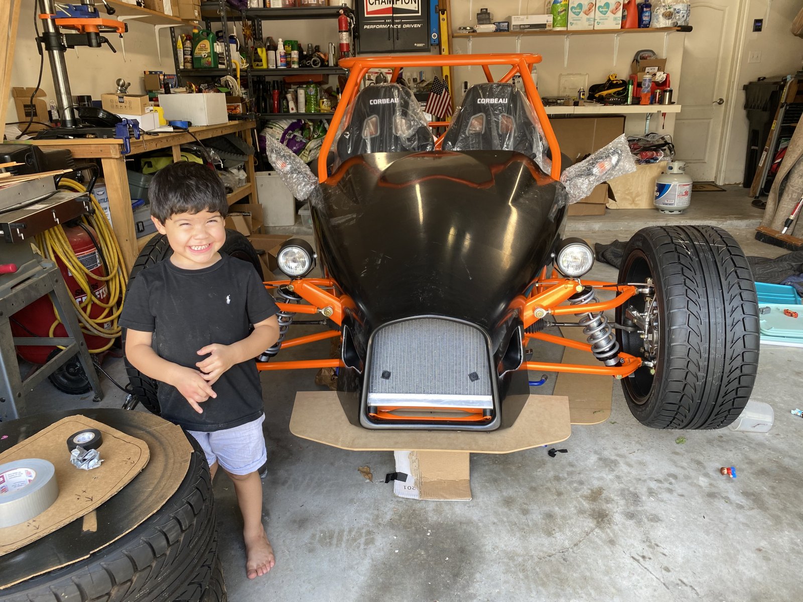

Yes the wing is an acquired taste and he’s already acquired it :).. it looks better in person... thank you!
He is ridiculously excited about the car. Every day when I get home from work he asks me if we can go out and work on the car
Classy
I really like that splitter! I love it when my kids want to participate in my projects, but it seems to be fewer and far between as they get older...

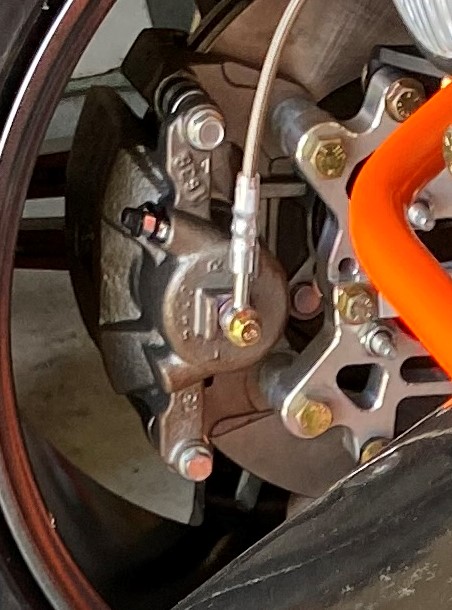

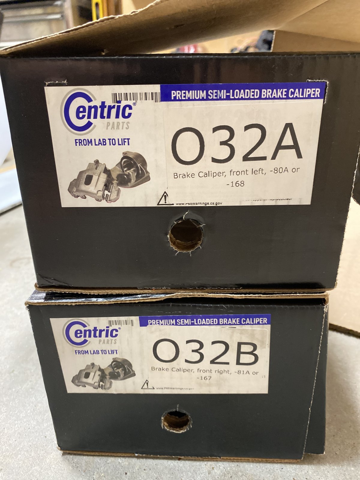

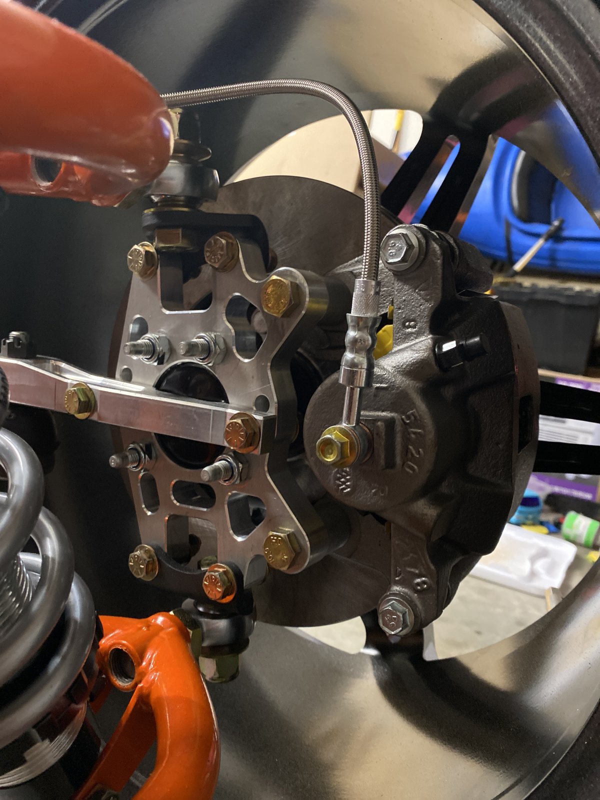

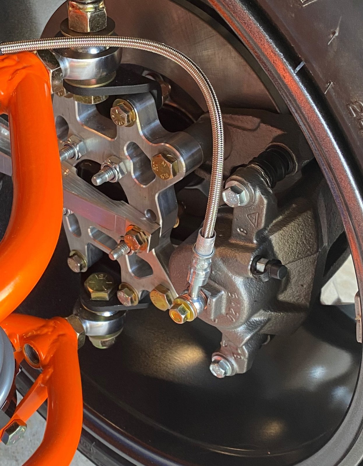

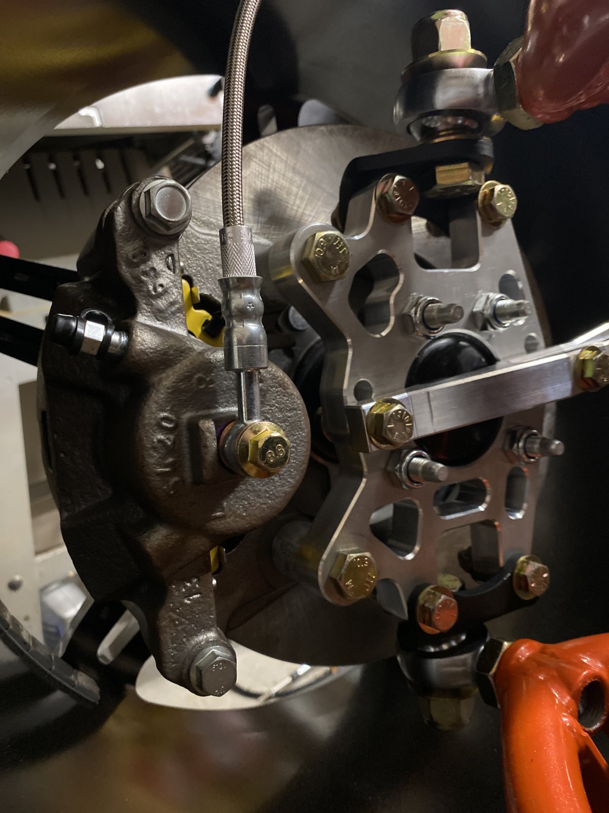

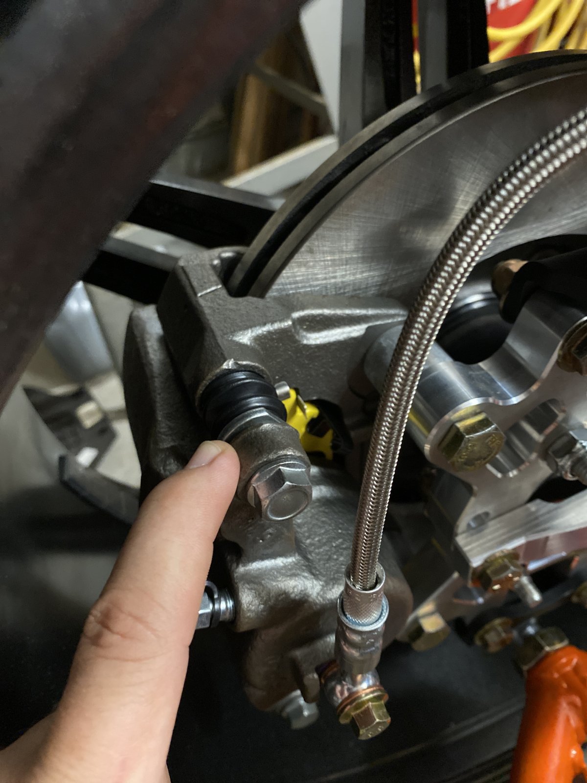

One question for everyone. I put my front pads in last night, just doing some little things, and I found out that one of my calipers (driver's side) has 12mm head bolts on both ends of the caliper and one (passenger side) had a 14mm on the top by the bleeder valve and a 13mm on the bottom. The one that had different sized heads was very tight with the pads in. It was like the sliding rod was bottoming out in the caliper. I thought I did something wrong, but they are the same number and they have the same pads in them. You can tell in the pictures that the heads are different. Anyone ever seen anything like this?
Something looks off, like they are not the same caliper. They should match, with the only difference being reversed for each side.
the bolt head being difference is not the end of the world, but the threads and shaft sizes should be the same on all 4.
SACTX
@Lonny Those are old pictures.
These are new pictures. I’ve already flipped them. The guys caught my mistake a while ago.
The part that I’m pointing at is where it would not push all the way in to allow the caliper to go all the way back into position. I had to push VERY hard to get it on with the pads in place. They are both stamped similarly but not identically. They are both stamped 5420 behind the main piston but one is marked 1688 on the side and the other is marked 2178.
I did them one at a time so I did not compare the rods.

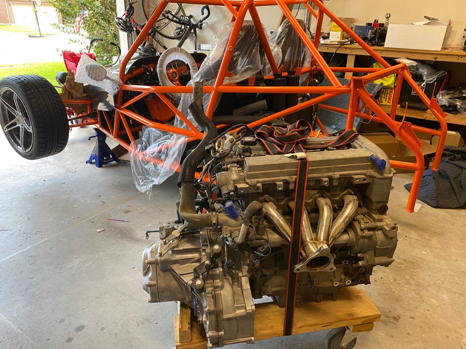

2 week update..

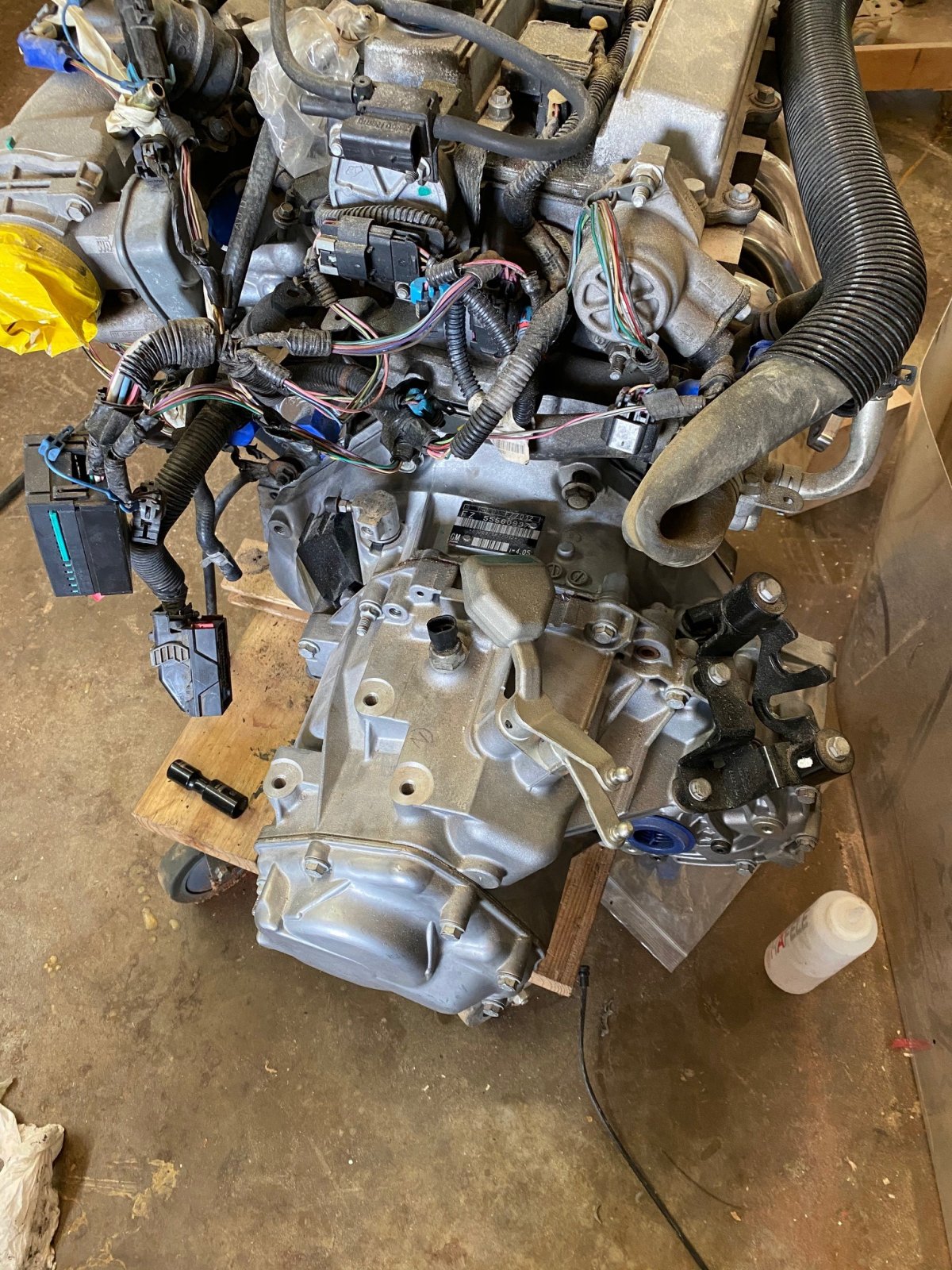

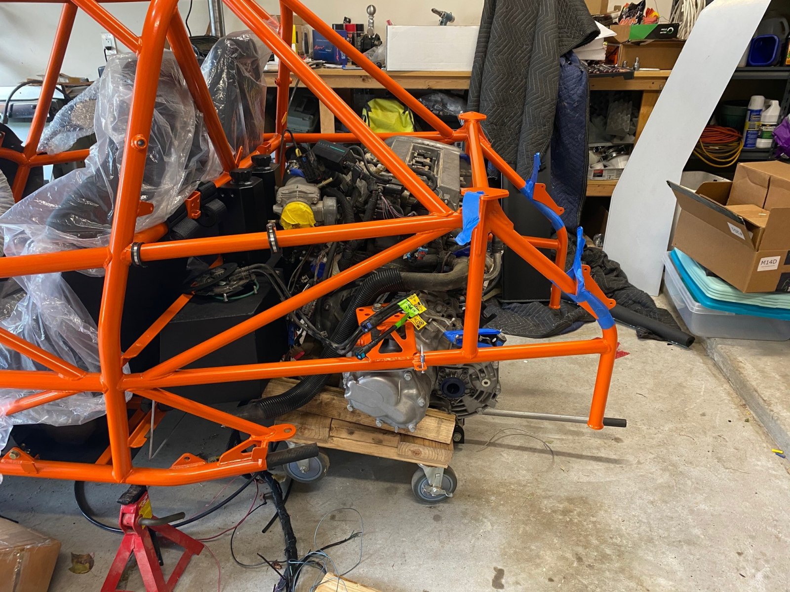

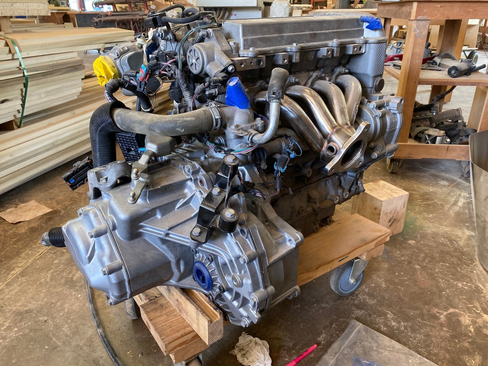

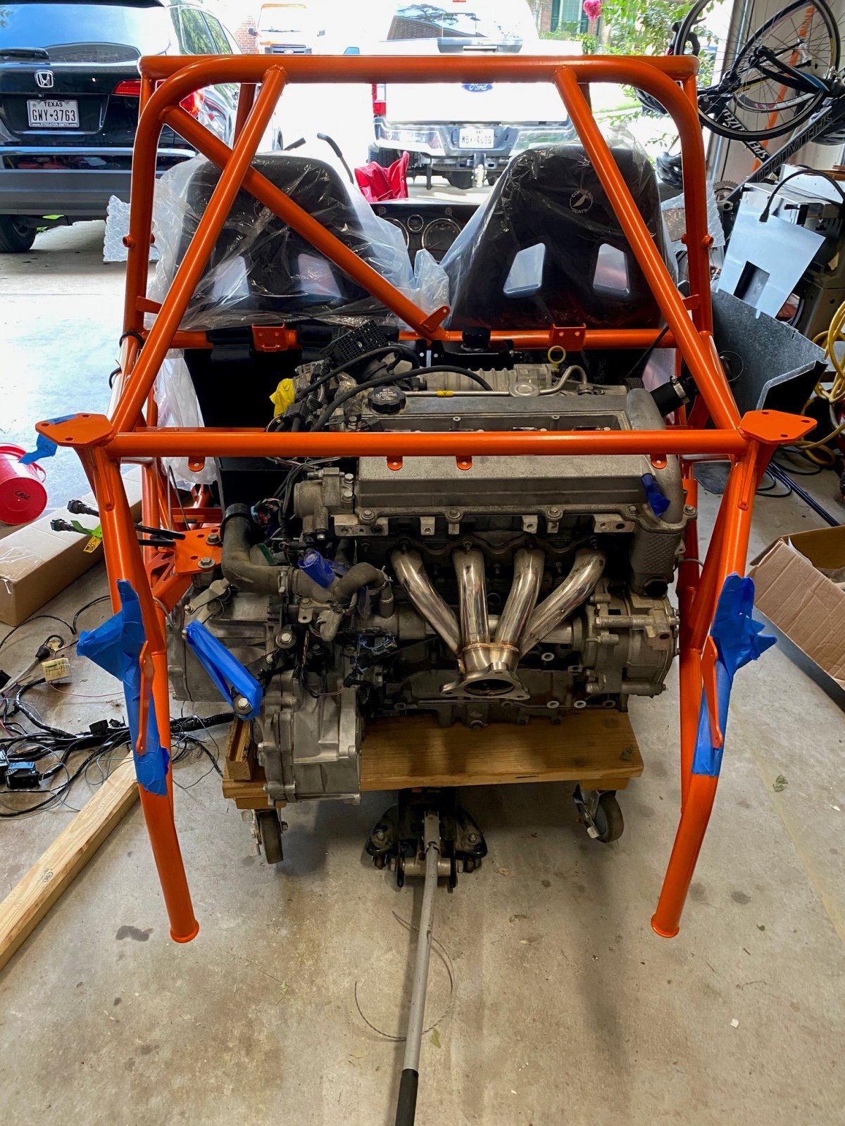

We got the transmission installed to the motor last week. Yesterday evening Alan and I got the motor in the back. I was able to set the motor in the car pretty much by myself with Alan running on both sides to pull and place jackstands. A low profile floor jack, good dolly, an able helper, and a good plan....
We're on to running hoses and hooking up the fusebox. I have a few little things that I'm wanting to clean up on the front (correct toe ends, wiring to clean up, etc) and I need to modify the clutch tower because it's hitting the hood. We're waiting on a few things from DF and hopefully we'll be moving on those things quickly.
I've been working on some other misc items and changes.

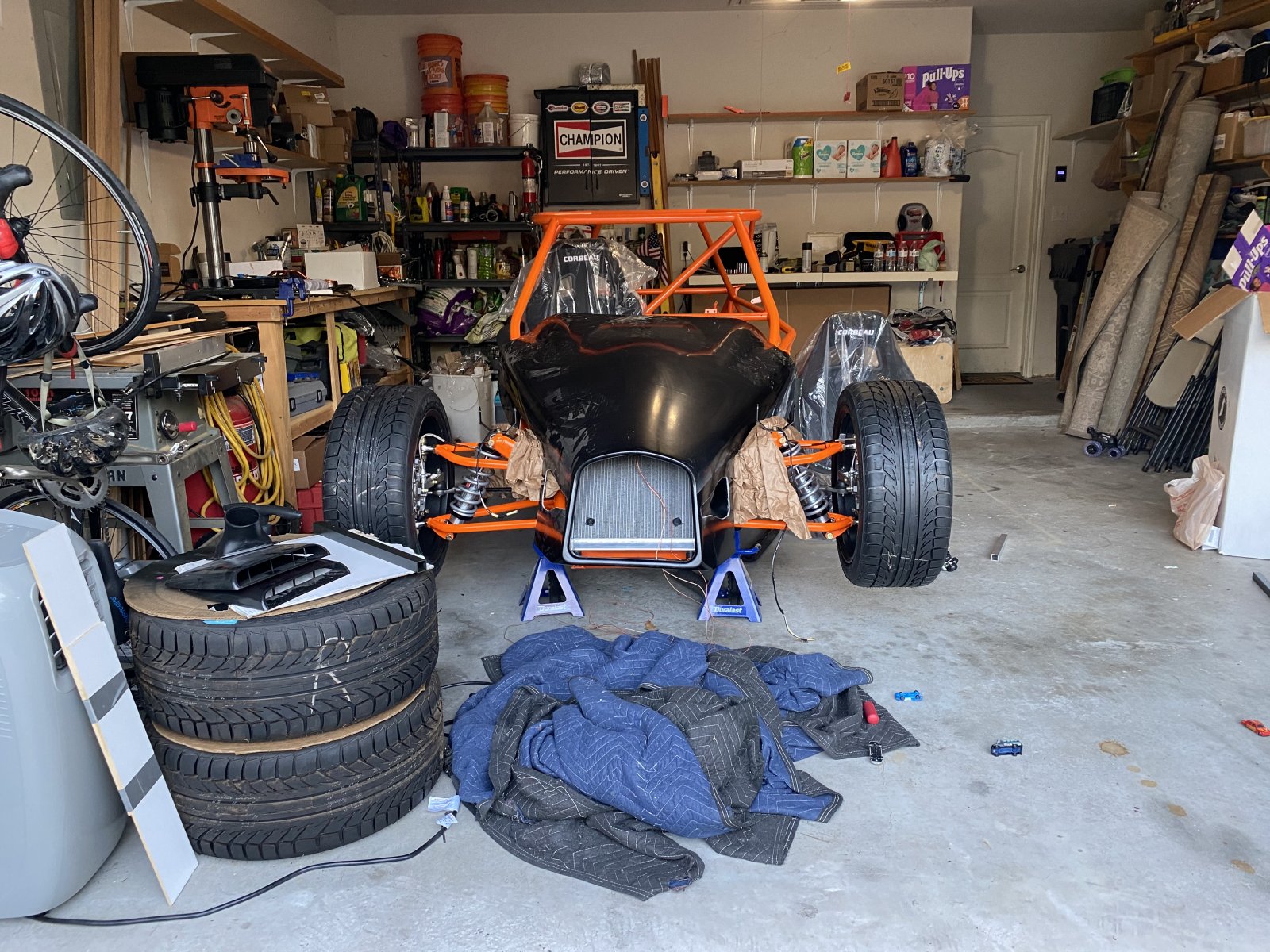

- I have the final design for the front splitter and side skirts and they are cutout and ready for install. I have to get the car off the jackstands to install them.
- I'm working on a rear pan under the motor with a built in diffuser but I need the subframe installed to finalize it. More to come on this...

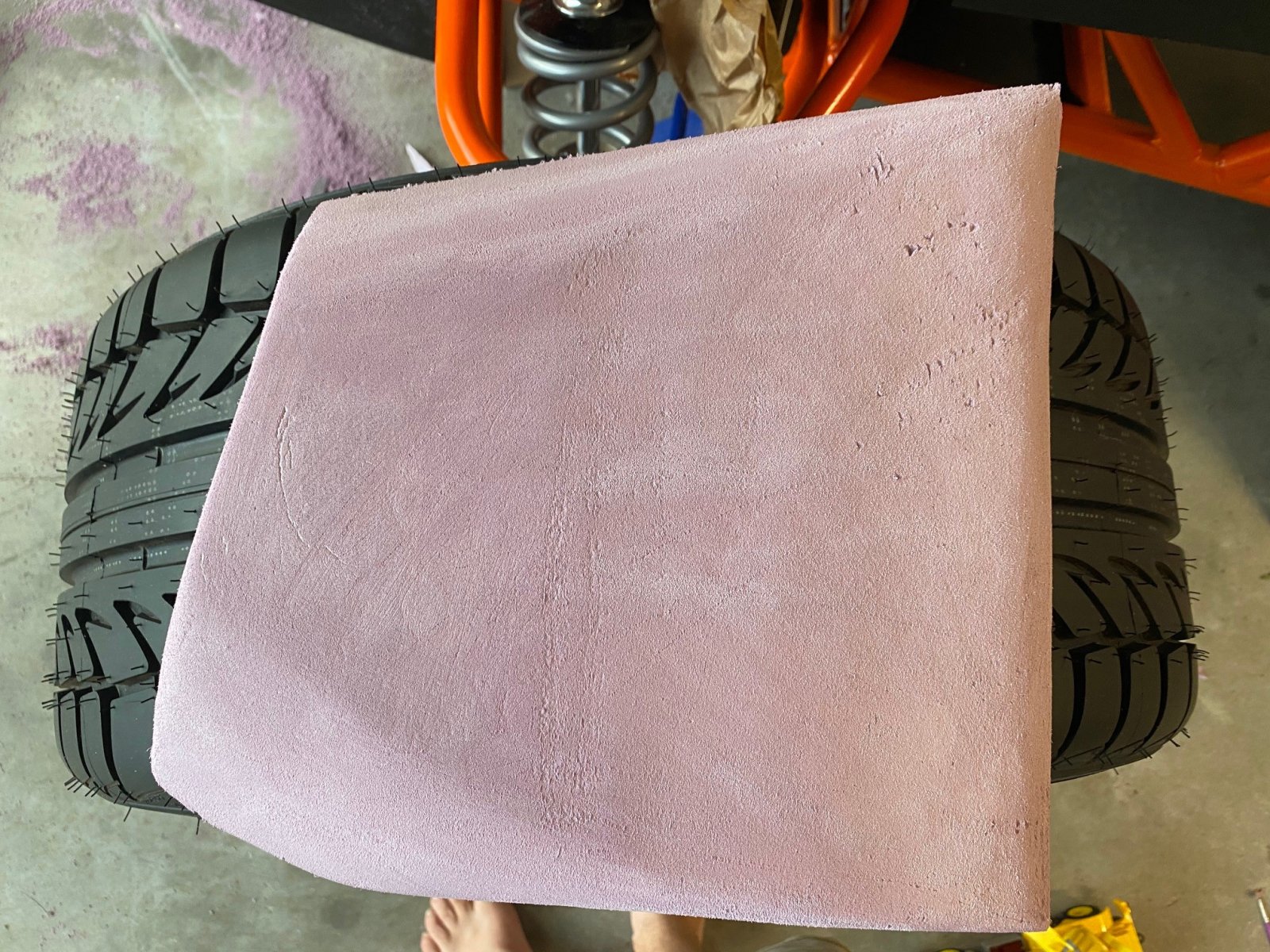

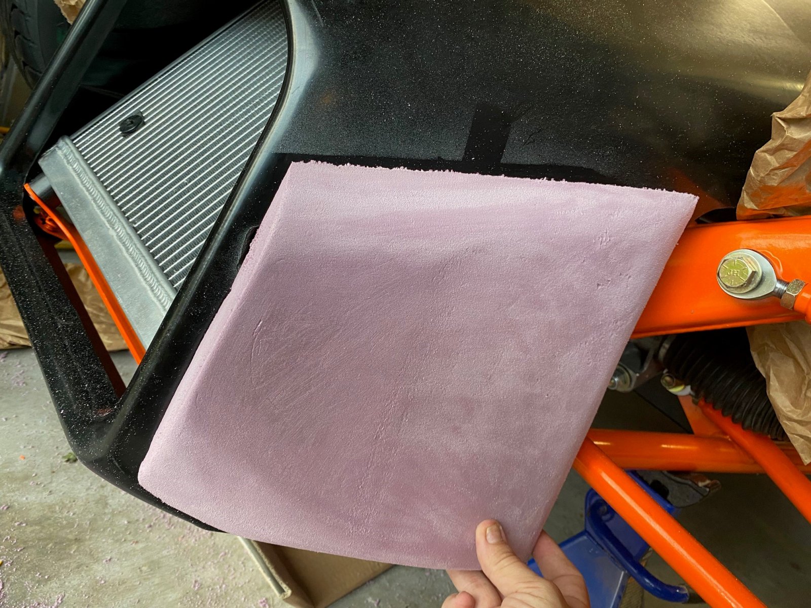

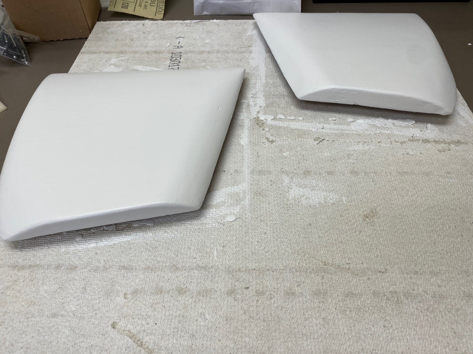

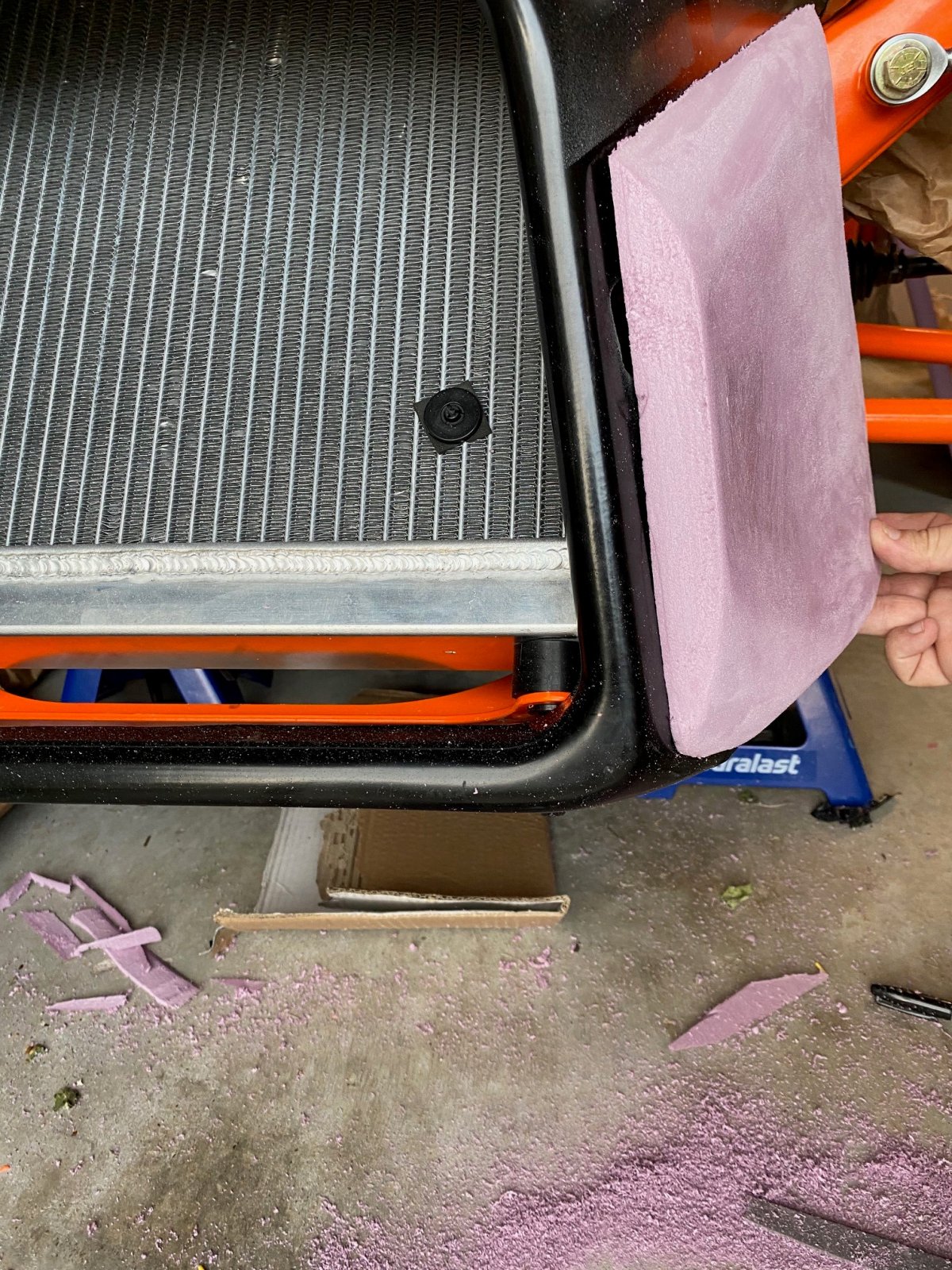

- I also have some scoops that I'm going to form in fiberglass to cover the intercooler duct cutouts. These pictures are of the foam plugs for the forms that are out of Pink Panther hard insulation. Plaster molds are next and then I'll lay fiberglass....
-I've worked on some side scoops and a scoop for the remote oil cooler that'll be going in the back. More pics for these things are coming soon.
-PCI Rear wing is here and I'm going to be fabbing some small mounting brackets for it once I get the upper wing mounting brackets from DF. I got the Black 60" version and it's pretty nice. It took a while to get but it's a quality piece.
A bunch of little things waiting on a few big things and a few big things waiting on even fewer little things but it's coming along.
Thanks!
