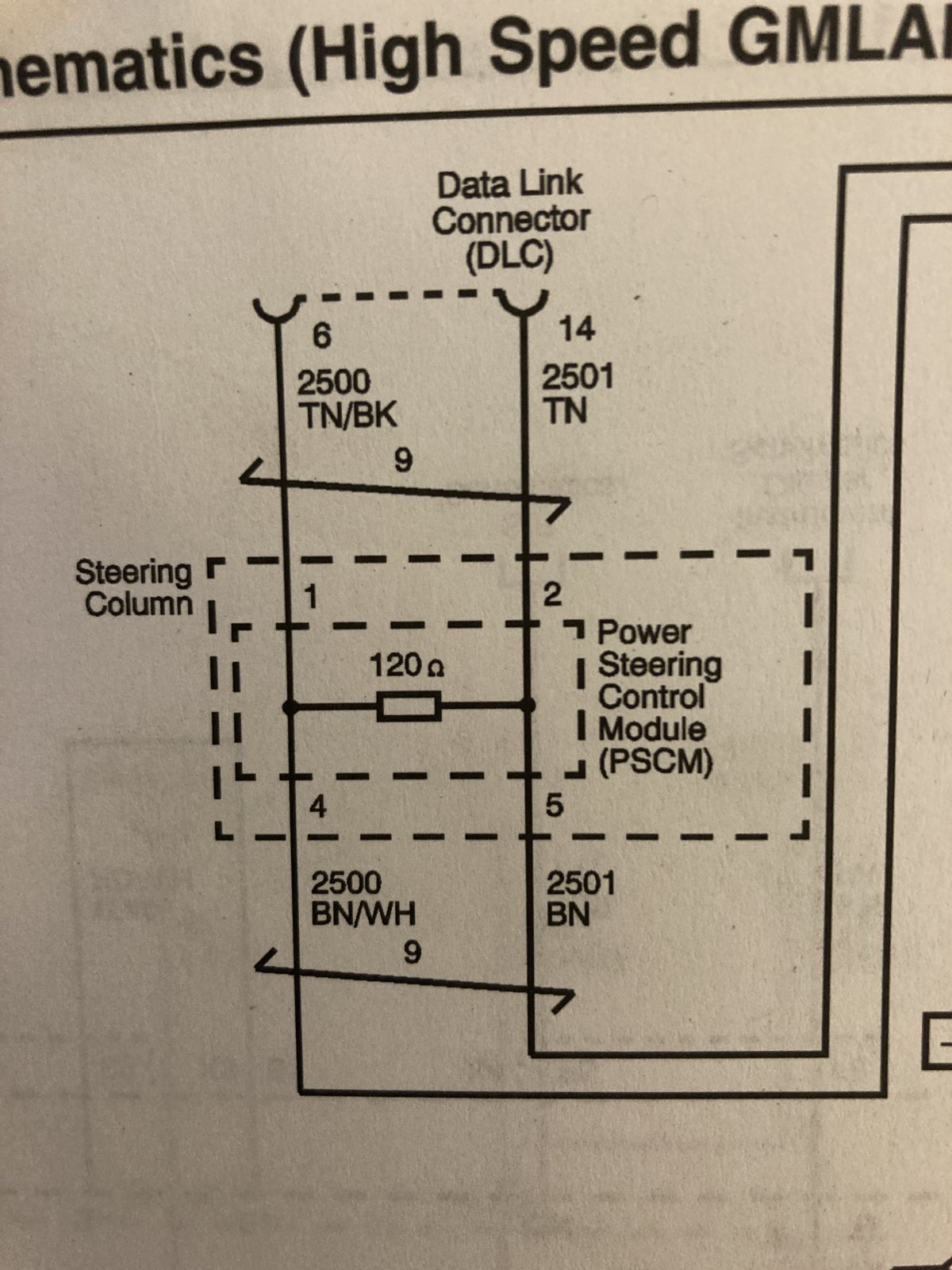

Installed the Saturn Vue power steering unit and I’m running into the loss of data communication problem. Research on here indicates I should be able to install A 120ohm resistor on the data wires. It looks like I will connect wires 1/4 and 2/5 together and then connect the pairs with a 120ohm resistor per the picture? 2009 TC donor.

The 120ohm resistor is for the end of the line of the serial data. 1/4 and 2/5 should be already connected inside the PSCM to allow communication using the DLC (OBDII port). If they aren't connected, it's not going to have an effect on the PSCM but the DLC won't work. I'll bet the communication issue it the ECM or BCM is expecting a particular PSCM and you have installed a different one.
Yes it won’t communicate plugged into the Saturn Vue PSCM. The Saturn Vue one doesn’t need to be tied in using the variable control with it. I’m trying to get the rest of the car to communicate without than original plug connected. It’s mentioned here
I'm surprised the BCM is okay without being able to communicate with it once it's removed. Yes, adding the 120ohm resistors terminate the end of the line so there is no reflection. You will want to connect the pairs as stated before so the DLC port still works.

I put a 120 ohm resistor between 1 & 4, and a second 120ohm resistor between 2 &5. I did not tie the two together.
All my data seems to be working correctly.
I've got some resistors ordered so I guess I'll see if I can get it to work. From my reading up on it, I think I should be connecting it up like my first plan. According to the literature I found, I should be connecting the GMLAN + (aka as High) circuit 2500 and GMLAN - (aka as Low) circuit 2501 with the 120ohm resistor. I'll see if a can measure the resistance across the pins on the PSCM and see if that matches. Judging from wiring diagram, pins 1 & 4 are connected to each other and 2 & 5 are connected in the PSCM. I may have to supply power to the PSCM since the 120ohm resistor may be "switched".

The older Cobalts may have had their GMLAN components in a different order and the PSMC may have not been at the end of the chain which is where it needs the 120ohm resistor. It might even have had separate resistor that wasn't built into a module at all.
It looks like Brian74 is maybe using an 09 BCM and PCM so that may be why he had to add the resistor. I haven't read his entire build thread, but I did find where he bought the 09 modules.
The Cobalt PSCM does connect up 1/4 and 2/5 internally and are connected by a resistance of 120ohms. I’ve connected the wiring this way and I get the 60ohms resistance at the DLC the link I posted above says I should. Car starts as normal and no check engine light or IC readout of an issue. Now to drive it and confirm no problem and a review of how it works.
No problem on the drives and my OBD2 speedometer worked so I think the 120ohm resistor connecting 1/4 to 2/5 is the correct way to go.
