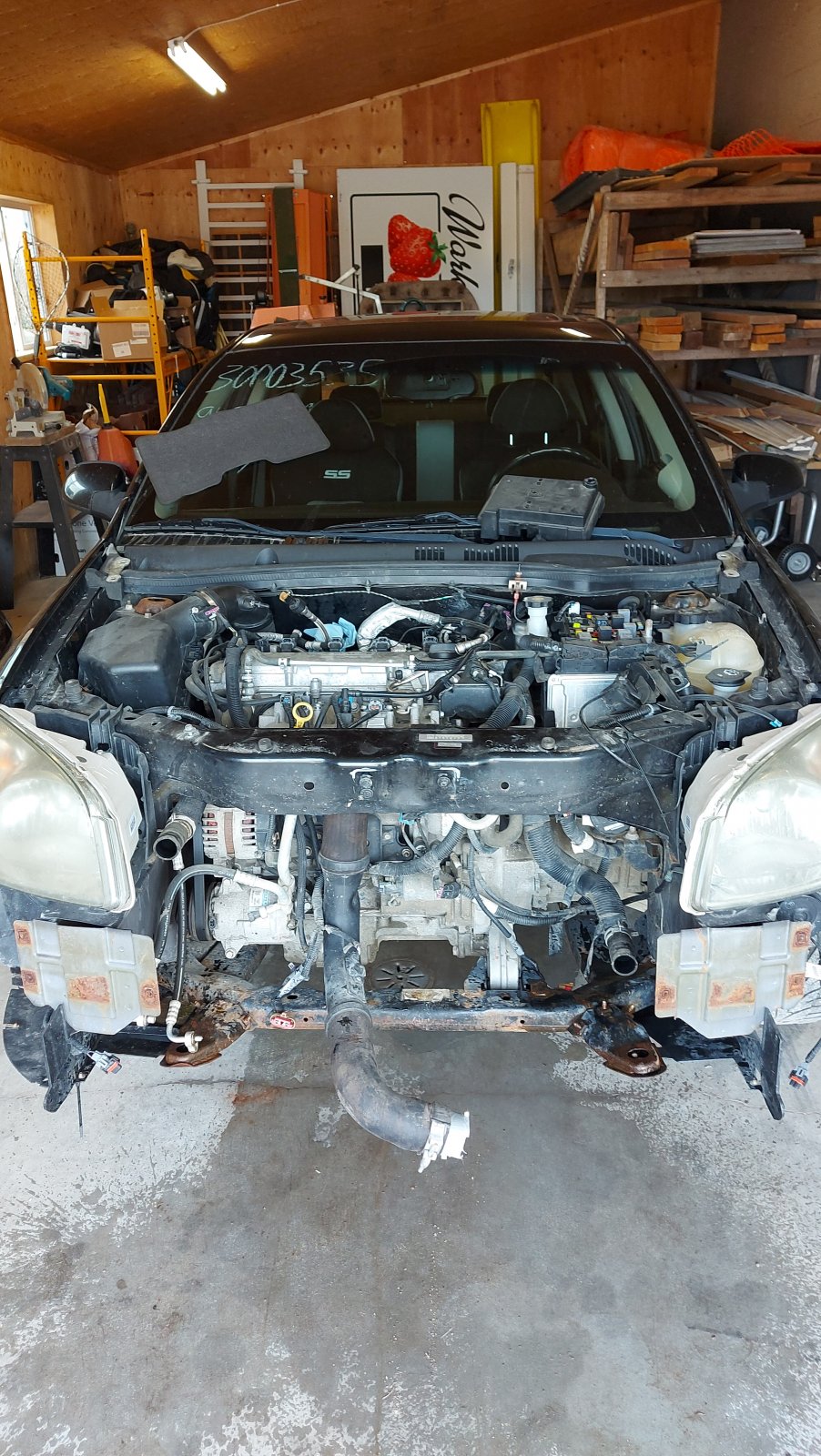

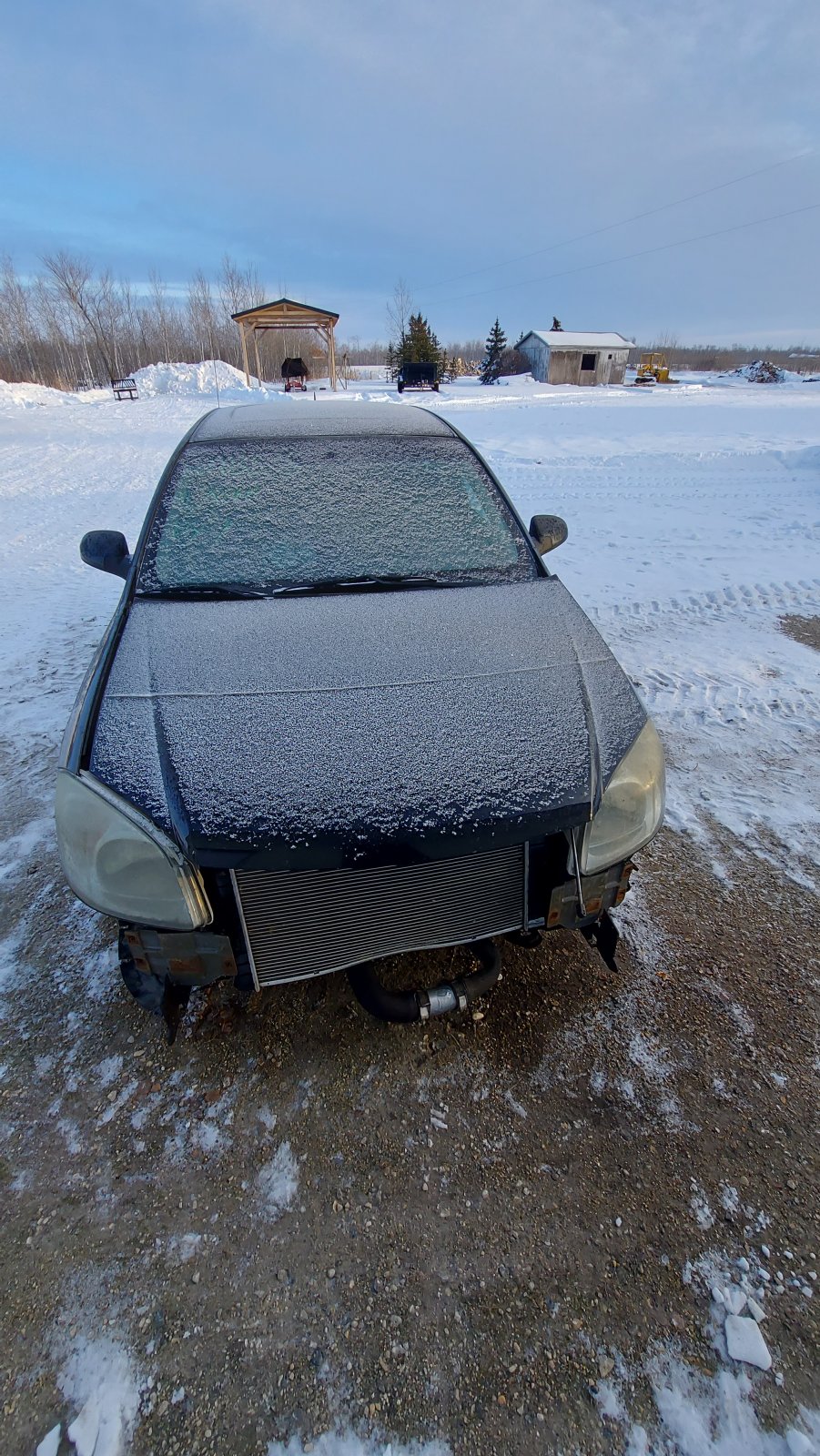

Hello fellow builders! I've been working on my build for the last couple of months and figured its high time to start my build log. My name is Scott, im a 23 year old mechanical Engineering student who loves racecars/bikes and all things mechanics. Me and my father stumbled across the DF Goblin at a parade in a nearby town. This was ManDan1957 build which I believe was the first one in MB (we will be the second). My father and I were very attracted to the idea of a homemade lightweight rear wheel drive racecar. It was also good to know that there is a lot of guidance available through both the videos and the forum on the construction. After a couple months of research and discussion we decided to pull the trigger on the build and start looking into doners.

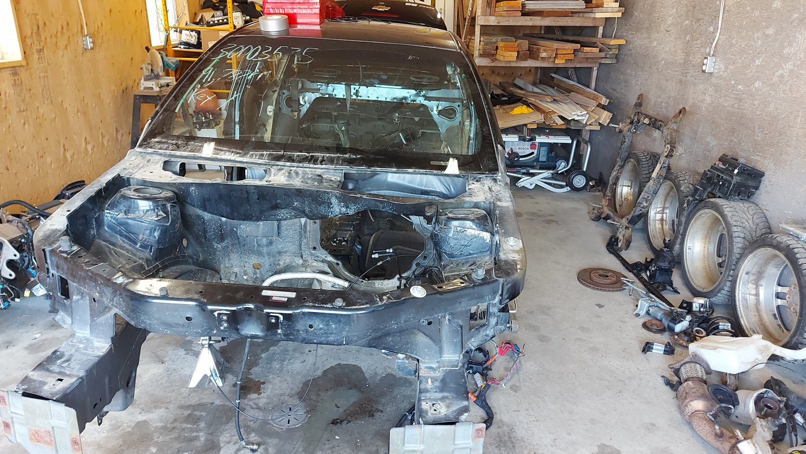

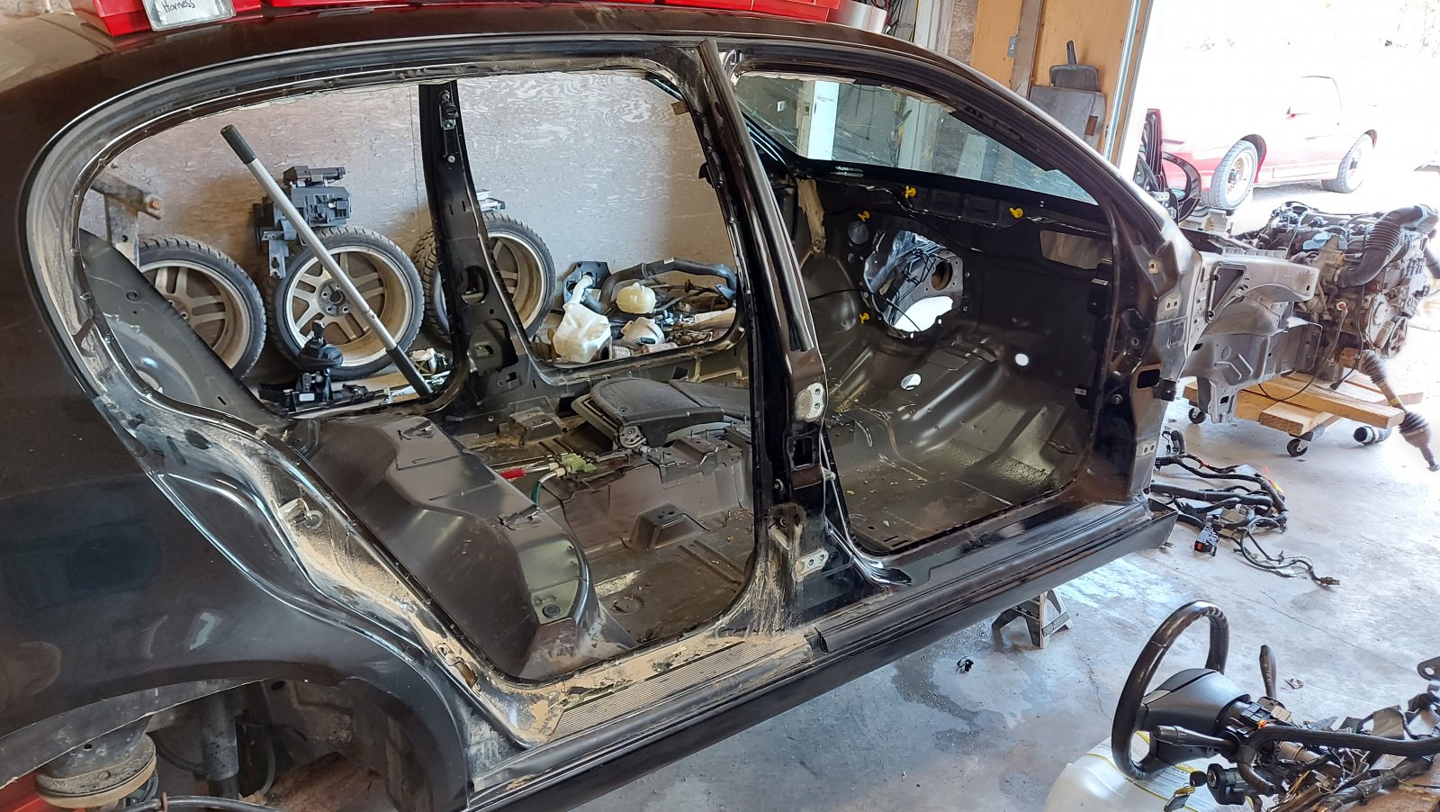

Late winter, I found the perfect doner at auction in Saskatchewan. A 2009 Cobalt SS/TC with only 91,000km that was in a minor front end collision. Won the bid at $1,200, got it home and began working on it in my free time to get it running. After some very backyard mechanics and lots of duct tape she was running strong! April I began with the tear down process and early June I started re-working the harness. Ill include a few pictures below. After dealing with some issues getting our kit across the border (due to missing paperwork) we finally brought out kit home last week. That same day, we dropped the chassis off at our painters place and it should be done by next week. For chassis color, we decided to go with a candy apple red with metallic flake. We are going with full panels that we are planning on wrapping either matte black or possibly matte carbon. Hopefully once we get the wing, seats and wheels it should end up being a pretty aggressive set up. We plan on registering the car for road use and could possibly end up taking it to an autocross event eventually.

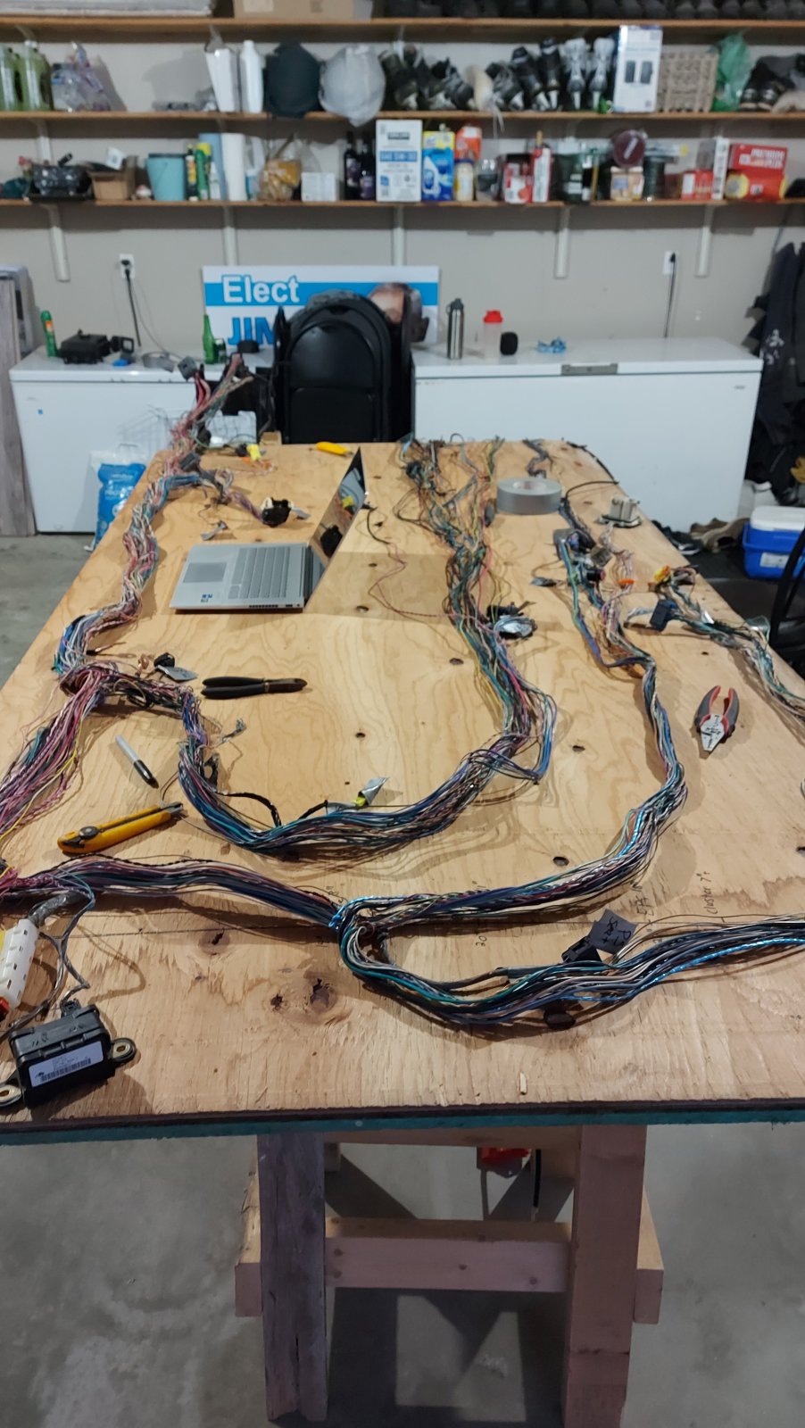

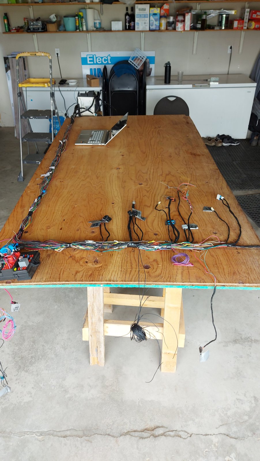

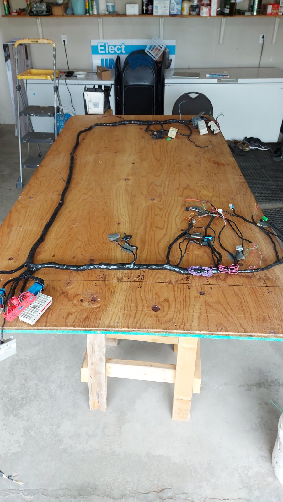

This afternoon I pretty much finished with the wiring! All I have left is to test my grounds and tape up the harness and it should be ready to install. In order to pass inspection in Manitoba I believe I will need to keep a functioning windshield washer unfortunately. For those of you that are in the same boat, did you find it easier to keep the factory system & wiring or did you add something aftermarket after finishing the harness?

Wrapped up the wiring harness, hopefully everything works first try

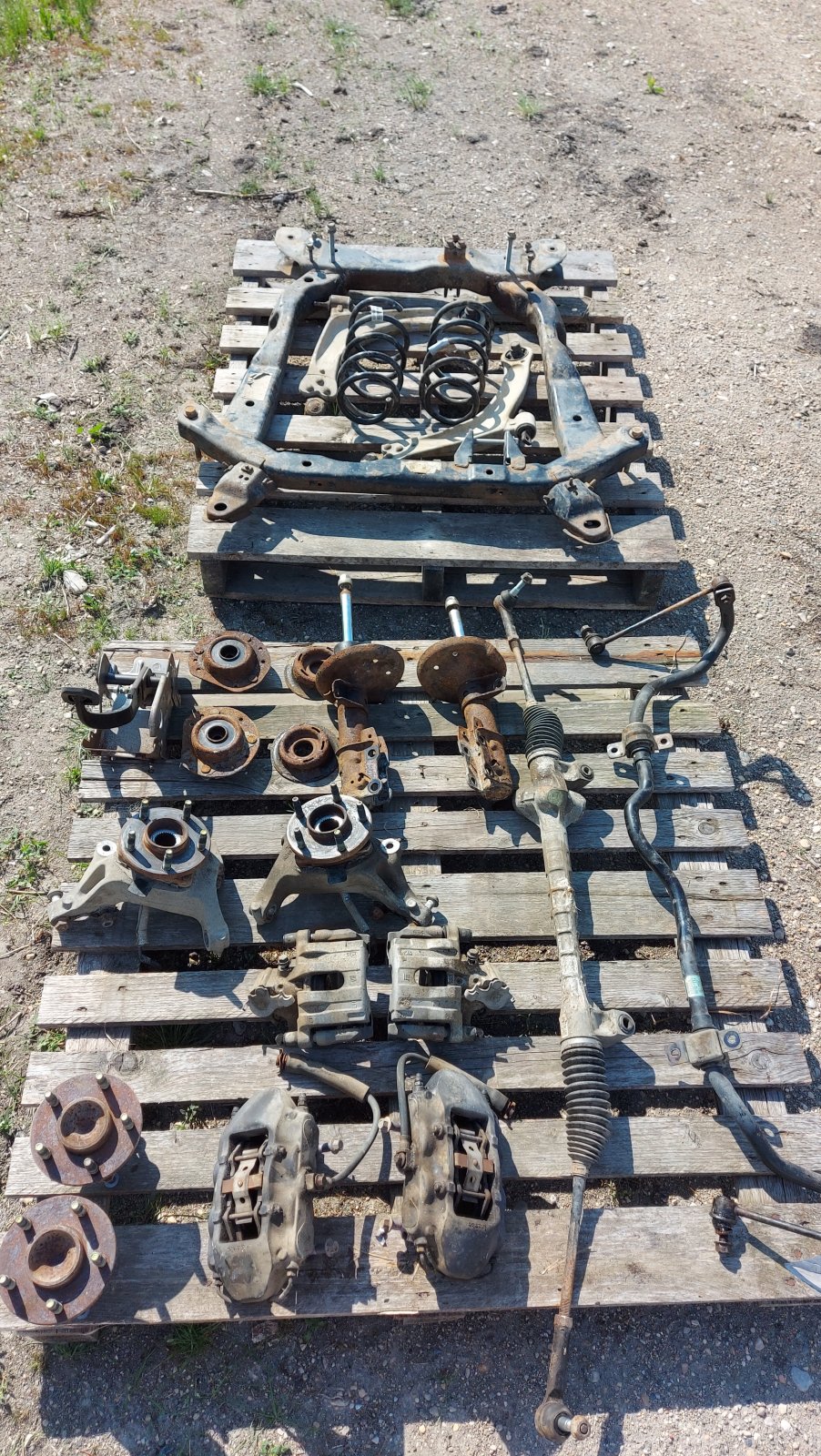

Prepped some parts for spray painting. Struts are pretty rusty and rough, was thinking of getting them sandblasted to get a better paint surface. I'd prefer not to buy new ones to save a couple bucks.

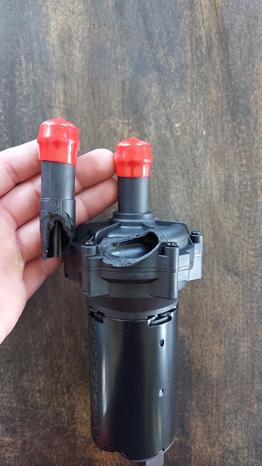

Went through all my boxes of parts and found my intercooler water pump broke in transit . DF is working on getting me a new one thankfully.

If buy shocks you mean struts, they can be bought cheap on rock auto for the off brand. And I would think new off brand is probably better than wore out name brand.
DUNE
Yes thanks I did mean struts. I just looked it up and I can find a nice set for ~$150 which is less than I expected. I might just go that route

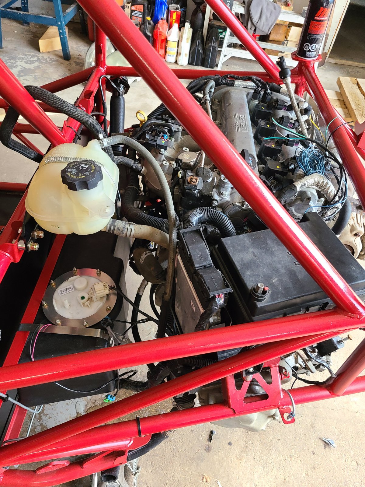

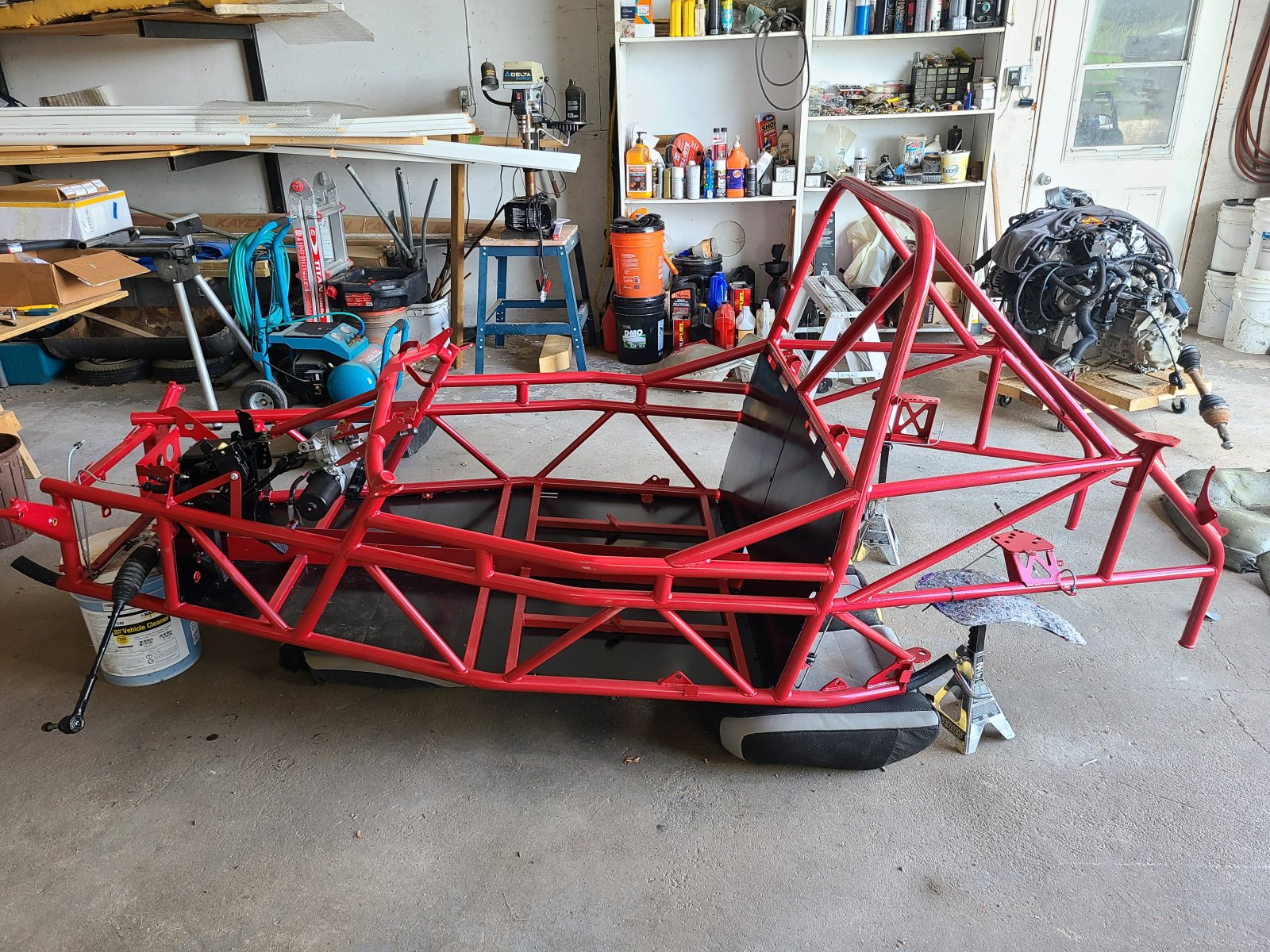

Since my last update I've made some fair progress

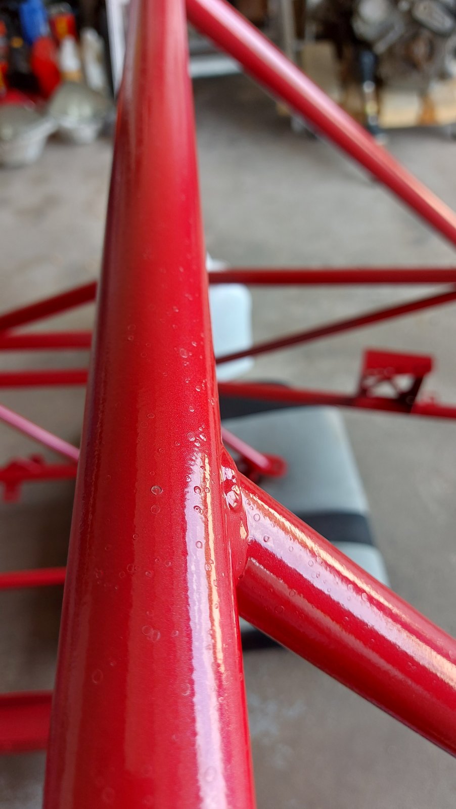

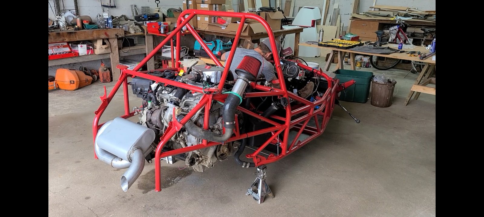

Chassis came back from paint early last week and if I'm being honest, I'm a little disappointed in the finish. The color is close enough to what I was picturing but there looks to be lots of little drop marks in the paint especially on the top of the roll cage as well as some areas having pretty noticeable overspray. This will be something I would like fix in the future. Ill include a picture below.

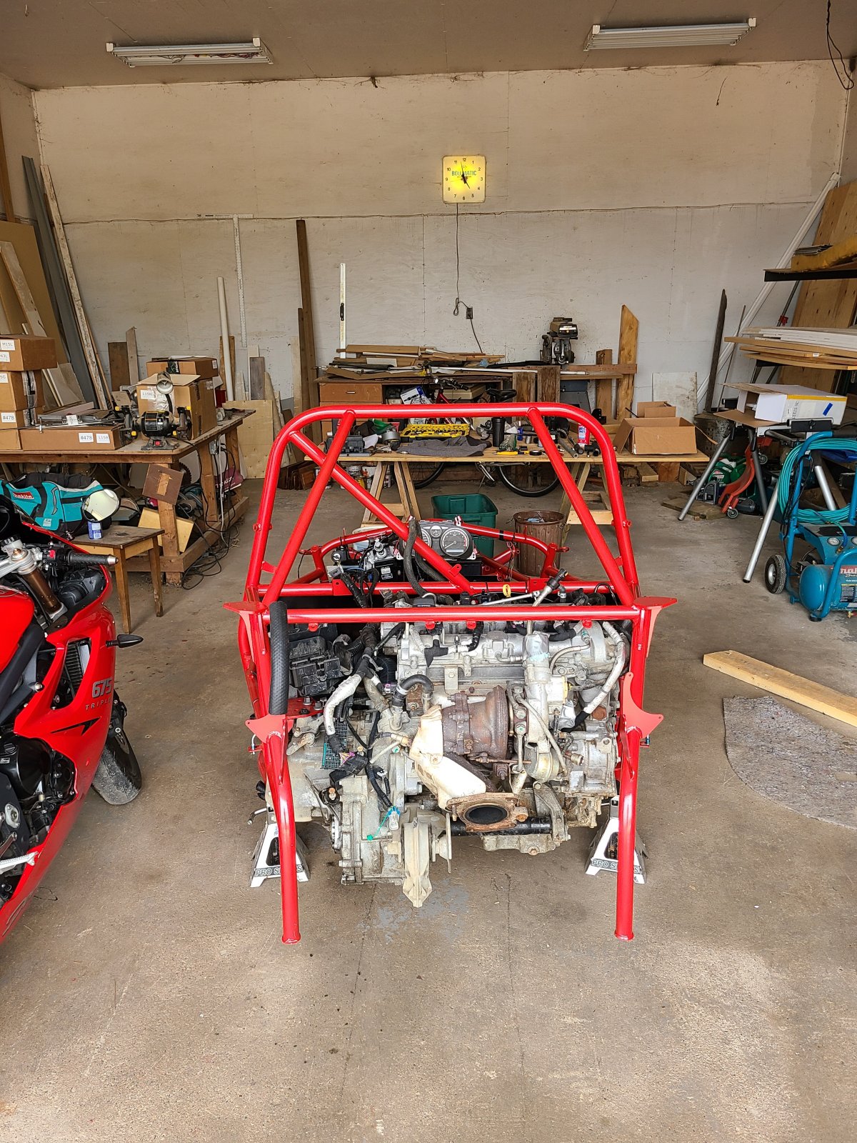

Got all of the front end components in with no issues. Rad, pedals, brake booster, power steering, ignition then the wiring harness all went very smoothly minus my steering rack limiter kit not being included in any of the stage one boxes as far as I could see.
Just this afternoon I got the engine and fuse box installed and fully hooked up. A few more coolant and radiator hoses to hook up then I should be just about ready for my first start! I'm getting near the end of the content that the videos covers so this next weeks progress will likely involve a lot more research and forum searching for guidance. Just today I found the helpful photo albums that Adam posted a while ago which should be really handy going forward. This next week I am hoping to get it running and wrap up stage 1 so I can start figuring out stage 2!

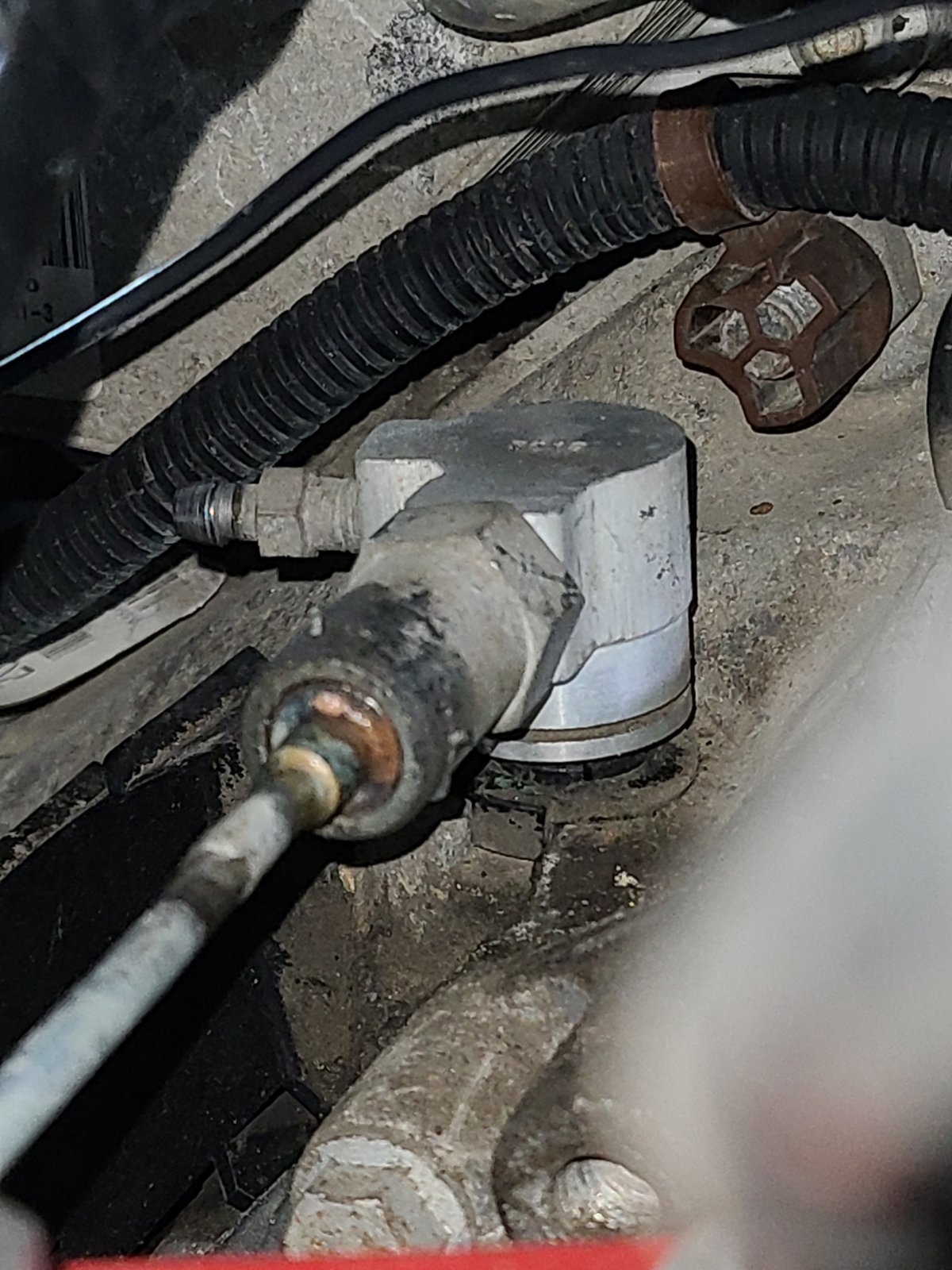

I haven't found any videos or posts that clearly show how the metal clutch line hooks into the transmission. Does someone have a picture of that?

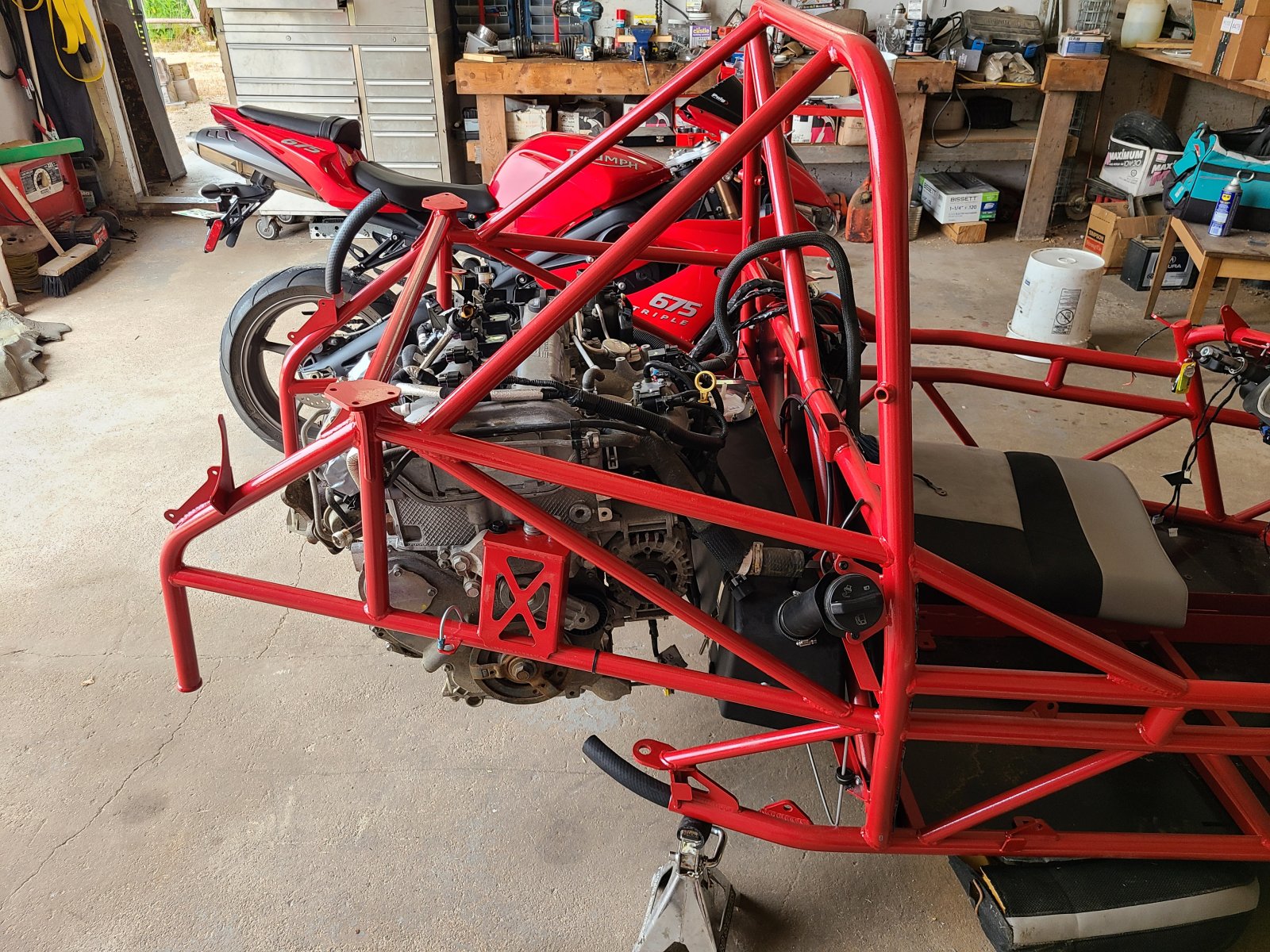

Today I cut up some of the factory intake and intercooler tubing to piece together the parts that are on backorder through DF. It does not look pretty and I definitely wouldn't trust it on the road, but it will do for a first start. After that I filled coolant, primed the fuel pump and tuned the key. Aaaand nothing happened. I could hear the fuel pump kick in but the starter didn't engage. When that didn't work, I pulled the starter relay and jumped the terminals with a wire and it fired up right away! Tomorrow ill pick up a new relay and hope that solves that issue. One more hurdle down on the way to a complete Goblin race car and I am thrilled to hear the engine alive and purring! Now with that out of the way tomorrow Ill begin working on the front suspension.
While I was working on the engine, I noticed that my clutch distribution block has loosed noticeably from the transmission and wiggles freely when moved by hand. I assume this is not a good thing, but how large of a issue is this?
