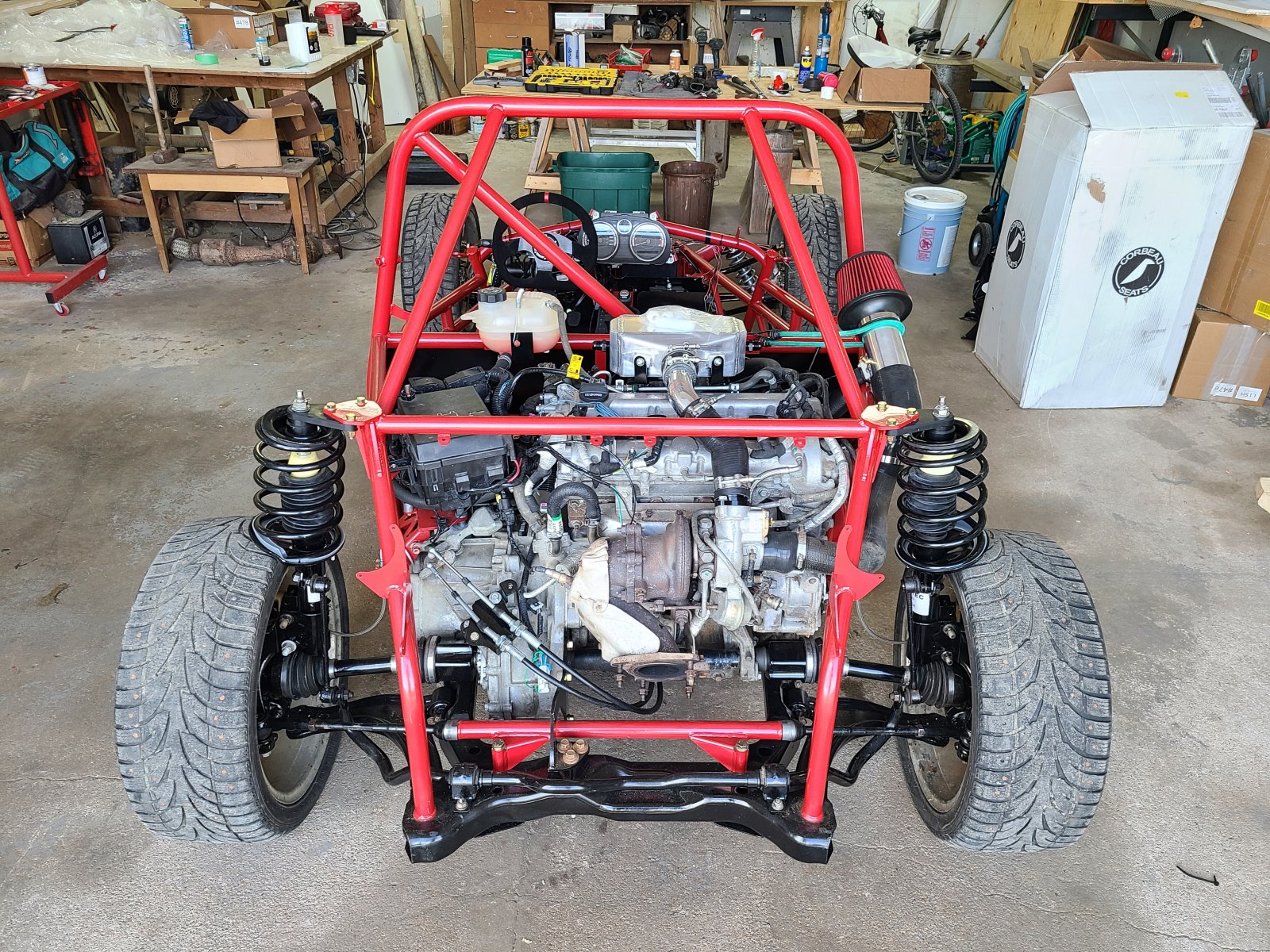

Finished up with the rear suspension, transmission lines and bleeding the clutch (thankfully the loose distribution block diddnt cause any troubles). Took it for a first spin yesterday and I am immediately in love with the sounds this car makes. Last major mechanical jobs that need to be done are intercooler waiter pump and parking brake. I will have to peruse the forum to figure out how the parking brake hooks up as well as where to route the intercooler plumbing around the engine.
Now I've started to put more thoughts towards the cosmetics parts of the build including a wing. For those of you who are running the NRG carbon wing, how much modifications was required to make it work? I love the look of this wing and it's right in my price range.

Don't know about routing, but highly suggest using a different cooler coolant for the intercooler system. Makes it easier if there is a leak to determine which coolant system is leaking.
Parking Brake - This is one of the more difficult tasks IMO. I think it may be best to connect them in the rear at the brake then see how to route them to the lever. There is a pic showing a distance from the rear firewall to mount the lever, but there may be some tolerances you can take advantage of if you need to.

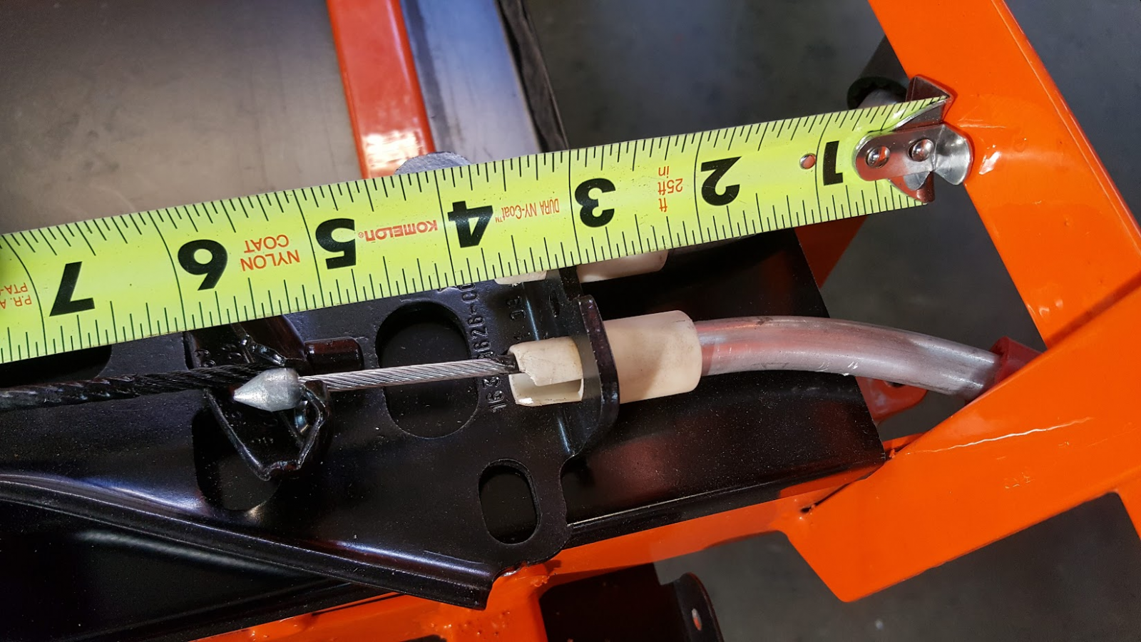

Save the parking brake handle, cables and cable tubes.
I trimmed the sides of the parking brake handle mount. Made the mistake of putting it too close to the rear firewall, and ended up moving it as far forward as I could, but still not interfere with the shifter.
Pic of my rear brake caliper here.
More pictures of rear calipers in this thread.

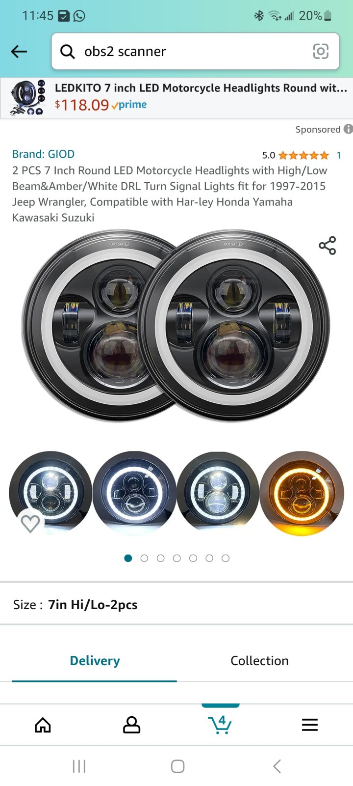

Just ordered in some headlights and a OBDII reader that will let me track live engine data and well as some electrical connectors for lights that I saw someone else on the forum here using. Pretty excited for those to come in. Anyone here have some experience with these style of lights?

I've got the same or similar. Low beams are pretty dang good. High beams don't add much. I have the yellow LED running as DRL/turn signal and white for parking lights, but I believe with an '09 donor you won't get the same arrangement. '07+ use the high beams at half voltage for DRLs and have a dedicated fuse you can pull to disable, while '06 and earlier run the turn signal high bulbs as DRL. Both use the turn signal low bulbs as parking lights. I'm not sure what your style DRL would do to the high beams in these headlights.

I have the same ones, got them mounted but haven't wired them up yet
41894
Just noticed the ones you showed were 7". mine are 5-3/4"
