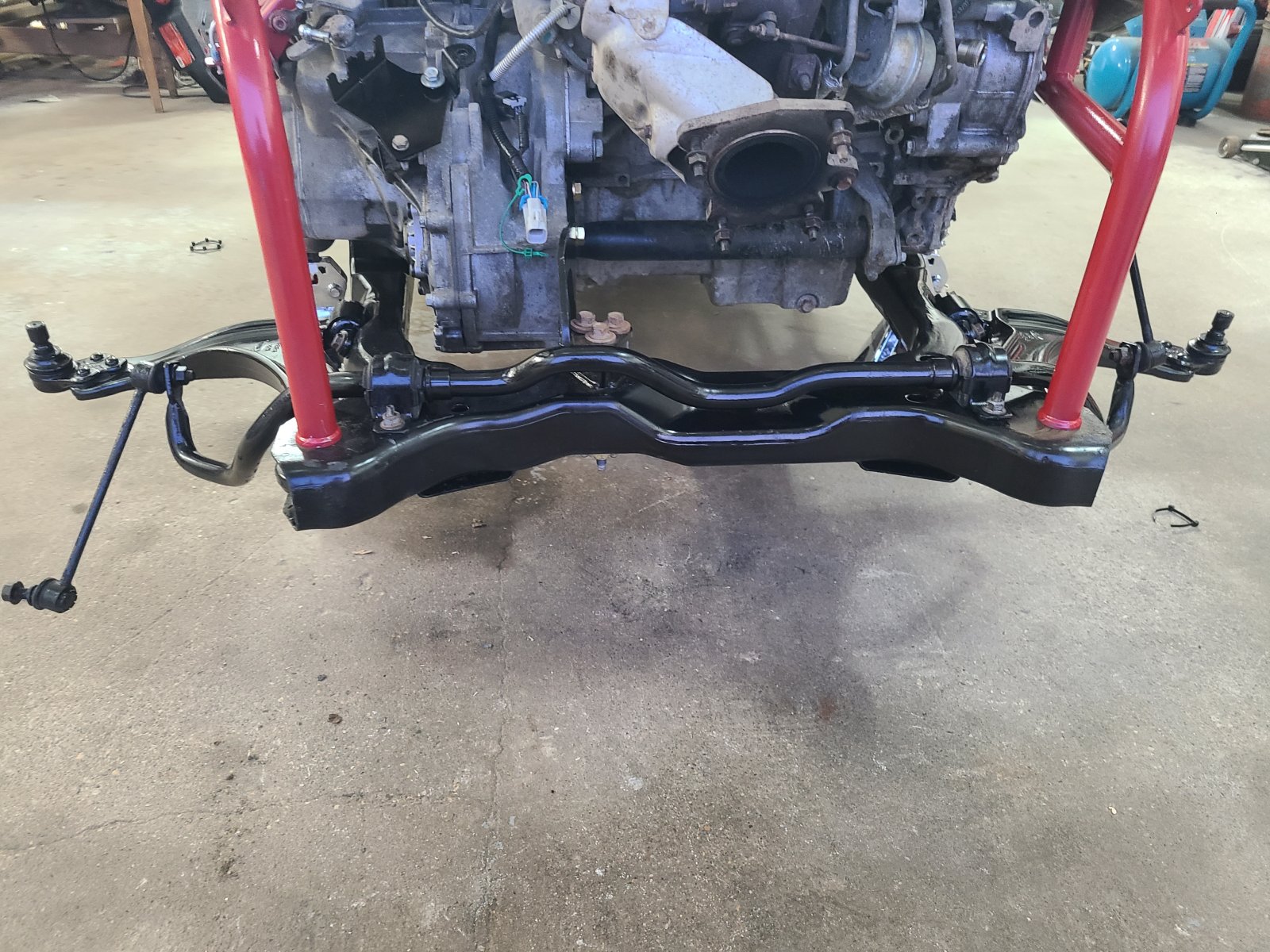

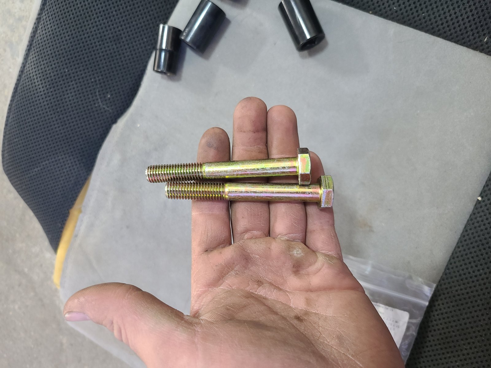

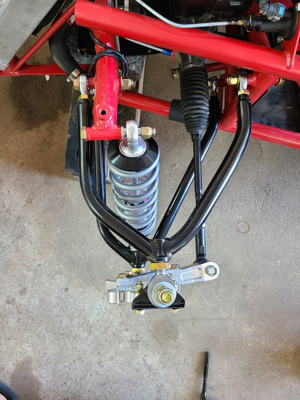

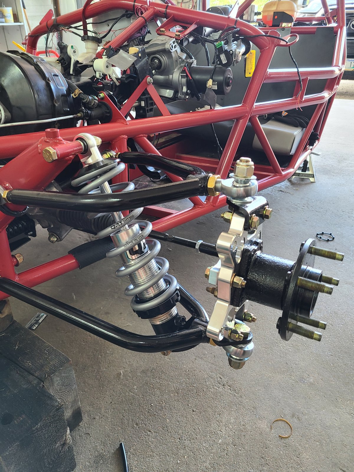

Got a couple other things done yesterday night as well. Front suspension is fully hooked up and I believe I did it correctly, feel free to correct me if you notice any issues. Got the subframe, control arms and sway bar installed. The rearmost bolts were pretty difficult to get in properly (especially doing it solo) but I made it work. Once I was done installing the subframe though, I noticed that I had two bolts leftover. Does anyone recall where these were supposed to go? I used the donor bolts to mount the subframe to the engine & chassis

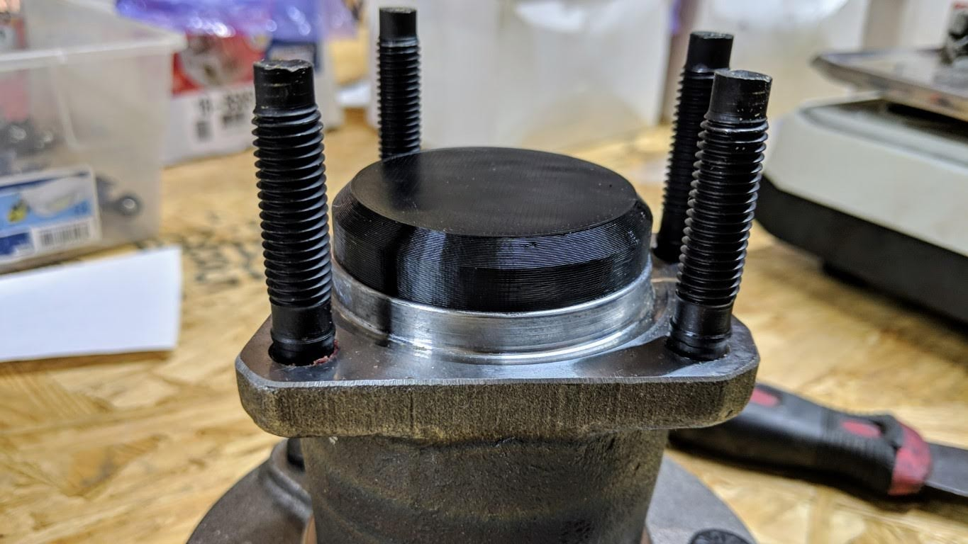

DF sells a 3D printed cap for the back of the axles.

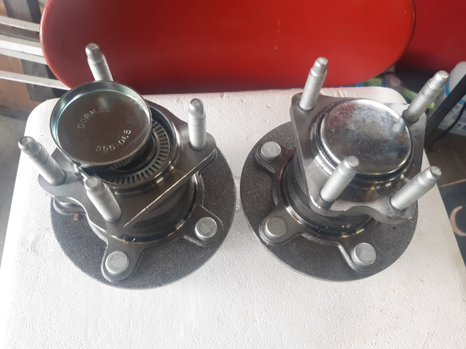

Scott used a Doorman 555-065 freeze plug.

The bolts may be the rear toe rod (steering rack replacement)? The only other place I remember bolts like those are in the front suspension and maybe steering rack.
Forgive me if this is a silly question. What's the difference between a toe and tie rod? And is this toe rod what I've been calling a sway bar?
Toe and tie are same thing, at least to me. But the sway bar is different. Toe/Tie rods control the in/out angle of the wheels as viewed from above the car (this angle is toe). In the front, its at each end of the steering rack. Since you moved the wheel knuckles from the front of the car to the back but not the steering rack, DF supplies a bar to replace the rack with toe/tie rods to allow for rear toe adjustment.

Sway bar is what you have installed in 3rd picture of post 27.

Ok then I may not have been shipped that bar. I don't believe I've seen that bar and I've been through all my boxes by this point

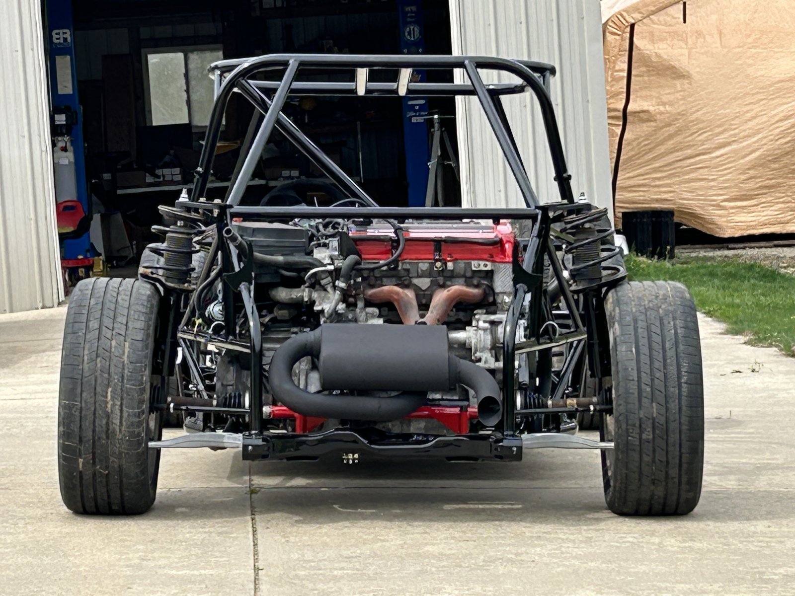

The "toe bar" comes from DF as bare steel. Mine is the red bar below the muffler here:
41641
DF also supplies new inner tie rods that you'll thread into the toe bar. The new outer tie rods go up front to the steering rack. For the rear, you'll need to reuse the outer tie rod ends from your donor to attach to the new inner tie rods. One last tip - the toe bar is easy to mount upside down. Note the angle of the gussets in the above photo to get the orientation right. Or, if you stand back and look, the whole tie rod system from wheel to wheel should be basically level.

Oh ok I found it now. I had set it aside when the kit came back from paint and forgot about it. Thanks for the tip
