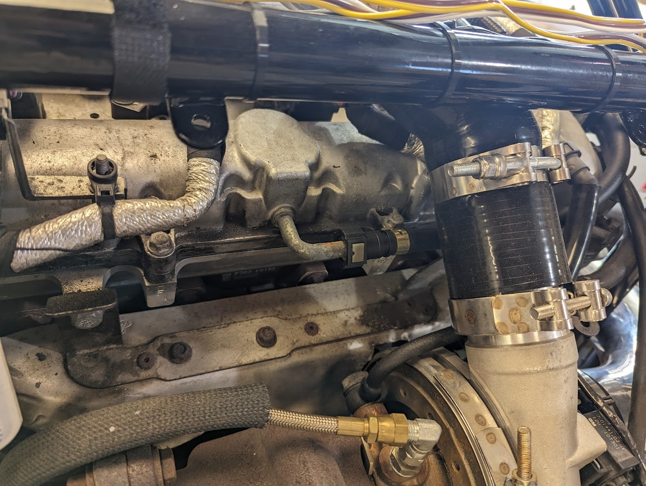

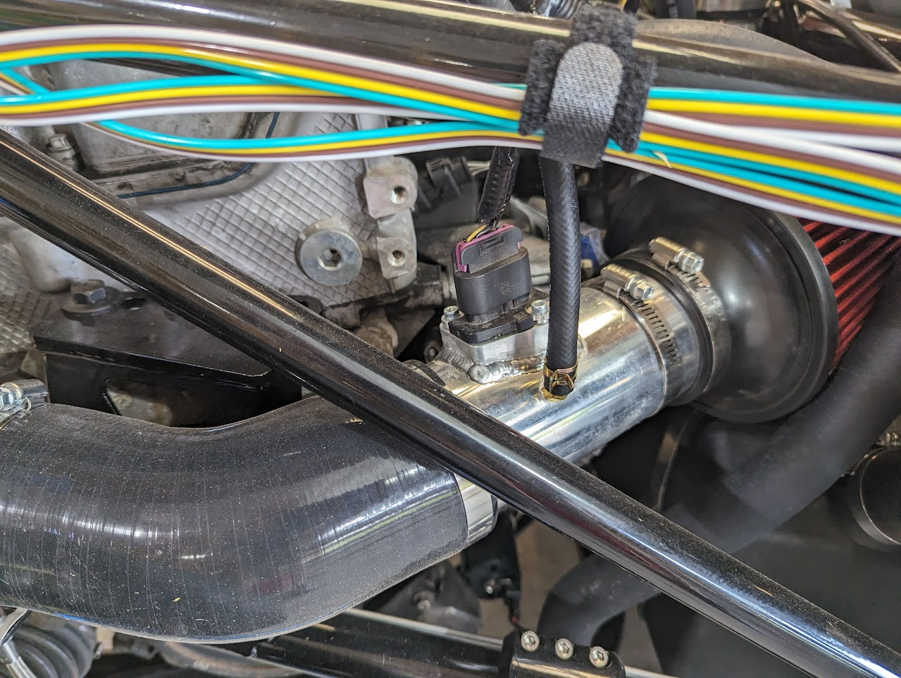

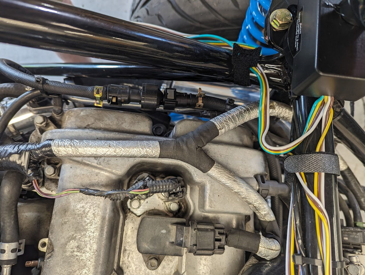

I kept the donor check valve and will use new hose (3/8?) to connect the two (old hose dry rots in the desert) - making certain the air flow arrow points toward the engine.
So you reused the braided metal line with the fuel line type connection where it connects in the engine by the turbo then just extended it with the 3/8" hose to the intake?
I took the braded line off the check valve and used new fuel line connectors and hoses on each end.

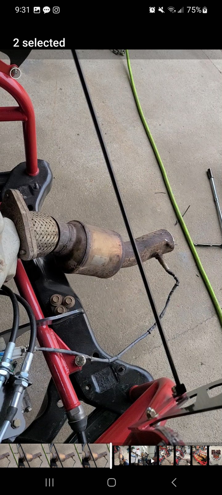

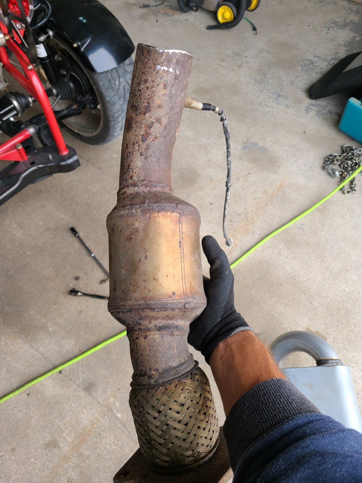

  • No catalytic converter (I just cut up the stock downpipe temporarily)

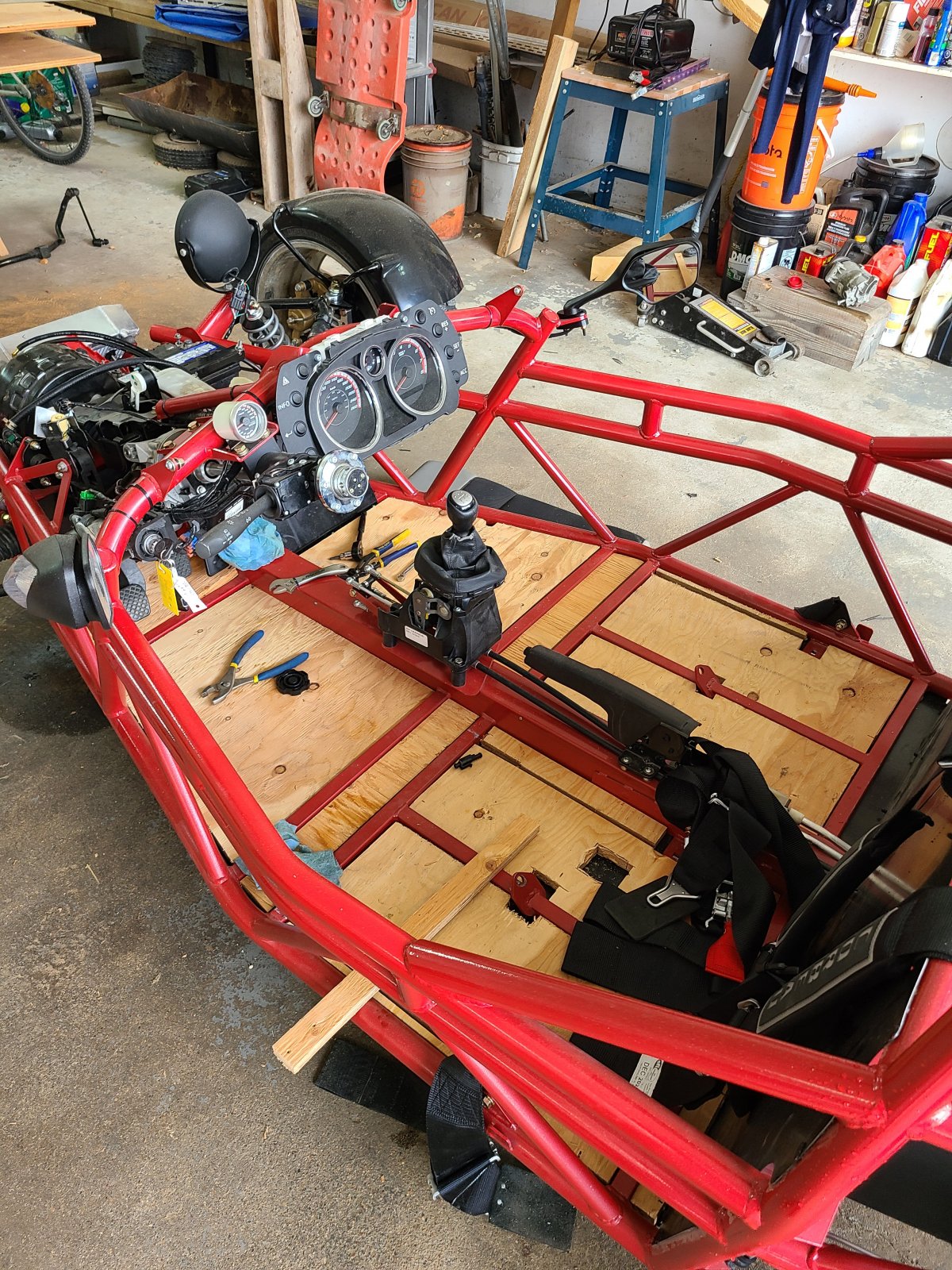

Floor not secure! I had a good chuckle when I read the mechanics note on this one. Apparently the floor is a little to thin for MB standards. So, I had some 3/4" plywood lying around at home that I cut up to fit in the gaps between the 1" square braces on the floor. I will be supporting said plywood with some angle iron brackets that I will be cutting up and screwing into the square braces. This should bring the plywood flush with the braces. Over top Ill be cutting up and gluing in some red and black diamond stitch faux leather upholstery. I might also do a rubber mat for the area where your feet rest when driving so the upholstery doesn't get to scuffed up. This should make the floor feel really solid and make the interior look more finished!
