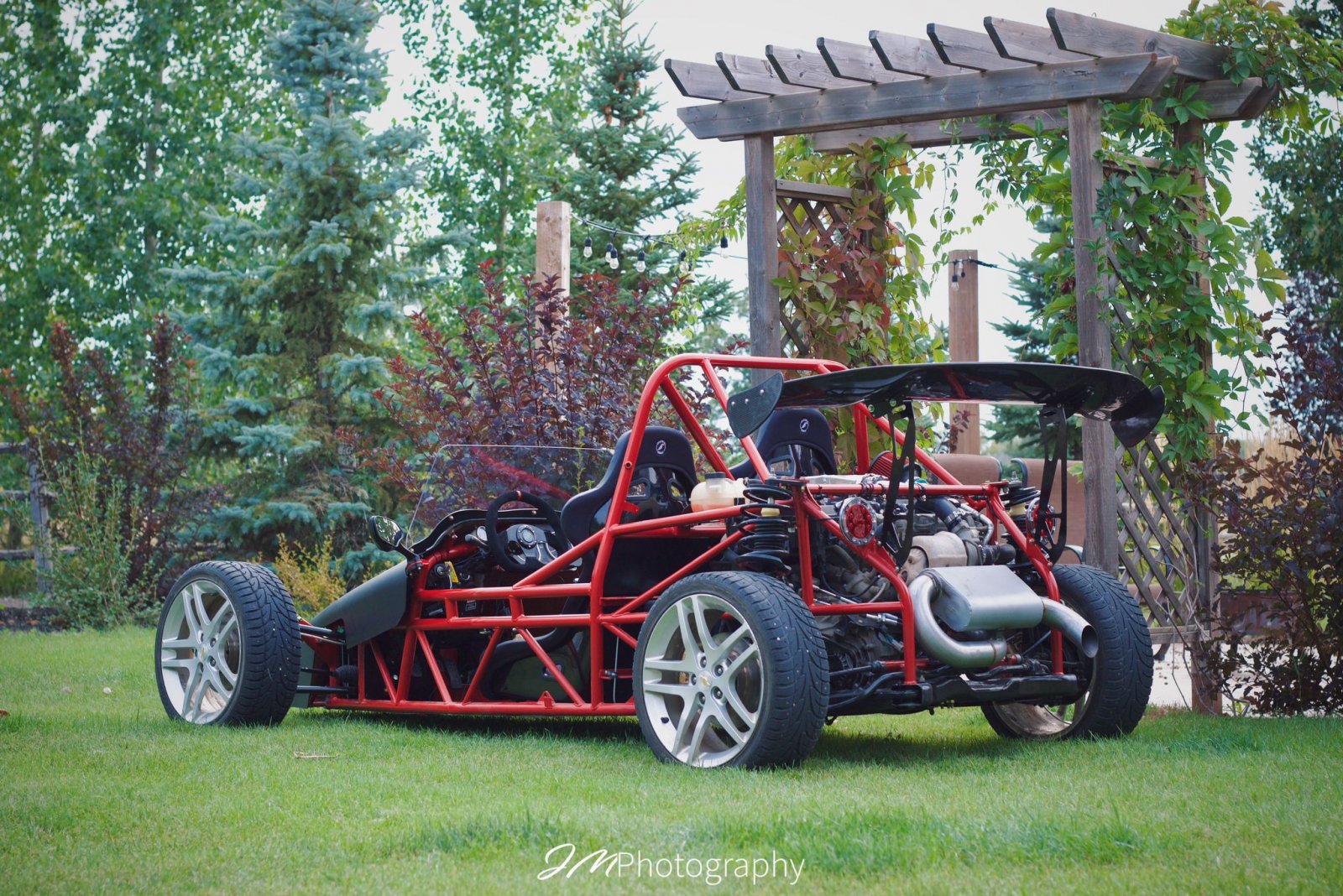

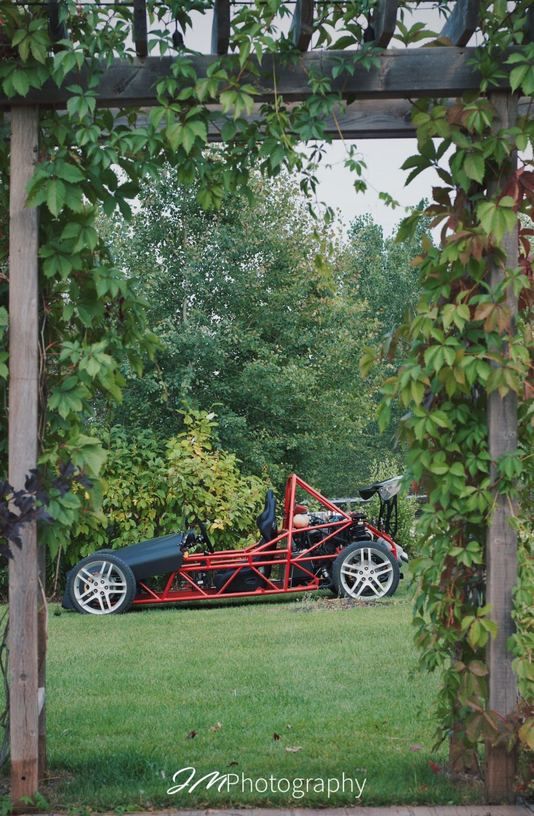

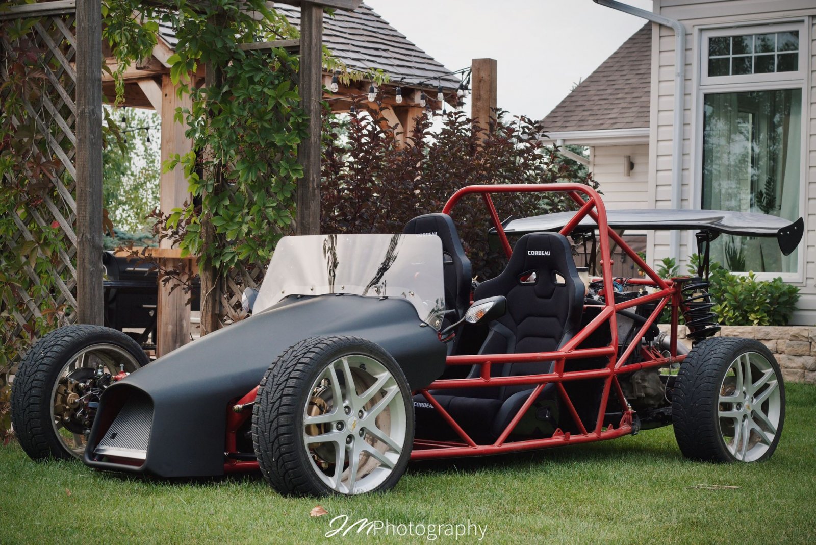

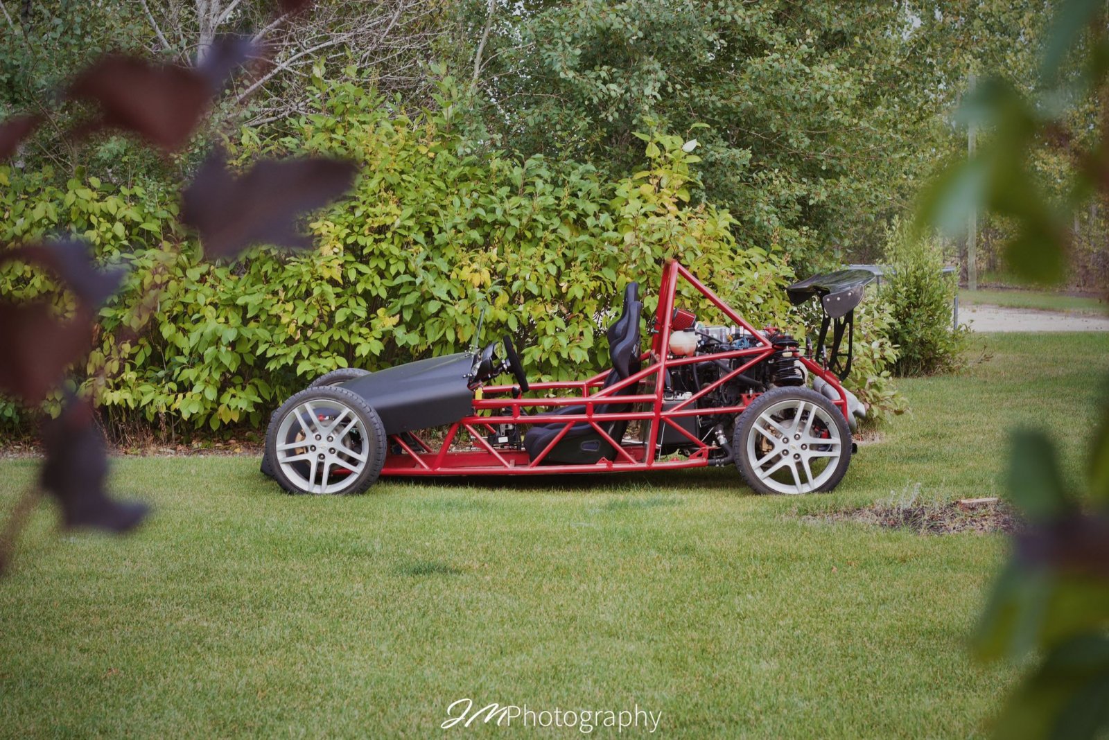

Hahaha to be fair this one was very heavily modified and the owner did do a really good job on it. Thank you for validating my frustration though. :D It's all good though, all the amazing conversations that I had and the looks I got on my short (and very illegal ride) were more than enough gratification for me! This is going to be a very interesting car to drive in the public. My 10 min drive from where we parked the trailer to the show was filled with broken neck stares and people rolling down windows to ask what the car was. Ill throw in a couple pics here of how she currently sits (its nice to have photographer friends) . Cant wait for my new wheels to come in....

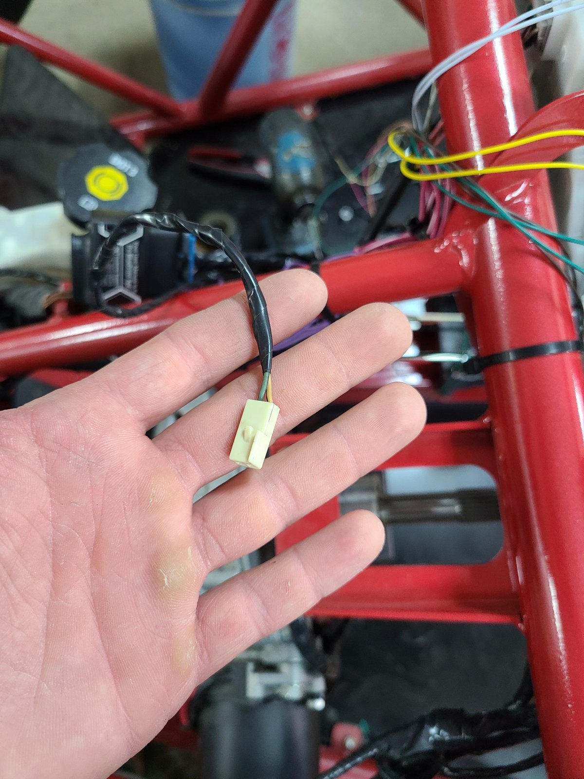

First one is a two wire, white connector by my dash area that I don't have connections for. Anyone know what this is for?

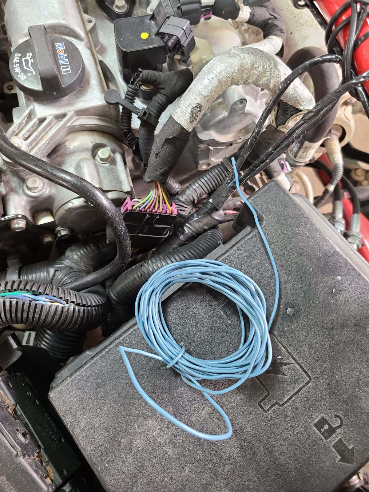

Second pic is a light blue wire that I have rolled up by my fuse box. Its not the radiator fan wire as that is hooked up and working already. Thinking it could be the Heat exchanger fan wire? If so, does this need to be wired in to the same connection as the radiator fan wire?

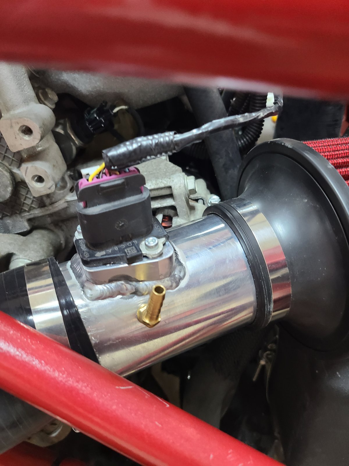

Third pic is the brass hose barb connector on my MAF pipe. What is the purpose of this and where should it be connected to?

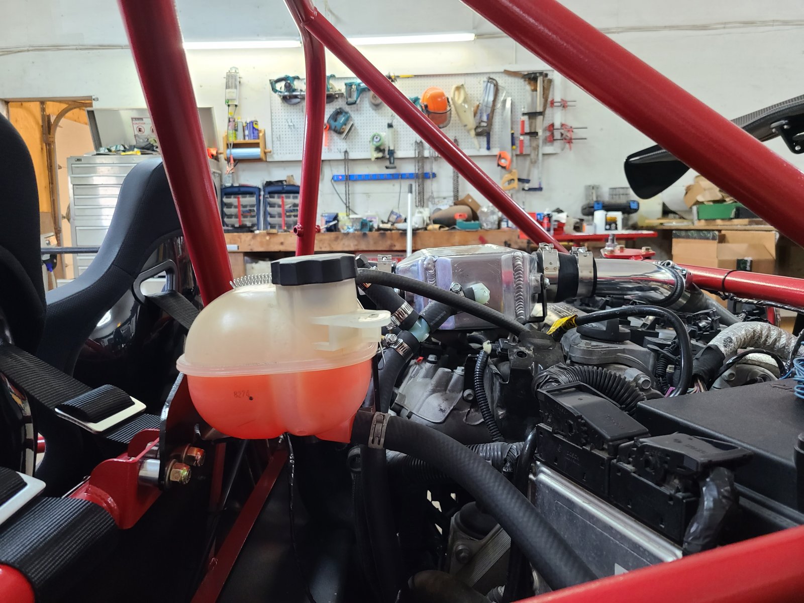

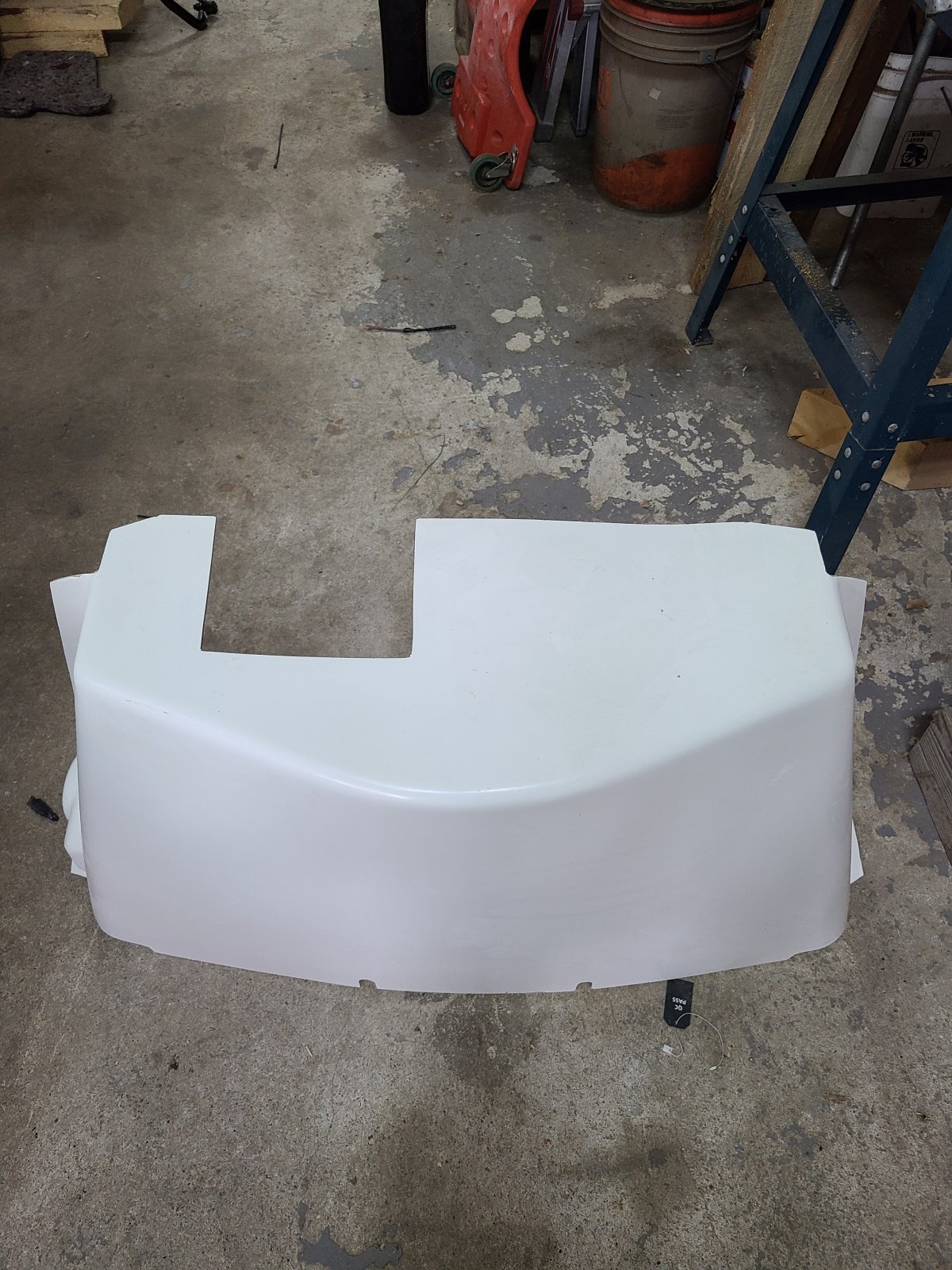

Fourth picture is my engine cover which seems to look different from the contoured ones that I have seen previously on the forum. Mine appears go down further on the turbo side and doesn't have the curves behind the seats. With the new coolant location being as high as it is now, it appears to be just as high as my intercooler. Can anyone with the new coolant reservoir location confirm whether or not Ill have to cut around that as well?
Ambient light sensor.
Could be the heat exchanger fan or pump wire? If it's one of those, it wouldn't be wired to the same connection as the radiator fan wire, you would want those 2 to be on all the time if the key is on. Check this or this post on where those 2 should connect.
Third pic goes to a vent in your valve cover. Needs to have a check valve in the line as well. See this post for more info.
4th pic is your footwell cover, not your engine cover.

Wooooooooow, you just blew my mind. I diddnt even know the Goblin had a footwell cover until yesterday, so for the past 2 months I've been assuming this was my engine cover since it's the only other fiberglass piece I received. That makes so much me sense.
As for the light blue wire, my intercooler water pump works just fine with key on power. You're saying the heat exchanger fan should be the same?
Yes, considering you want your IAT as low as possible, there's no reason to ever have the heat exchanger fan off.

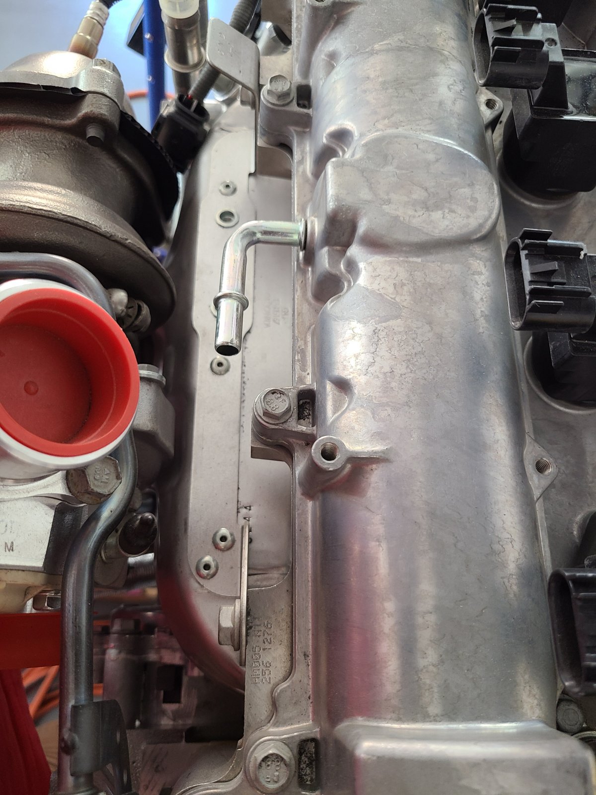

Are you hooking your 'PCV' outlet to the hose barb on the air filter intake pipe? Everything I looked at and read the valve cover vent - on the passenger side rear corner - goes to this hose barb. This one:
The connecting hose gets a one way check valve to allow filtered air into the engine, but not allow crankcase pressurized air to flow back into the pipe.
The PCV outlet goes into the intake manifold to function correctly and is internal to the manifold with no external connection - in the stock configuration
I was planning on hooking the intake hose barb to the outlet in your picture. Is that the PCV connection?
On a TC the PCV is inside the intake manifold, it has no external connection. The vent tube in the photo, at the passenger side rear corner of the valve cover in front of the turbo, is the engine crankcase vent that allows a metered amount of air into the engine under certain normal operating conditions. It is connected to the hose barb next to the MAF in the air filter intake pipe that goes to the inlet of turbo - and as mentioned it requires a check valve (one-way valve) that should have been removed during your donor teardown.

Ok that makes sense then. The brake booster vacuum hose I have connected already. How did you connect the intake hose barb to the crankcase intake? Did you manage to re-use the stock lines or did you have to purchase new connecters, line & check valve?
