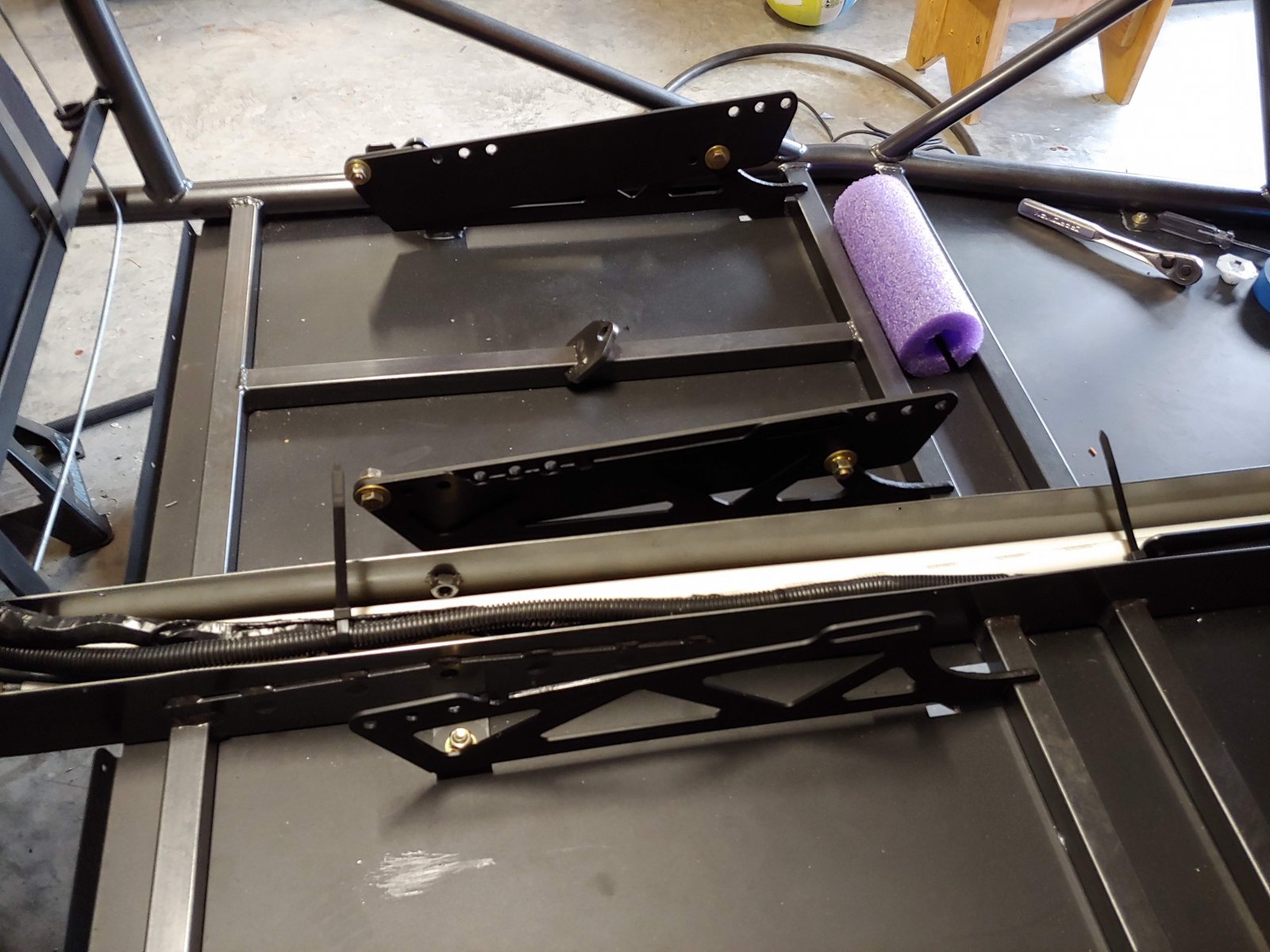

Yep, I had to deal with this. I have an extended frame and mounting brackets for an extended. I think they made different seat brackets for non extended frames that used to be available but I just made adapter plates.I bolted the driver seat in tonight to get an idea of where the steering wheel will line up. The shimming I did to the EPS puts the shaft too high to mount the wheel assembly, so those will come out and will be addressed once I get the wheel assembly where I want it. I'm hoping to not have to deal with clutch interference again once I get the wheel position finalized.
The bad news is that even in the forward-most position, my seat is a bit too far from the pedals for me. There's no more room on the DF seat brackets to drill more holes so I'll have to think on this one for a bit on how to get the seat another inch or 2 closer to the pedals. If anyone else has dealt with this please share your solution.
