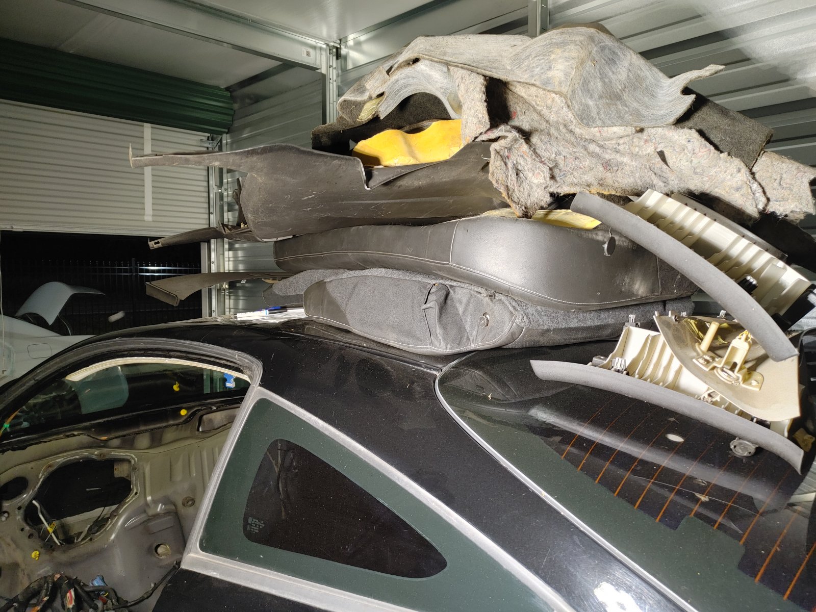

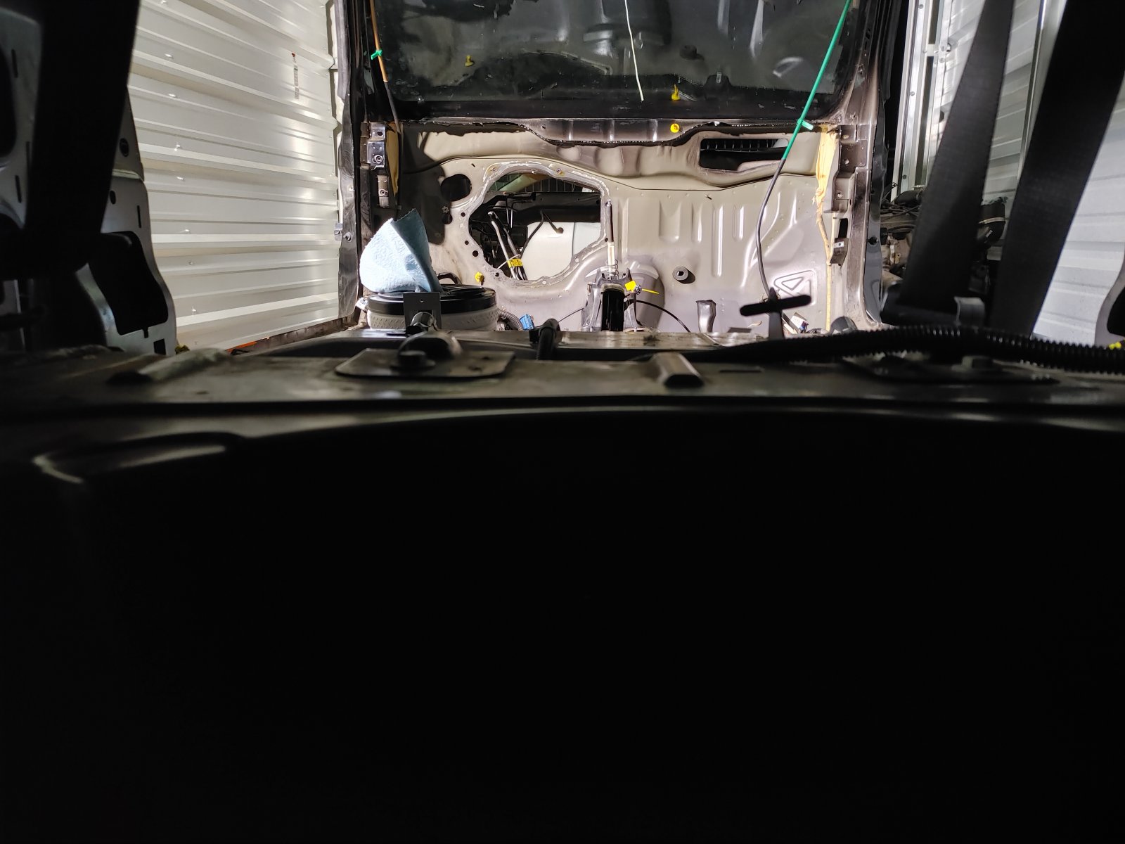

Not many photos for these last 2 sessions, but progress is being made. Progress from the trunk:
28740
Parts piling up:
28742

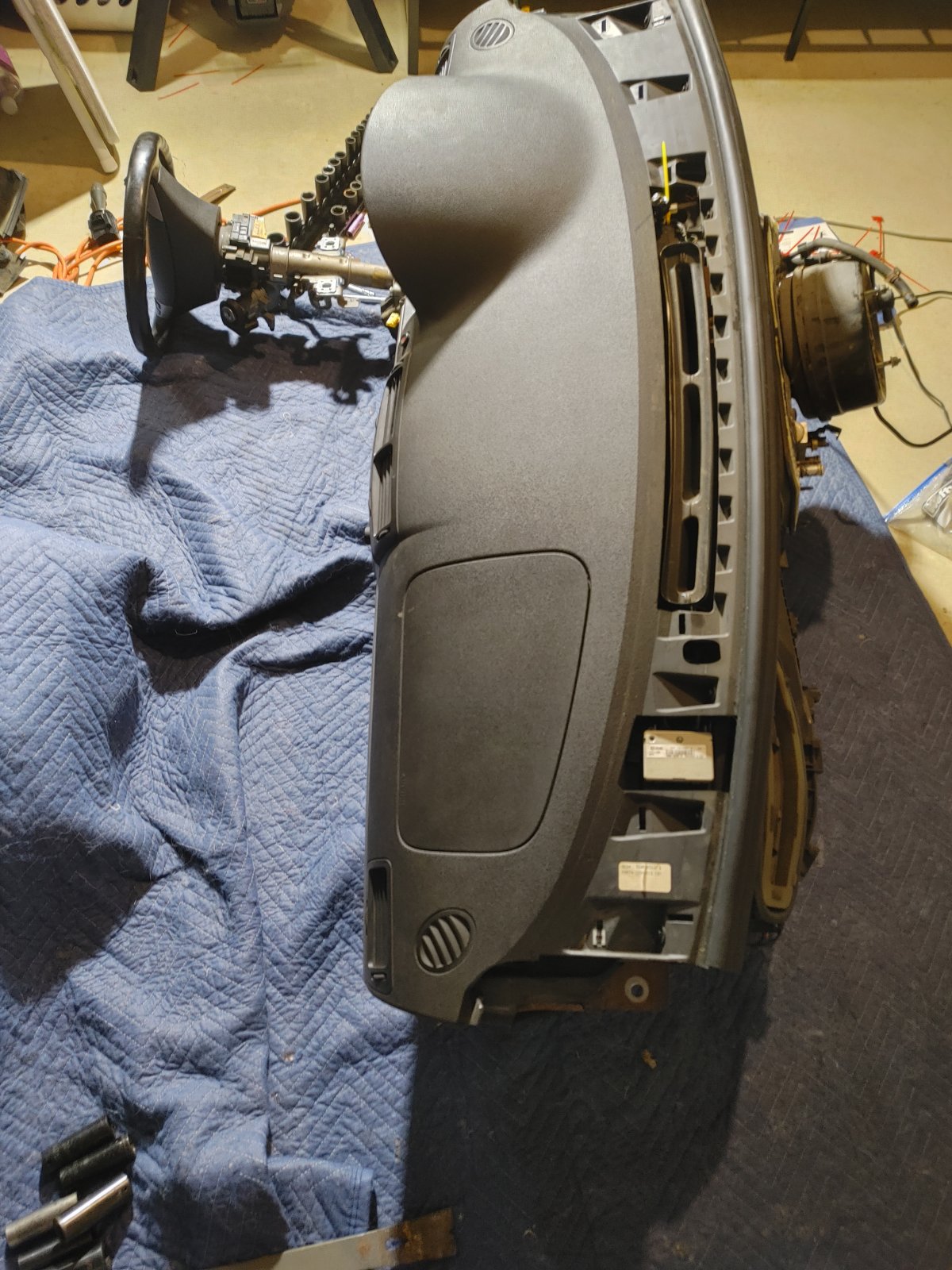

Dash transported home to finish Video 7 indoors:
28743

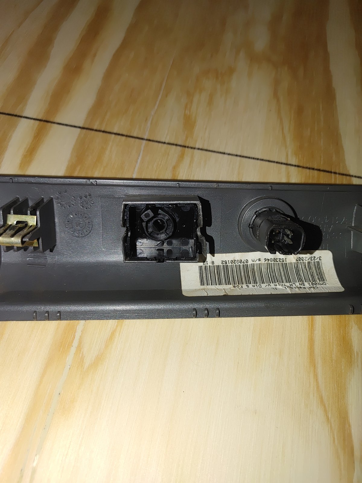

I had 2 issues when disassembling the dash:
1. Clutch Pedal Removal: Searched the forum and found my answer. I hope to have this removed tonight.
2. Dimmer Switch: When I popped the trim piece with the dimmer knob, there was nothing attached behind it. This reminded me that when my donor was assembled, I originally thought the cluster was bad because I couldn't see the DIC info. Further checking revealed it was working but just really dim making it nearly impossible to see except in the dark. I now know why turning the dimmer knob had no effect. lol
I'll have to recheck my dash wiring harness, but I didn't see any extra unlabeled connectors. so I am not sure where the dimmer switch wiring went.
Does anyone have a picture of what the dimmer switch wiring/connector looks like?

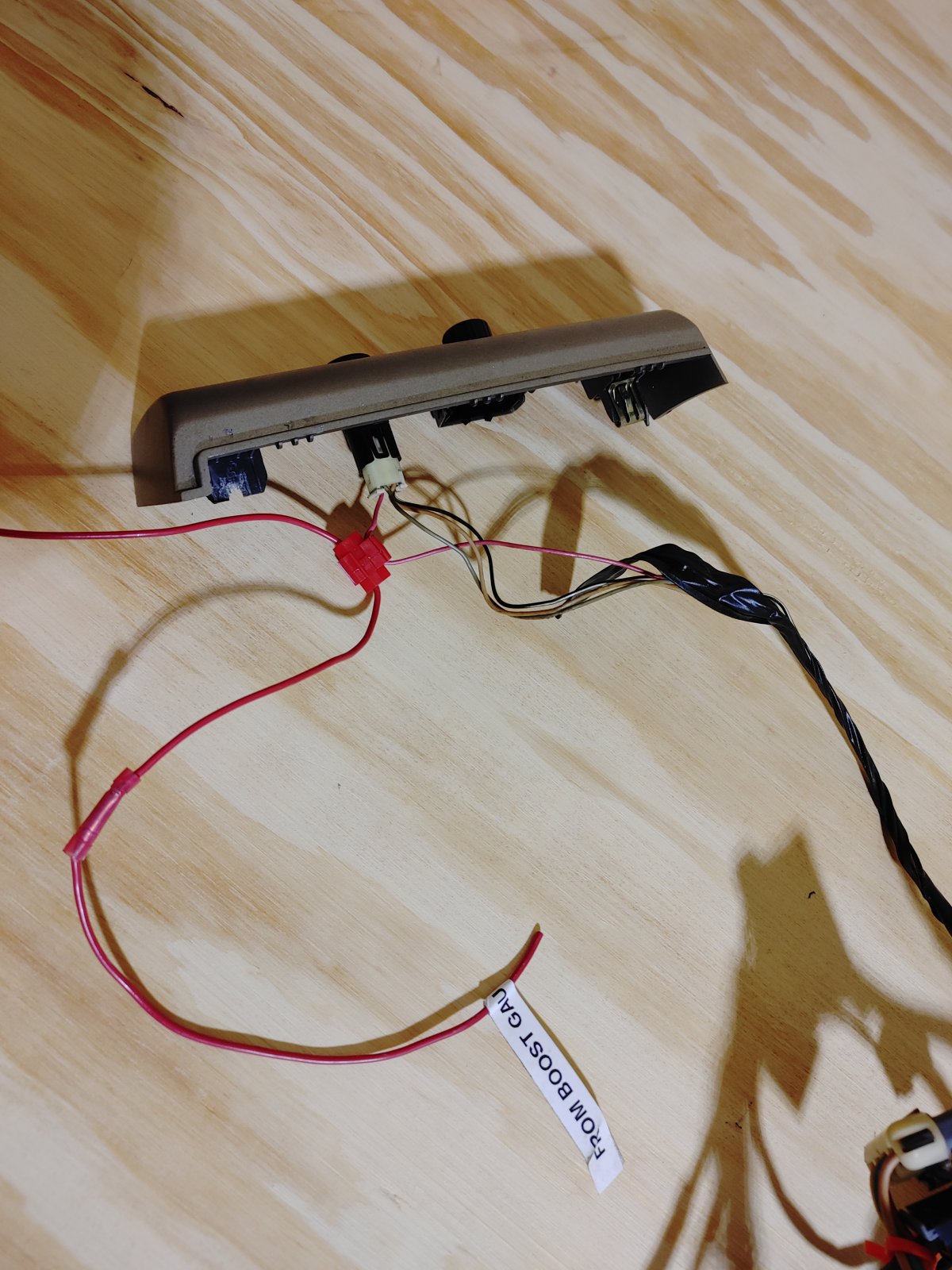

I found the wires. The fog lights were pulled and used for the boost gauge's power and the back half of the dimmer switch either fell off or was removed for some reason and was just dangling somewhere in the dash.
Neither of these were plugged in when I popped it off the dash:
28763
I knew this wire had been pulled from somewhere when I removed the A-pillar gauges and it's definitely the fog light switch connector:
28764
Untangling the mess revealed the back half of the dimmer switch still plugged in:
28765

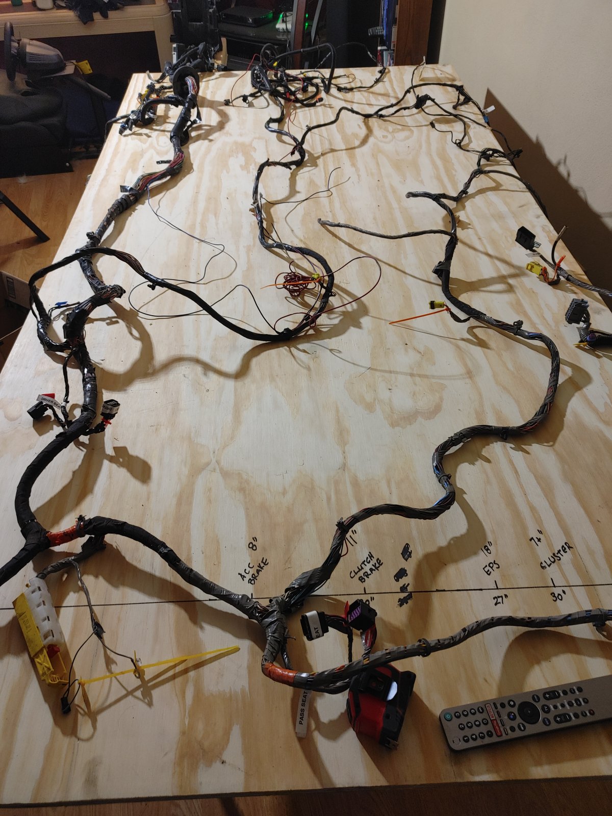

After reading some nifty advice on the forum I was able to get the clutch off pretty easily to officially call the dash video complete. I hauled the dash carcass back to storage and finished up Video 6. This means I finally have my wiring harness out and back home on the board ready to start the harness video series journey.
And so it begins...
28802

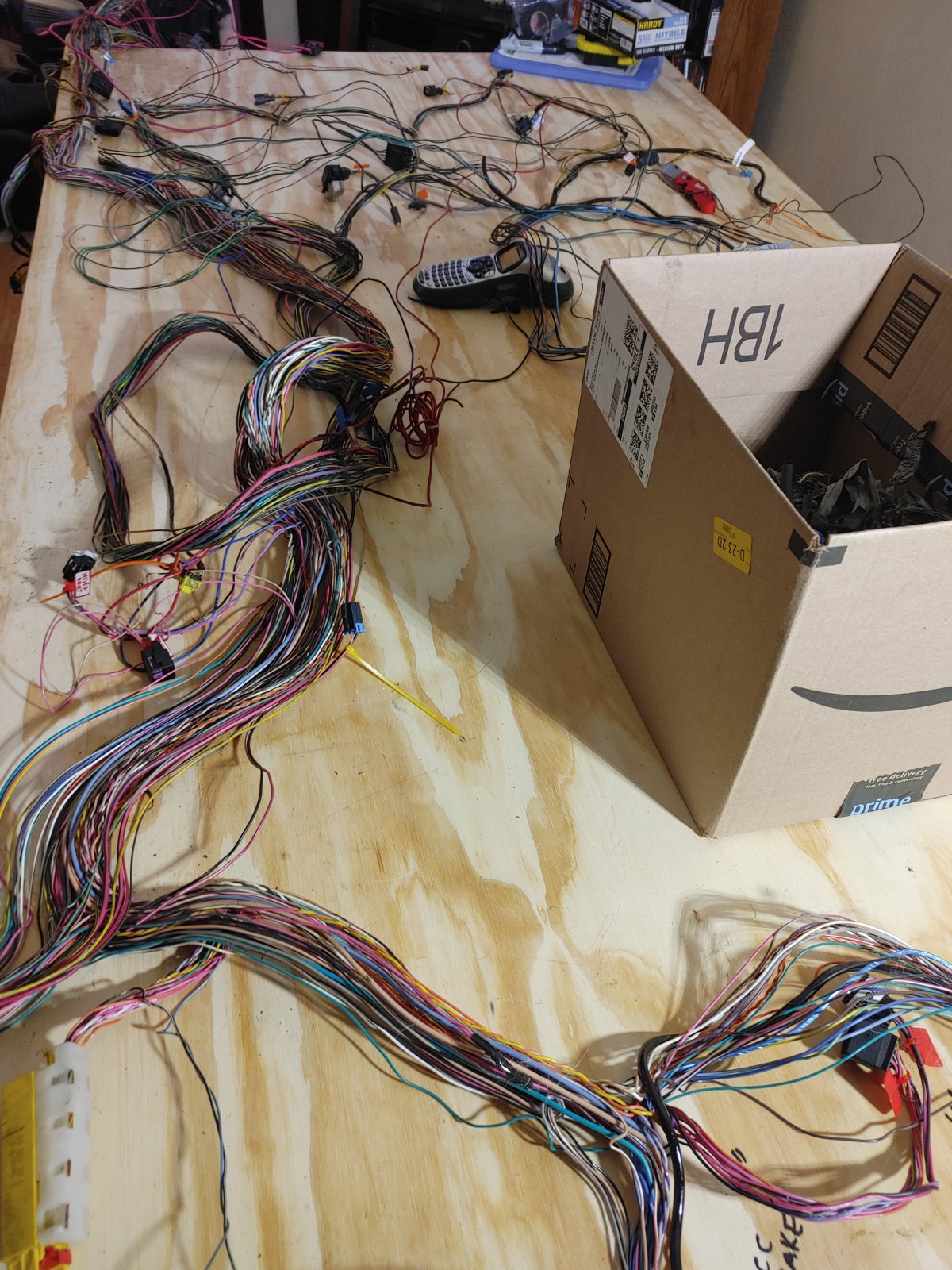

Spent just under 2 hours on the harness tonight. I moved at a leisurely pace just cutting and removing tape after getting rid of all the wire ties and loom last night.
I watched some TV and chatted with the wife and the next thing I knew all the tape was off and there was nothing left in the 1st video. That wasn't too bad.
My harness is only kind of holding its shape even though I tried not moving it too much and sort of looks like Lonny's in the video but on a bad hair day. I'm hoping to get some decent time into it this weekend and see if we can't bang this whole thing out in 2 weeks.

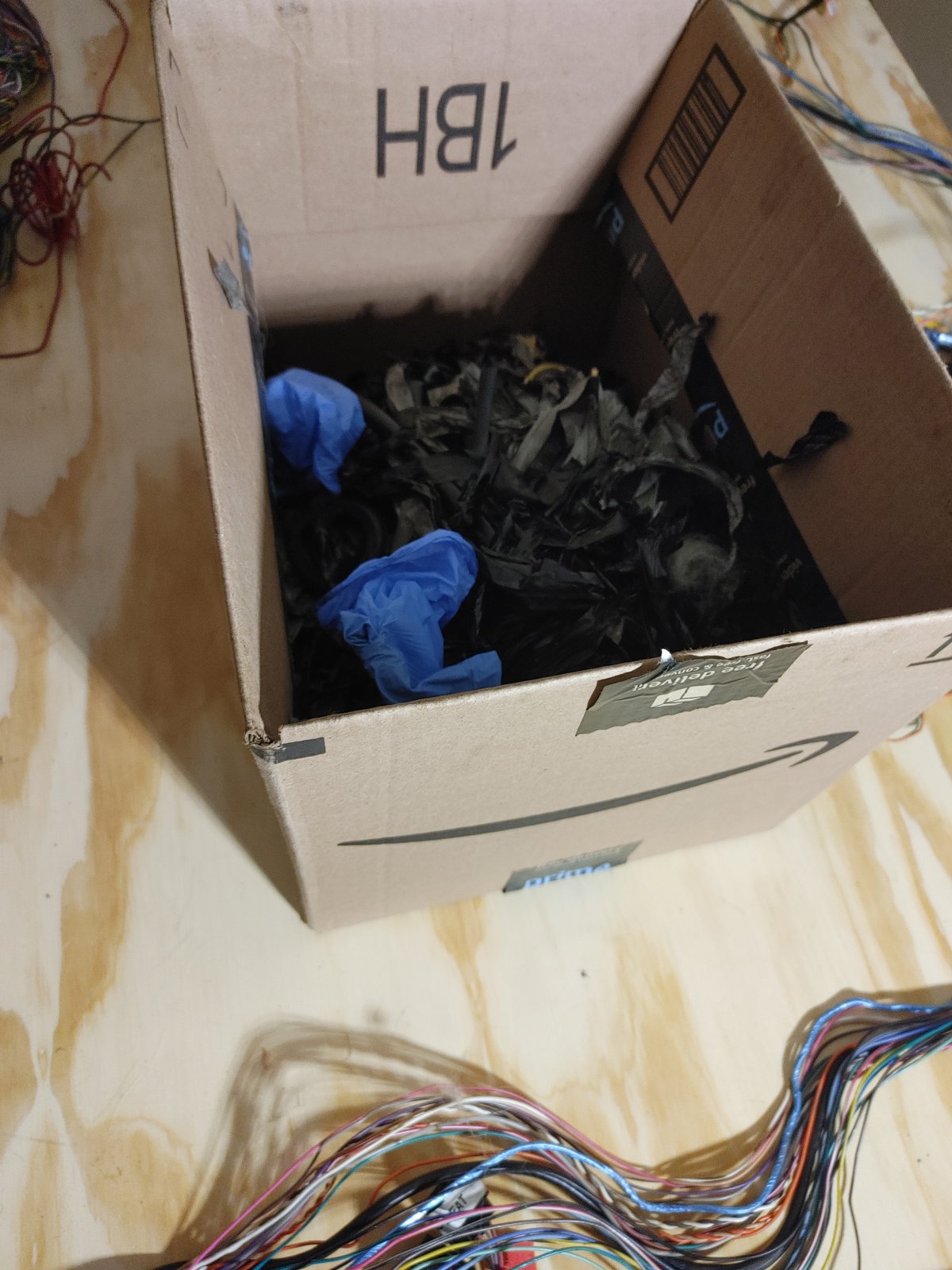

Took my time and the next thing I knew I had a box full of tape:
28818
Spaghetti. It's what's for dinner:
28819

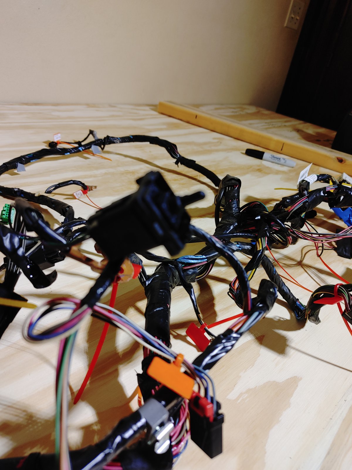

Day 10
Work Time: 4 hours
Completed: Wiring Harness Guide Part 2 & 3 (Thinning)
I got in two solid 2-hour sessions today. I was able to complete the thinning videos. Mostly.
I have to check some wiring diagrams for one single red w/white stripe wire. It looks like it was cut from a connector and leads to one of the multi-plugs but I'm not sure what it was from. I didn't take any breaks during the video and made sure to thin or label each wire on each step. The first video was very straight forward and the significant differences didn't occur until the second thinning video.
I also still have a second connector for each seat (seat heater stuff maybe?) still on the table. I know when removing the main seat connector the video referenced a possible second connector that should have come out with the main one but neither of these did. Aside from the missing headliner connection mentioned in a previous post above, here are the other differences I encountered:
  • Missing both black and white VCIM connectors (trunk light went to BCM/ground and not VCIM/ground as shown in the video).
  • The rear defroster was connected to the wires that went to my sunroof from the driver-side and the defroster wire that came off the passenger side went to a ground lug - it wasn't a single wire to pull from the harness in like the video.
  • I didn't have a vacuum sensor or yaw sensor connector.
  • When I went to pull the second set of speaker wires I couldn't find them. I know I labeled them when I removed them, but it was a long day of chasing wires and I don't remember if they got removed earlier in the day. In either case, no more speaker wires are on the table.
I'm going to check the wiring diagrams as stated above and make sure I can just cut out those second seat connectors and I should be completely done with the thinning. I will also try to tidy up my mess, as my wires aren't looking like the video like they did at the beginning. I'll call it a night after that and throw some pics up once done. I'll start the Organizing videos tomorrow.
