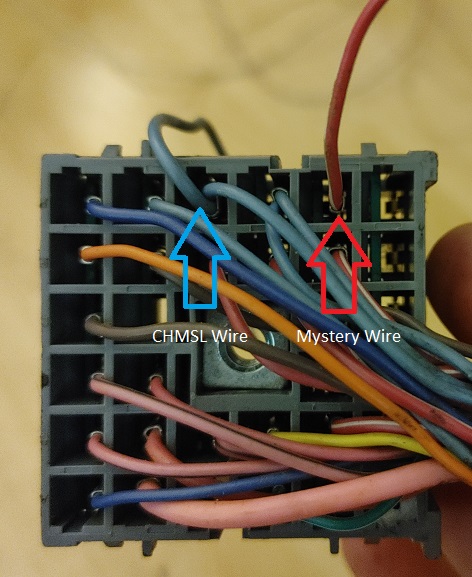

I can't find any diagrams of the multiplugs in the images and PDFs I've found/saved so far.

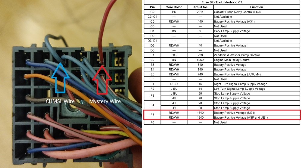

I am curious as to what this red w/white strip wire is before cutting it out. It is 2 spots over from the CHMSL/3rd Brake Light wire on the small gray multi-plug:
28844

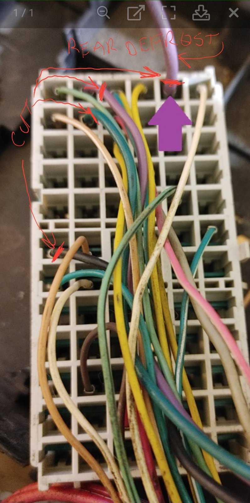

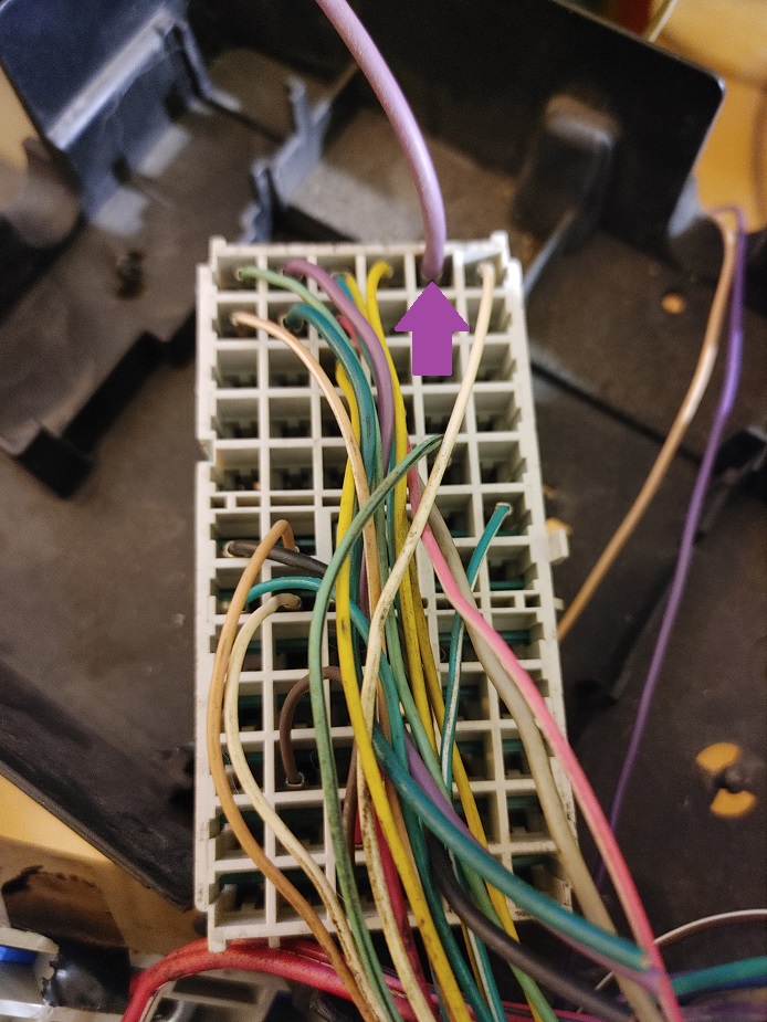

I also traced the 3 sunroof wires, with the 2 small ones going to the red BCM multi-plug and the thick purple wire running to the large white multi-plug. I am curious if the larger purple wire is power for the sunroof, as I've read conflicting information as to whether that is a RAP circuit or not. If the sunroof circuit is RAP, I would consider keeping whichever is the power wire for a RAP accessory connection:
28845
Appreciate it if anyone can locate wiring diagrams for either plug so I know what I am cutting in the first instance and whether to keep or remove in the second instance. Thanks in advance!

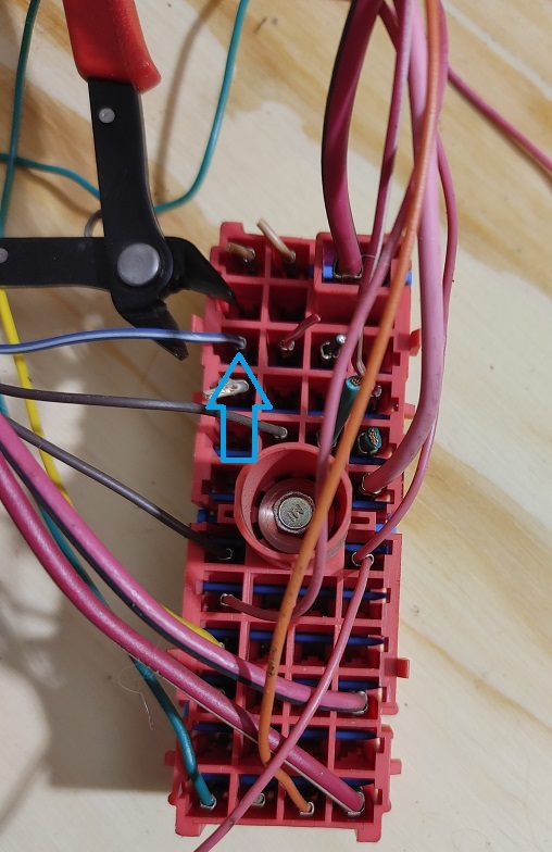

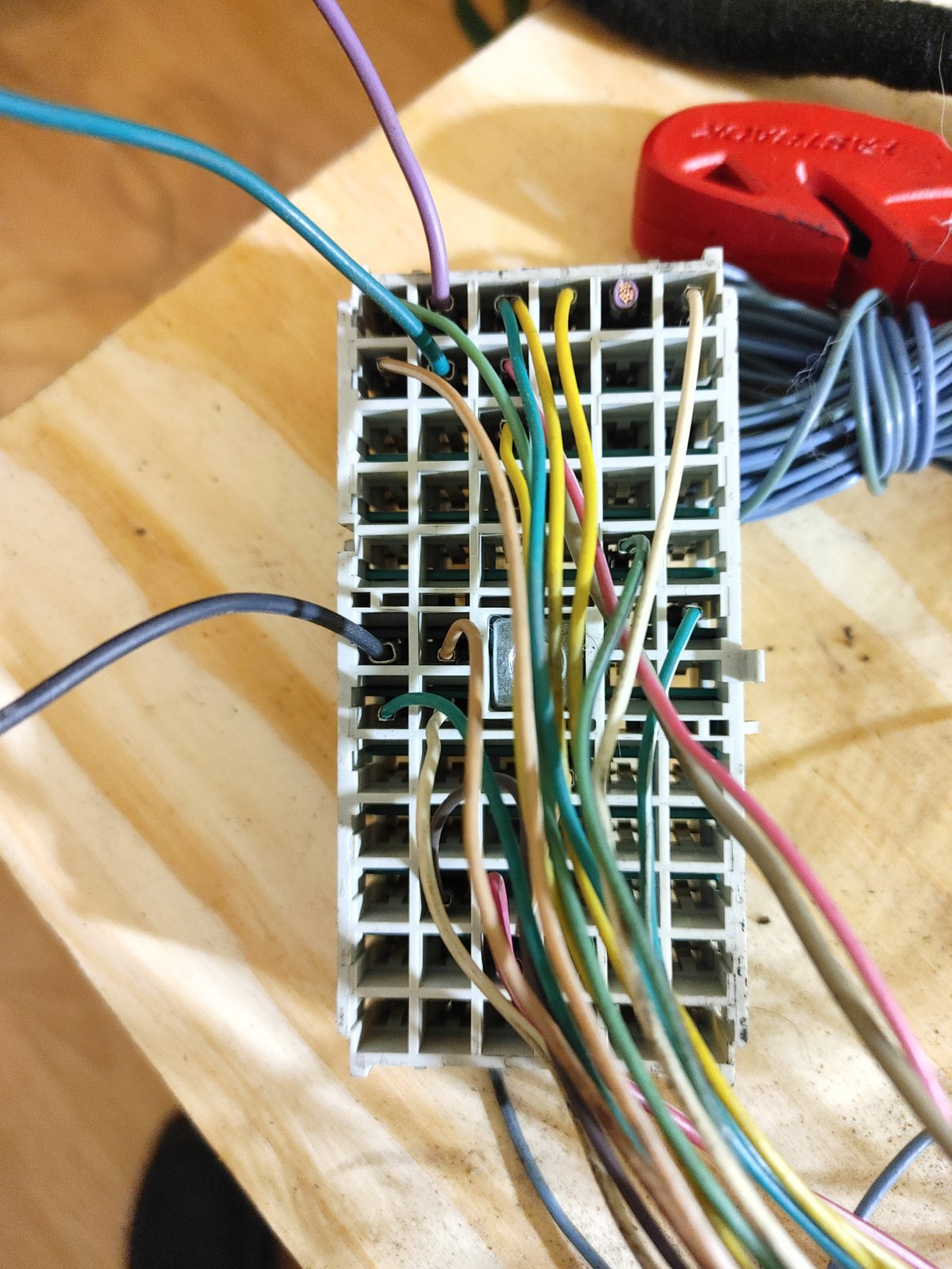

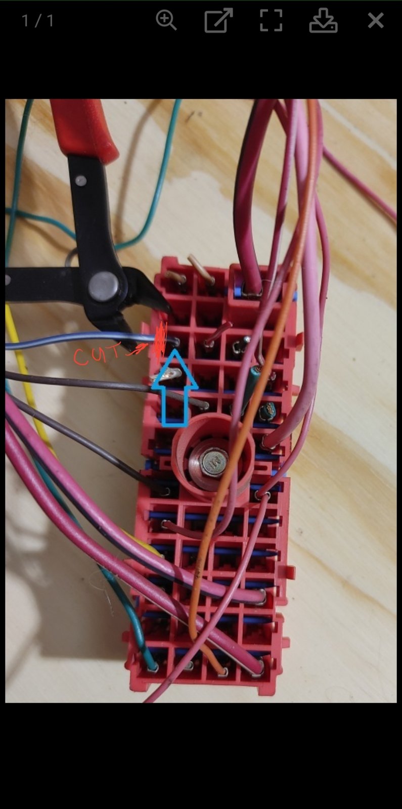

I lied, I have a 2nd mystery wire. I found one more while straightening up my remaining wires. It looks like I bundled this blue w/white strip wire with some grounds.
It was from the side opposite of the main wires just like the red w/white stripe mystery wire, except this one traces back to the red BCM multi-plug:
28847

I can’t help with that specific wire, but watching the videos ahead of time may show where it goes. As a fail safe, cut it a little long, so you can reattach if need be. Cap it with electrical tape in case it’s not needed, so it won’t short out anything else And mark it somehow to be referenced later.
I kept a few of the accessory wires and ran them towards the dash, so I have plenty of options later down the road. I marked them with phasing tape (different color electrical tape), so I could find them when needed.
The large wire is for the rear window defrost. It is black in later models.
The other three are for the word motor. There is a yellow wire that runs from the wiper motor connector to a BCM connector.
The blue with white stripe can be removed.

It looks like the 1st mystery wire is from Underhood C5 in the F5 pin. The diagram tells me it's circuit # 1340 and is for Battery Positive Voltage (UE1/ASF). How do I determine what that is exactly?
28854
Sluggonaut

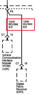

I think I found it. Randomly looking through wiring diagrams I see 1340 on a Power Distribution diagram. Circuit 1340 off of F5 shows it going to the VCIM and Digital Radio Receiver. Based on where this wire was on my table, it likely came from the XM plug. If the VCIM is for OnStar that explains why I didn't have the connectors, as my car didn't have an OnStar module. The bottom line is I'm 99% certain I don't need Mystery Wire #1. lol

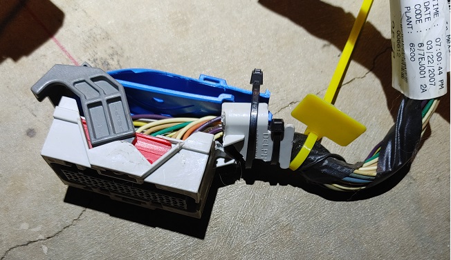

When I was digging in my wiring harness box for my headlight harness, I noticed this casualty. It had to have broken sometime during disassembly of another component or transportation because none of the connectors were damaged when they were removed.
I'm sure it will still lock into place because the lever seems undamaged, is this anything to worry about?
28897
