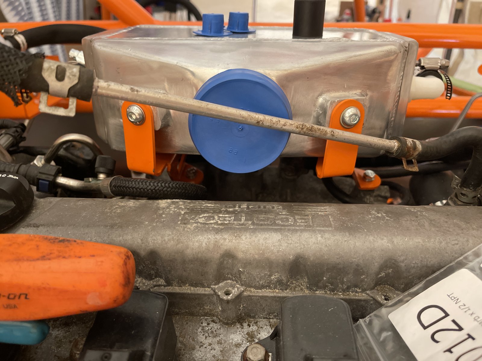

Next stupid question. Is everyone running coolant through the heat exchanger or something else. Also I know there has been talks about adding in a tank in place of the T. What are people using?
SmsDetroit
I got it mounted today. My issue was getting the 4 holes to line up with the inner-cooler. I had to grind the welds down a bit then enlarge one of the holes to get it to fit
Was going to use the same coolant I used in the engine but found a case of engine ice I had for my four wheelers. Decided to use that in my intercooler. (Why not lol). Now I can tell the difference if there is a leak somewhere also
