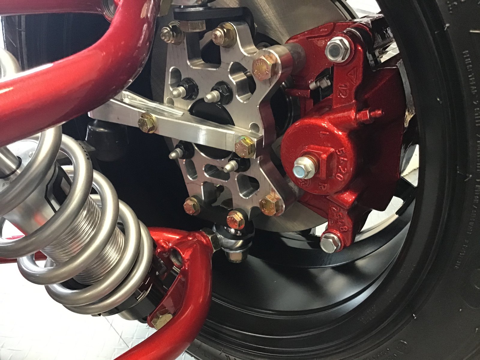

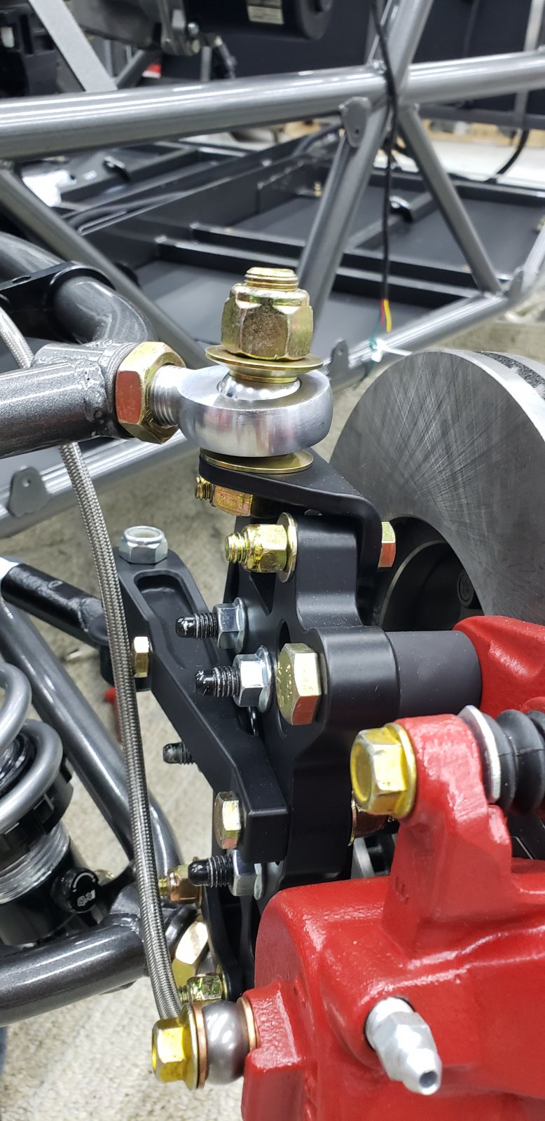

Your metal 90 degree brackets are on the wrong side of the billet uprights, both on the top and bottom.

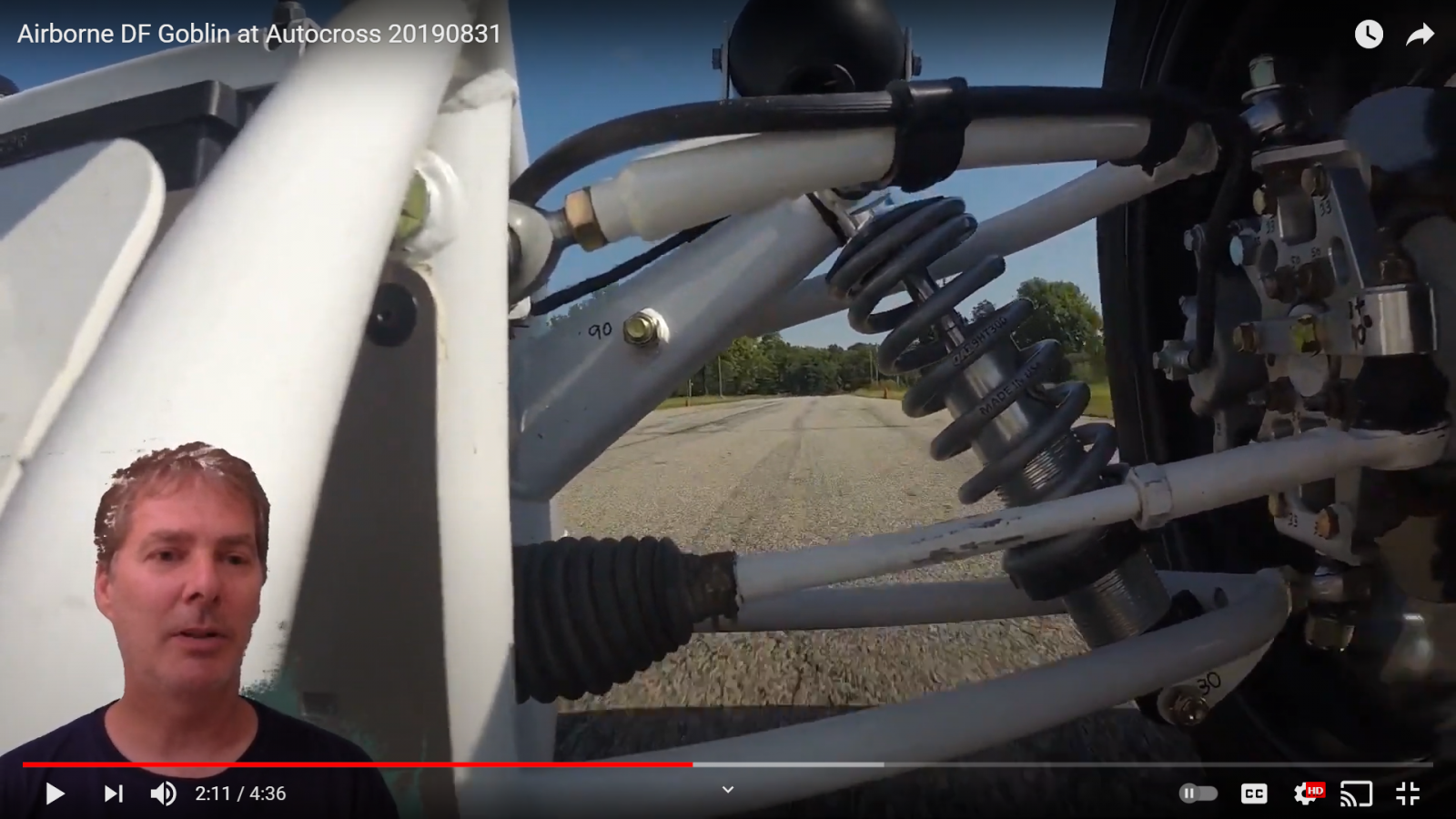

Here is the view from the passengers side of my Goblin from my youtube video.
21982
After you flip them, thread the bottom heim joint in, and the top heim joint out about 8 turns.

I think you have your upper and lower dohickies offset wrong.

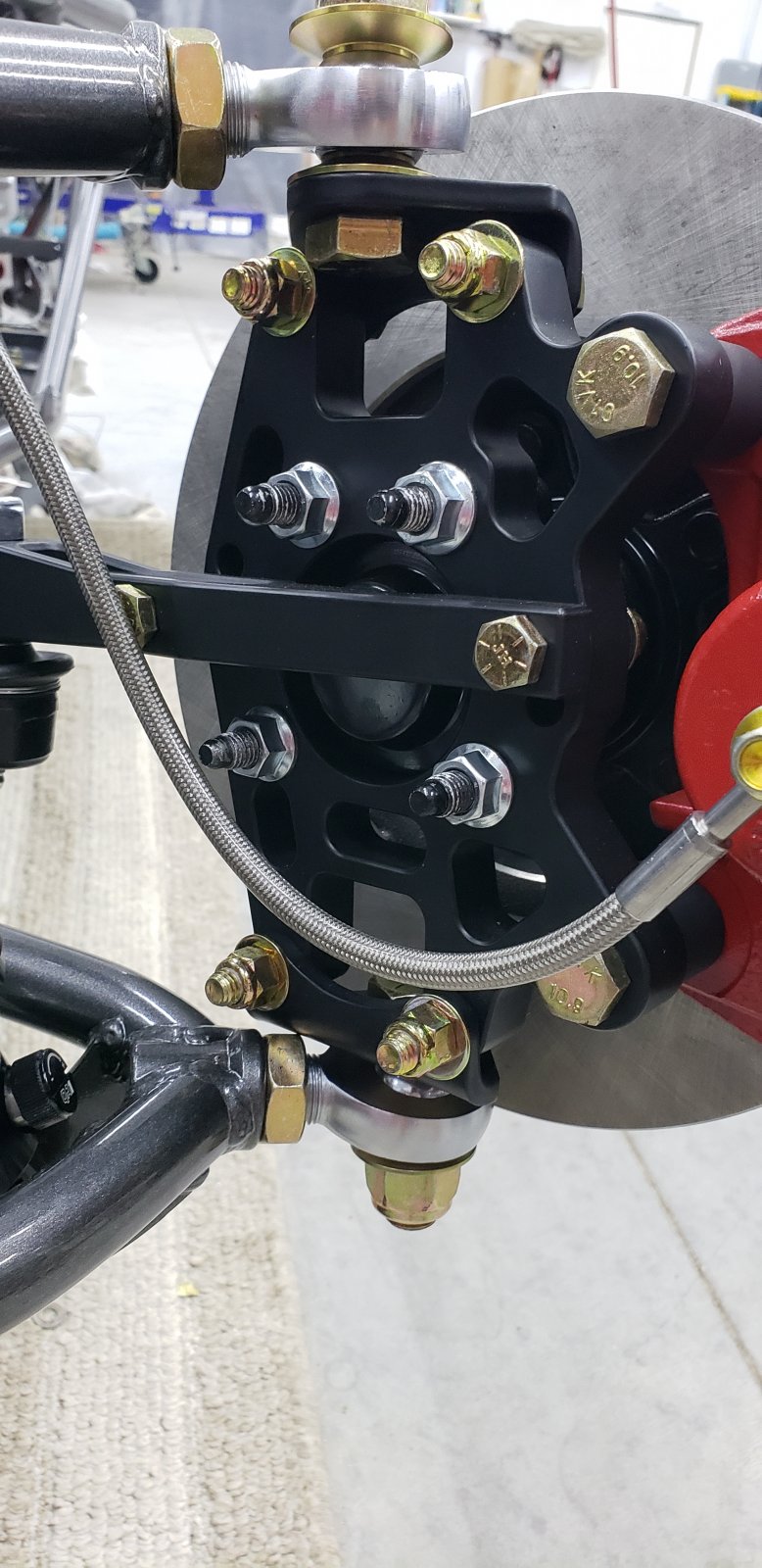

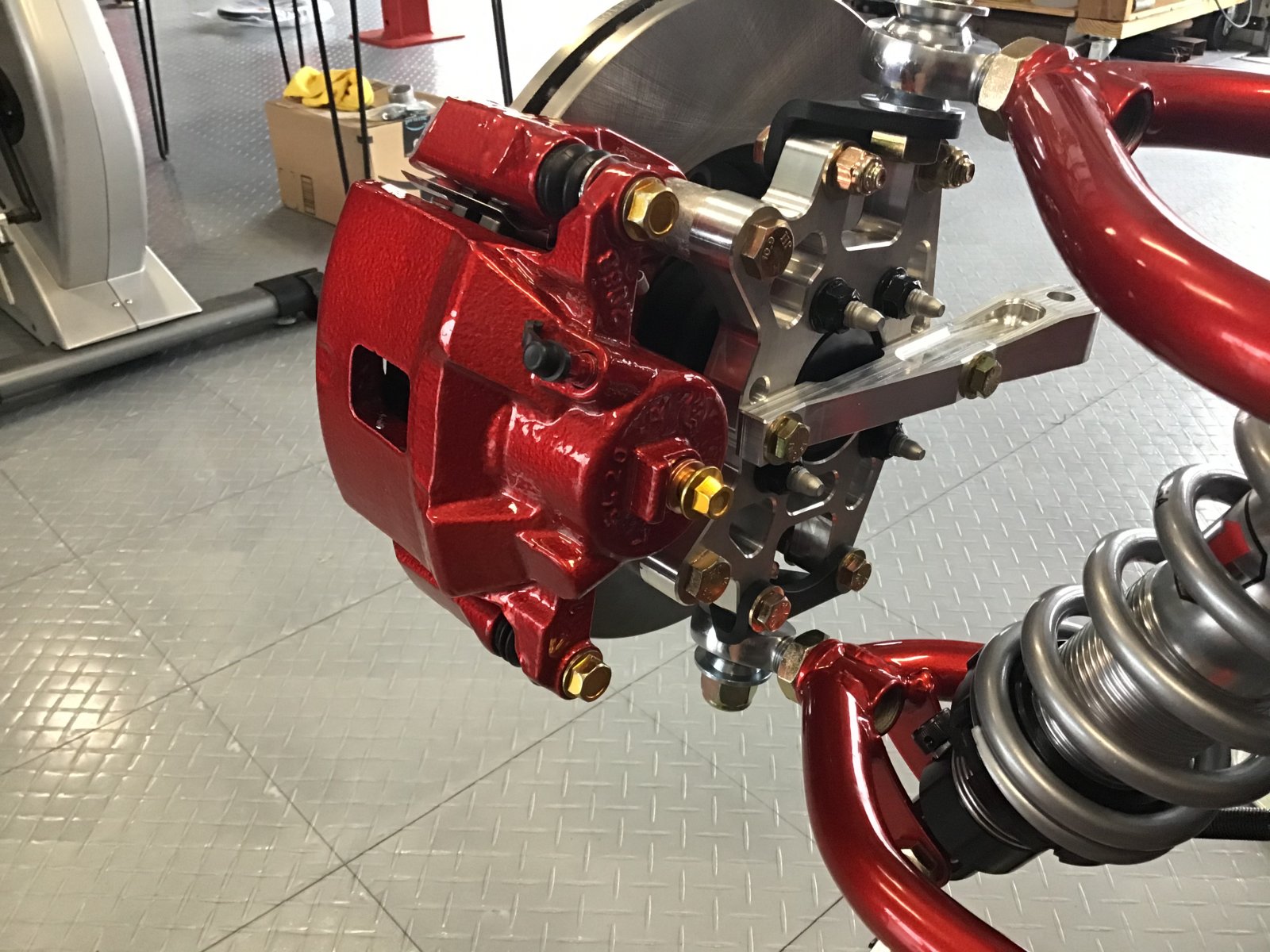

Lonnie said the steering arm is adjustable so we can reduce bump steer.
I haven't heard which position reduces bump steer the most.
Need to tape a laser pointer onto the wheel or brake rotor, and remove the spring, so I can measure bump steer.

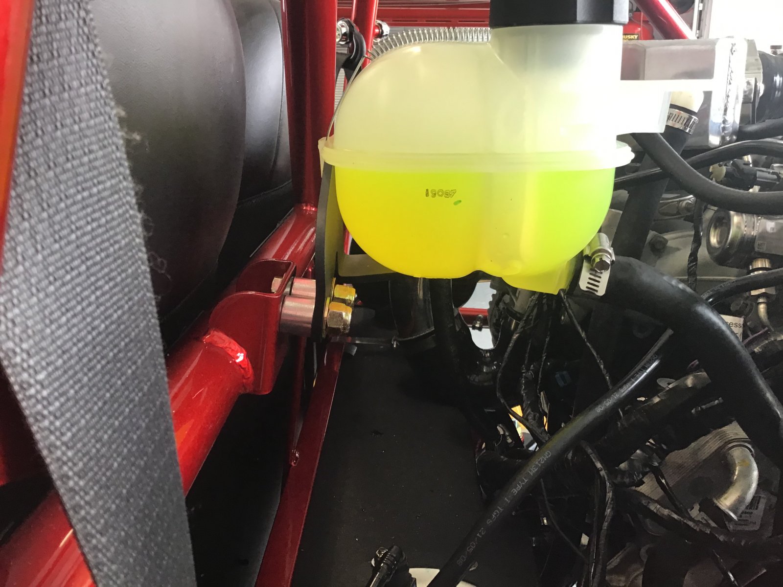

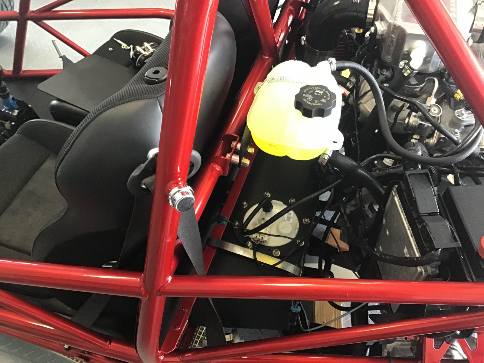

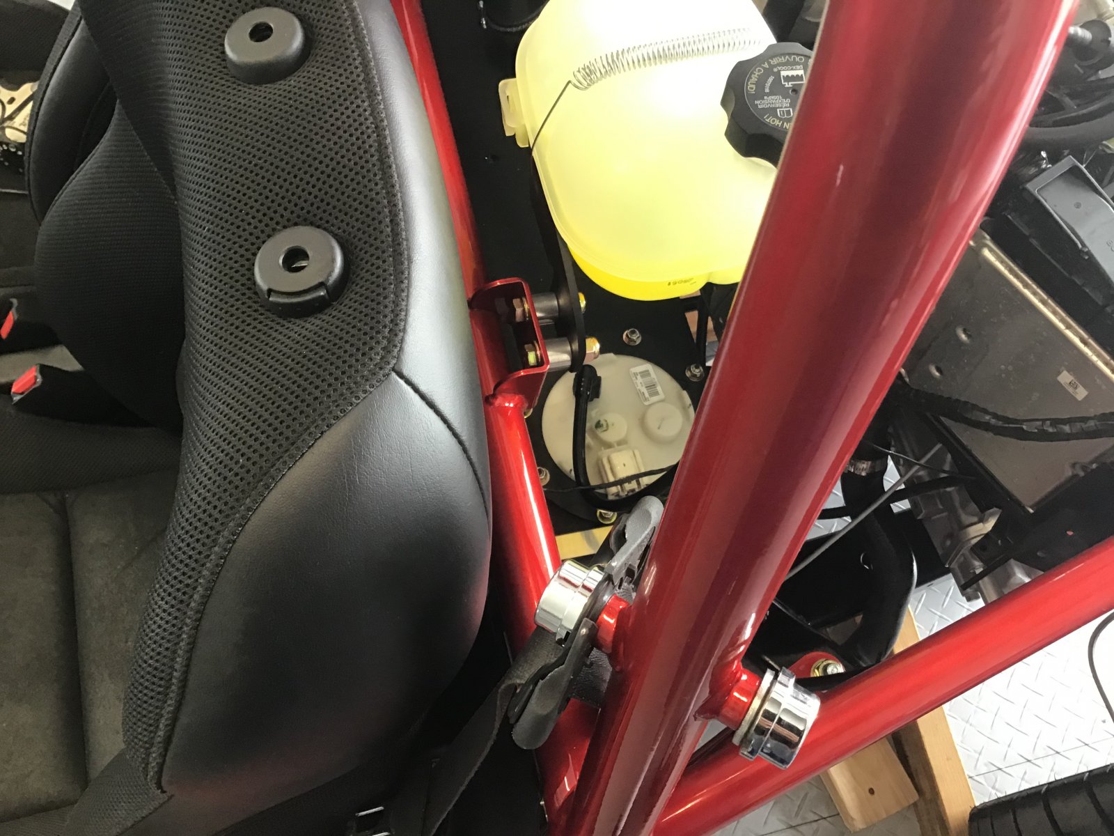

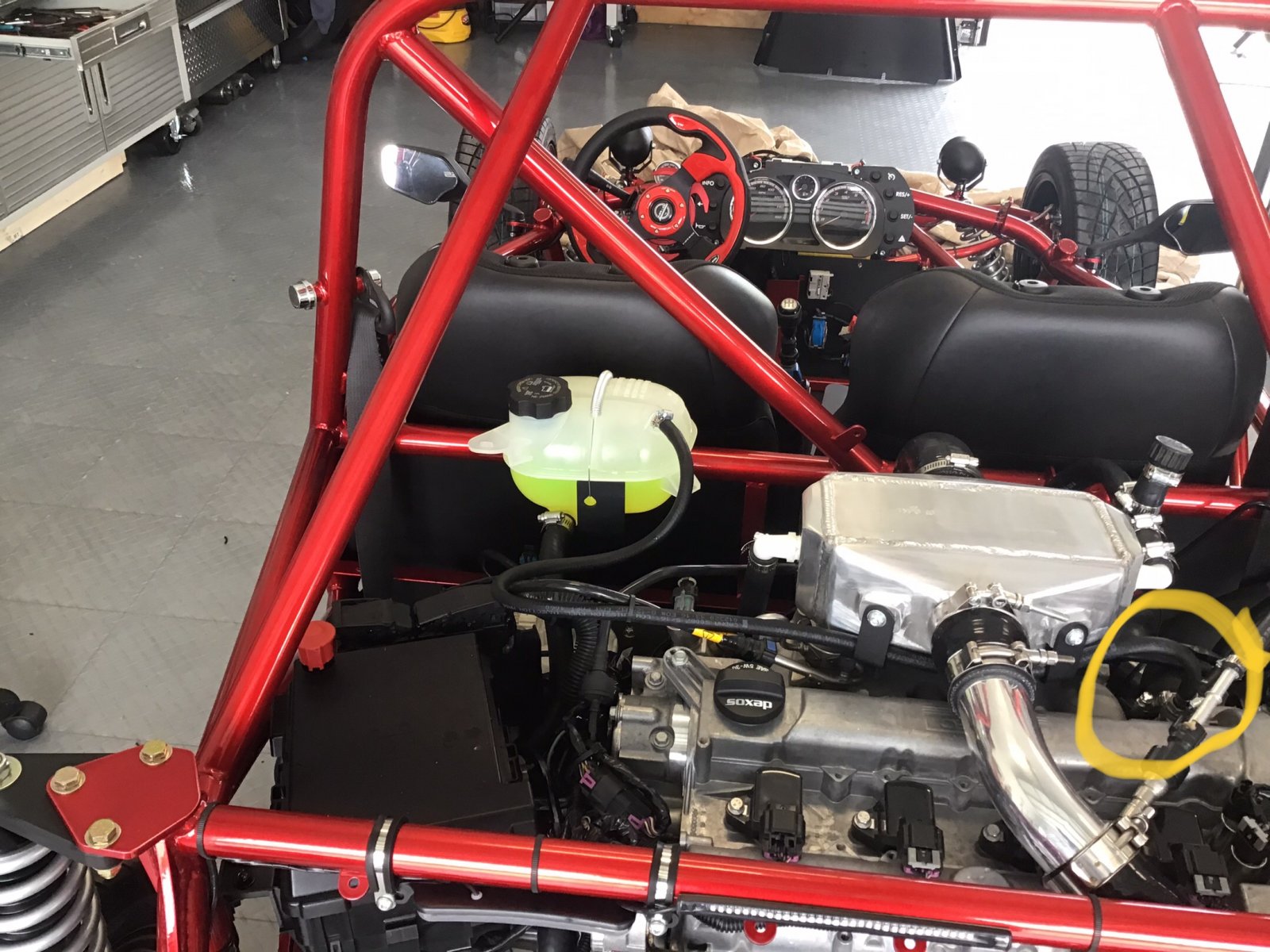

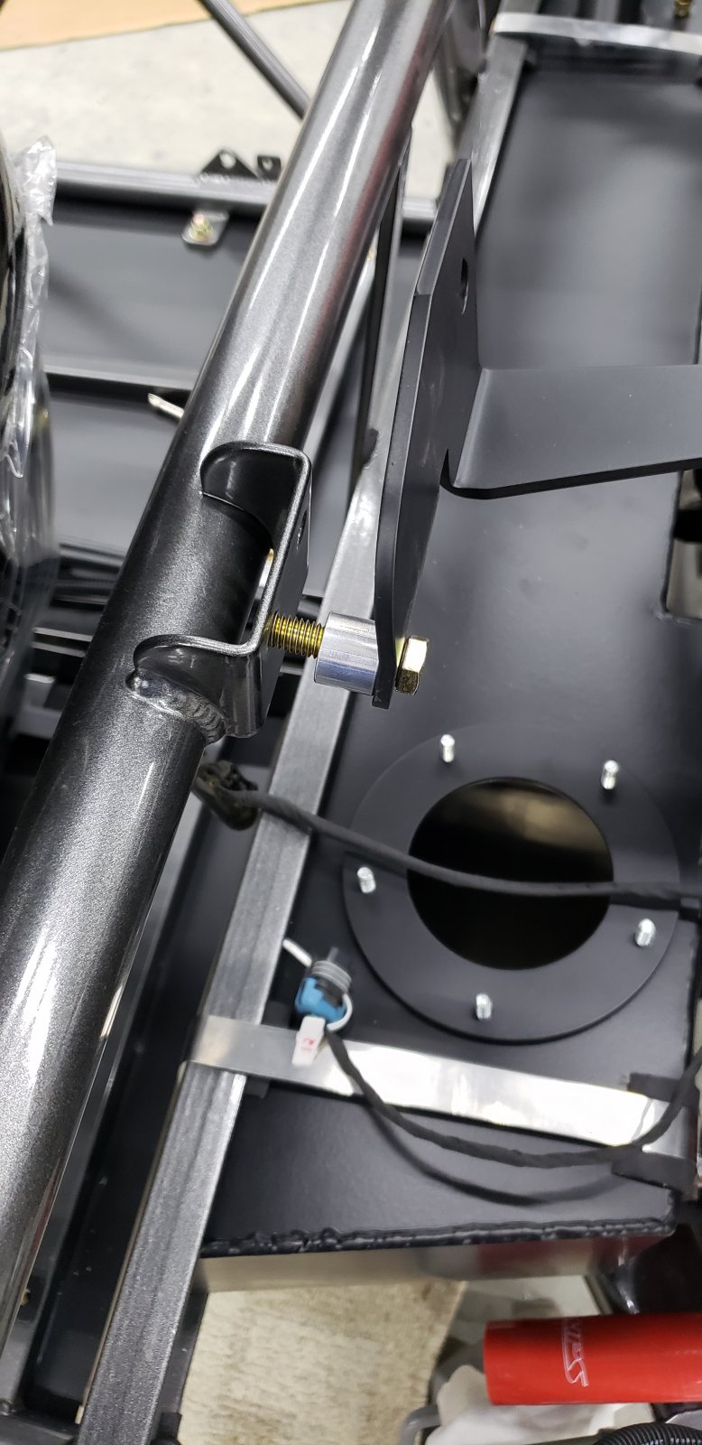

Can someone post a picture of how the mounting bracket for the coolant tank bolts up. I’m confusing myself as to which side the mount goes on
It mounts to the back side of the two hole brackets behind the seats.

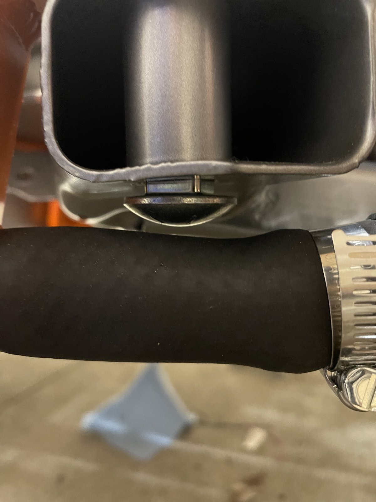

I feel like this may be an issue. I can not get the bolt to go all the way into the subframe
You can stop torquing on it at 100 pound feet... according to the Cobalt specs... for most of us that is right beside "until you can't any more".
baustin
Yep, one of my bolts is like that, the other went fully seated in. Both are fully torqued and haven't been a problem.
