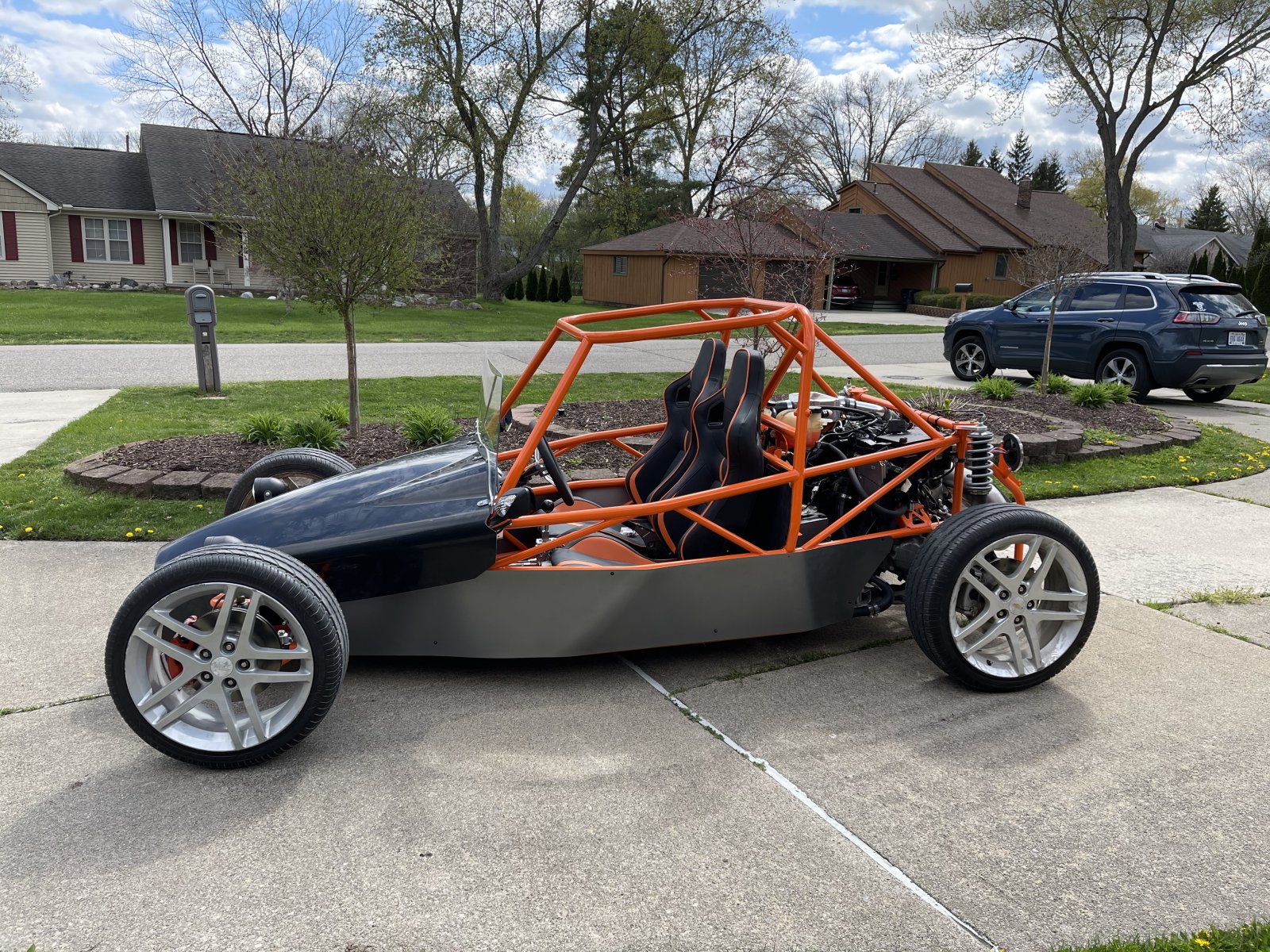

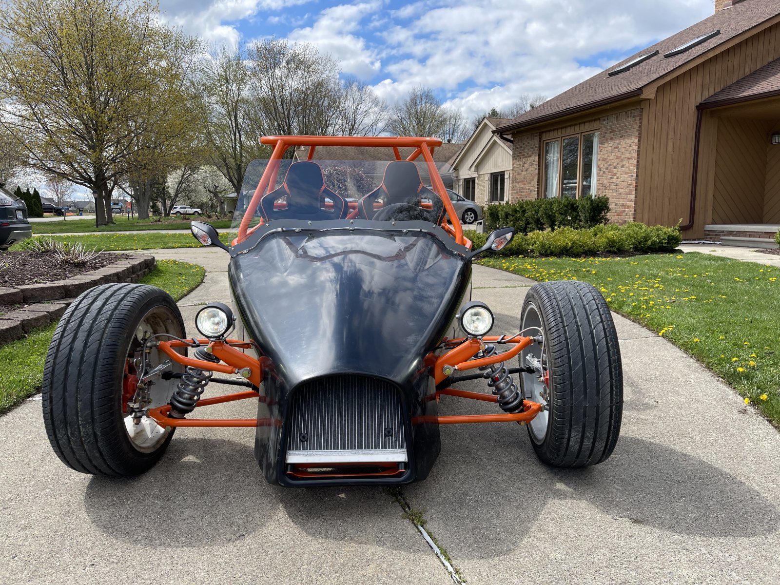

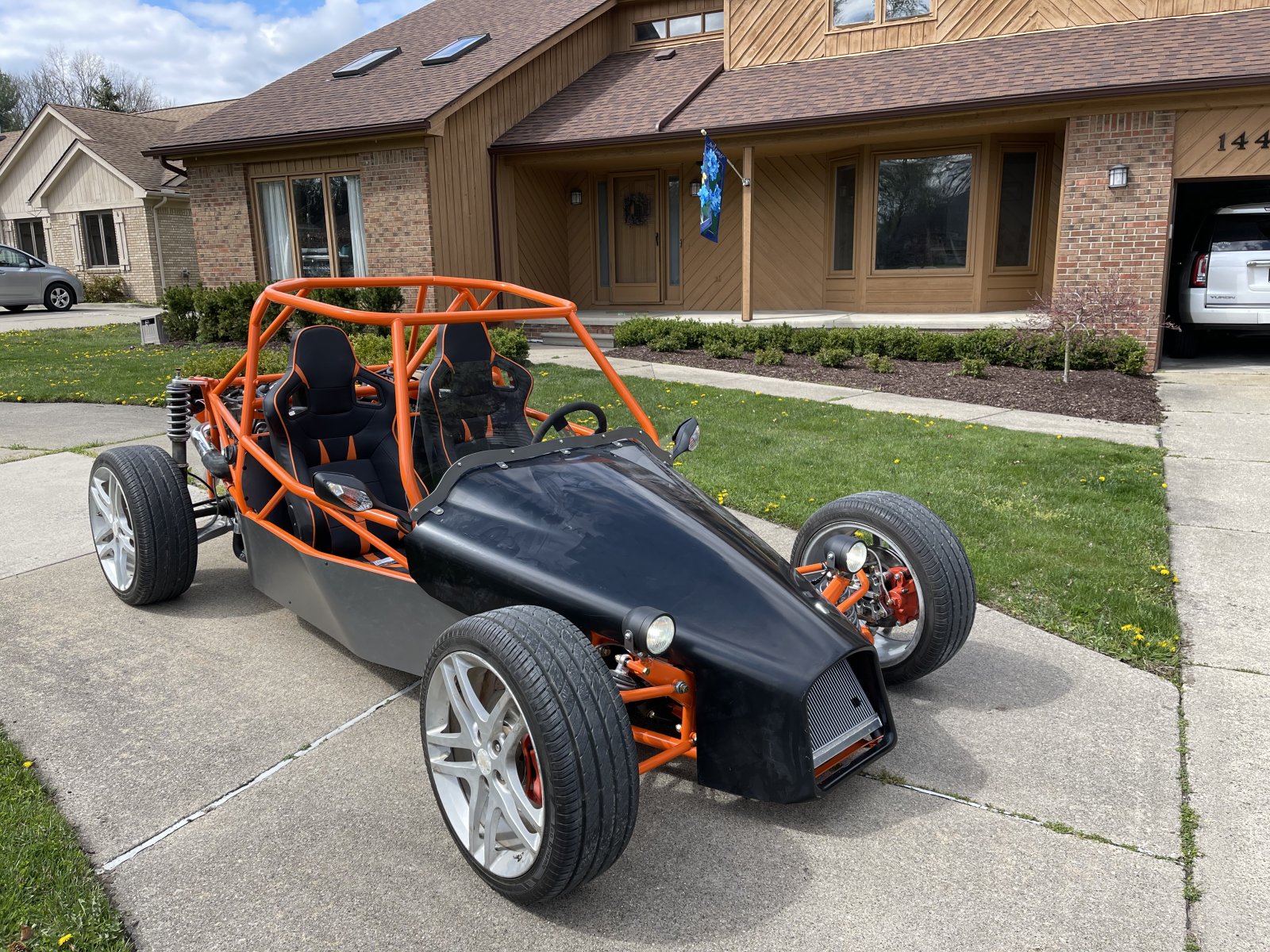

Been out driving in my sub a few times to get some bugs worked out. Finally go my MAF code to go away then developed a miss fire. It was cylinder #4. So I figured it was a bad plug from turning the ignition on an off too many times without starting it. Didn’t fix it. Switch the #1 and #4 coils and the miss moved. What are the odds that I fix one problem and another one popped up. On a good note I’m 99% done with the wiring
