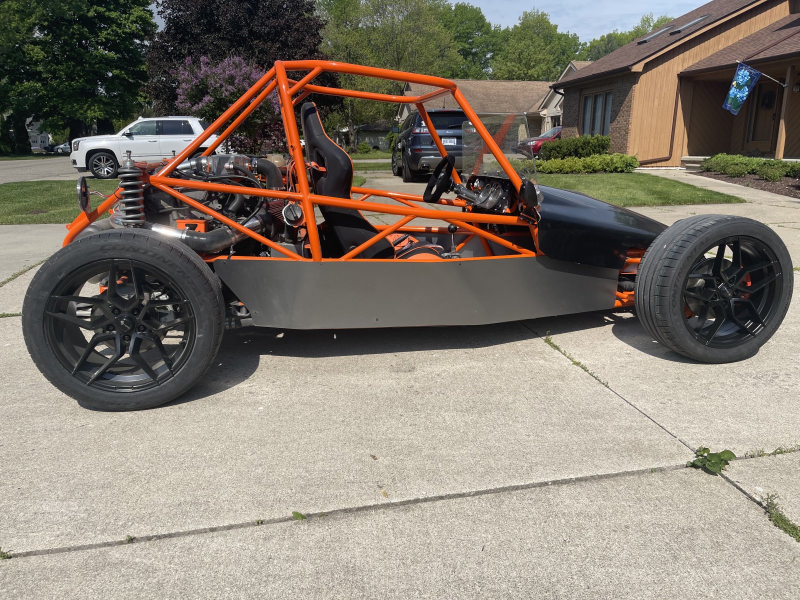

SmsDetroit

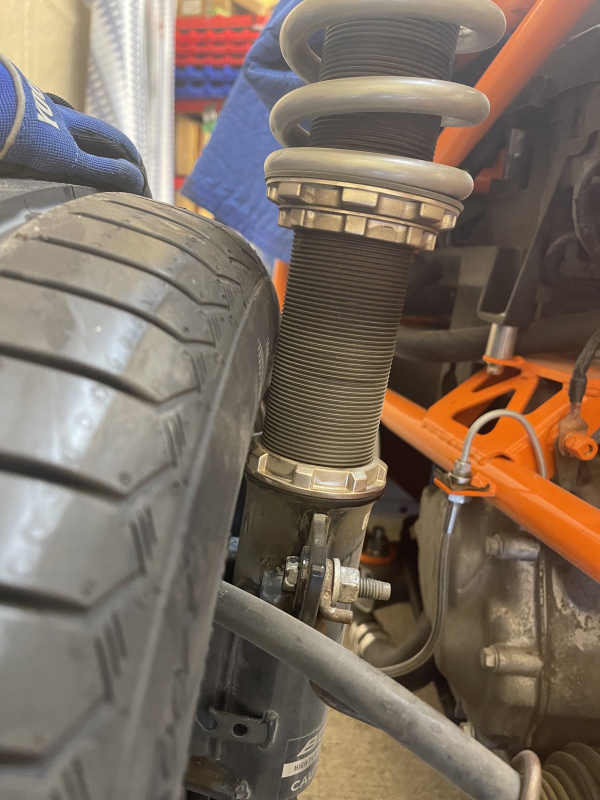

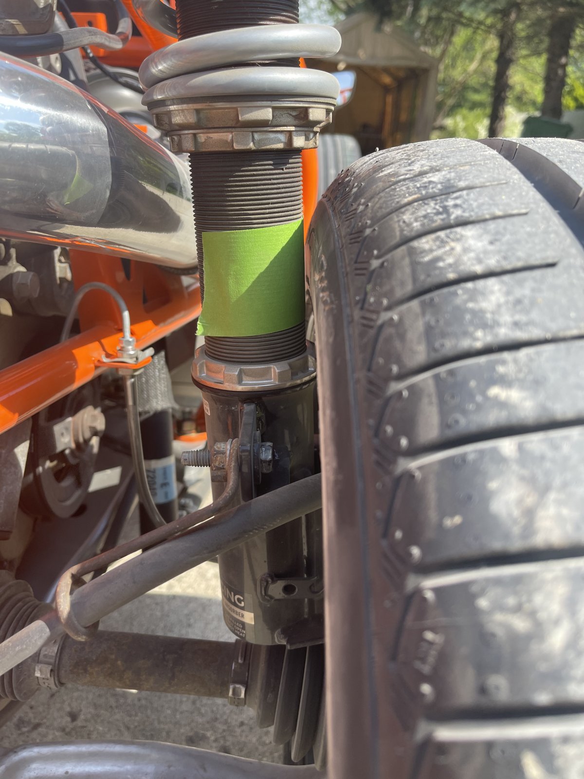

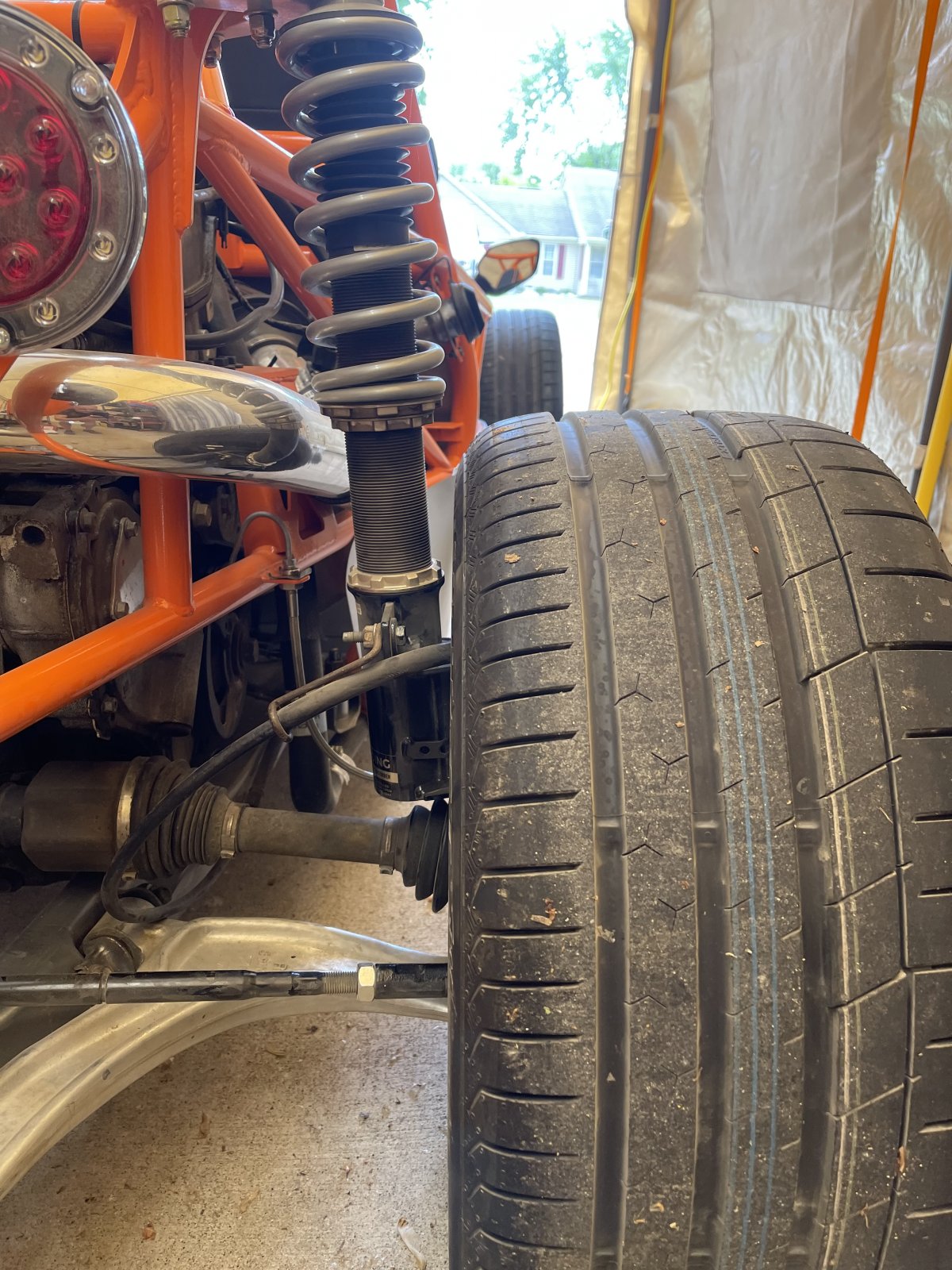

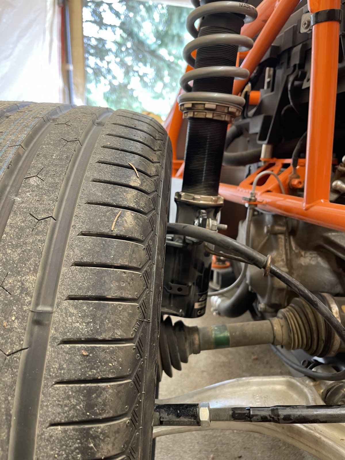

First off the Vors wheels look great. Now apparently I can’t math. The front are 8.5” wheels with 255/40R18. They fit fantastic. Lock to lock with no rubbing. The rears are 9.5” wheels with 275/55R18 the passenger side has about 1/4” clearance and the drivers you can fit a piece of paper in between. I rechecked camber on the drivers side and it’s at -2 deg. Does anyone think putting a camber kit in and pulling a deg out would give me enough clearance. Or should I just put small spacers in.

SmsDetroit
Ordered them. Cost was reasonable $90 each with studs to replace the hub studs. But then they were like oh it will be 3-5 weeks to make them unless you want to buy a “fast pass” and expedite your order to the front of the line for $100. Then we can have them to you next week.
Yeah, I've never dealt with them but have been looking at the options. There are other options, especially if you can just go thin enough for slip on spacers.
5 Lug Wheel Spacers | Shop Bolt On, Slip On and Custom Builds. (uswheeladapters.com)
5X110 TO 5X110 WHEEL SPACER (billetwheeladapters.com)
hubcentric spacers 5x110 65.1 | eBay
TheNuker
Same **** they told me, And that is when I took my hubs/rotors to a local machine shop and had them re drilled for 150$ the next day.
