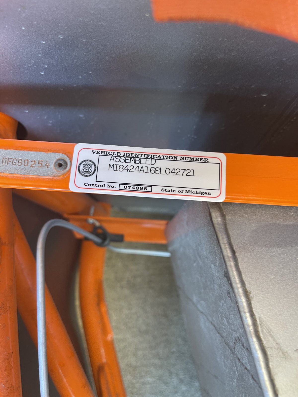

SmsDetroit
Super pumped. Got my Vin today. Only have to wait a few days for their system to update then I can go get it registered.

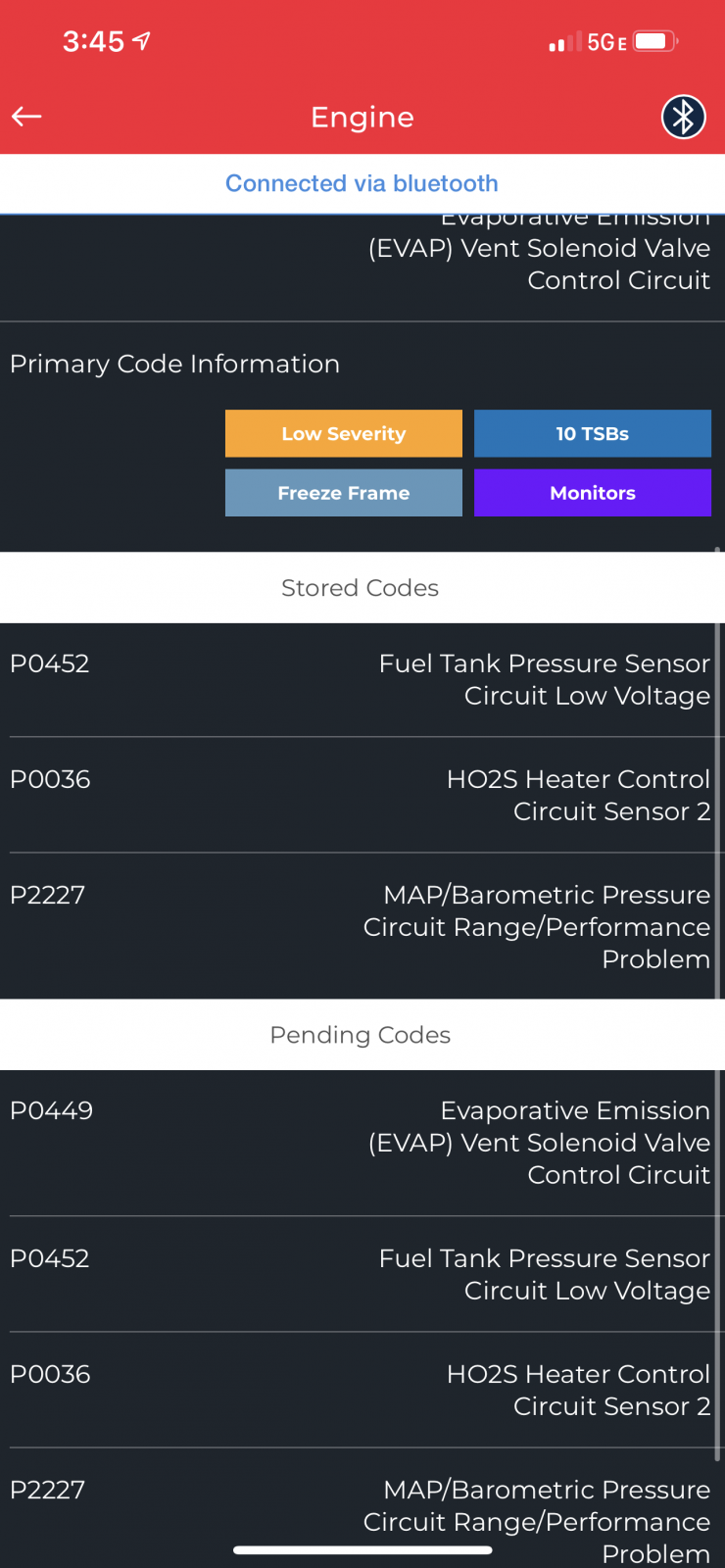

SmsDetroit
When I picked up my donor it had a Map/baro code which is in the ECU. My brother in-law works for bosh who makes the ecu. He got me a new one and programmed it. Now the code is back with the new ecu. I’m hard pressed to think that I have 2 bad ecu. Any thoughts.
Quick internet search on the p2227 code indicates "Barometric Pressure Sensor Performance", which is;
Bad sensor
Bad Harness
Bad connection
Bad ECU
What made you think it was the ECU the first time? I don't have the service manual with me, but it should have the steps to check that particular code, which will likely entail checking voltages and resistance to determine which one it is.

Internet search and seems like everyone wound up replacing the ECU. I got one for free so why not start there. Looks like I’ll actually have to diagnose it

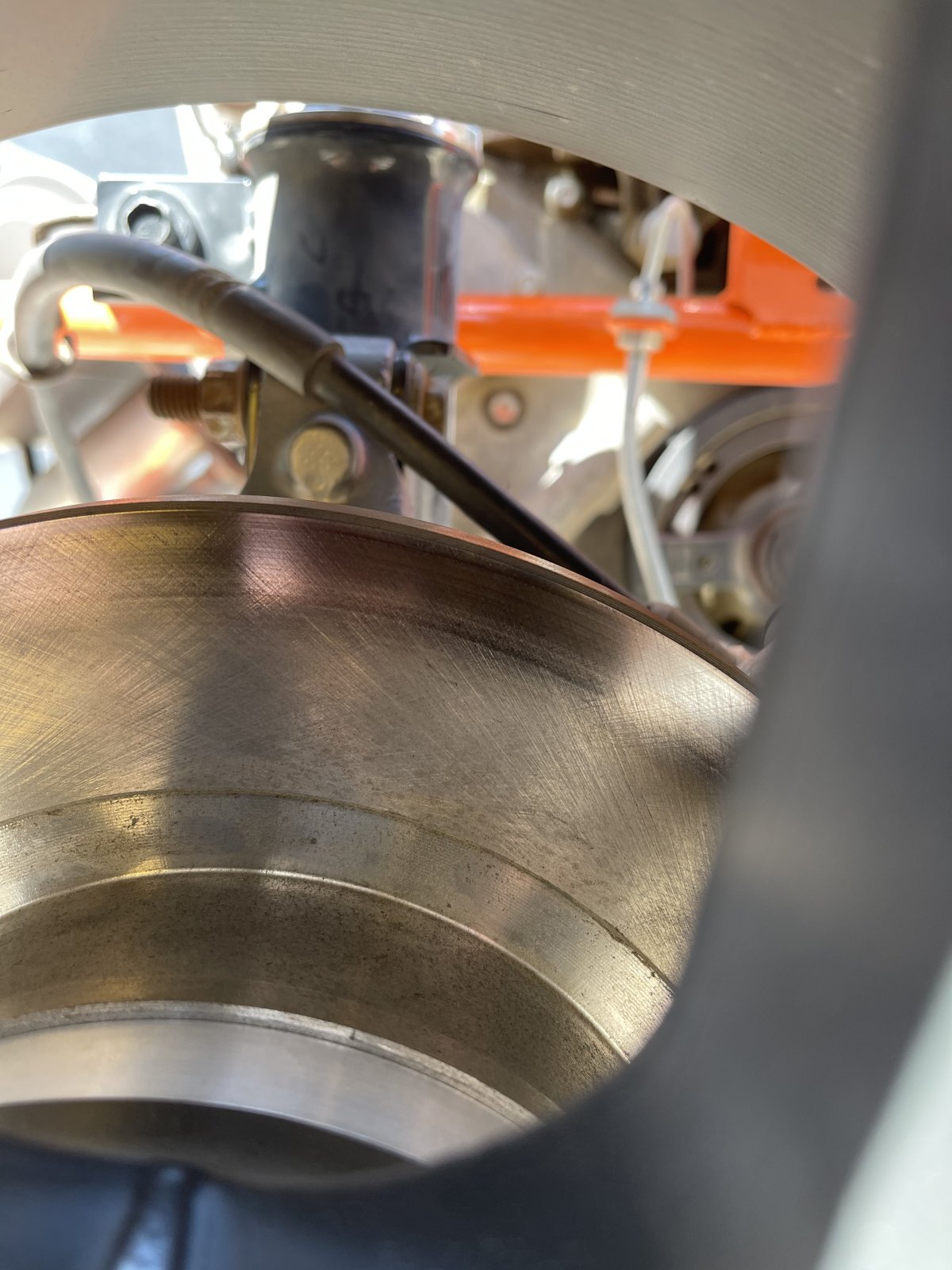

Do my pads need to just be seated from driving or do I have something off. Both of the rear outer brake pads are only contacting the to 1/2 inch of the rotor.

Waterdriver
What does the other side of the rotor look like?
If it's the same, your pads are hanging up, preventing them from sitting flat against the rotor.
The stainless steel shims the ends of the pads sit in are sometimes a pain to get seated properly. You might have to check them possibly.

About the same. A little more contact.
