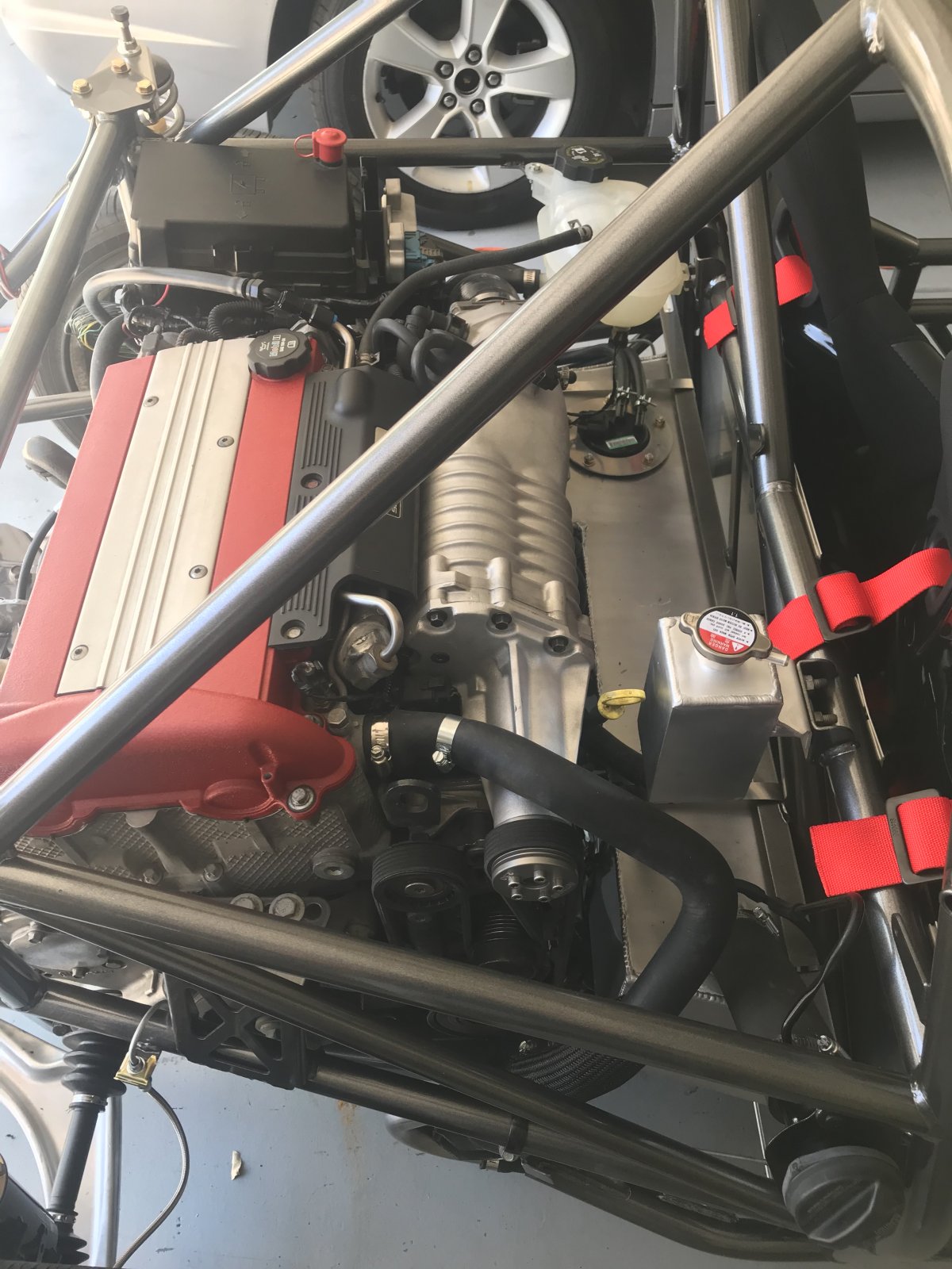

I made one out of aluminum. I also have a stock coolant reservoir that I considered using, but it was a bit big.
