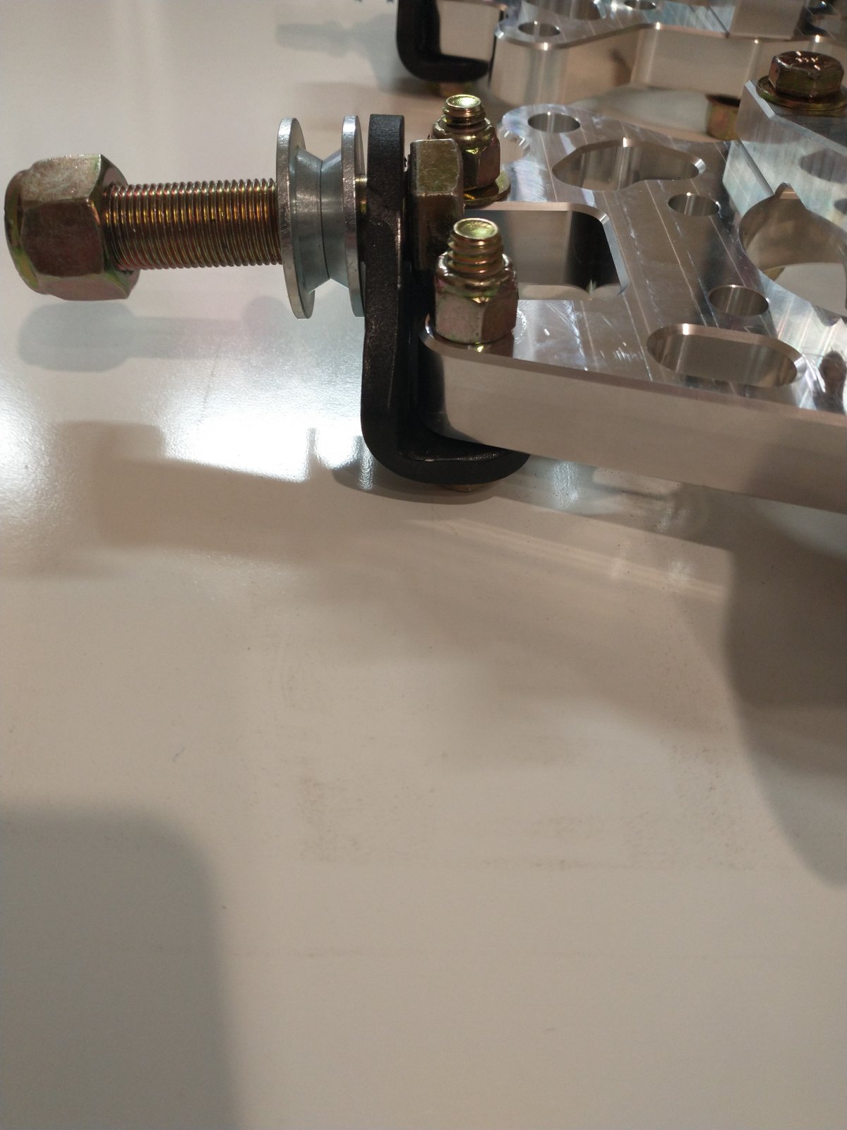

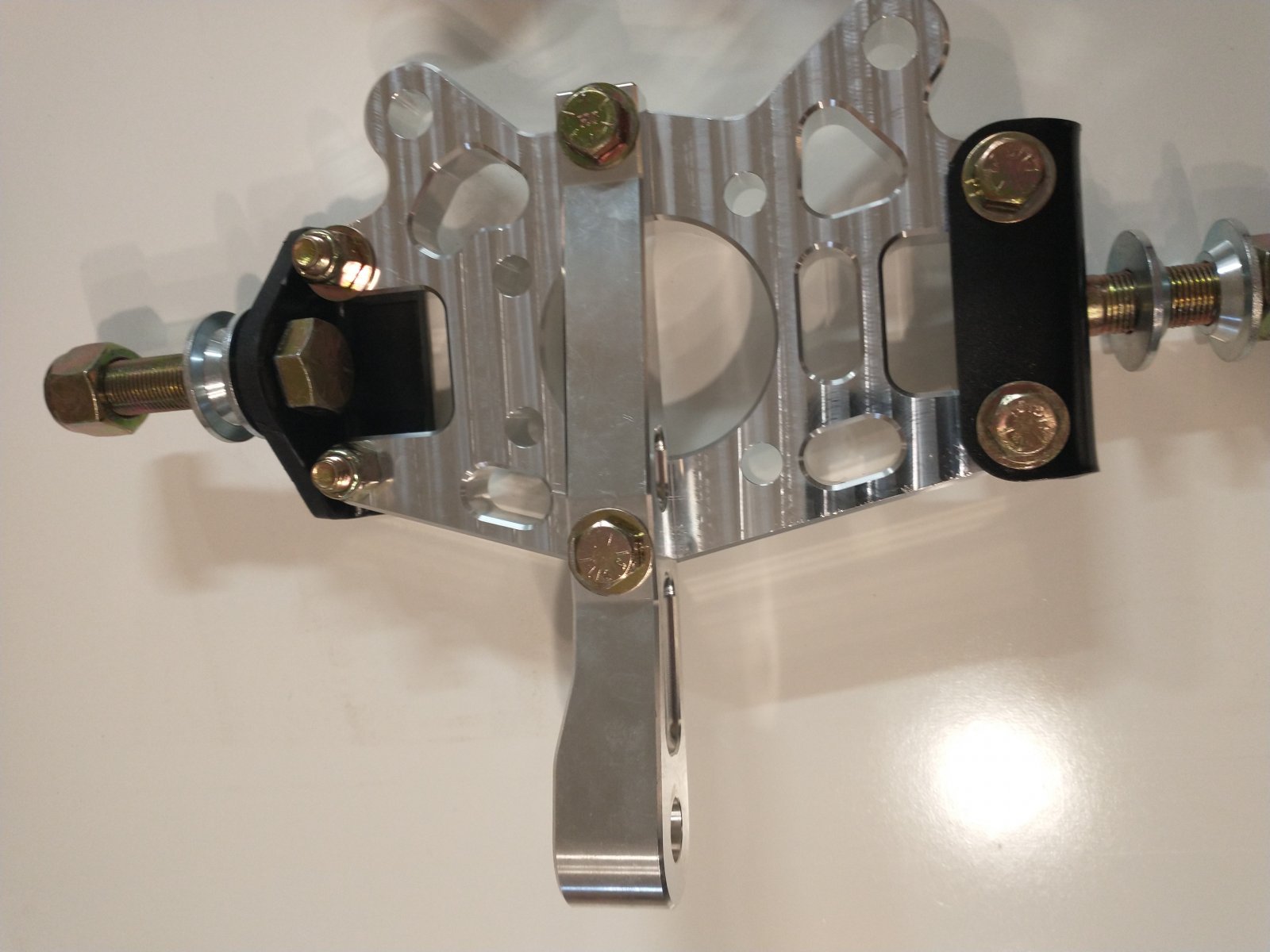

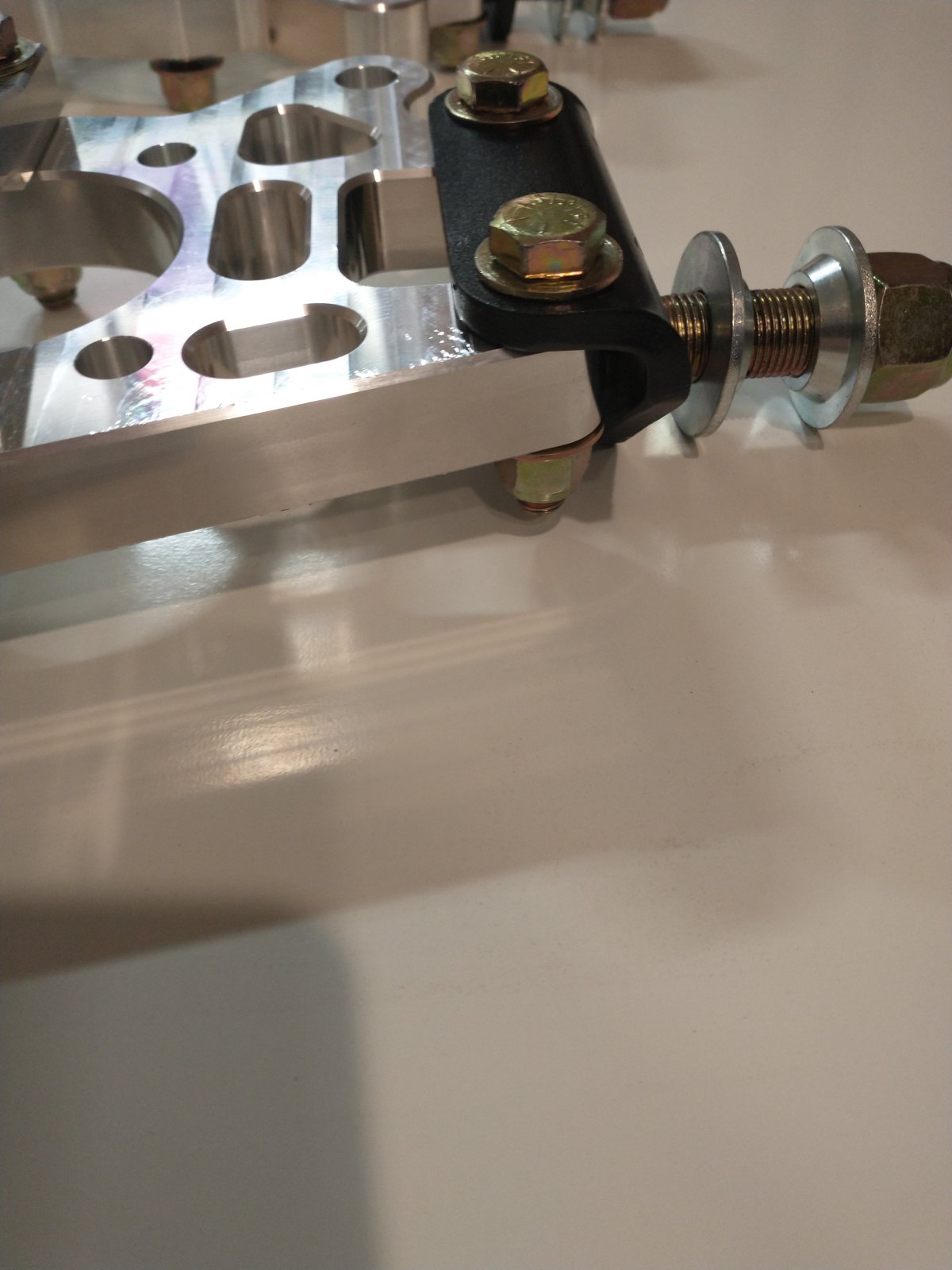

It appears to me that the newer-style rod end mounts have an offset that is opposite of the old-style billet mounts. So when I assemble the uprights, I need to mount them opposite of what is shown in the old video. Looking for confirmation and clarification from the forum. Don't want to compromise safety. Pictures of my assembled uprights are attached

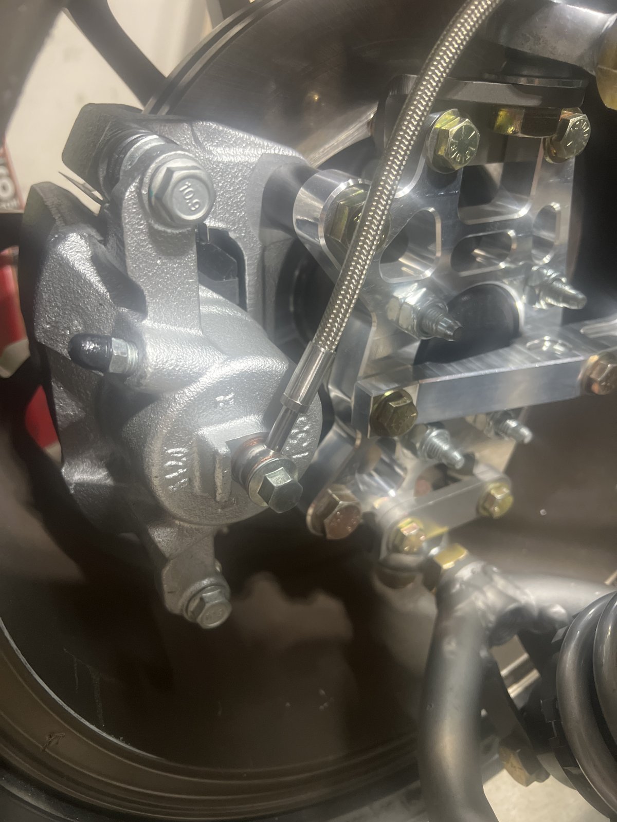

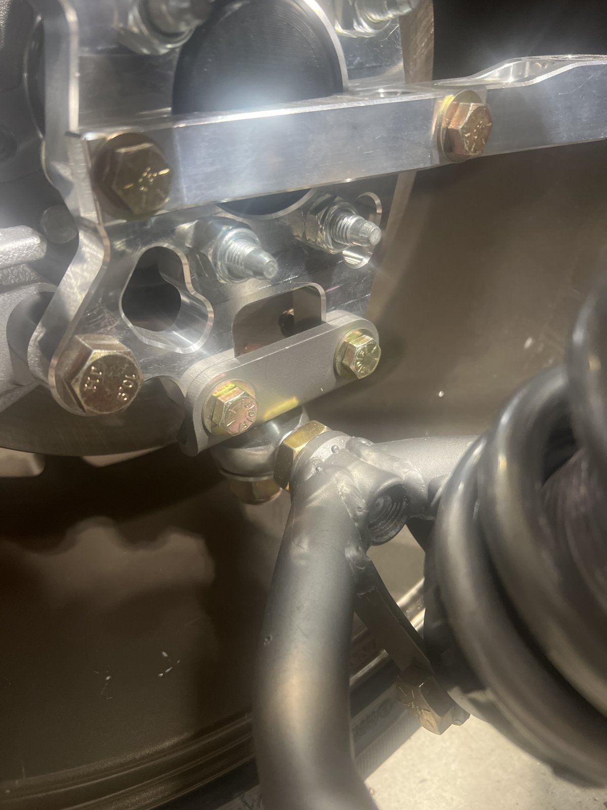

The knuckle you got pictured will be for the driver side.make sure when you do the passenger keep the control arm brackets the same way. Your tie rod attachement will be flipped.here a picture of my passenger side Iam currently installing rack limiters so my tie rods off
