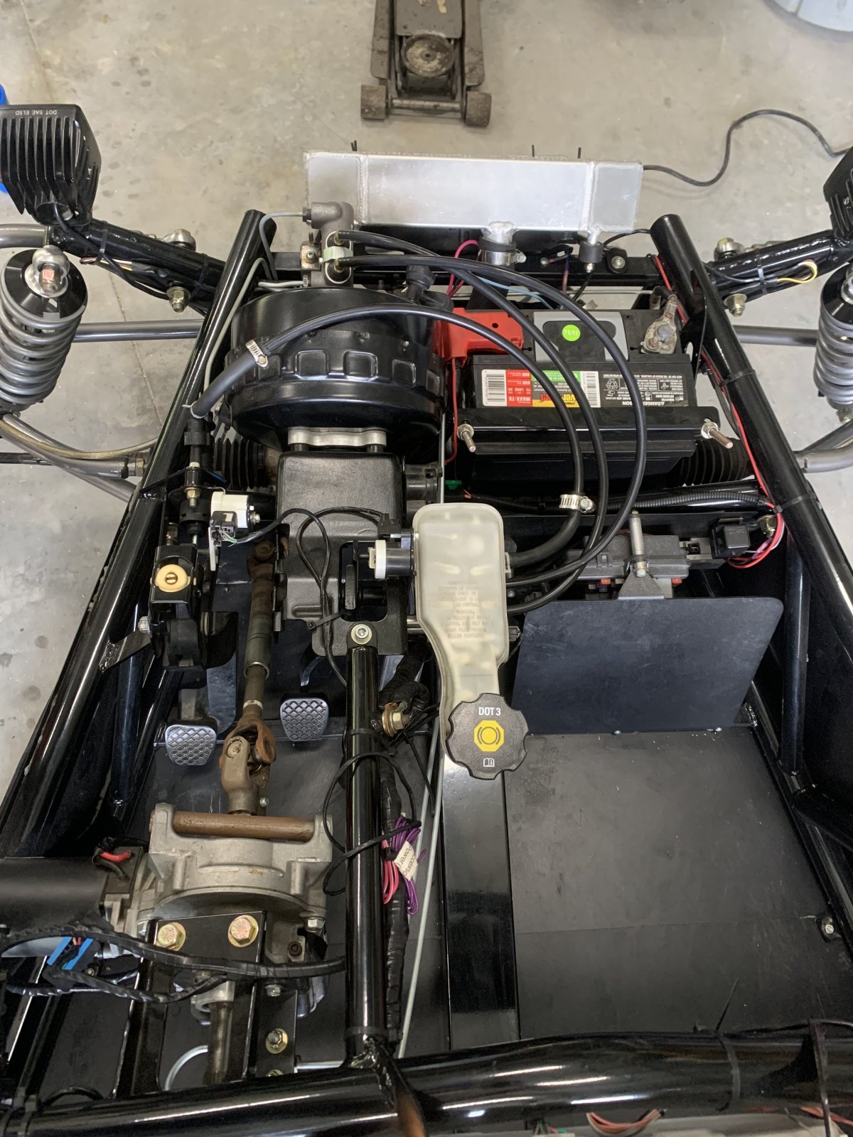

I recently got a hold of the proportional valve kit. Pretty easy to toss in. Now I just have to bleed the brakes. I hit the brake pedal knowing the fronts would be soft but the rears don’t feel like they’re hardy working. Maybe that’s just because it’s off and the whole system probably needs to be bled but I’m hoping this prop valve helps a lot with the fronts locking up hard.

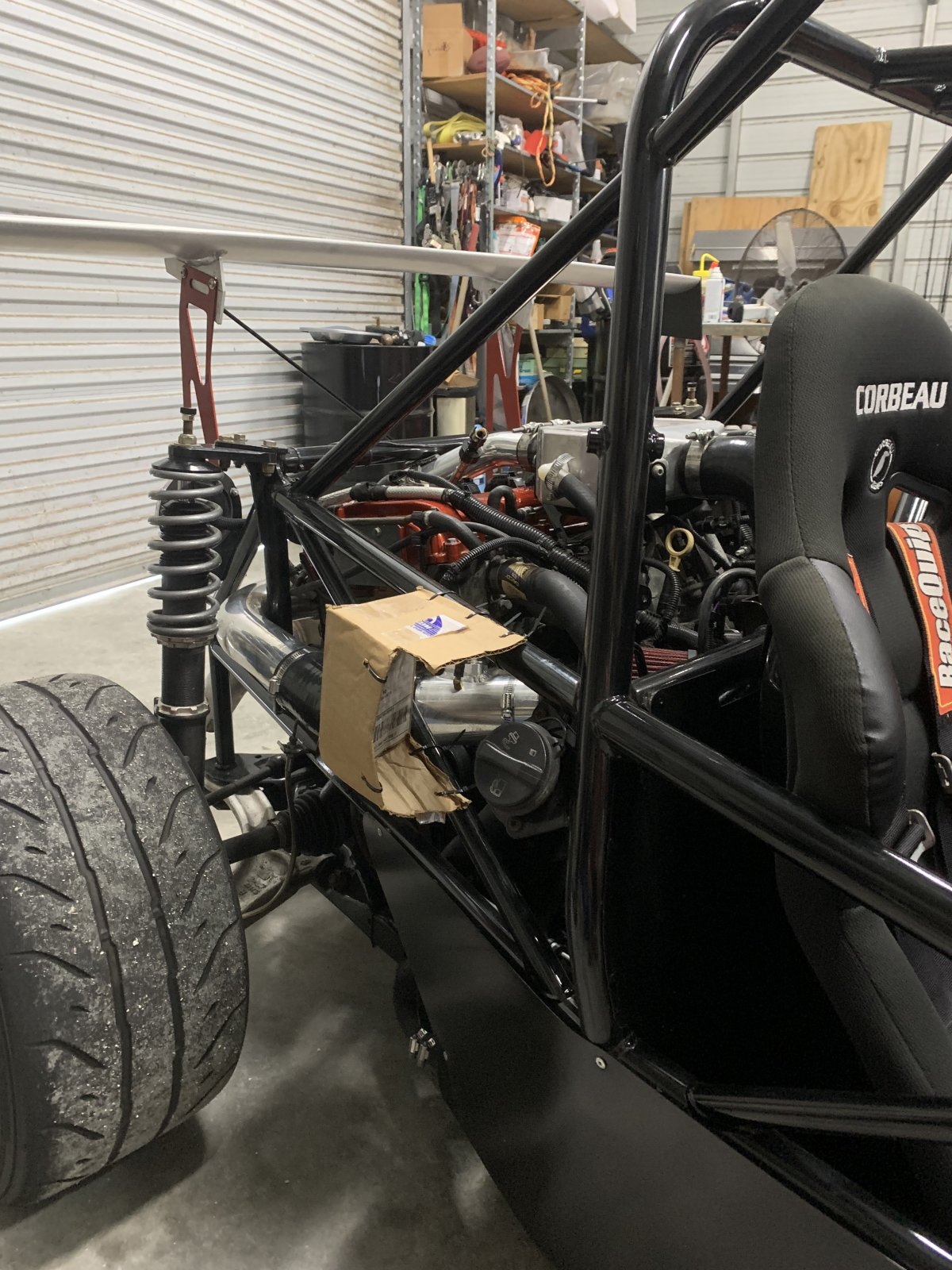

Since buying the aero force gauge I’m on the quest for cool air. Before I move the intake I’m curious to see if this will help.
I have a “scoop” used as a deflector between the radiator and heat exchanger and it seems to work well. I ordered another to put underneath the car to help the puller fan while it’s rolling. Being able to see KR, iats, and AFR makes me feel better about this heat.

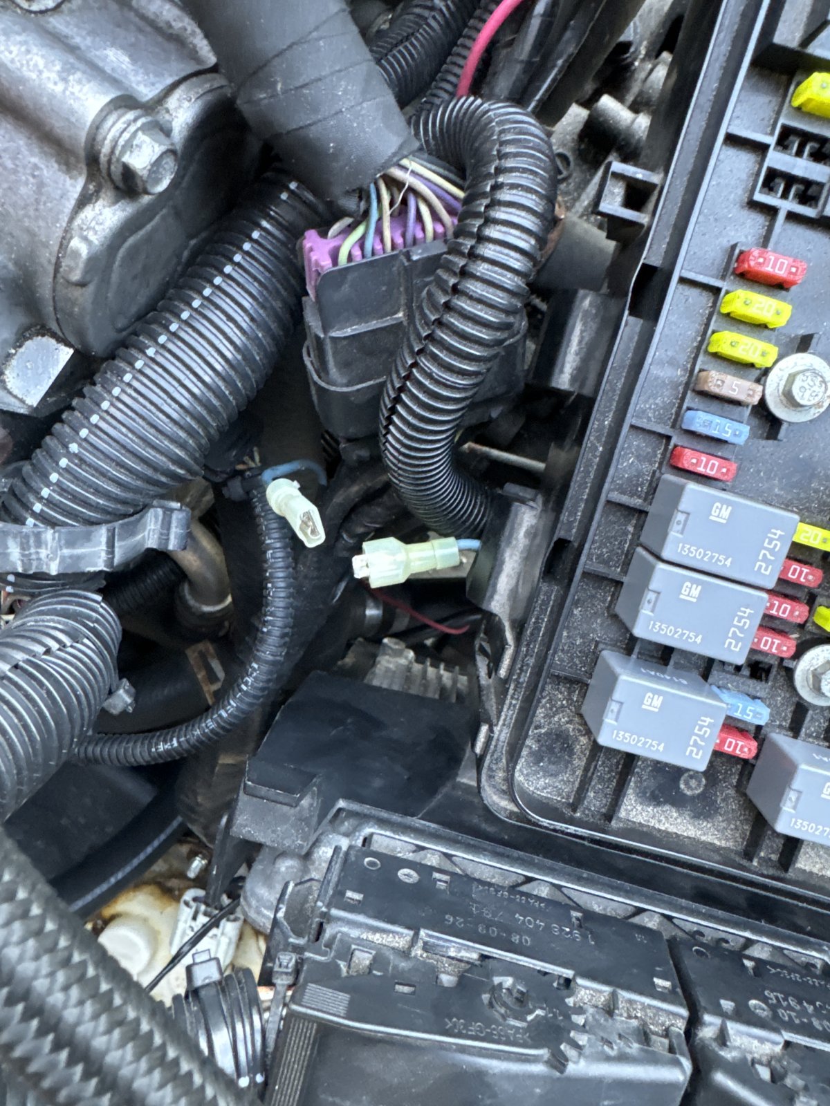

1. Coolant fan has never kicked on even with the start temp set at 192. I may have wired it wrong being that I had two different blue wires leading to the fuse box? Neither of them had any power even once the car was hot enough to kick on the fan.

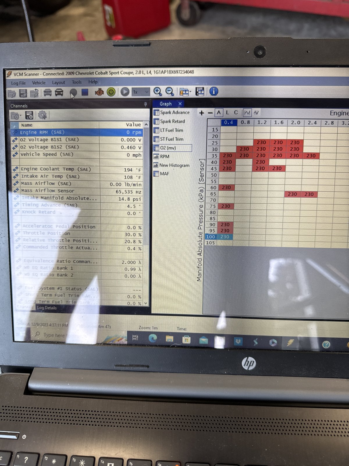

2. O2 sensor is “reading” but is showing no MV on one side of hptuners and saying 230 on the graph everywhere? I checked the grounds and I have a new O2 sensor. It keeps going into cl-fault, wanted to adjust the tune but then realized the o2 is inaccurate from being 0mv all the time.
I’m just kinda lost with it and wonder if it could be a pcm issue or I’m just missing something.

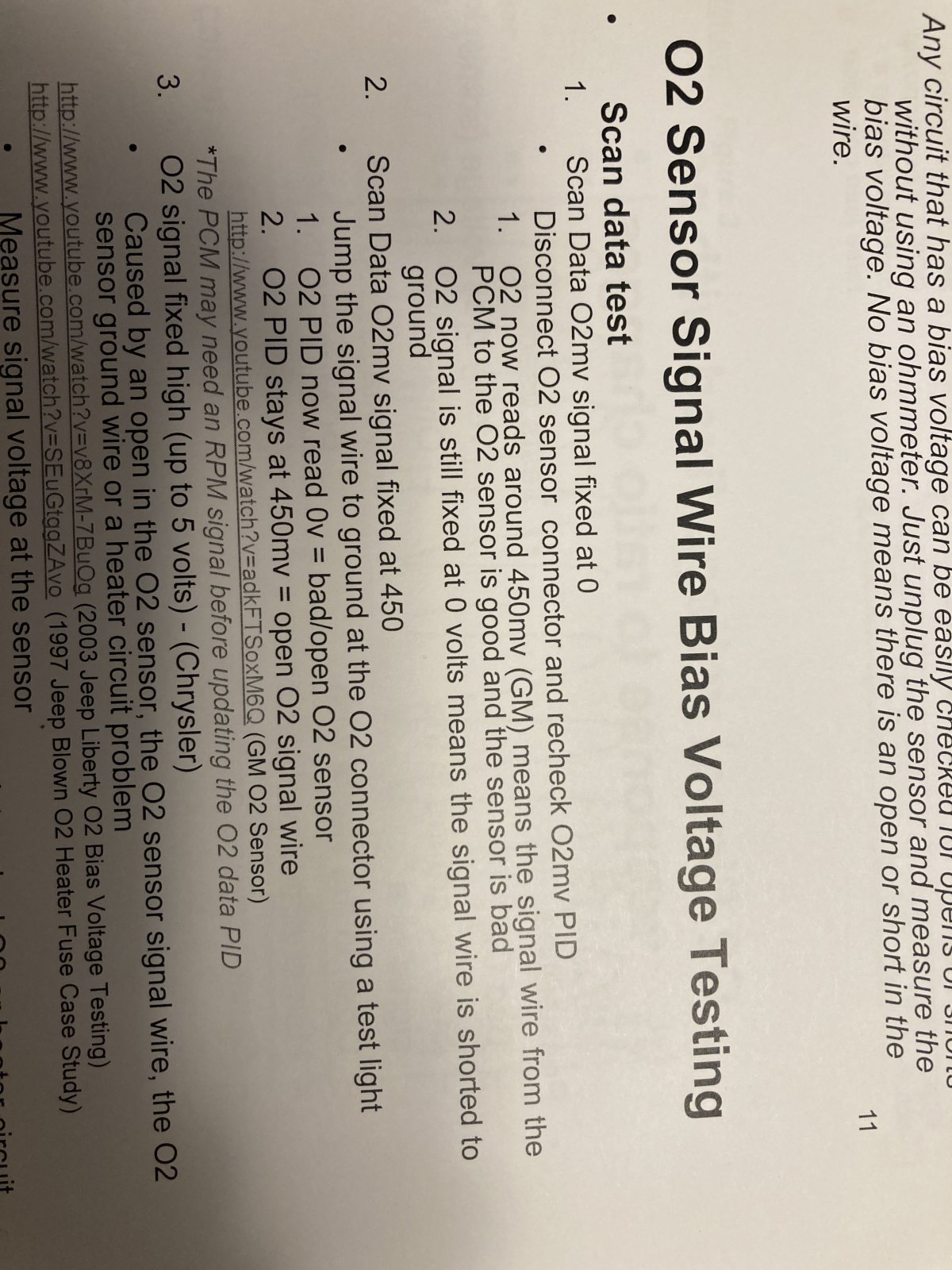

Short: 1st place to look is the wire harness and connectors that has been modified. 2nd place to look is the O2 sensor, check for a direct short (zero ohms) between the connector pins. 3rd place (and the least likely) is a problem with the PCM. The O2 sensor needs to be working before tuning.

I have a multimeter but I’ll have to see if it has smaller ends to fit in the plug. I guess the fan might be shorted but I don’t even know if my wiring was correct the whole time. The video shows one coolant fan wire and I had two when I got the harness. It wasn’t linked in to the 30amp fuse block.
I didn't really tie this back to you post on "LNF trims". I just studied your logs and tune and commented in that thread. I'm not sure what you should be checking for o2 voltage in the LNF pids, but it appears your o2 sensor is working. What I posted above applies to narrow bands o2 sensors. Maybe wideband also but it won't have a 0.450 volt bias voltage. HPTuners is not the best at being a diagnostic scanner.
Just checked the service manual and it doesn't list expected voltage for the B1S1 wideband. Only list it for B1S2 narrowband. This indicates that the HPT values probably don't mean anything for the wideband.
Stretch2126
So would the cl fault just be from being lean? Unless my table I made is wrong again I’m confused about the -90 percent on my scan. That would also make a lot of sense considering the b1s2 “holds” 460mv even though it doesn’t exist.
