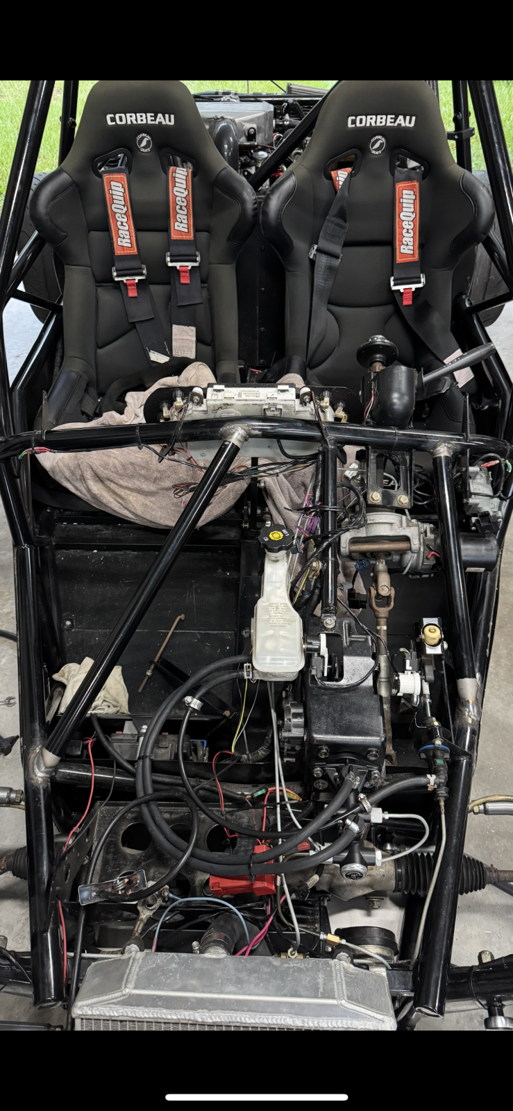

After changing all of the rod ends up front the car still rattles on hard brake and clutch gets weak at high rpm. Just did a fluid flush so it shouldn’t be that. Anybody ever have to replace a rack and pinion? If I lift the front off the ground and grab the front wheel and turn it, there seems to be a slight “numb” spot or loose spot in the center. As for the clutch I wonder if the feed line from the reservoir is collapsing or something past the master cylinder.

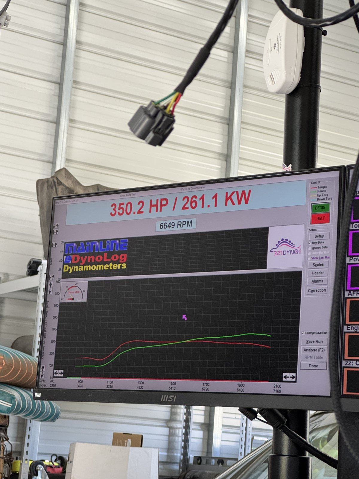

Ran the car on the dyno today with the Zfr and a modified version of the zzp goblin intake. I added a piece of straight 3 inch to help give the maf room for better flow. Best run made 350whp but even better the power curve is fantastic compared to what I had tuning the ko4. Still sorting out some maf issues and closing up plug gaps. Either spark blowout and/or coils failing was giving a little bit of missing up top.

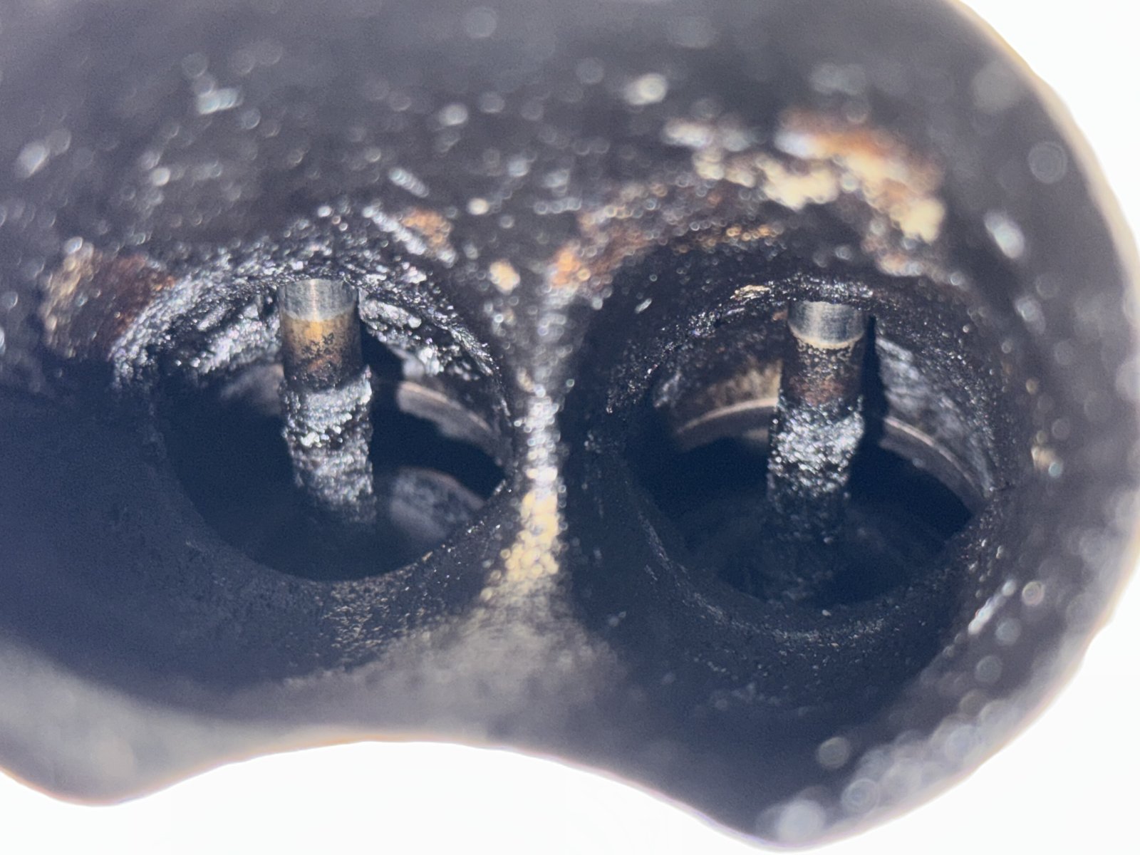

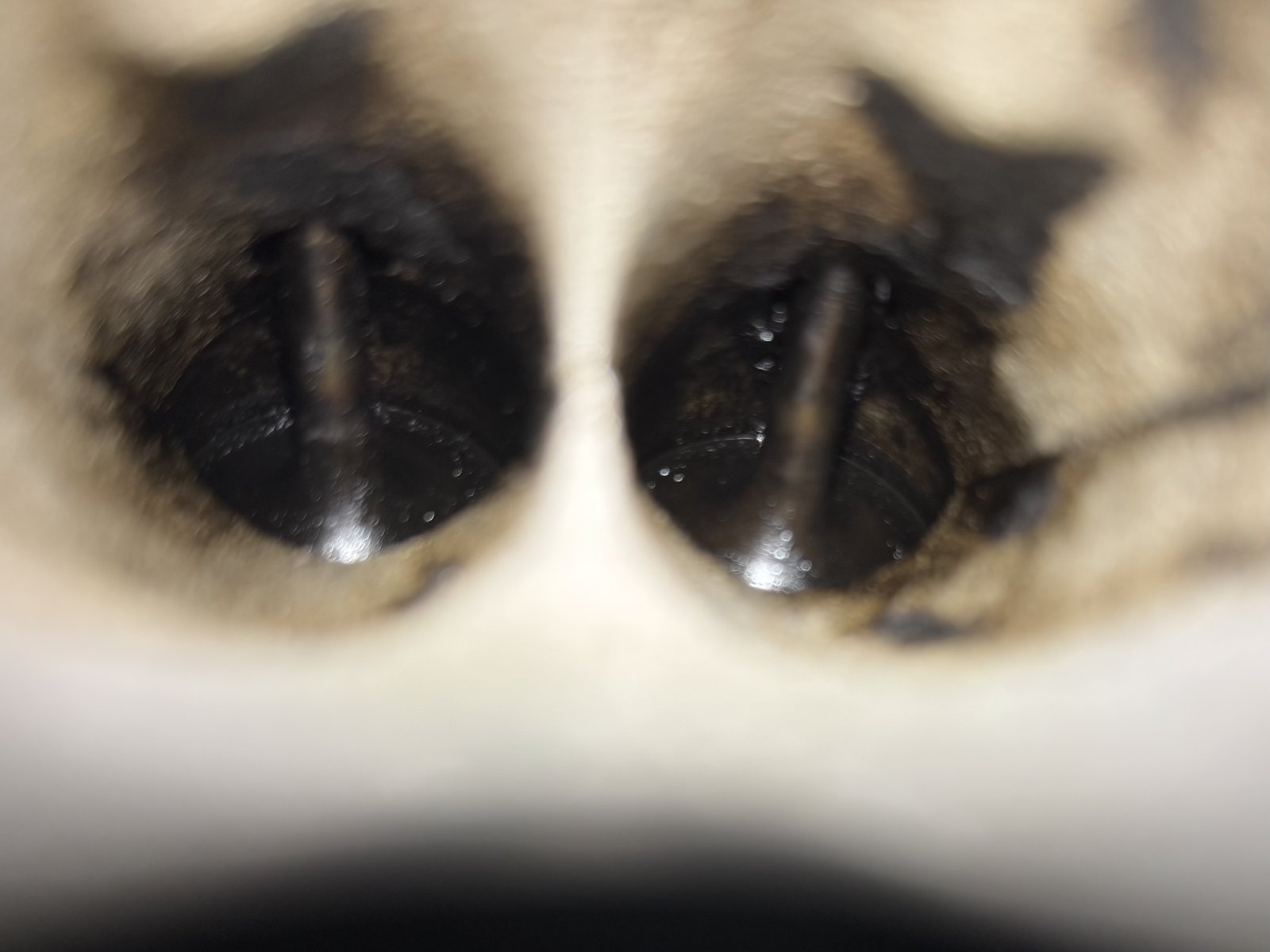

Valve cleaning time finally. Had another PCV valve go out I think in the engine. The first one was definitely bad cause I could blow air both ways. This time I can’t but it had the same symptoms of pushing oil thru the turbo seals. Compression is still good and plugs look good. No misfires or anything. I think some gunk got in it or the meth injection doesn’t agree with the seals.
Anyways, I’m plugging the intake and routing an external check valve thru a catch can sorta like powells v3 setup and cleaning my valves while I wait. Didn’t realize how gummed up the runners were until it was caking up the brush. I’m using gdi intake valve cleaner and an assortment of brushes and air. The black marks you can see on the clean side isn’t the gummy stuff but leftover dissolved liquidI just couldn’t reach. It splatters when hit with air.

Still working on that similar issue that Ross had a while back (hard braking wheel hop). Tried some additional bars to stop what seemed like framed flex but it looks like mine is from elsewhere. Tried different wheels with 22mm offset at 18x9.5 and the problem still persists. Hubs still feel tight and rod ends are fairly new. Going to put new outer tie rods on but the steering all feels tight still. When turning the wheel on the ground you can see the rack move slightly from the holes in the rack and bolt clearance but I don’t think that slight movement would do it. Later on this week I might search for a cracked weld possibly on a lift but I haven’t seen on yet.
