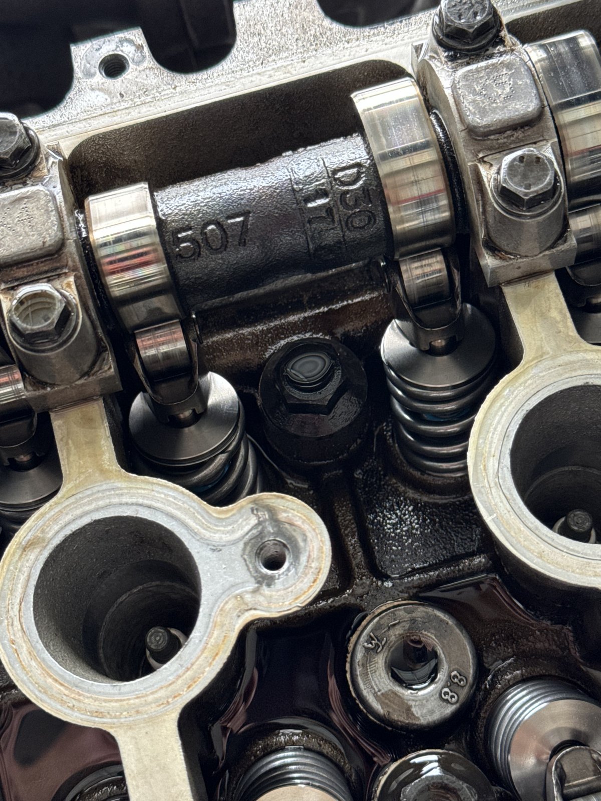

Valve spring let go on the exhaust side. They’re only a month old and I was easy on them the first couple rides. Installed heights were all close so I’m not sure if it was just a lucky one. Now trying to find out if the valve is bent, burnt, or seat is knocked.

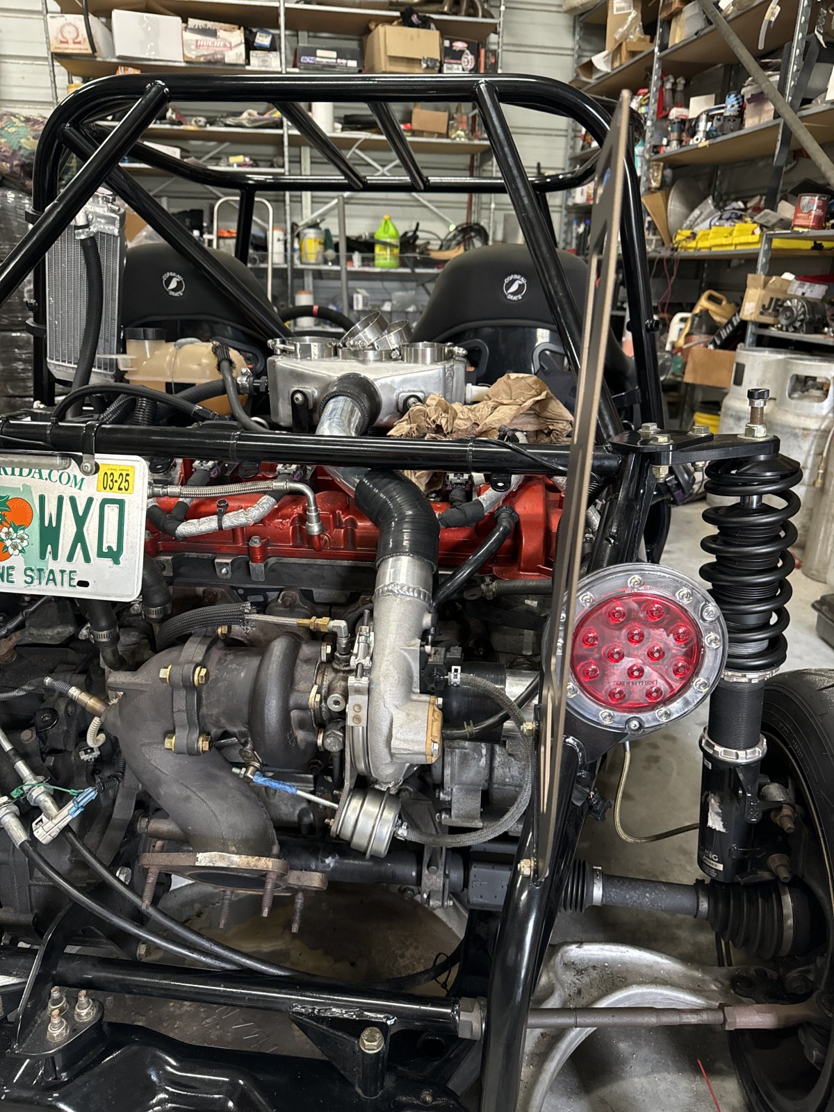

The time has come for the ko4 to step aside. Got a very slightly used Zfr 6758 from a friend and stayed up late putting it on. Where I’m at in Florida we are going to see rain everyday for a while so tuning and driving won’t happen yet, but hopefully in a few weeks it will be close.
