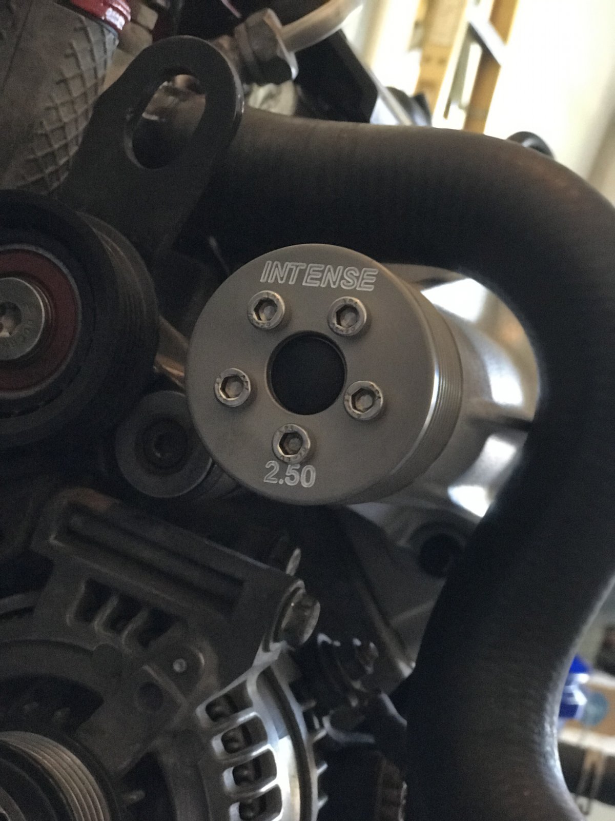

2.5” pulley. 60lbs injectors. Also the tune to go with it all. We will see what Intense says. I guess worst case, I go with smaller pulley and stock injectors. The headache is not worth it. Intense says it will all work with their tune, so I will put it in their court.
