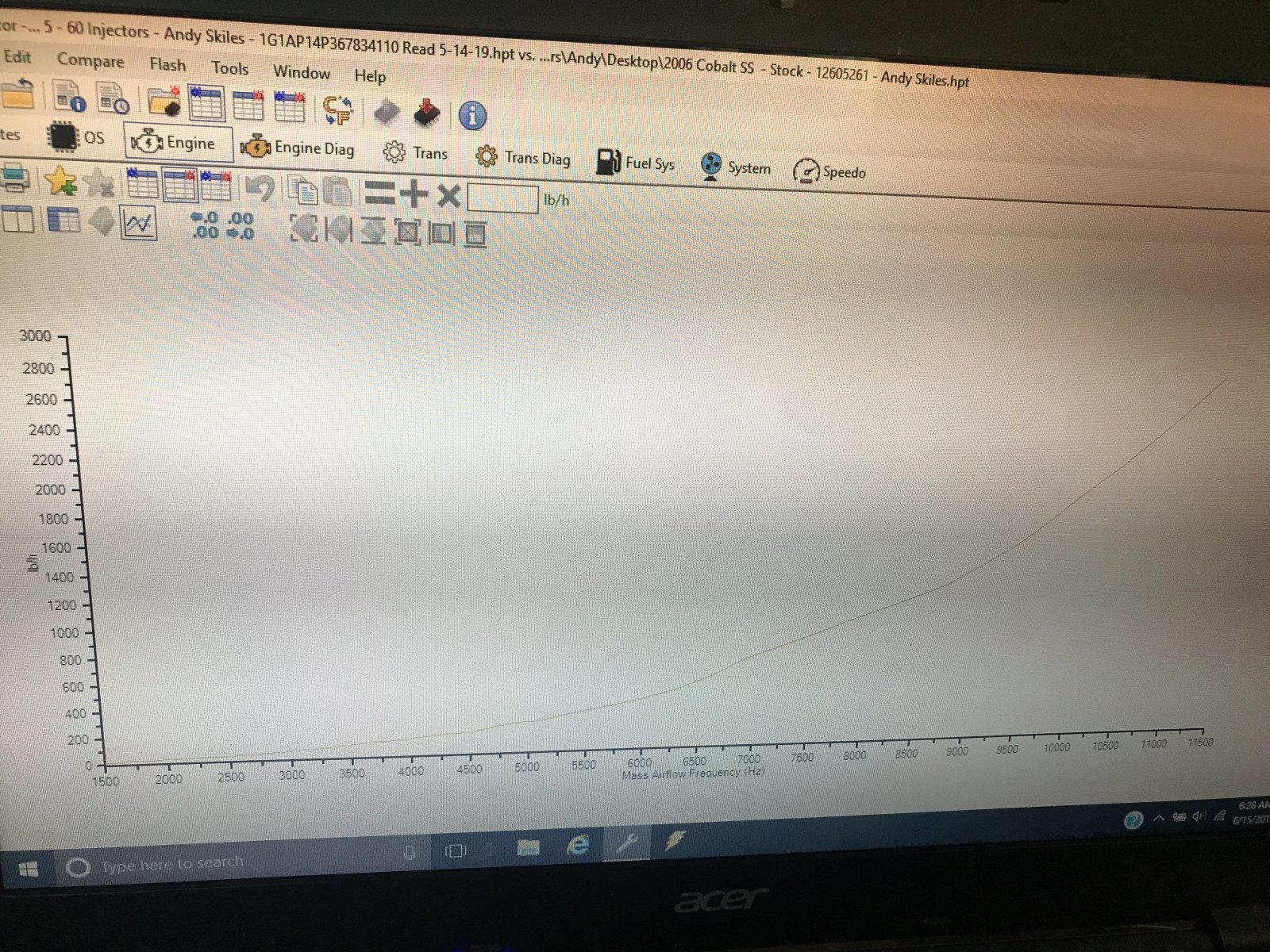

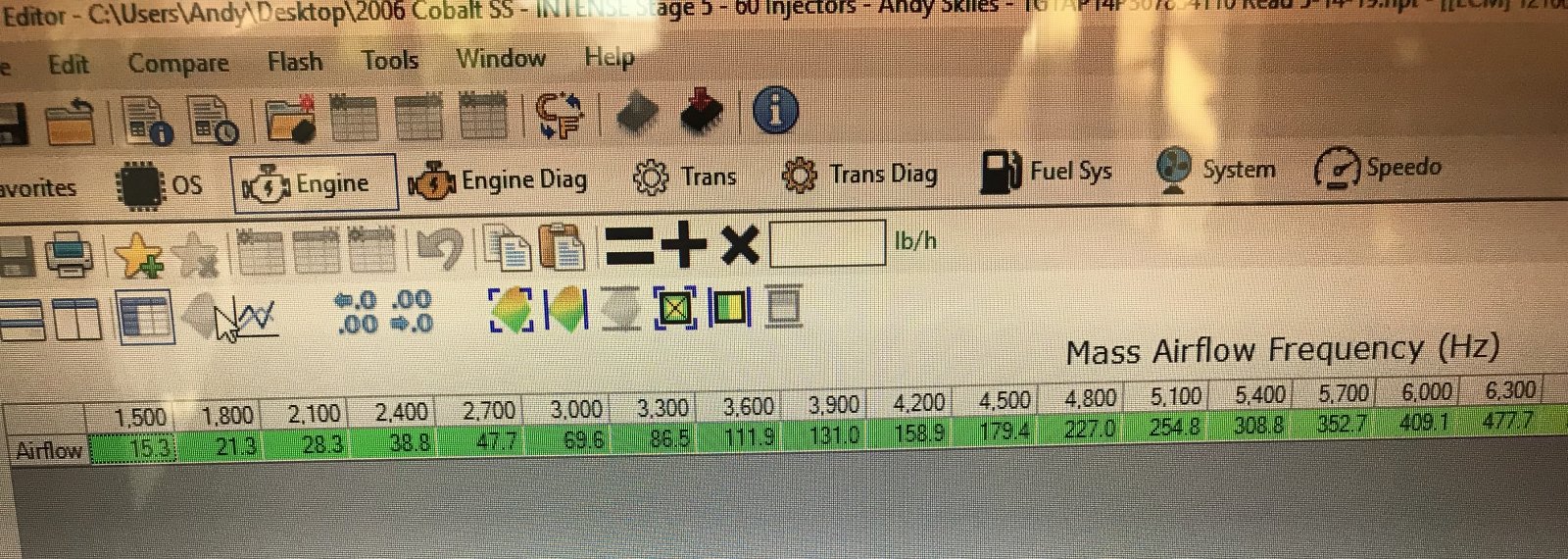

askiles
Comparing my table to the stock tune, it is all the same until 7,500 RPM where he added a tiny bit to it. How is it our values are so different??

I loaded on a stock tune and it still surges.

Try changing the mass airflow vs frequency make the number larger in the first 4 cells. besure to save the original settings. then after making the change save the new program with a different name may be add a 1 or an A etc.

I can try that. Not sure it will do much, as the table starts at 1,500RPM. The idle issue is well below that. It’s worth a shot though.
I also loaded a tune from the repository and another member...also surging. I may need to take it to a shop that can smoke the intake just to ensure there is no leaks. Then I can be 100% certain it is a tune issue.
