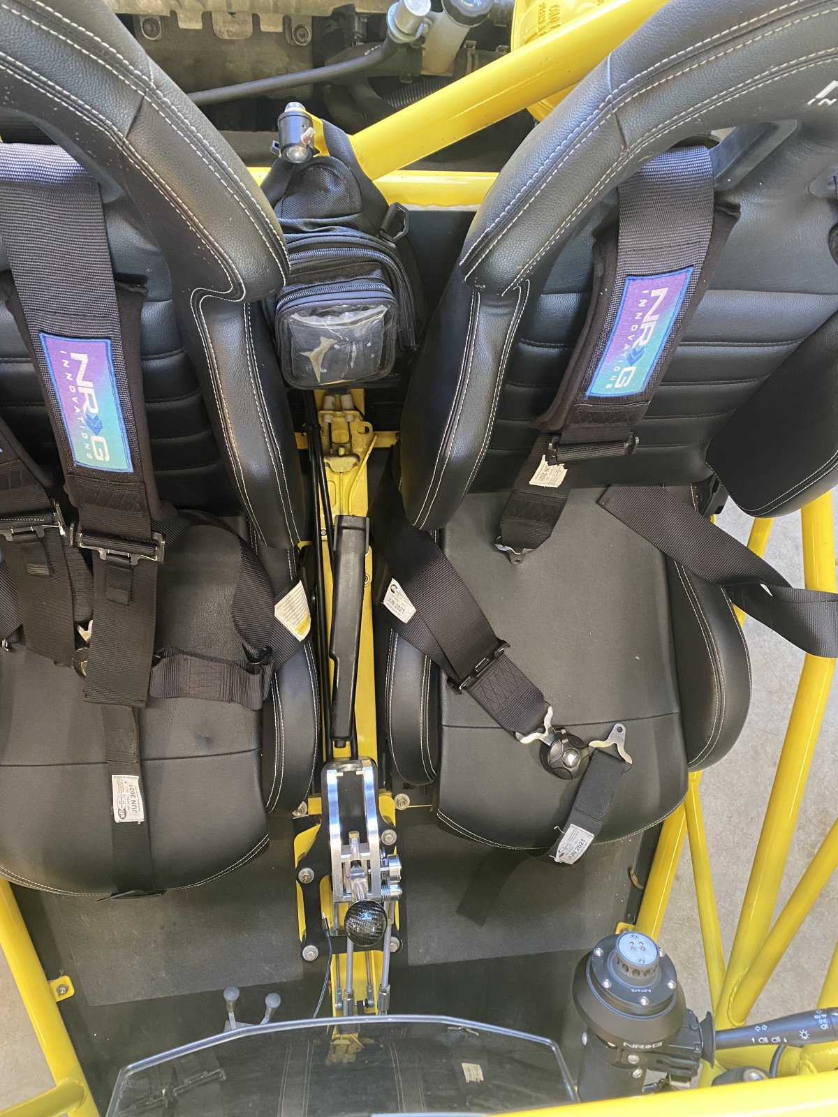

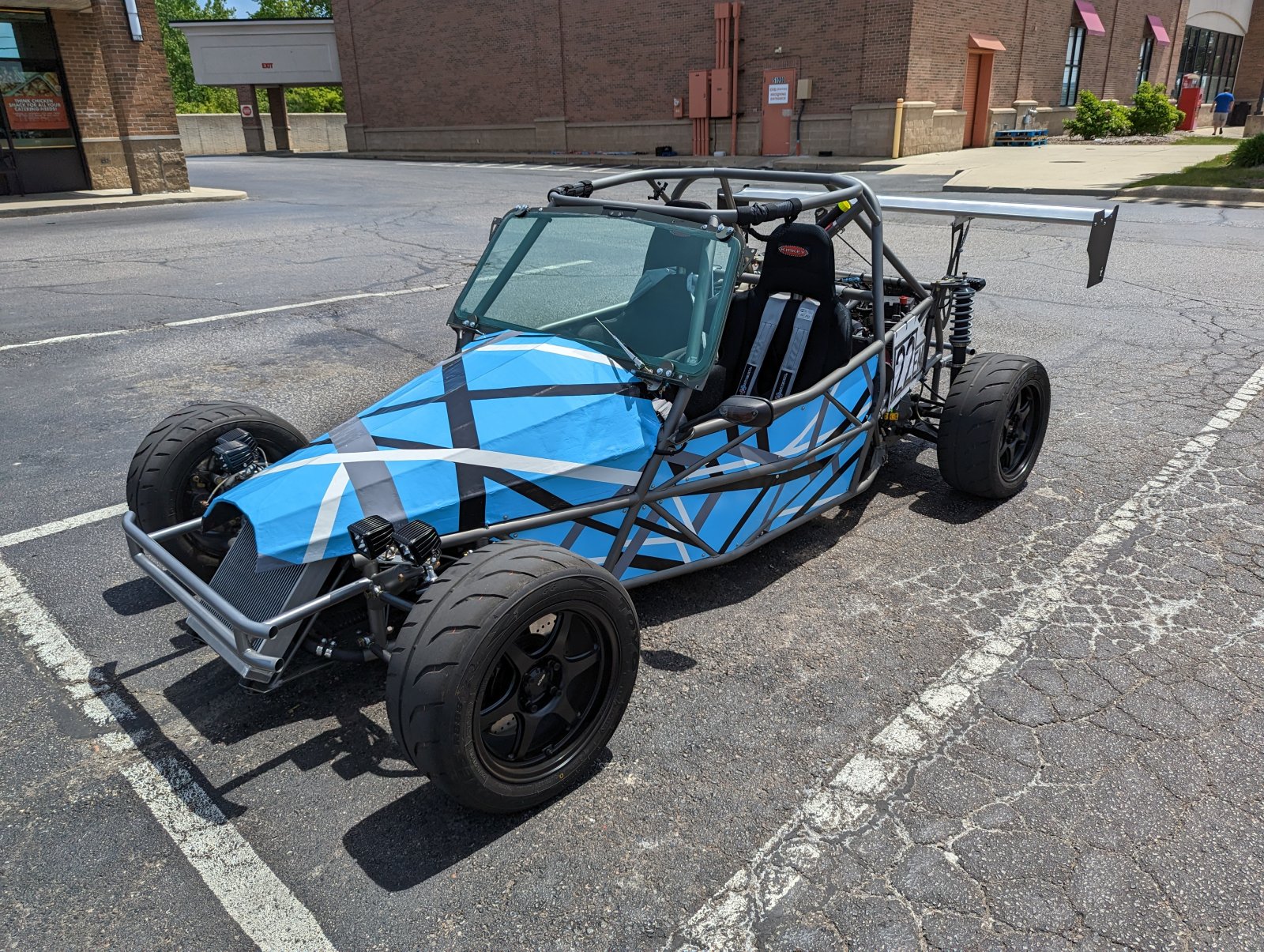

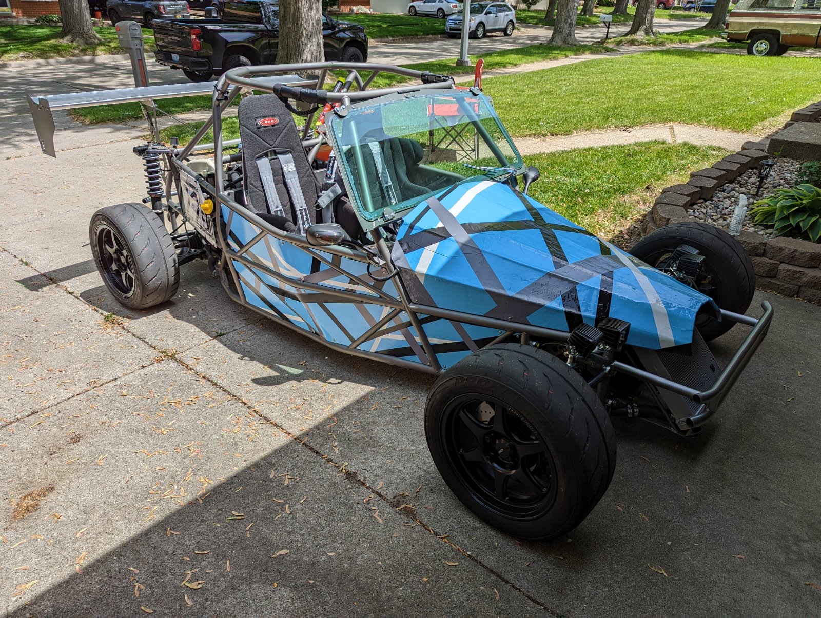

Thinking I could use a rear view mirror and some sort of storage for the insurance and registration too. If anyone has a good spot they use other than their pocket, I'd like to hear it!

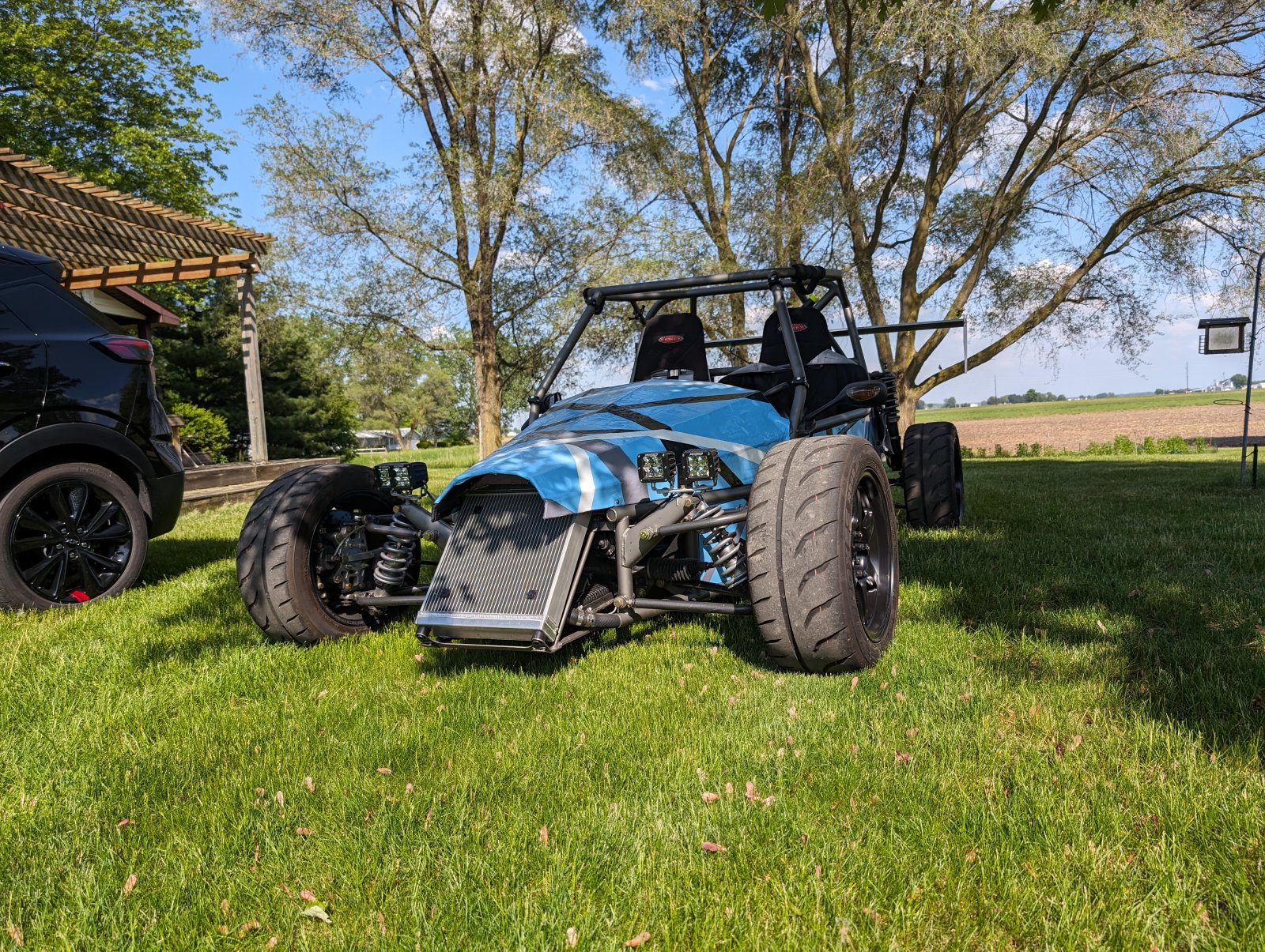

Well got it out and about! I'm amazed how different you have to drive it cruising around town compared to ripping around at autocross.

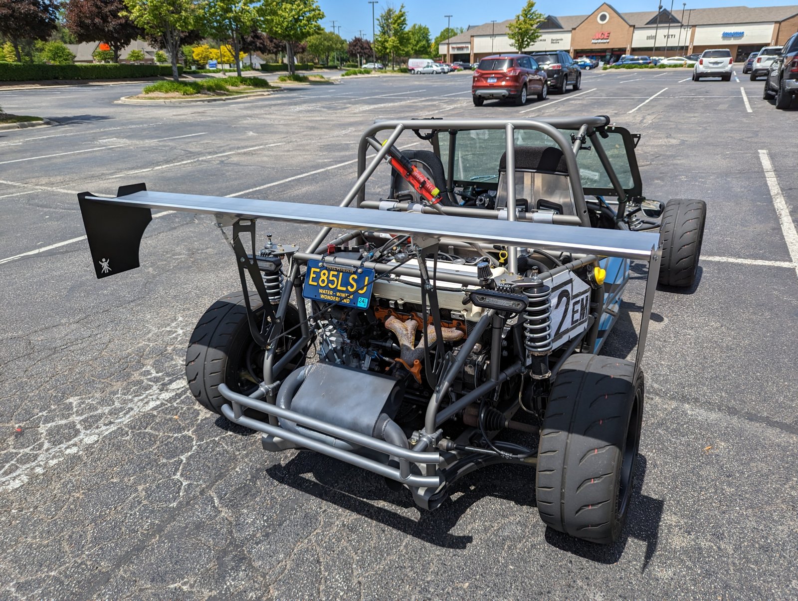

Have you tried cleaning all the junk off the coolant port? Mine had a lot of buildup over the years and needed to be polished a bit. What type of clamps are you using? Cheap Harbor Freight worm clamps or something reputable?One problem I've continued to have is a leaky front coolant hose. It's the driver's side, at the connection to the hose out of the rail. No matter how tight these hose clamps get, I get a puddle. Hoping it's something I can Band-Aid for this weekends racing in Oscoda MI.
I got rid of the PEX tubing due to so many people mentioning leaks and just did heater hose all the way from the heat exchanger to the pump and Laminova core inlets.
