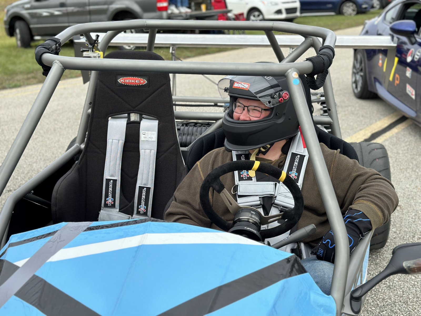

Another weekend of racing, and a great finish to the season! Gave a couple of folks a ride along in my sight laps and just had a great time. The car handles so different with 2 people, that my first run out alone I spun it in the first turn! Will for sure get these vids up along with the data (if it recorded right... hard to see if my blind button pressing actually activated the hp tuners dongle...). It was the fastest I've probably ever been, and for sure the most confidence inspiring as everything had finally come together for the first time.

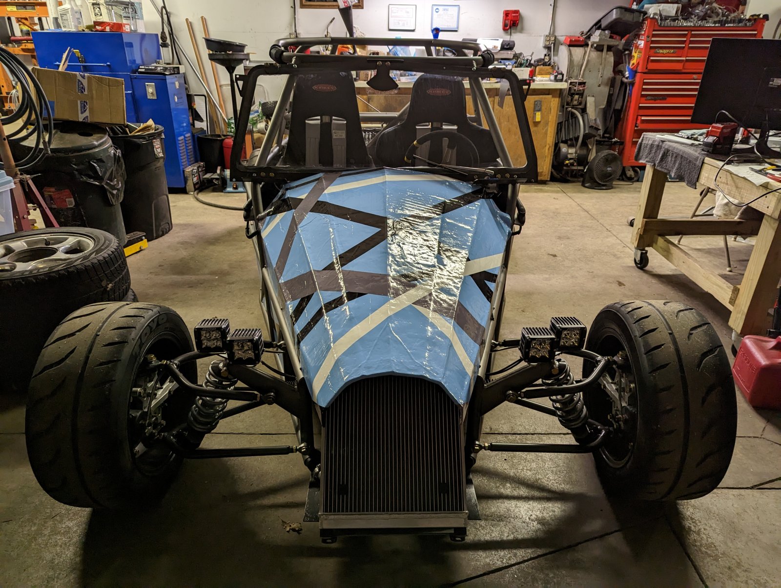

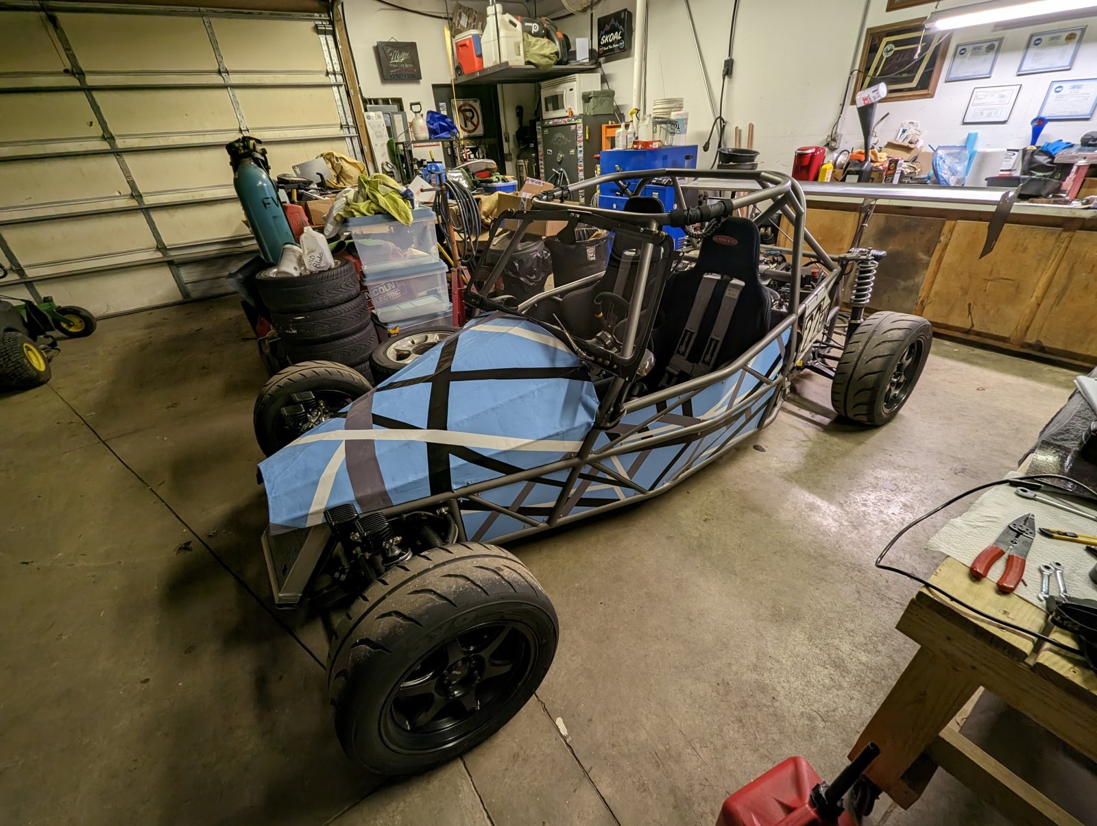

First off, finished the hood wrap. Can barely tell it's cardboard now! Learned a lot in this process, and think the next time may go better. Had a few wrinkles and bubbles I just couldn't get out right - but I still think it's great! I'm going to rock this for a long while. There is still hope for re-doing it all in carbon someday, but for now I love this look.

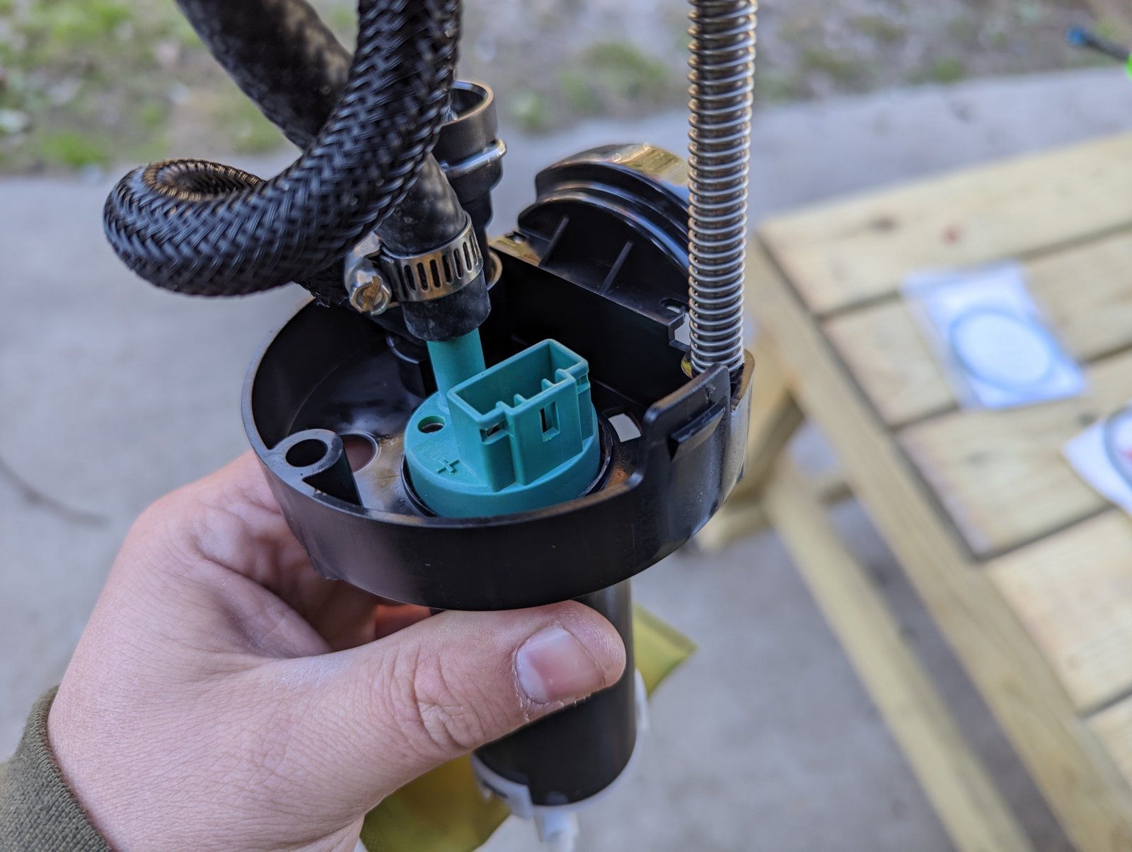

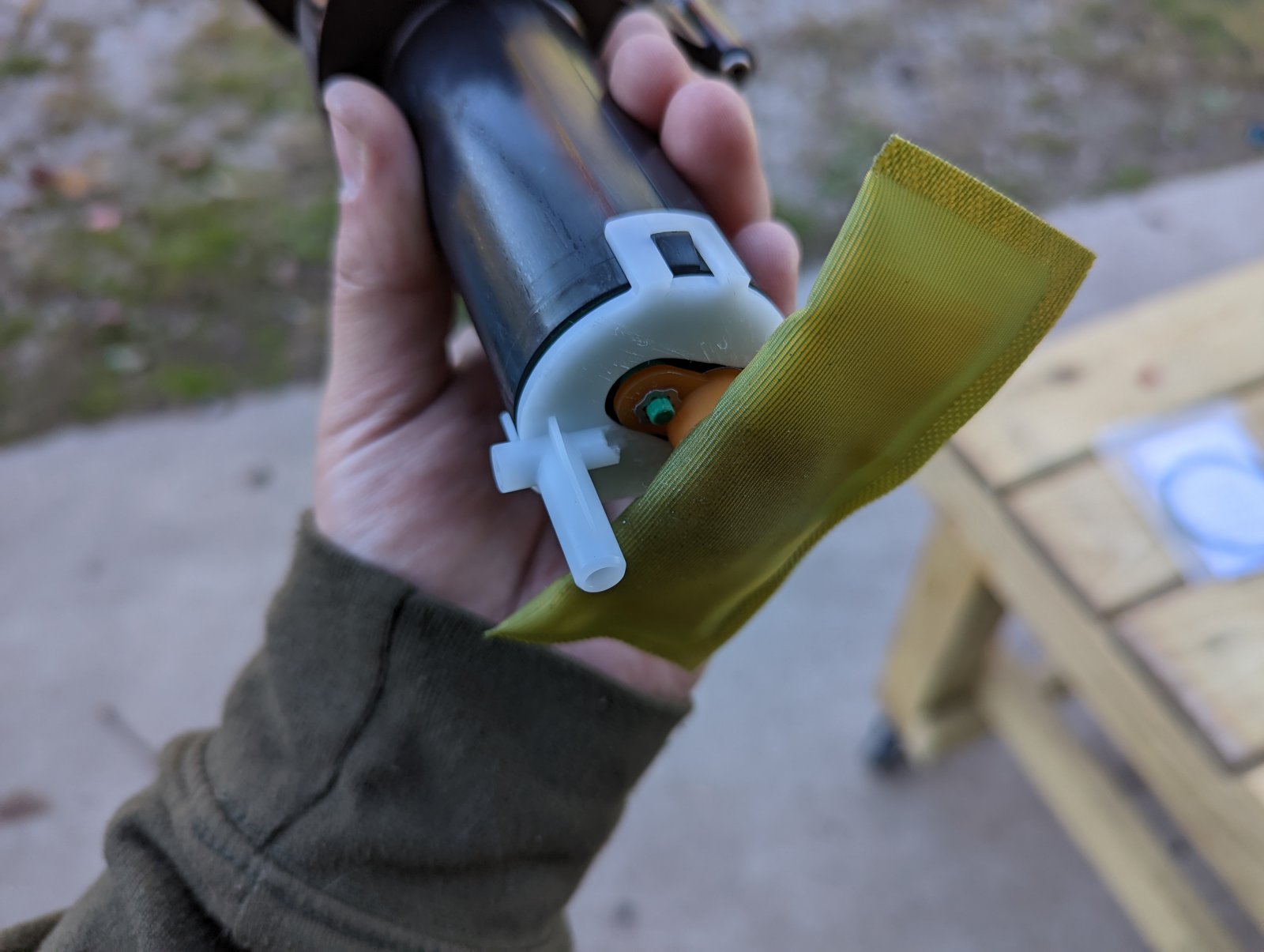

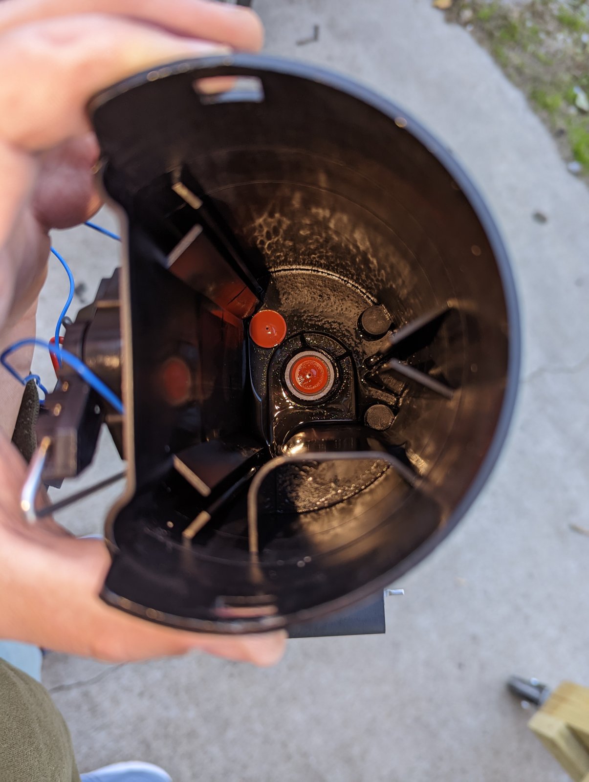

Also I appreciate everyone's input for the fuel stuff. After running this weekend, I think I nailed the issue and found the real culprit... myself ha. So the pump is an aem replacement for running e85. The reservoir was a Chinese replacement, since mine broke when disassembling the vehicle. I had modified the reservoir to fit the new pump, while adding in the appropriate wiring and hose routing to make sure nothing bound up in the tank when installed. What I didn't do was realize where the pump was pulling from in the reservoir. The way it sat, I was pulling fuel straight through the primary fuel check valve (a flimsy piece of rubber). By the looks of it, the pump nearly sealed itself to this valve. My guess is when pressure would drop off from a hard corner losing fuel, it would continue pulling from external to the reservoir, regardless how full it was. The fix was a GM reservoir replacement that actually adapted much more cleanly to the aem e85 pump. Still a little modification, but more for wiring clearance than anything else. I'd still like something different for a setup, but that will come when I jump to a turbo in the distant future. Also, tank does have a small baffle, so thought I'd capture that while I could.

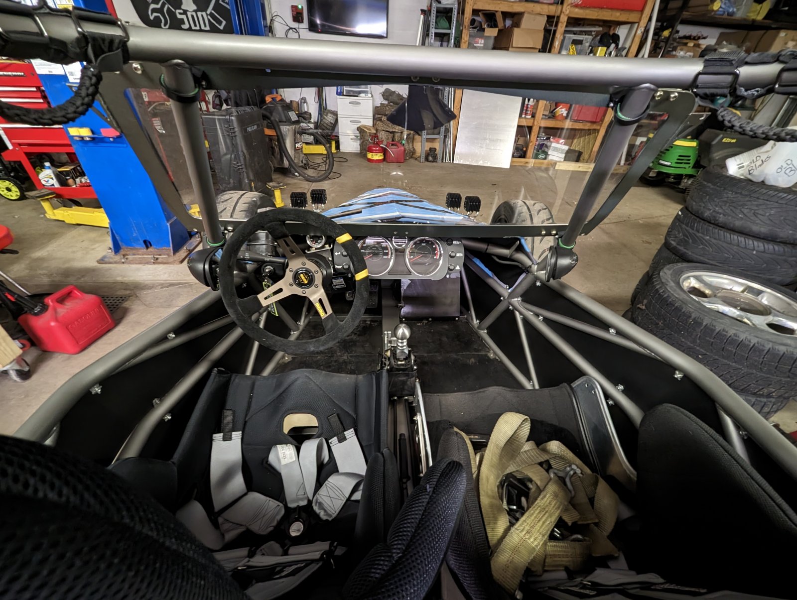

I got my inspection done just before the snow flew. They didn't care for my windshield, but everything else seemed to pass well. Might need to revisit what I use for that. The car looks a bit silly since it's too wide for the frame, but it was a cheap solution that I got from a buddy with an Exocet. I added a few pictures below to give everyone a laugh.
Once that was complete, I went and submitted the paperwork at Michigan's Secretary of State. They took plenty of my money, so now fingers crossed that it's a matter of time before I get a call to final inspect and install a VIN. Not gonna lie, I walked out of the place uneasy that they actually signed me up for everything I went in asking for Might have to make a few phone calls if no contact is made in the next week or so. Just glad it's a step made forward. Then have to find insurance...

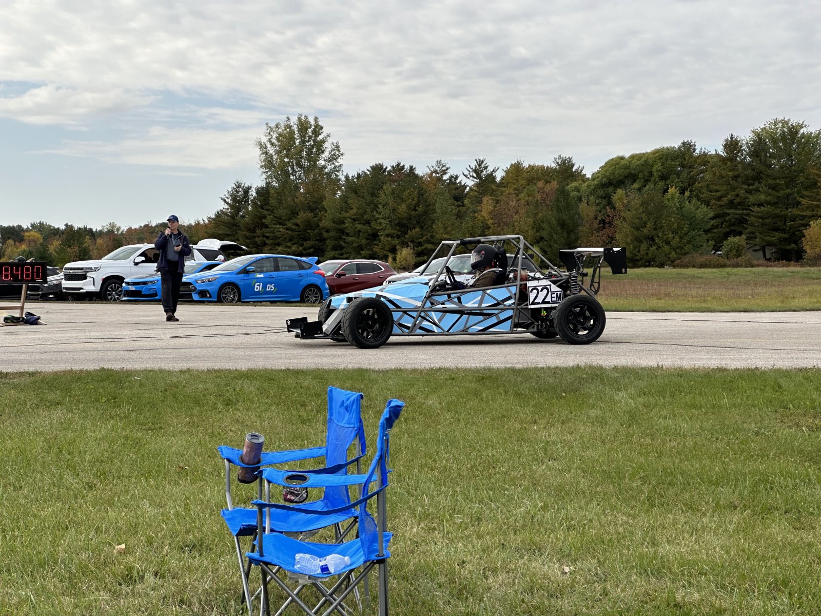

I'm assuming that windshield goes away and/or get replaced with a better fitting plexiglass one? BTW, in the 3rd photo - and guessing it has to do with the wide angle lens - your rear wing looks like it is a foot wider than your rear tire. Hopefully the DMV trolls will do their job and get back to you soon!
TravMac
Yup, it will probably be fitted with a good cut piece of plexi right on the uprights. The cool thing with this frame is it fits a samurai windshield thats flat and cheapish. I just threw plexi in it for the inspection cuz of a backorder on glass.

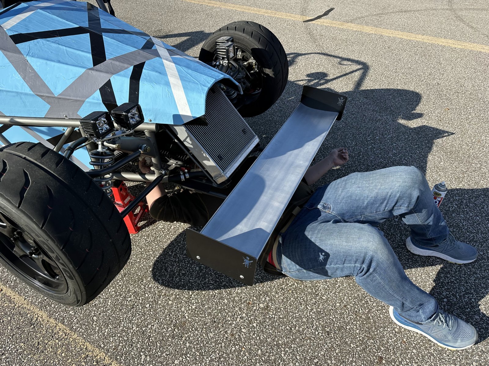

It is also the 71" wing, so it is pretty wide. The guys at 9 lives said its an interesting thing how these open cars handle airflow. Its not typical like a closed cabin car with smooth, carefully designed flow over the surface. That's why they don't do anything special for raising their Exocet wing kit into "clean air." Regardless, without testing it's hard to quantify what the car wants. So just have to keep playing with it!
“Interesting “ is a whole new meaning for the aerodynamics of the goblin. It was something I never really worried about until the goblin came along.

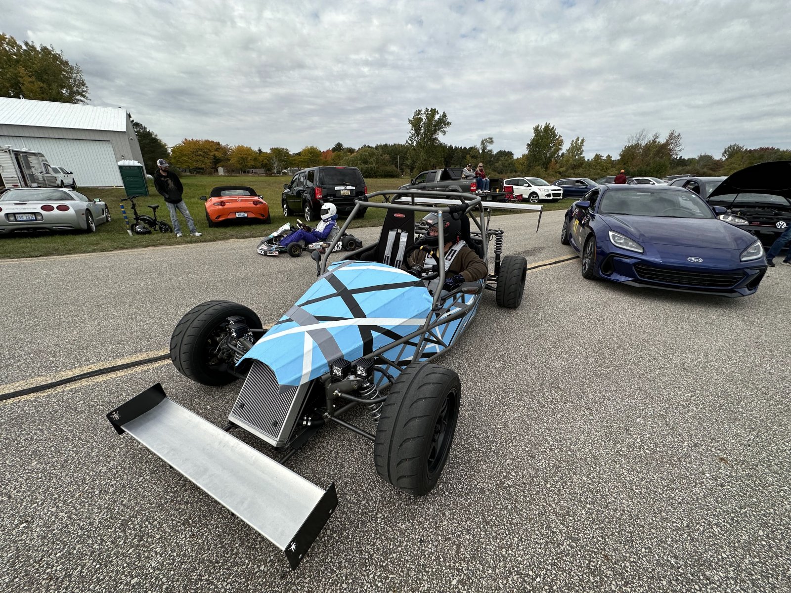

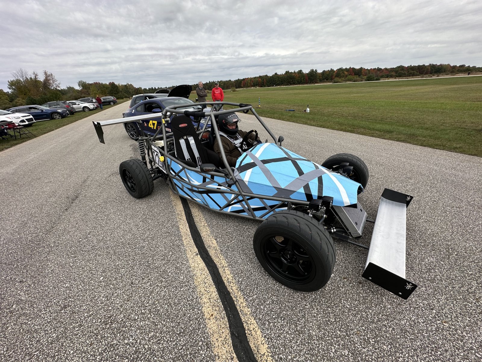

This picture gives some better perspective of the width overall. The front is where I really think there could be improvement of aero for balance at speed, but the mounting method right now is a bit too compliant to be very useful. For now it just looks cool.
Most gains I will see for autocross next season will be in suspension/alignment/tire. Playing with the wings is way down on the list. Sort of a set it and forget it type of thing. This thing was quick for the season, but there's so much more potential that I'm really excited for more seat time.
