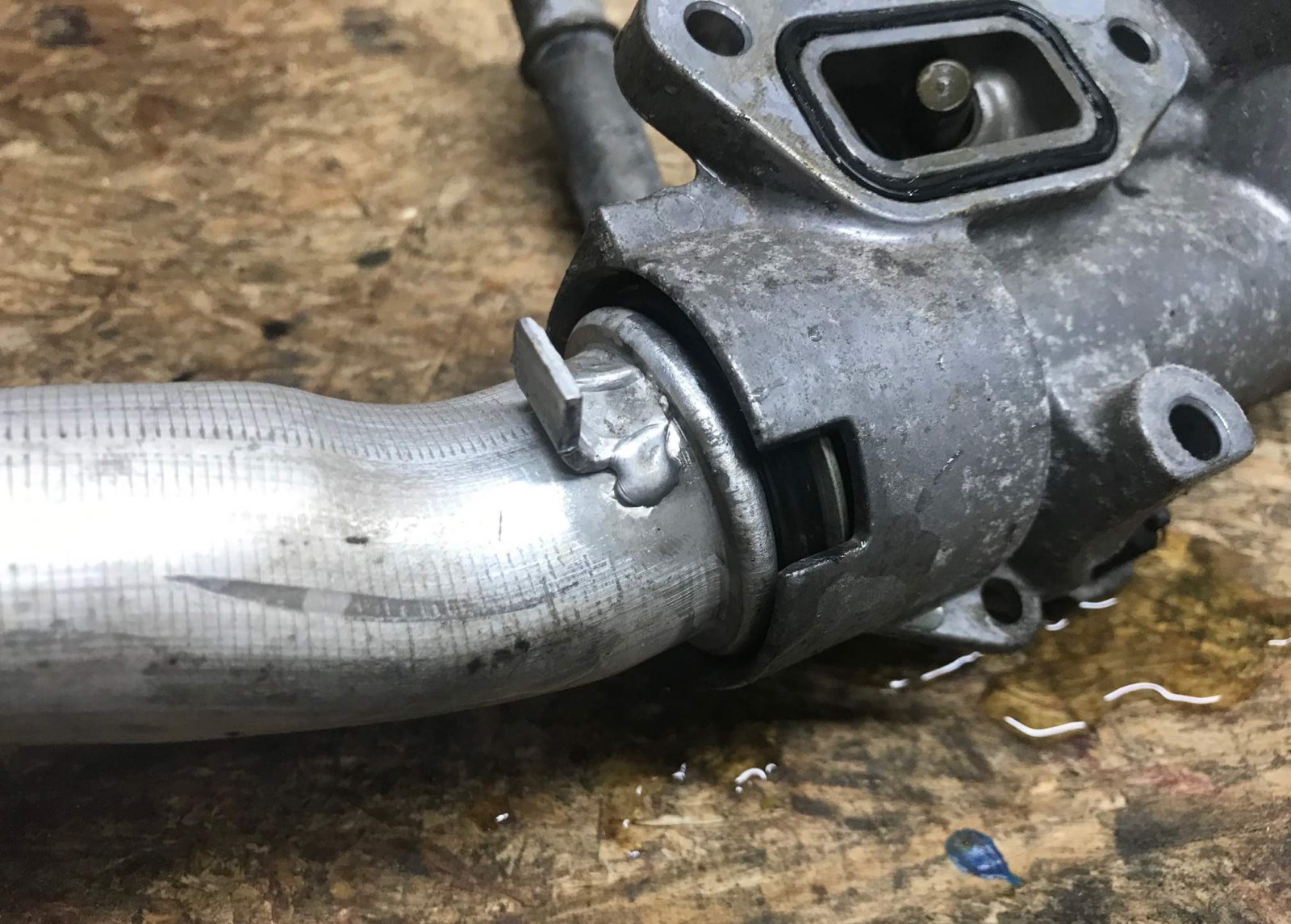

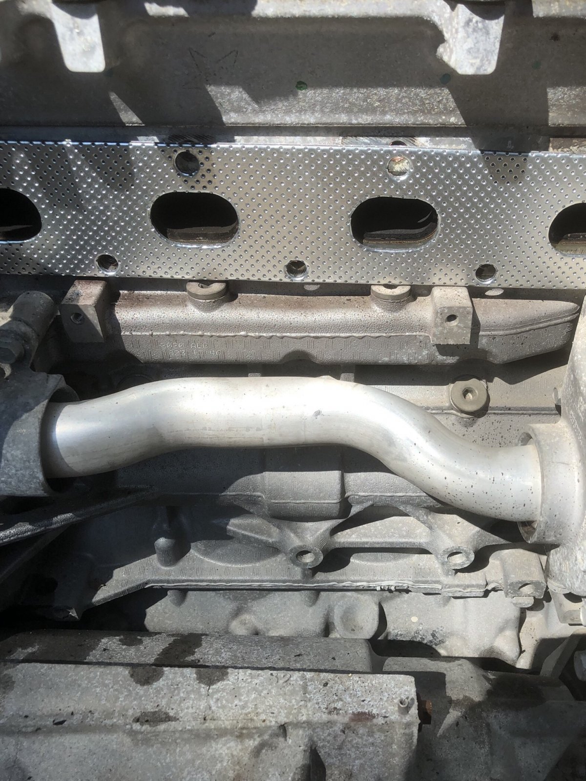

I’m trying to install a new exhaust header and it is hitting the line coming off the water pump. Any way to turn this line to gain mor clearance?
CaptFrank2001

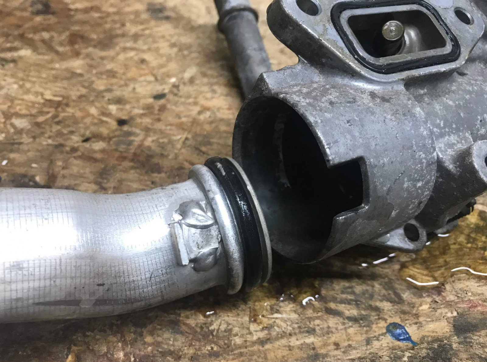

It sits in an "O" ring on each end. I had the same problem with my headers & just turned it about 10 degrees to clear the headers. There is a tab on the pipe that fits into a notch on the left side. I bent it over to rotate the pipe just enough to clear the headers. Hoping for no issues when I run the engine for the first time. Should be fine.
