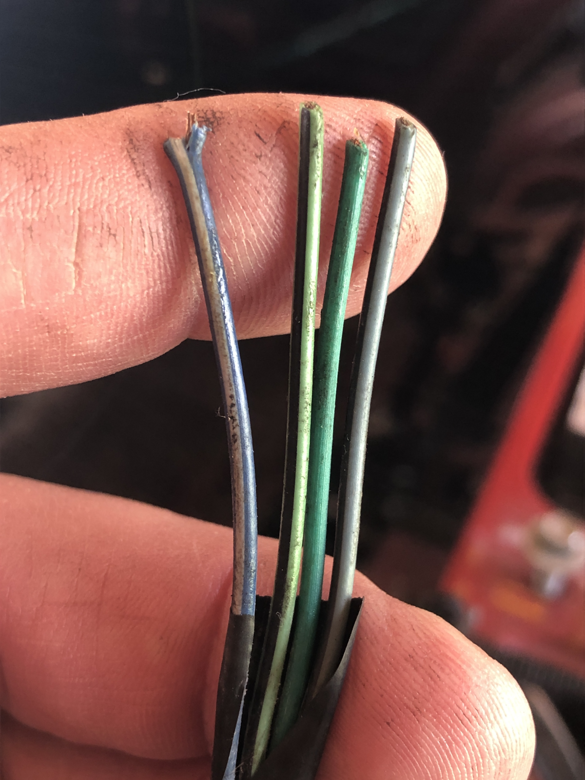

Tearing down my 06 SS/SC and came across some wires in the trunk that were cut. Hoping someone here can help identify them. Its a 4-wire bundle (BLU/WT, GRN/BK, GRN, GY/BK) that was cut in the trunk just after passing through the back seat on the LH side. I can say it is NOT:
Side marker light
Tail light
Reverse light
License plate light
Trunk release
CHMSL
Speaker wire
Trunk light
Rear defroster
32784
Anyone have any ideas?

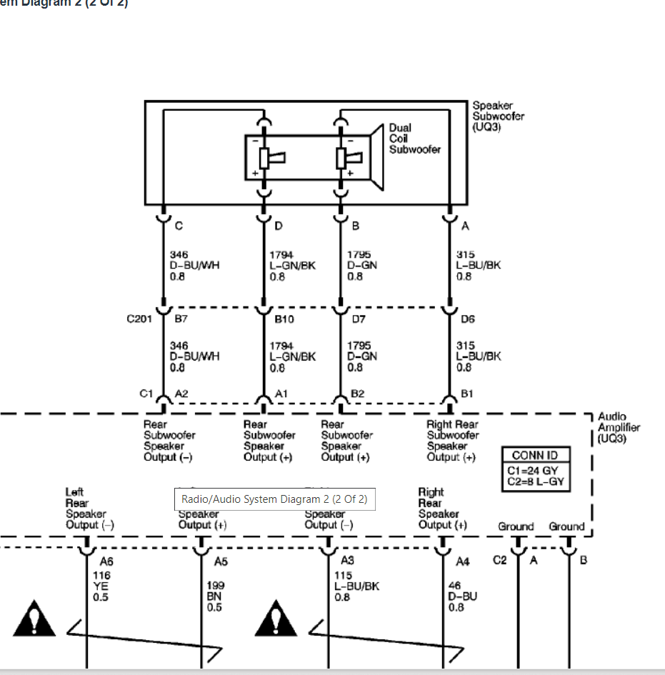

My stock sub is still in car and all I can see is the power dropping in on top. The audio connections are in the back. I'll pull it and see if it matches those. Do you have Pioneer tweets up front?
That's affirmative - Pioneer tweets in the doors.
That last wire sure doesn't look BU/BK, but there was no sub back there, so that's probably it. Thanks Ross!
I don’t think the wiring diagrams are as accurate as they could be on wire colors on the older models or the aldata isn’t quite right. I’ve noticed several things that are wrong. It may just be production changes through the years that don’t get updated.
