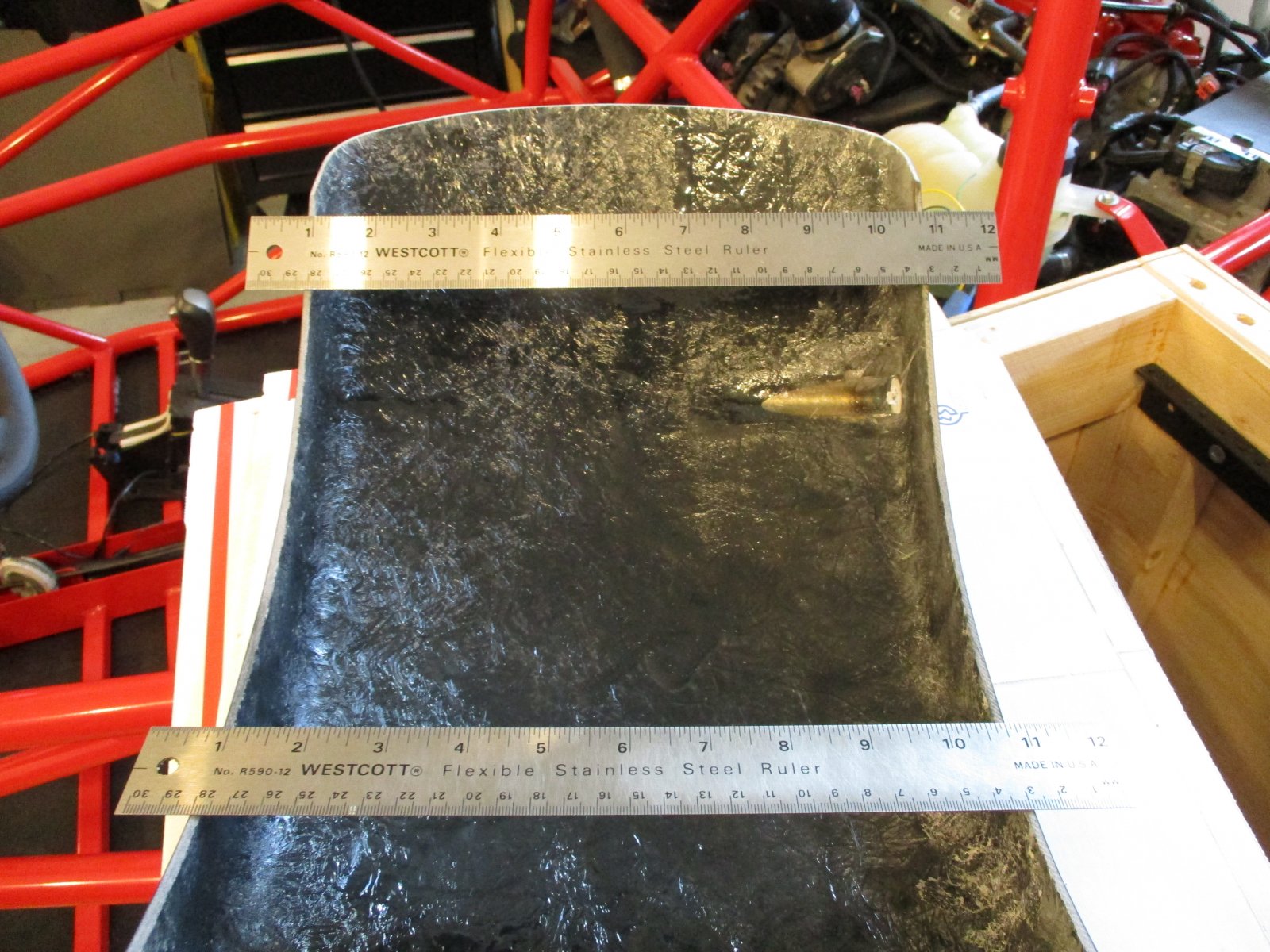

We purchased the wider ones - internal width between the fiberglass is 9-5/8"
Can send a picture tomorrow
That would be great! My rim size is planned to be 17x9 so that is close. I assume the 9 5/8 is the width at the bottom opening not the top? Do you have the top width where it goes more narrow?
Thanks!
9-5/8 in center and 9-11/16 on the ends.

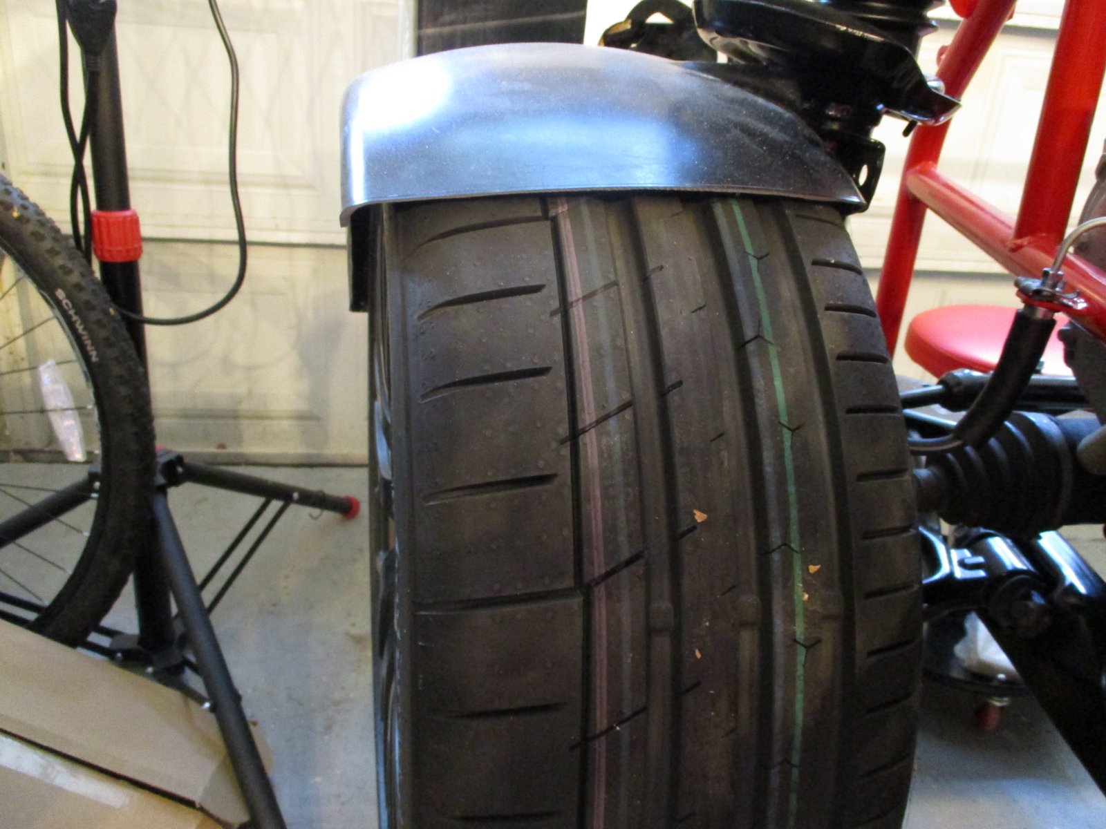

The 2nd picture is the fender sitting on the tire with the inside edge touching the tire. Leaves ~5/8" of clearance which would translate to roughly 5/16" on each side when mounted properly. Note that these tires are 225/45R17 so YMMV depending on which tire you put on those wheels.
ncgoblin
Thanks Bretter that is exact what I was looking for I appreciate it. Looks like at 17/275 I am going to have to cut down the center and add some fiberglass.
