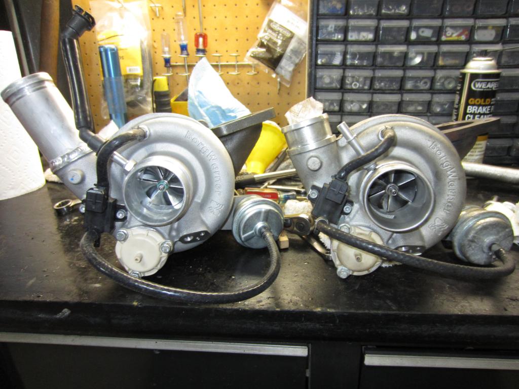

Smart people of the DF Community - how do I figure out where to plug these in? I bought a donor that doesn't have a stock setup. Lots of sweet upgrades, but not a 'follow the manual' setup.
Forgive the semi-double post, as I posted a long Engine Help request somewhere else asking all sorts of questions, but maybe it's best that I solve the three mysteries one at a time.

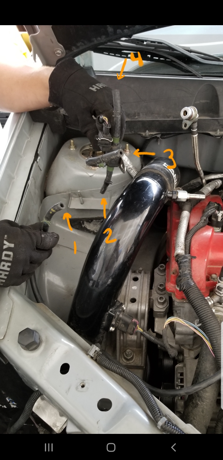

Aren't those all vacuum lines lines for the turbo? 3 will go to the wastegate control line, 4 to turbo housing for boost reference, 2 should plug into the intake somewhere close to the turbo for the actual vacuum. Where is 1 running to?

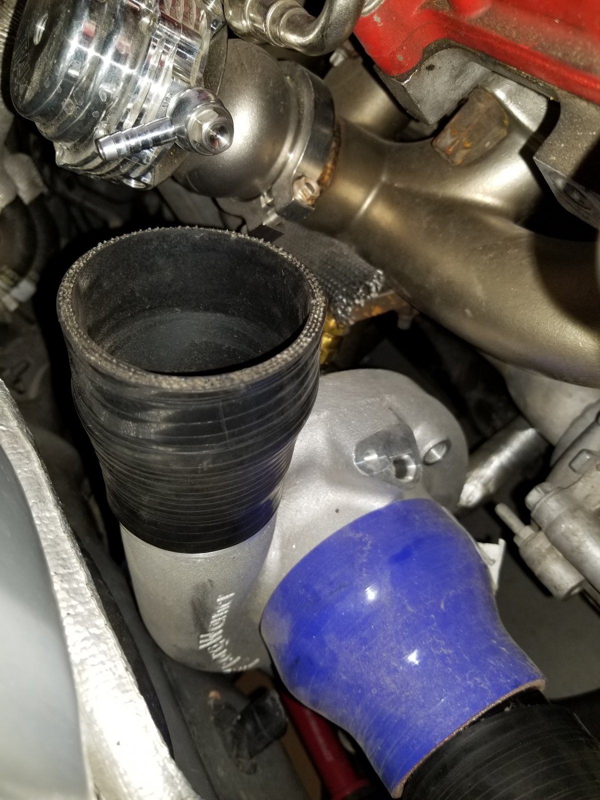

In this picture 2 would tie into that white thing near the bottom, that has a port that goes directly before the impeller
Waterdriver
If your going to pay for dyno time, I would remove the blue silicone hose reducer. Definitely an air restriction on the turbo intake side, limiting your overall output potential. Keep the intake plumbing the same inside diameter from the turbo all the way to the air cleaner.
