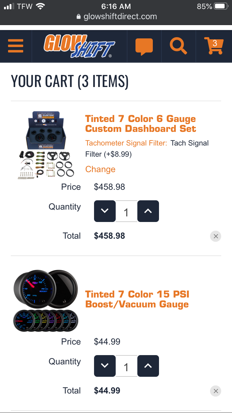

Anybody want to try and talk me out of ditching the factory Cobalt gauges in favor of a full sheet metal dash full of these? It’s almost $700 and a ton of work, but I’m leaning this direction.

If I go this route I would use the sensors that come with the gauges and run new signals for most of them. Here’s what I’m thinking.
Speedo- go GPS to make it easy
Tach- use a tach signal converter and get a signal from the car
Oil Pressure- use their sending unit
Fuel Guage- hookup to factory signal
Coolant Temp- use their sending unit
Volt Guage- simple
Wideband- need to weld in a bung when I make my exhaust
Boost/Vac- Tie into a vacuum line
I plan on running a wideband and a boost guage either way. The rest of it seems pretty simple electrical wise to me.

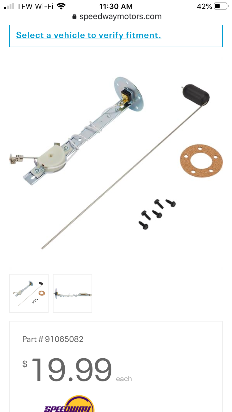

I’ll have to check the resistance on my stock sending unit later but I read online it’s somewhere around 40 ohms E 240 ohms F. If that’s the case these gauges won’t work. There’s no setting close to that, but I did find this solution for $20. 6FD50044-247A-496F-80C2-C6291E993BB5.png
It sure doesn’t seem like I’m talking myself out of it very well.
You have the right idea.... use their sending unit.
Hooking up to the factory signal might be a bit more work. Maybe a can bus gauge would work. Not sure how standardized the fuel level
signal is on a can bus.

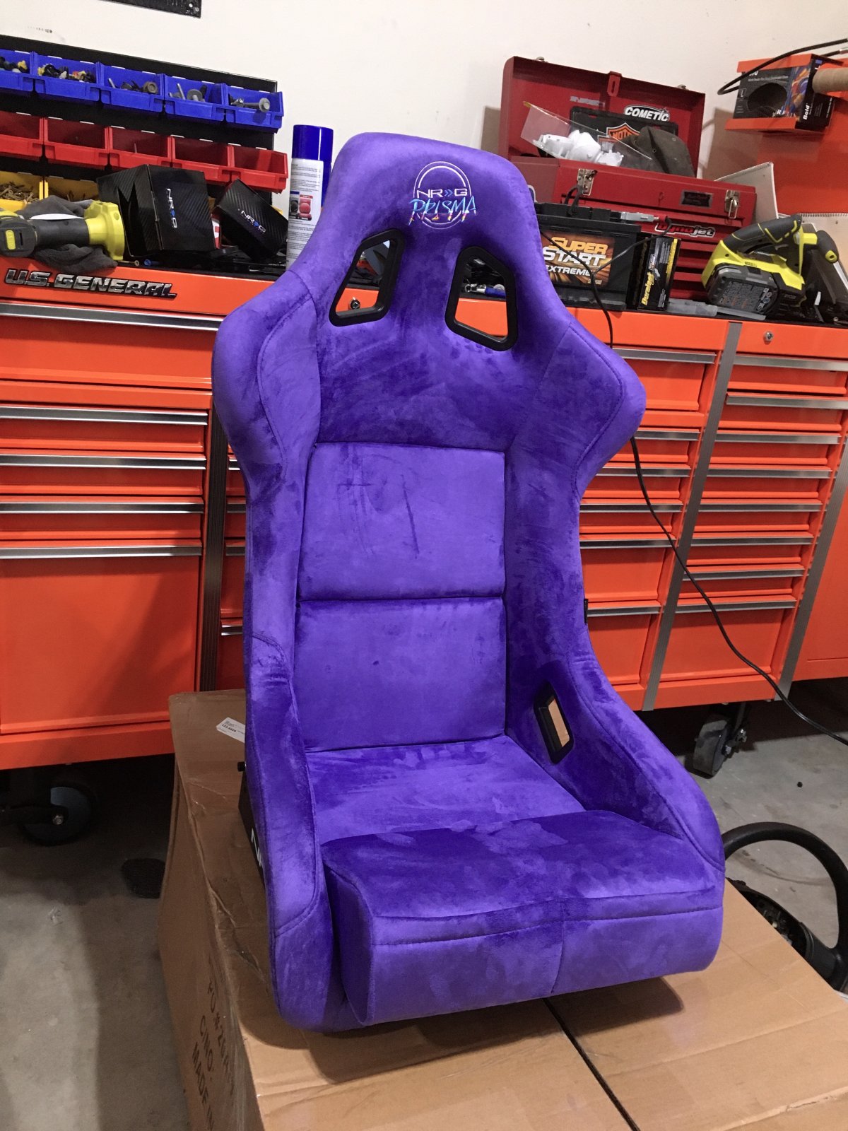

I also have a bunch of NRG stuff all over the place including a quick release, steering wheel, harnesses, and a pair of these bad boys.

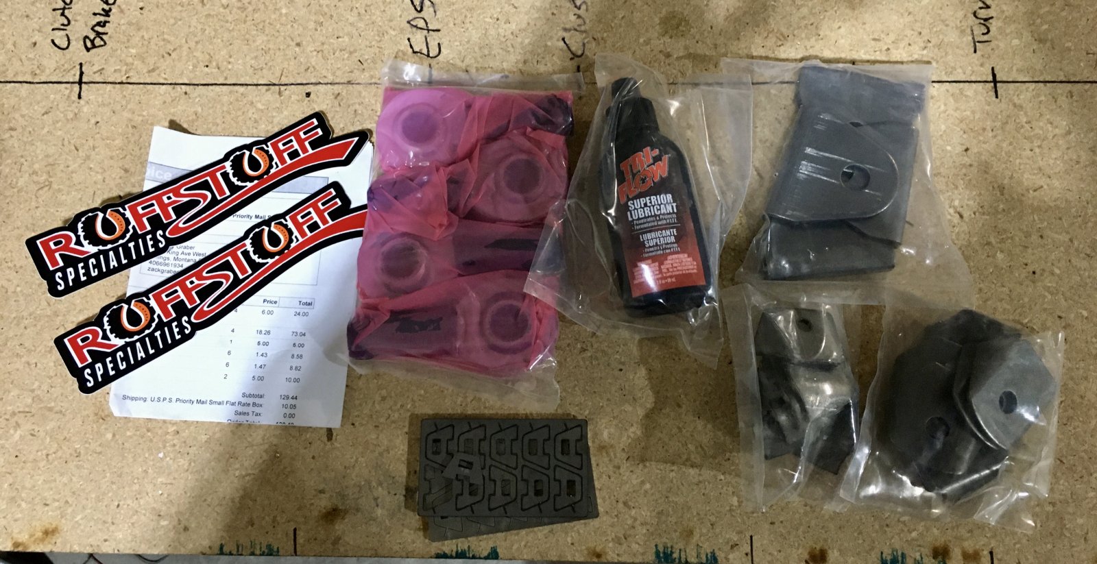

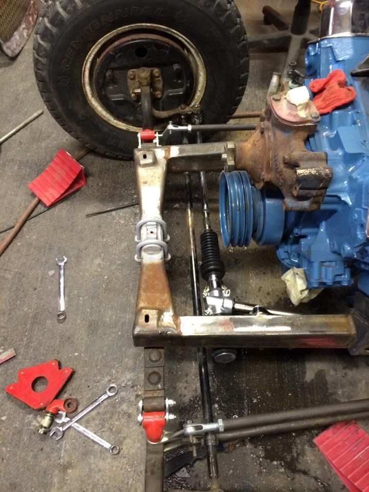

Got a box of goodies from Ruff Stuff yesterday. I ordered some miscellaneous tabs to weld on the frame.
While I was at it I bought four rod ends and a bottle of Tri Flow to “fix” the front end. Seems like a lot of members complain of the factory nylon race ones getting noisy. If you’ve never used a rod end from Ruff Stuff you have to try them. They are cheap and bullet proof. Cost me $80 for the four 3/4x5/8 rod ends and the lube.

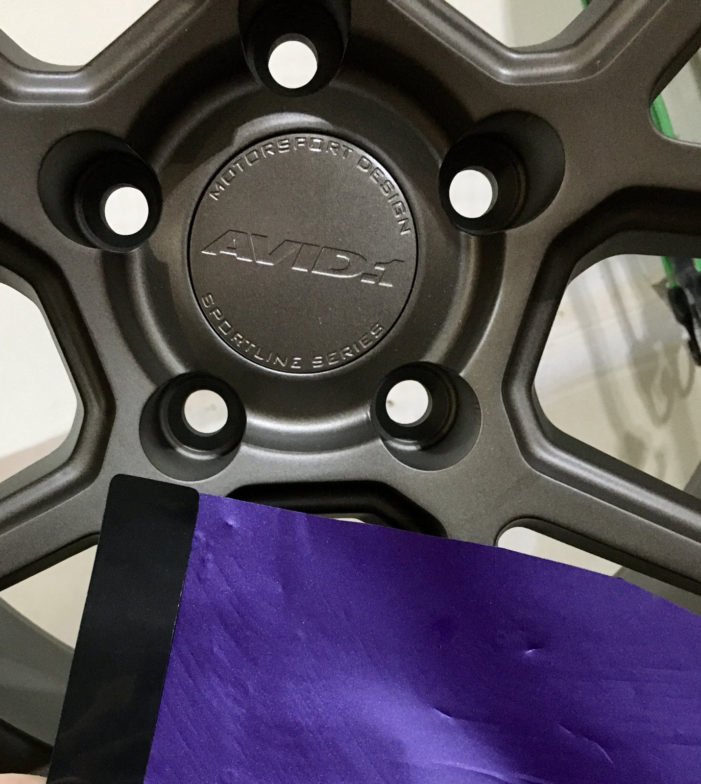

Got a bunch of Prismatic powder samples today and got a color combo locked down. I ordered a bunch of bronze, black, and purple samples.
I really like everyone’s colored frames but none of the bronze or purples were close enough to me. Frame will be Satin Black Metallic Prismatic powder, Bronze Avid.1 wheels, and VVivid Matte Purple Ghost Metallic vinyl. All the donor parts are getting satin black spray paint. The motor will get the satin black treatment with a bronze valve cover, timing cover, and oil pan. My local Oreillys has a paint store that can custom mix me some spray cans to match the wheels.

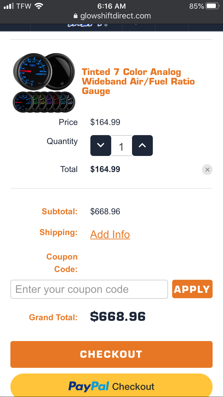

There was a Black Friday deal so I ordered the boosts gauge and wide band last night. I’ll order the set of 6 dash gauges today.

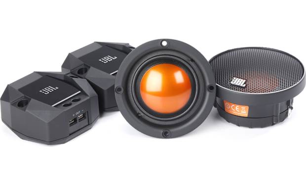

I wish my kit was here so I can see if there is room for these speakers. I want to run a 3 way component set. I think the 6.5s will have to go under the dash if I can make some pods for them to fit. A 3 way kit will let me crossover the woofer at a low frequency to help compensate for the horrible off axis position I’m going to have to put them in
I’ll just have to wait on that stuff til my kit gets here. Crutchfield always seems to have sales going on. Not just this weekend.

The gauges I bought came with new coolant temp and oil pressure sensors. I bought the GPS upgrade for the speedo. I’ll need to grab a cheap universal fuel sender-$20 and put it in the tank. The stock resistance won’t work.
