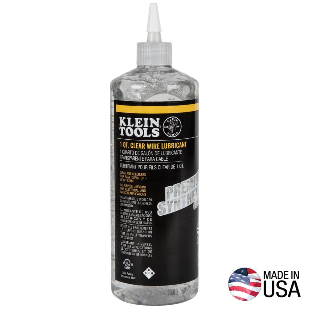

So got one of the radiator hoses through the frame. Started working on the second one and the paint roller came loose from the rope just at the last corner. Now I gotta figure out how to get it out.
Pull hard in the oposite direction worked if there is enough left over hose to grab. I had to brace my legs against the frame.
Metal Mech
Not sure what you’re telling me.
Either way, I was running a dry paint roller through the tube to clean out the gunk. The knot in the rope slipped and left the paint roller inside the tube. I got creative and got it out. Was way to late to finish. So I got it all prepped and ready and the kid and I will finish pulling the second one through in the morning.
The hopefully on to the floor boards.
