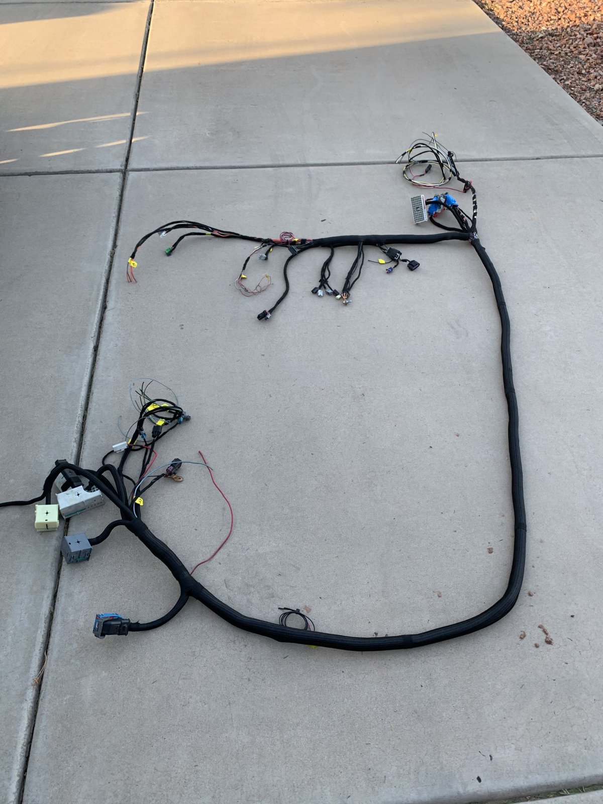

Mattc3366
My advice for anyone doing the harness is do what you said and tape it at intervals ( I wrapped mine like a candy cane) and then get some split loom sleeving for it. If I messed up on my harness I had the ability to go into it very easily or if I wanted to add some wire down the road it’s not as big of a deal. I ordered this stuff here in multiple sizes. I did the whole body harness and engine harness with this stuff.
