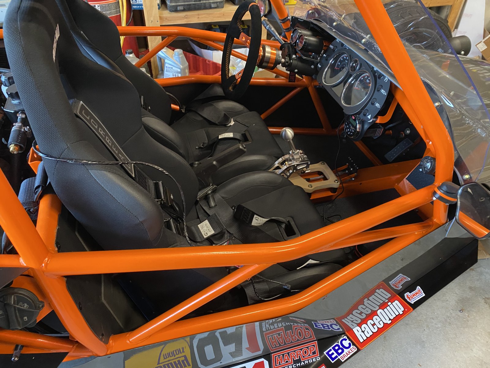

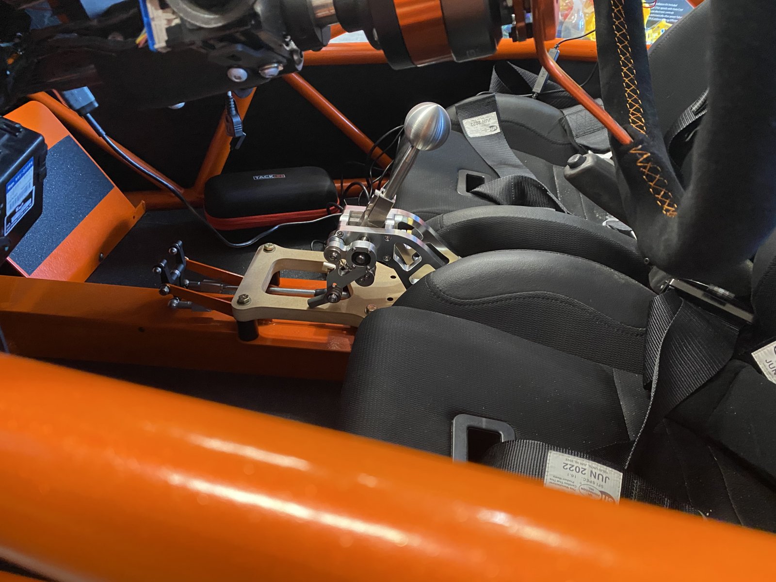

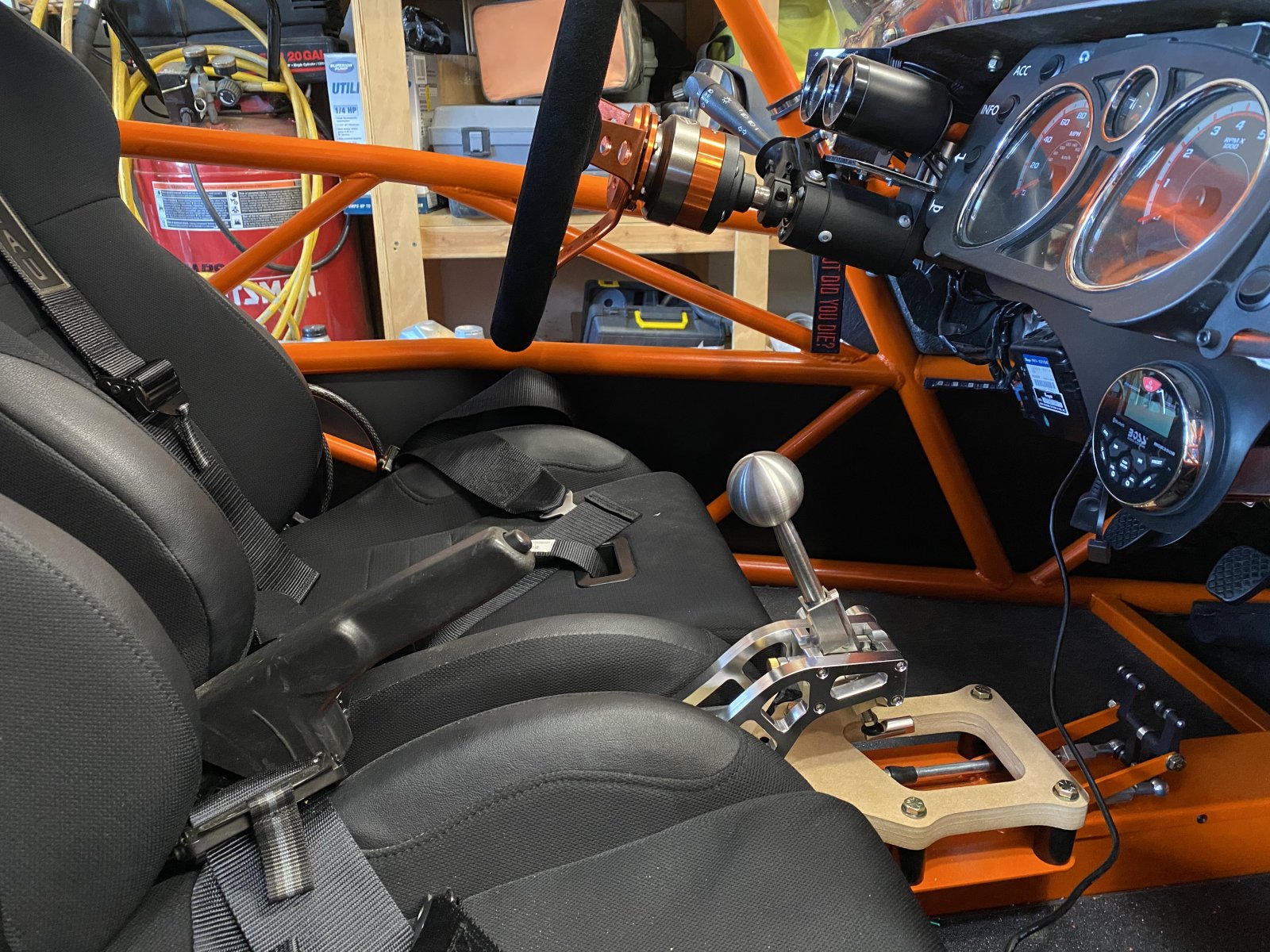

Better pictures of it actually mounted to the car. My hardware from McMaster Looks like it will work. I went in a little bit different direction then @Fozda. We will have a couple options of hardware set ups.
It really does look sick. A major improvement in looks and quality over the stock shifter.
