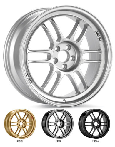

So onto the wheels, and specifically the bolt pattern.
I think I am most likely going to use Enkei RPF1 17x9s all around and will need 5x114.3 hubs.
At a little over 16lbs and a couple hundred dollars each, I don't think I can do much better.
As best as I can tell I have three options to got to 5x114.3
1. Drill the 5x110 hubs to 5x114.3
2. Use Adaptors
3. Change hubs to a 5x114.3 pattern

The question also remains as to how well a 5x114.3 wheel will work on a 5x115 hub. Again, very opinionated people on both sides of the argument.
Are there any other reasonable ways to get a 5x114.3 bolt pattern?

With Option #2, there's theoretically no different stress on the wheel bearing if you've got 25mm spacers, if the wheel has +25mm more offset than what was otherwise going to be run. It's just adding a bit of weight (1-1.5 lbs?) to each wheel.
Option #4 would be to get RPF1s drilled for the 5x110 bolt pattern. Obvious downsides there including cost, but then wheel bearings go back to being a standard off-the-shelf consumable.

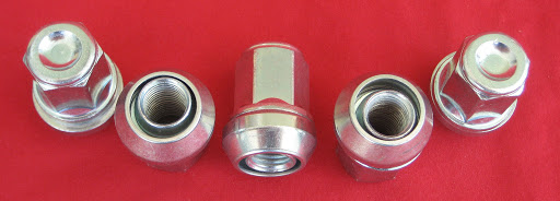

As for the bending of the studs, playing Devil's Advocate, Wobble Lug Nuts allow for the seat of the lug to be offset from the center of the lug (most common use is 5x114.3 wheels on 5x112 hubs). It also seems like some manufactures use the same model rim and market it as both 5x115 and 5x114.3
Like I said there is every opinion out there from "I've been doing it all my life" to "You car will instantly blow up"
Although DS's input will weight heavier than most.

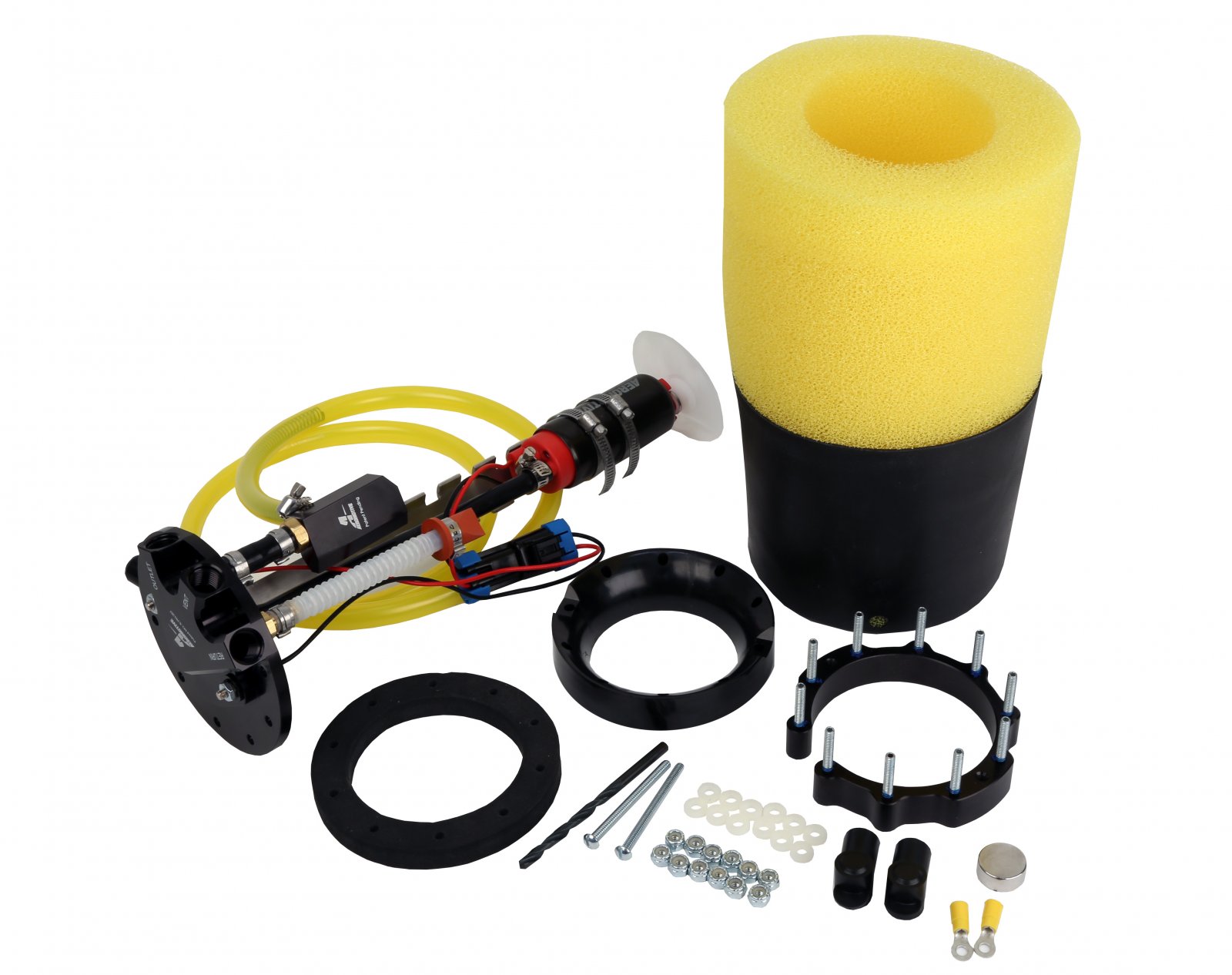

The two options I've been considering is either an external surge tank, or modifying the in-tank fuel pump set up. I did briefly consider custom baffles inside the fuel tank, but I don't think that's the best way to go about it.
I'm not in love with the surge tank idea. Its another canister to bolt in, a second noisy external fuel pump to be wired and plumbed in.
My current though is to replace the OEM intake fuel pump, housing, and level sender with an aftermarket system. This means the opening for the existing pump will not work. I emailed Adam to see what the possibility of getting the tank without the opening was and he said they get their tanks laser cut by a 3rd party, 50 at a time. So not to needlessly spend money I'll find some way to put a cover plate on the existing opening.

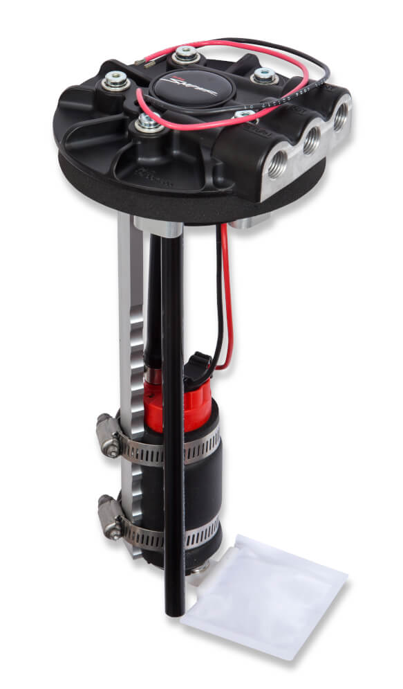

The two best options I have come up with for a replacement pump are the Phantom Apex 340 with the remote Siphon Pump or a generic Holley fuel pump connected to a Hydramat (or two)
The Phantom Apex is an in-tank Slosh control pump kit that consists of a bladder that is filled by both the return fuel line, and a remote pickup that can be placed anywhere in the tank.
The Holley pump is just a generic in-tank pump (so I could really use anything), but it would connect to a Hydramat.

Both systems are within $50 of each other and both will required a new fuel level sender.
I'm leaning towards the Hydramat set up as it will offer the most scavenging area.

I would pursue mounting an aftermarket pump with the Holley hydromat into the stock assembly first. If you look at the pictures of most of the aftermarket assemblies, they use hose clamps to fasten the pumps to the assembly anyway.
I think I have a spare fuel pump from my Camaro SS around and I think it might be the same size, and I'm sure there are aftermarket pumps that can be installed into that assembly.
Walbro 450 LPH Fuel Pump (overthetopperformance.com) shows it being "Flush mountable to existing hanger with installation kit 400-0085".

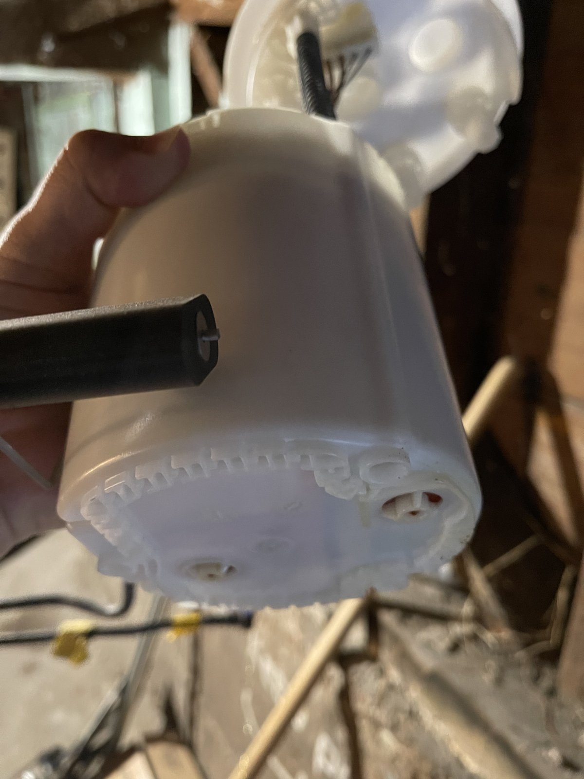

I do like the idea of using the OEM housing, but the housing is designed to sit on the bottom of the tank, and there would not be room to install fittings from the pump to the Hydramat.
I'll giving the housing a look and see if there is any possibility of modifying it.
In my mind you would cut away most/all of the bucket and hang a new pump off the the stock hat.

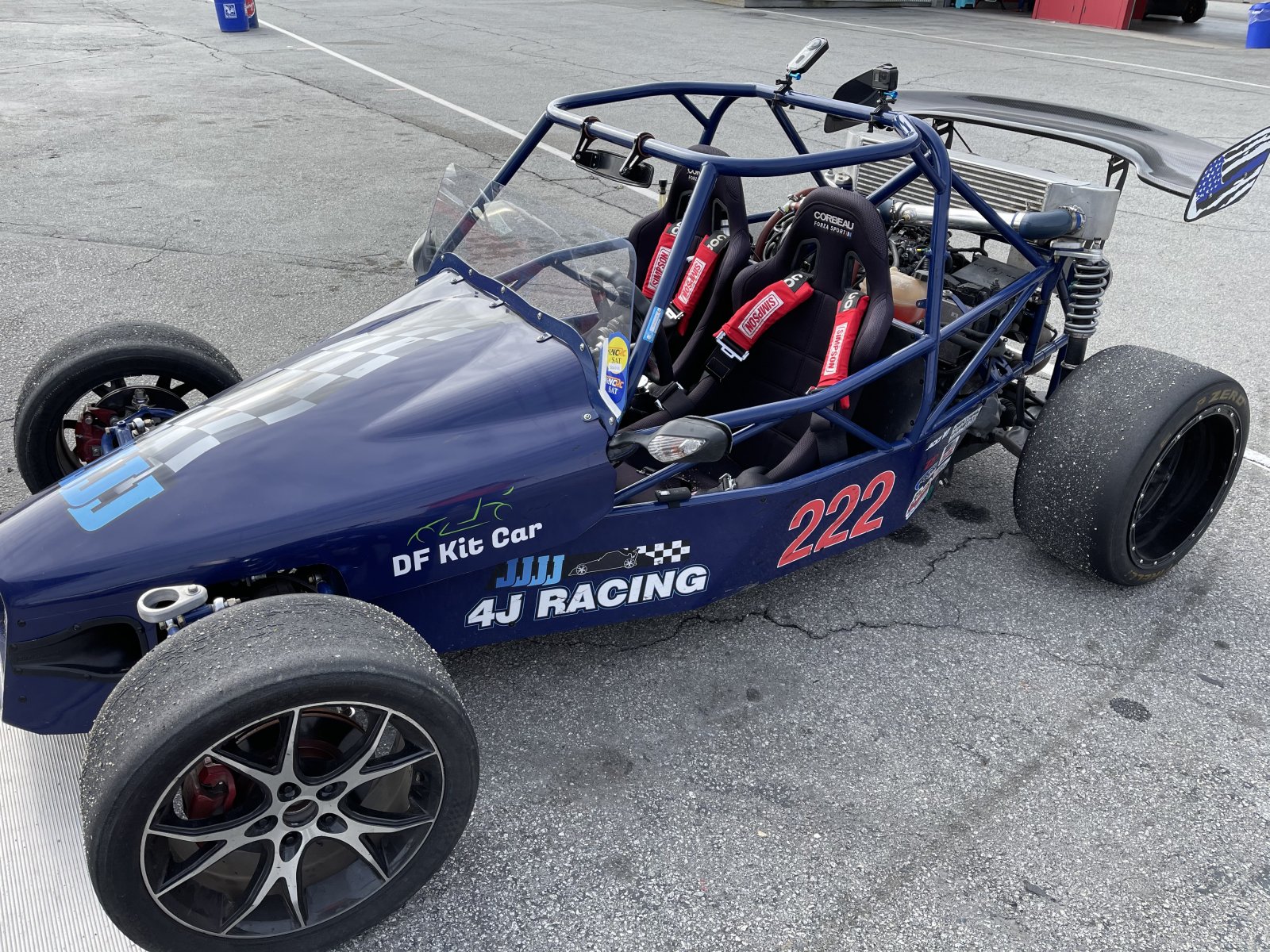

I had a really fun weekend at Laguna Seca.
Jim and Jeff Loesche came out to my event and brought their Turbo Goblin.
I spent a bunch of time talking with them and checking out their build.
Too bad Lagna Seca is not allowing passengers right now so I couldn't get a ride, but I followed Jeff around the track for a few laps.
Here is a video of a couple of laps. I'm in the pesky Black VW.
I really can't wait to get working on mine!

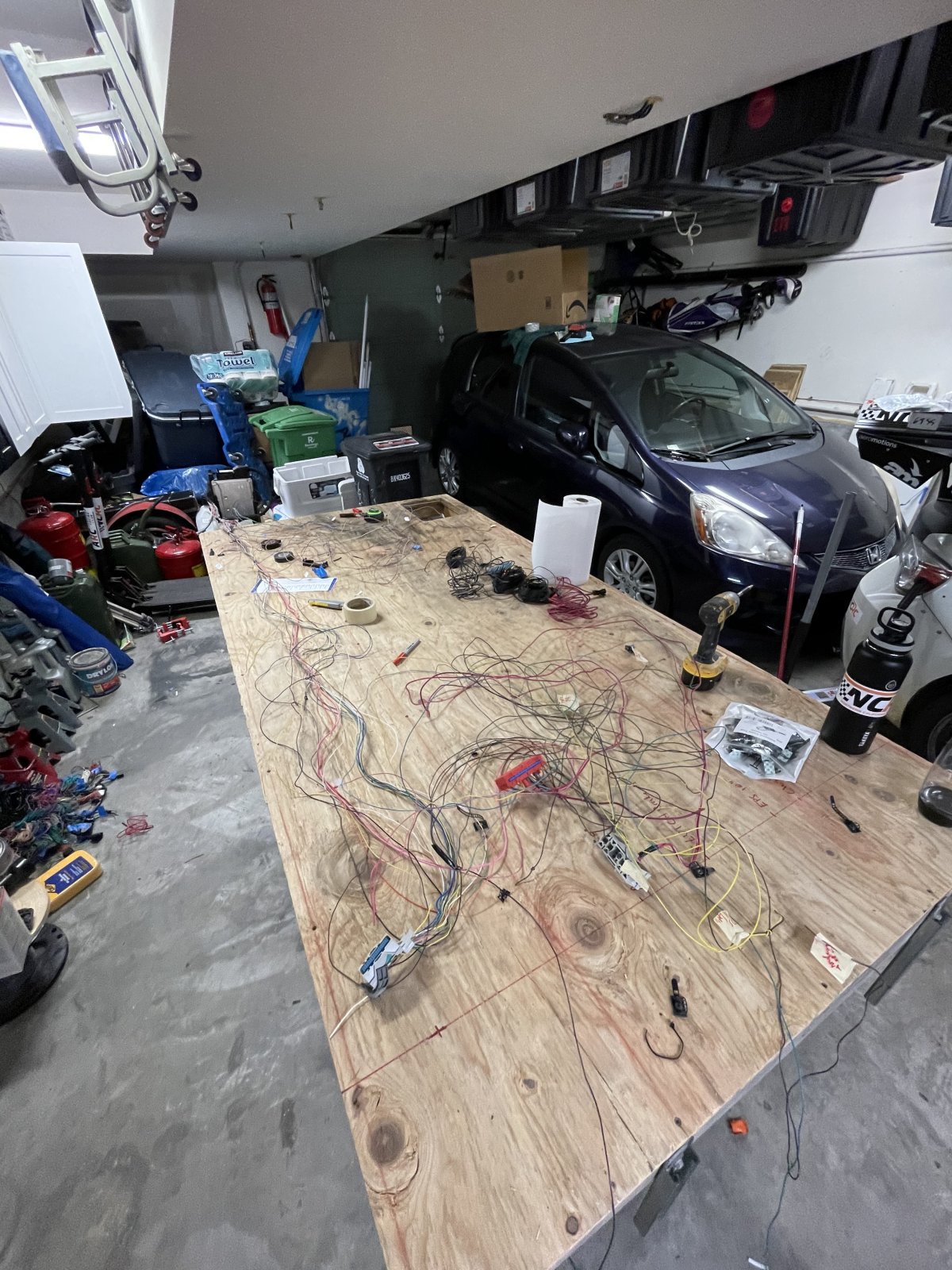

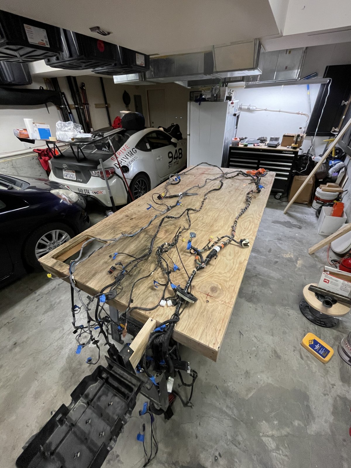

I put in a solid 8 hours today on the wiring.
got through the 4th video. No surprises. Everything seems to be as it should :)
At the end of the 4th video Lonny says the loose small pink wire is for the coolant level, but the earlier videos says it’s for the Heat exchanger Pump.
coolant level sensor has a green wire on it.
can anyone confirm that the small pink wire to be extended is for the HX Pump?
