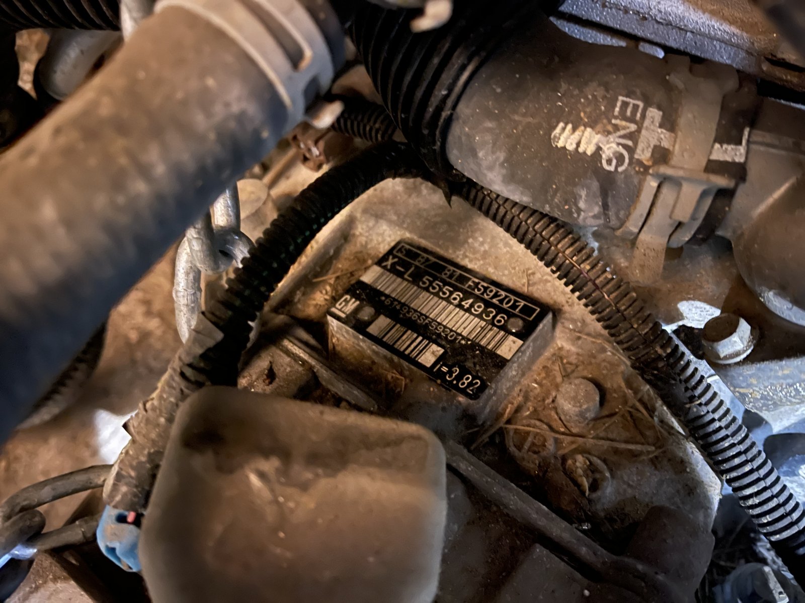

Since I was planning on buying a new motor and trans I have been battling if I should buy a donor or not and had convinced myself that I could pull it off with out a donor.
However, as I was browsing the internet looking for wiring harnesses I came across what I think is a unicorn of a car.

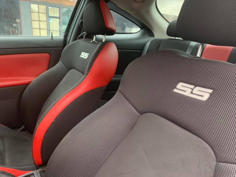

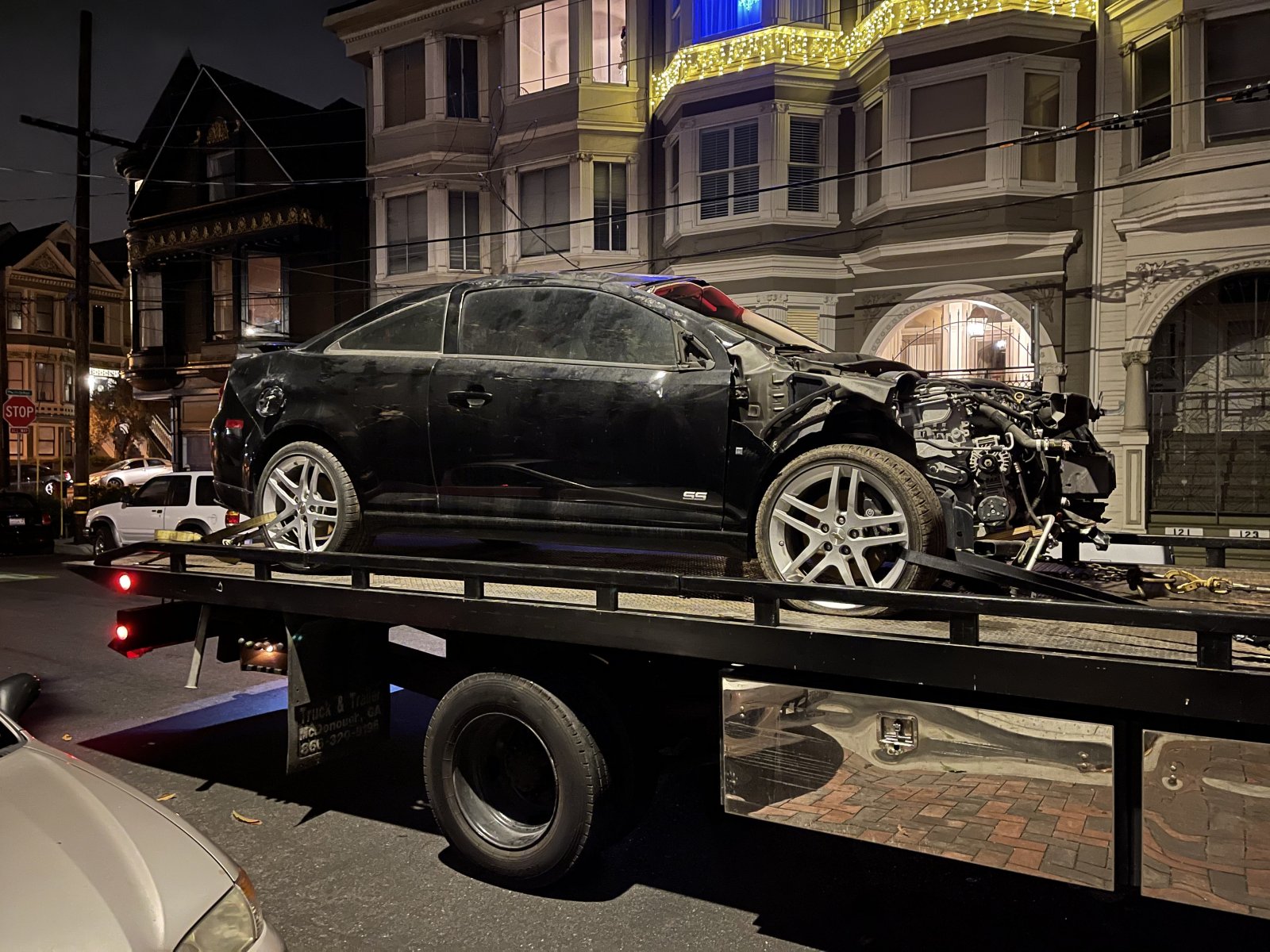

A 2008 LNF with the Factory LSD with 4,019 original miles on it.
The car was rolled just three moths after it was purchased in 2008. It ended up sitting in a race shop for 12 years until they went out of business where the guy I bought it form pick it up with several other cars, and amazing it was only 30 miles form my house.
I paid $5,000 for the car plus $200 to have him tow it to my house.
With this car I no longer have to buy a new motor or trans and I now plan on utilizing a lot of the parts I though I would be buying new.
To top it off, the interior is in great condition and it looking like I will be able to make at least 1/2 of the purchase price back by selling things off.

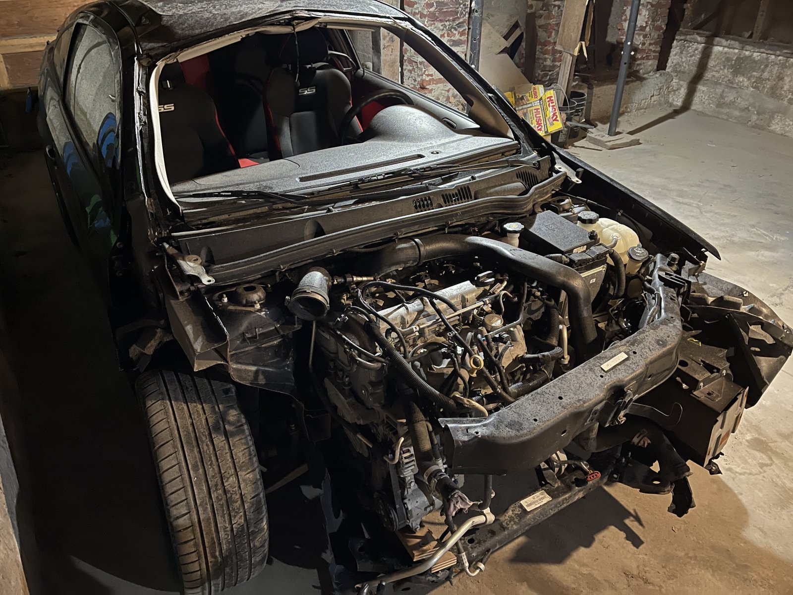

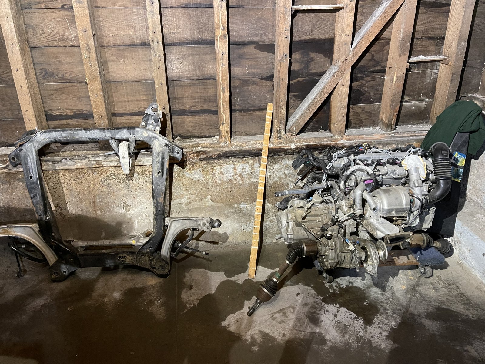

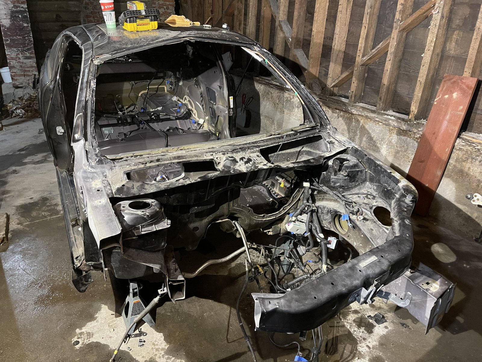

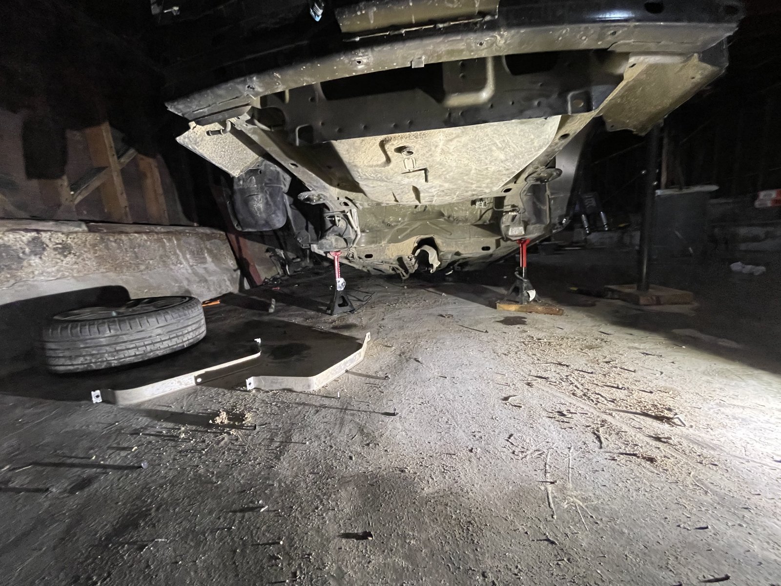

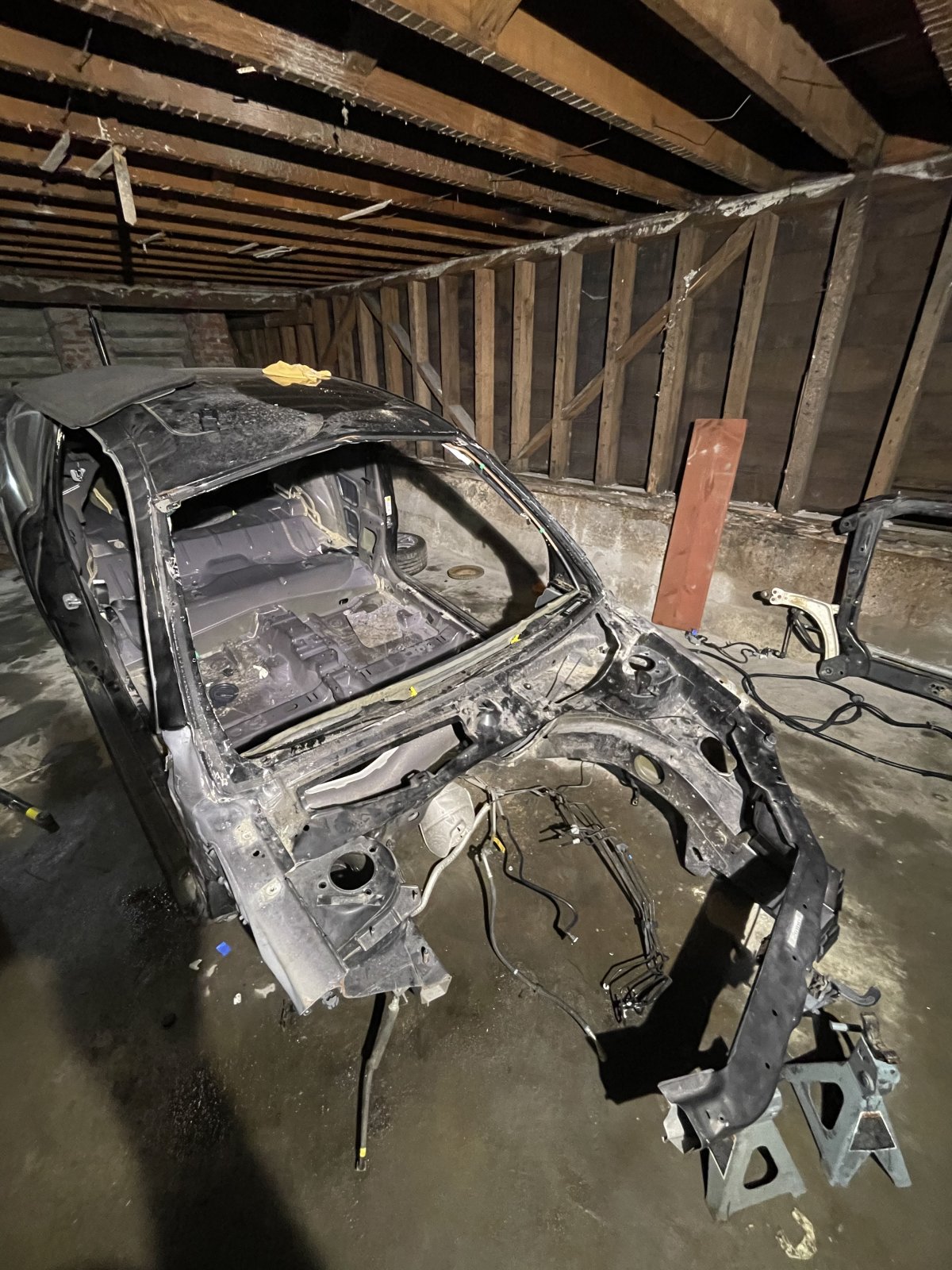

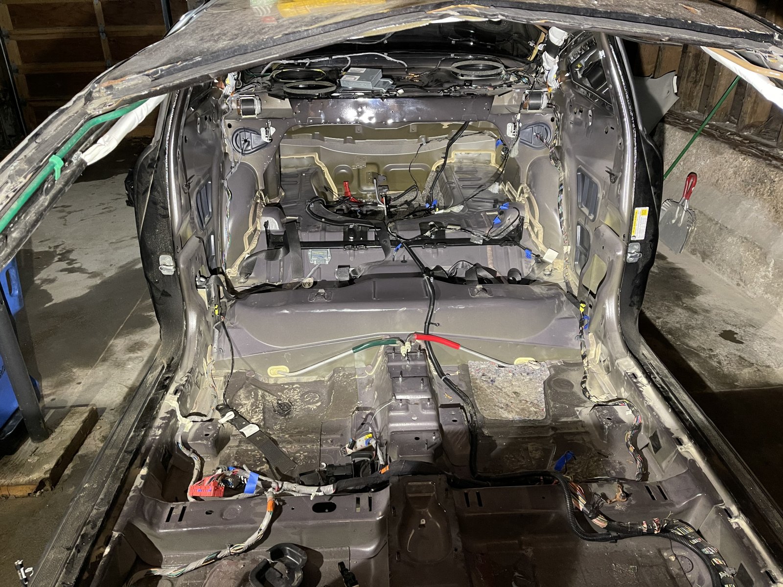

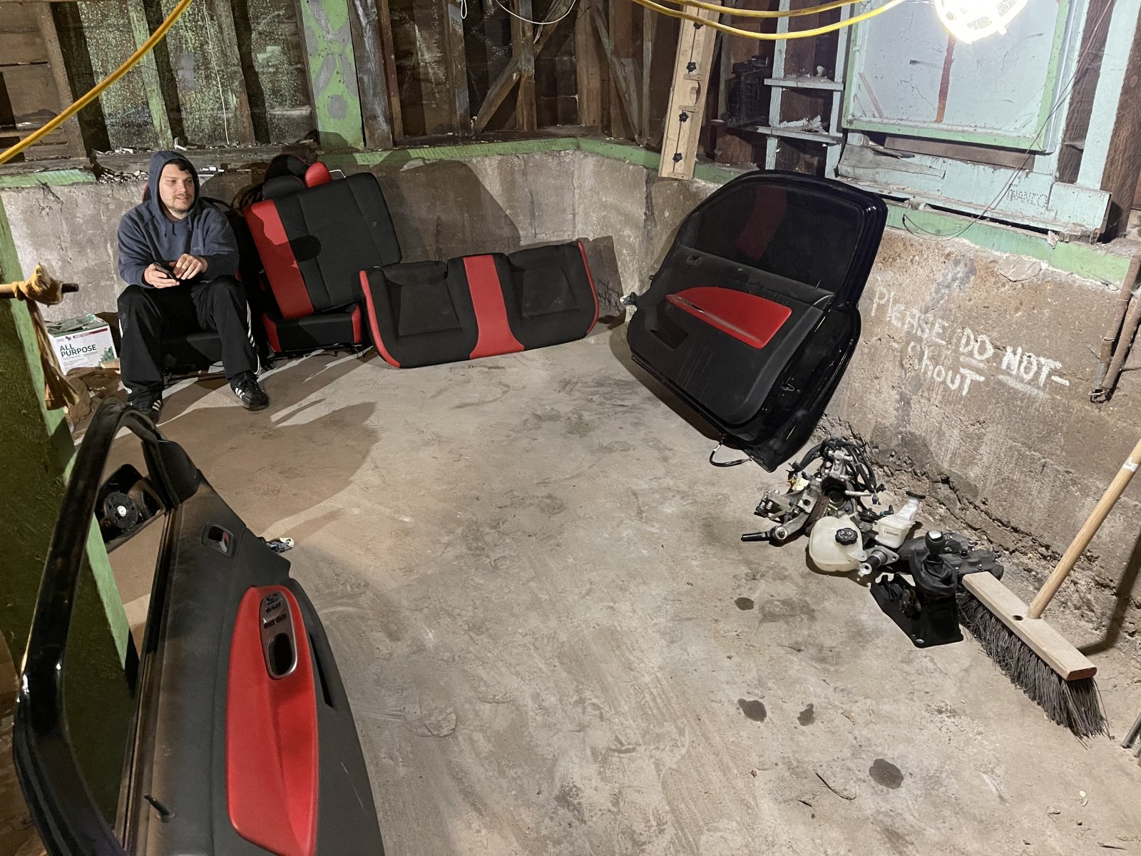

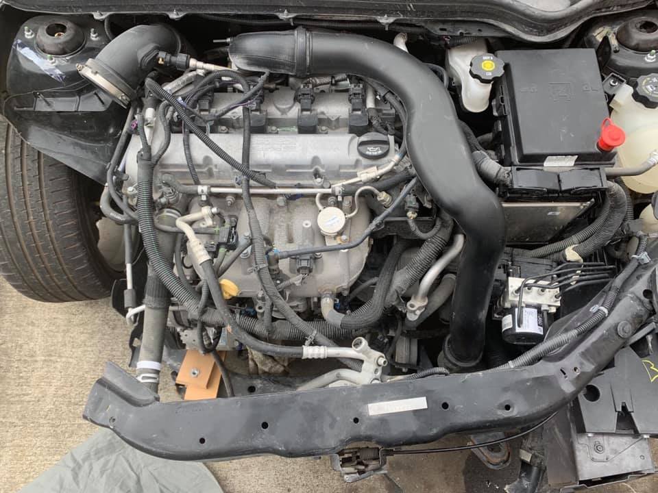

Well I had a really productive day.
8 Hours of work with 1/2 of a helper and the Motor and interior is completely out.
Only ran into a couple of problems. I blew up a 21mm Deep Socket because it wasn't impact rated. And the motor didn't have any lifting eyes on it so I had to get a bit creative. But other than that, I didn't have to fight a single bolt, I guess that's what happens when a car only see the road for 3 months.
I just have to pull the body harness out of the car, strip the dash and drop the fuel tank. I should be able to wrap it all up tomorrow then figure out how to get rid of the shell.

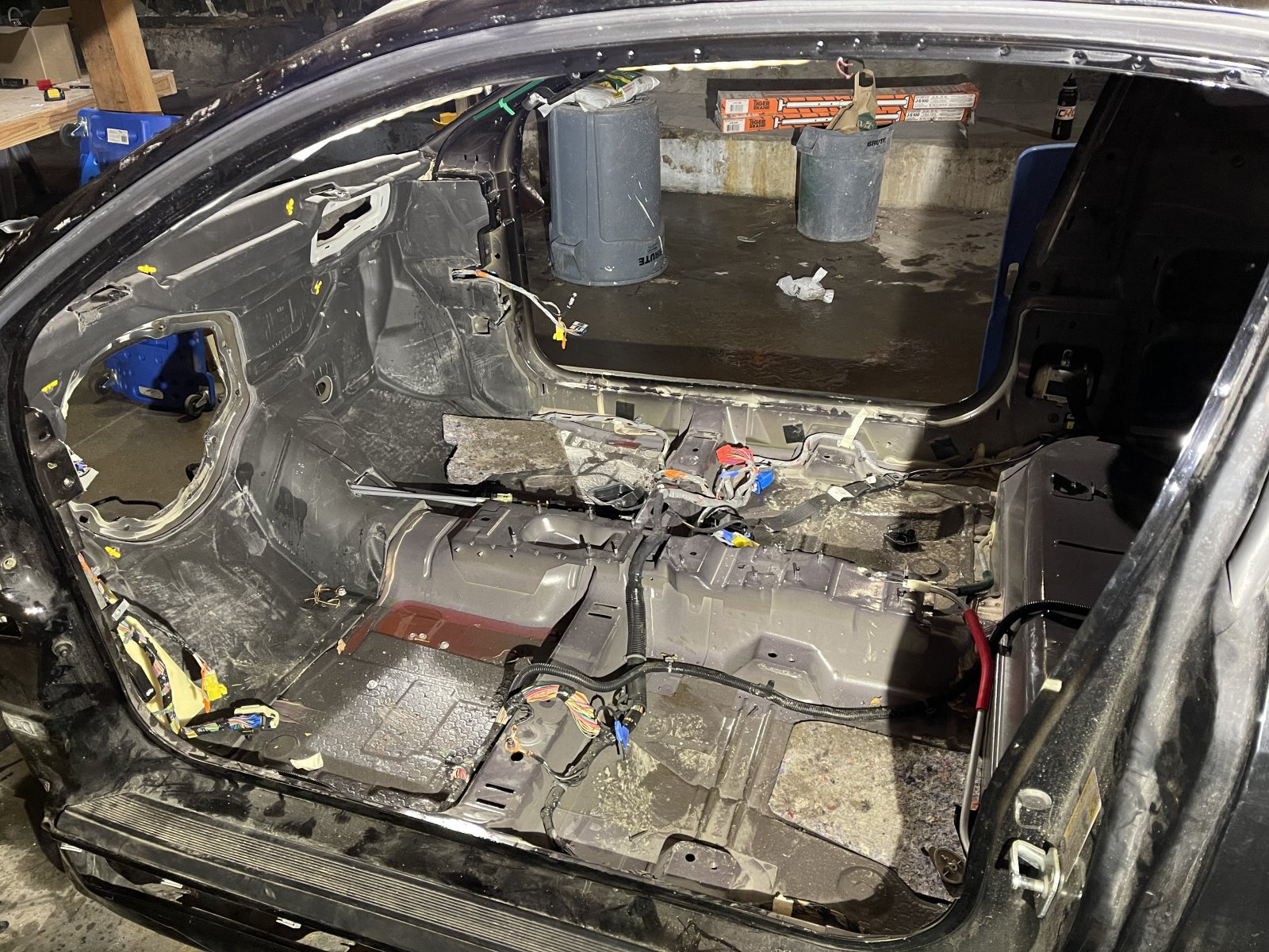

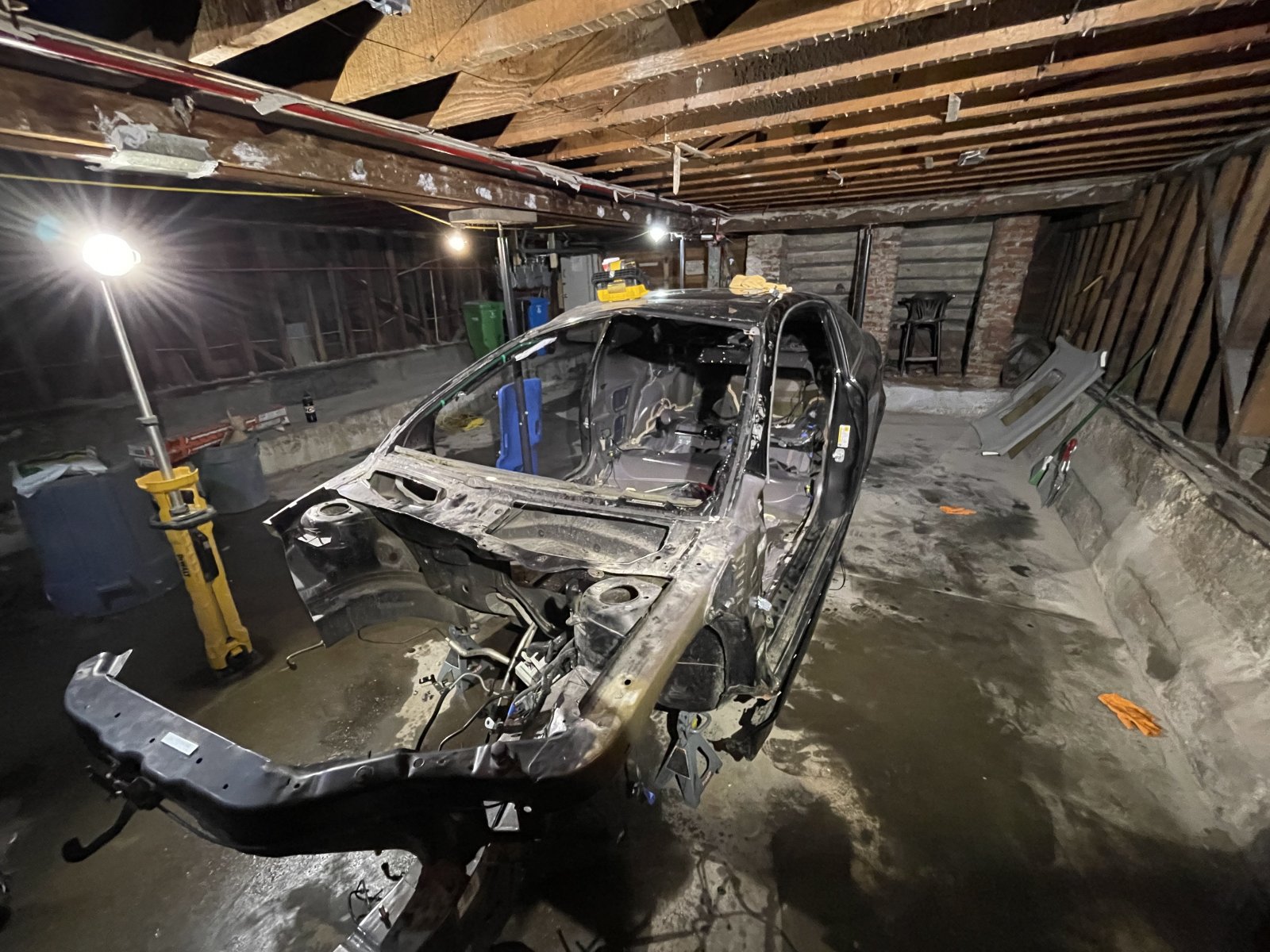

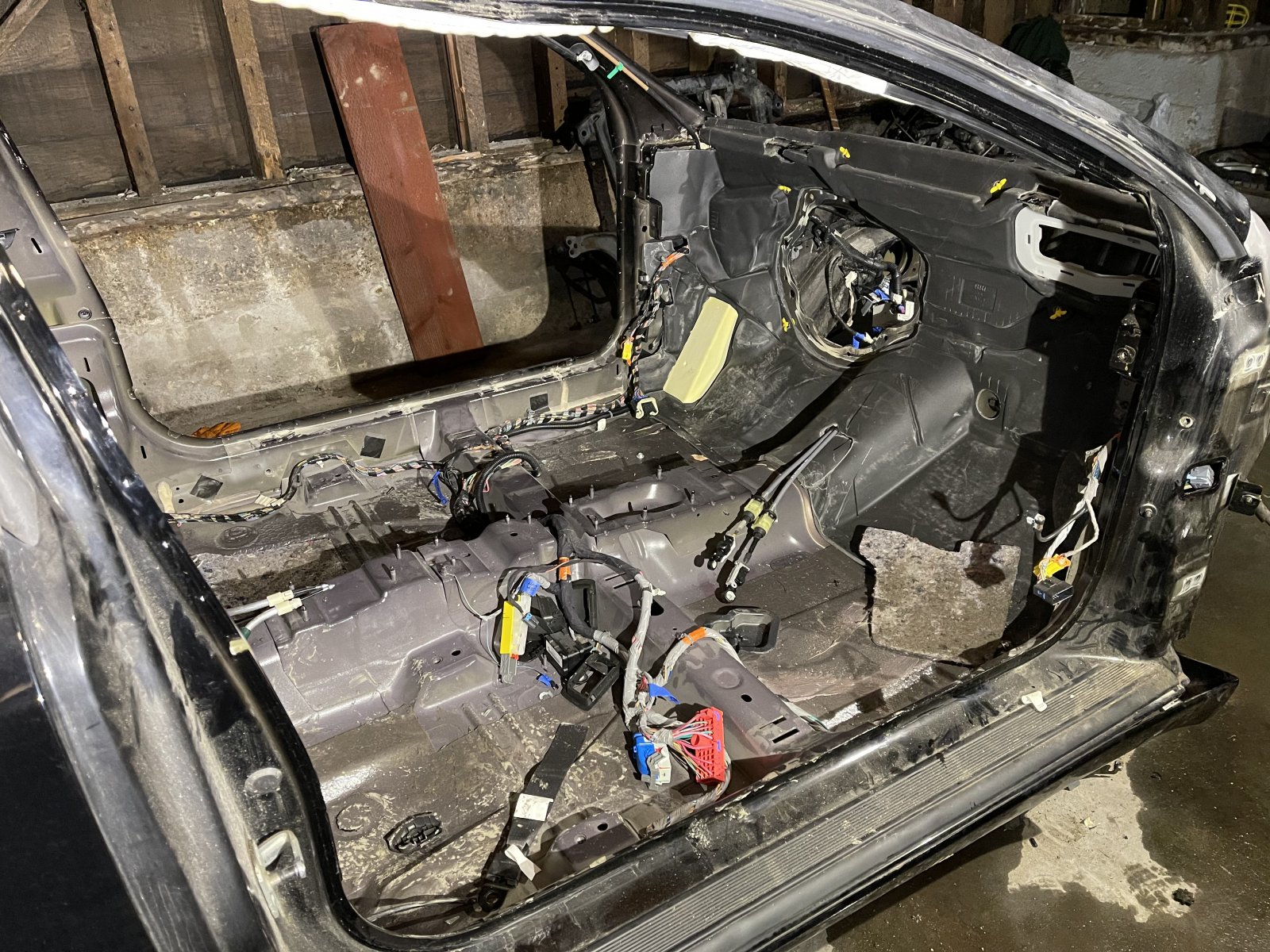

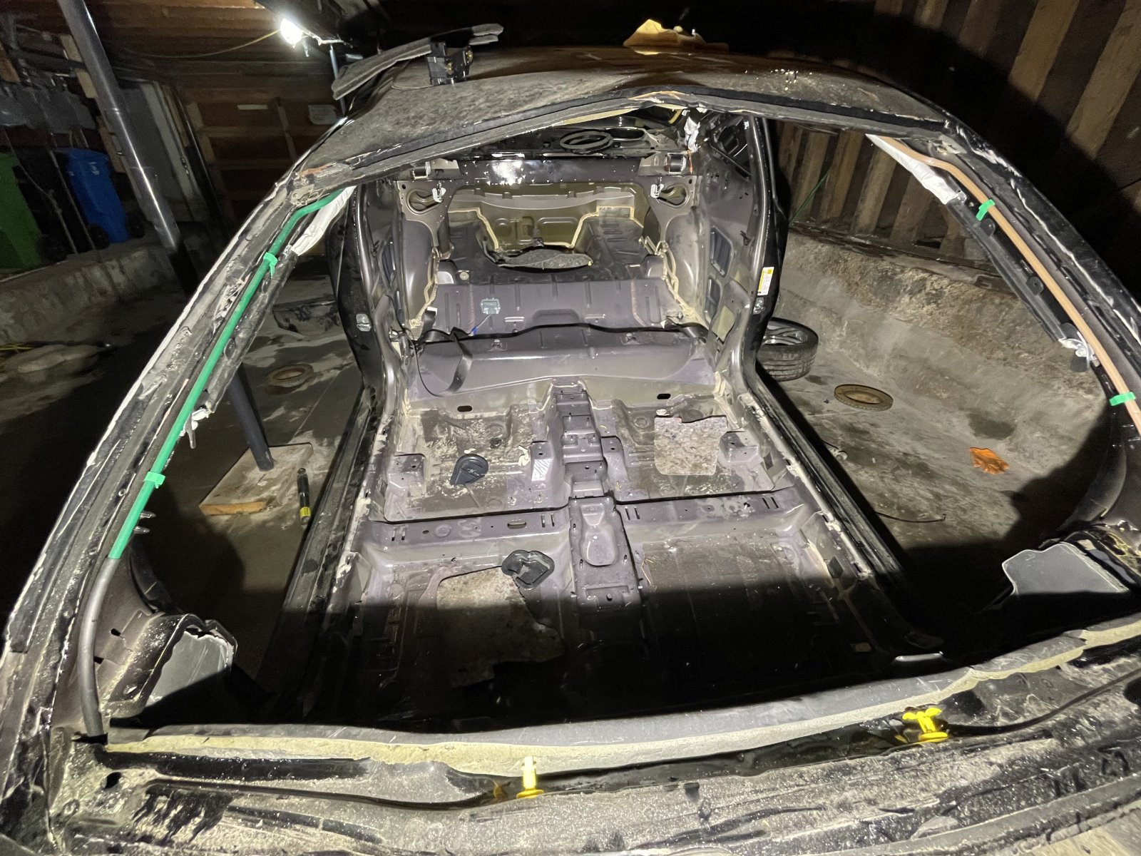

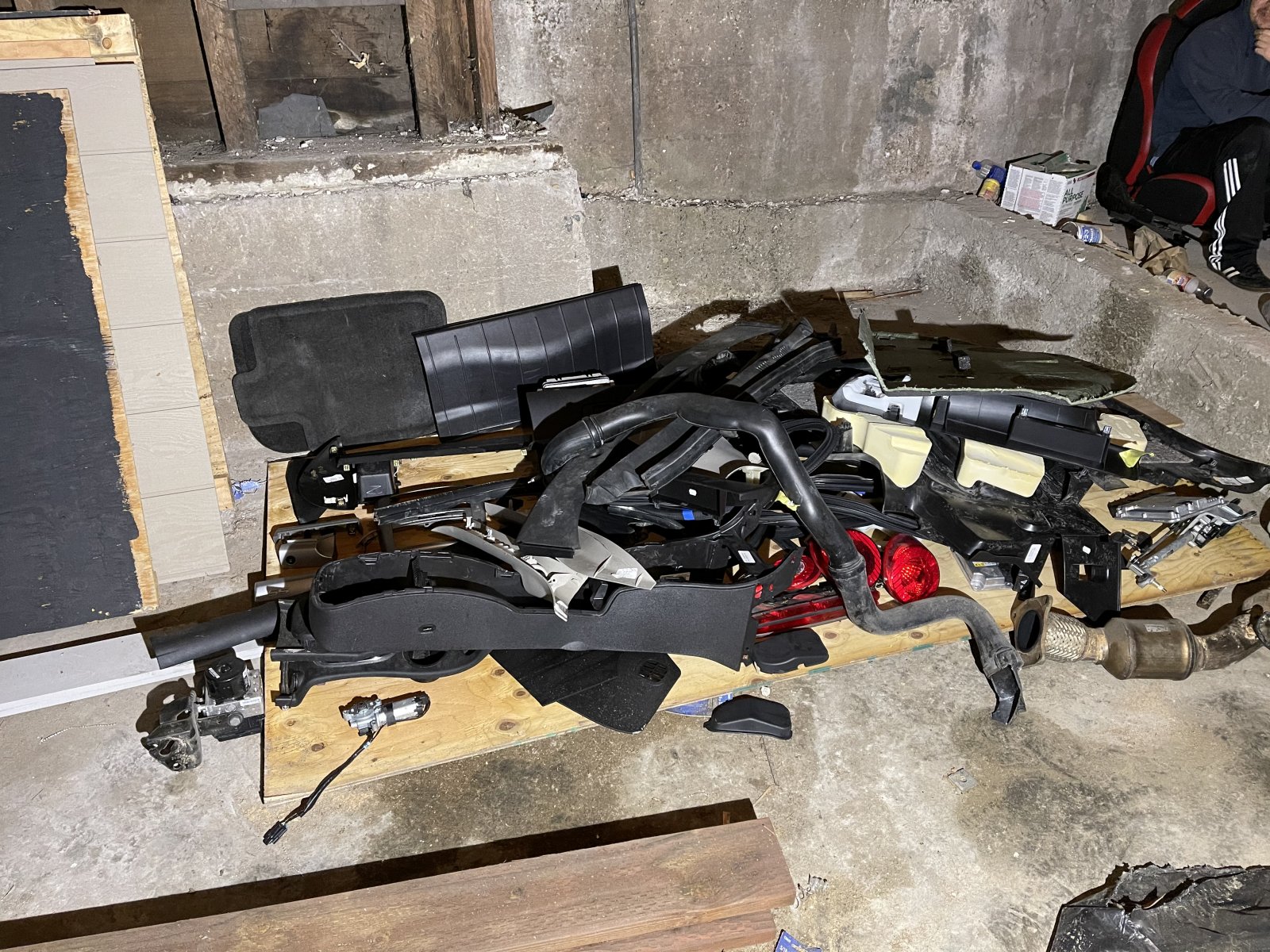

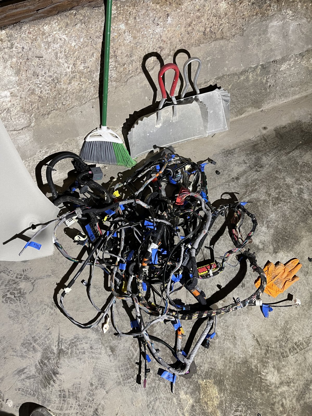

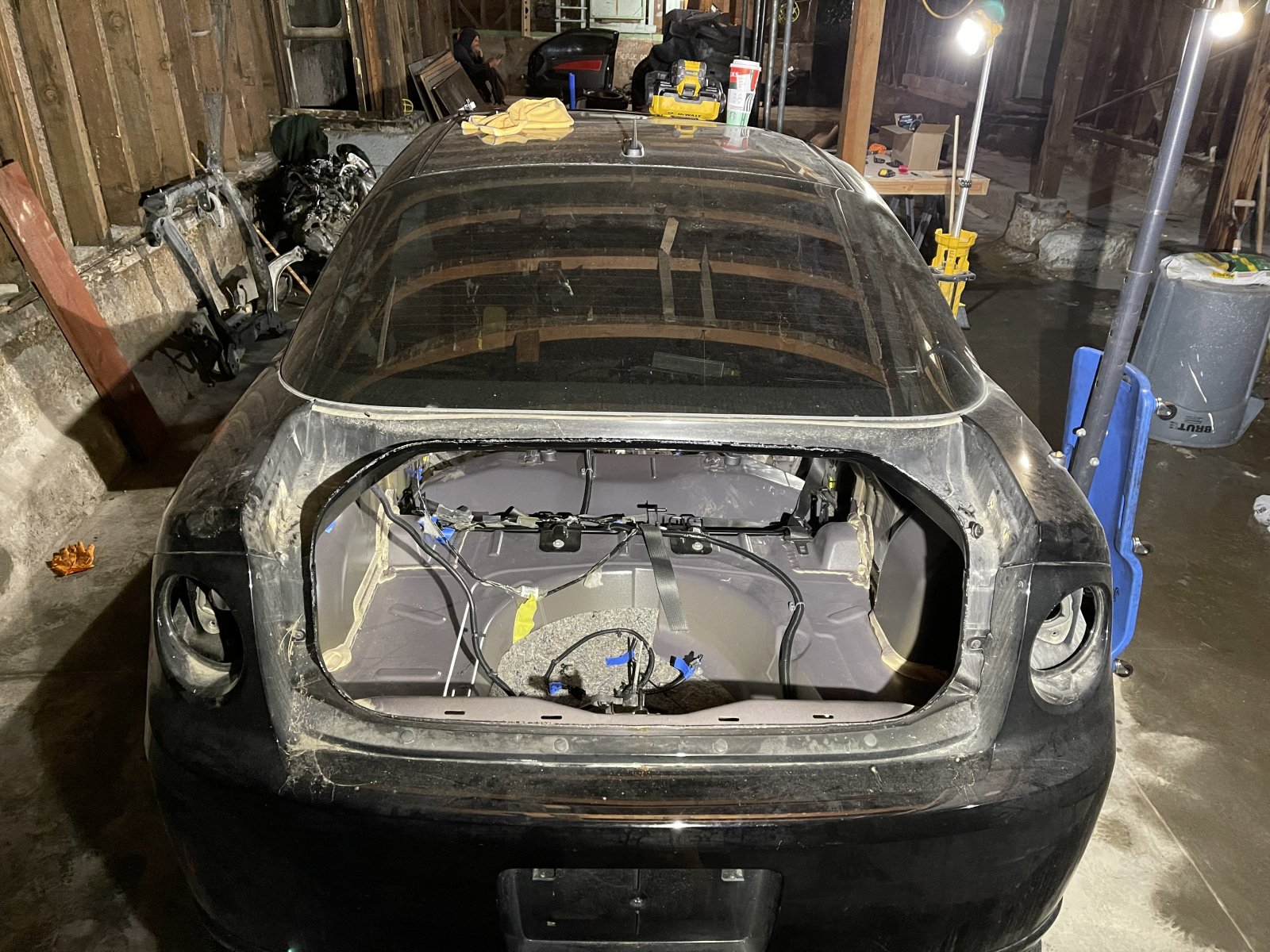

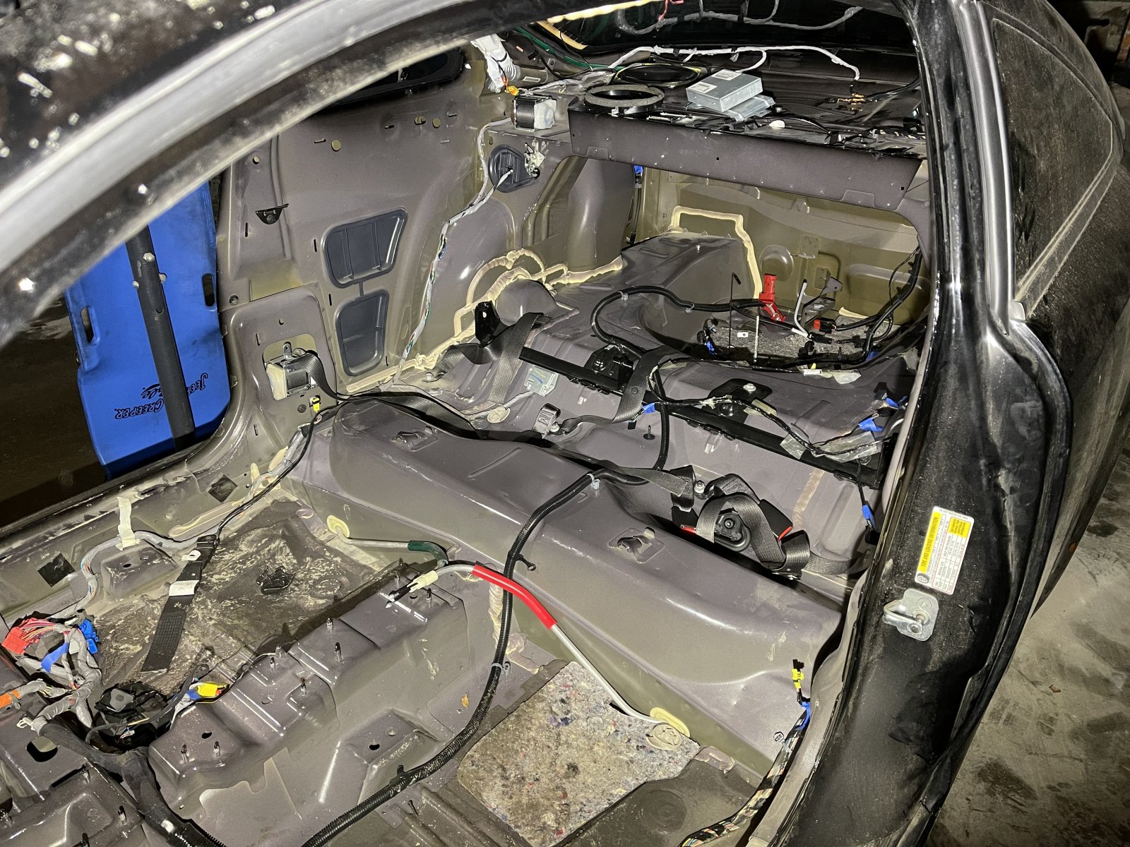

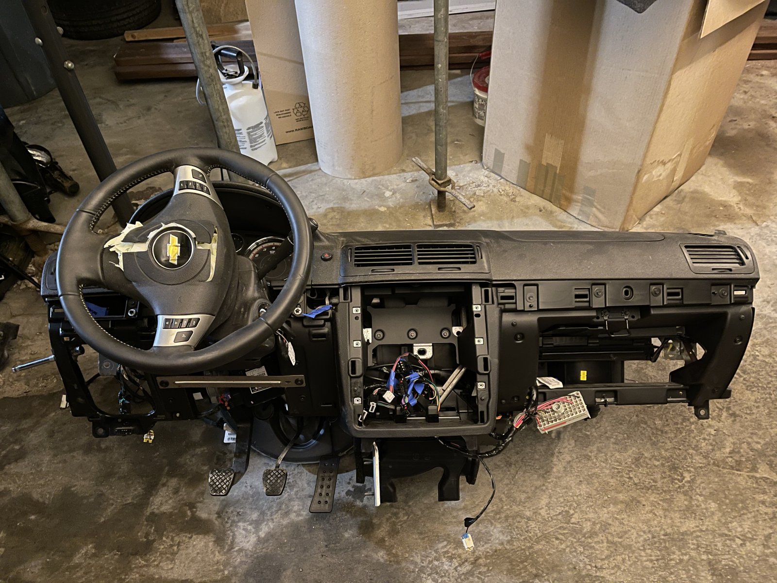

Another productive day.
I got the donor completely stripped. There isn't anything left in it, short of the sunroof.
I started cleaning up parts I'm selling. Next I'll organize and put everything into bins to be stored until the Goblin Frame Shows up in 4 months.

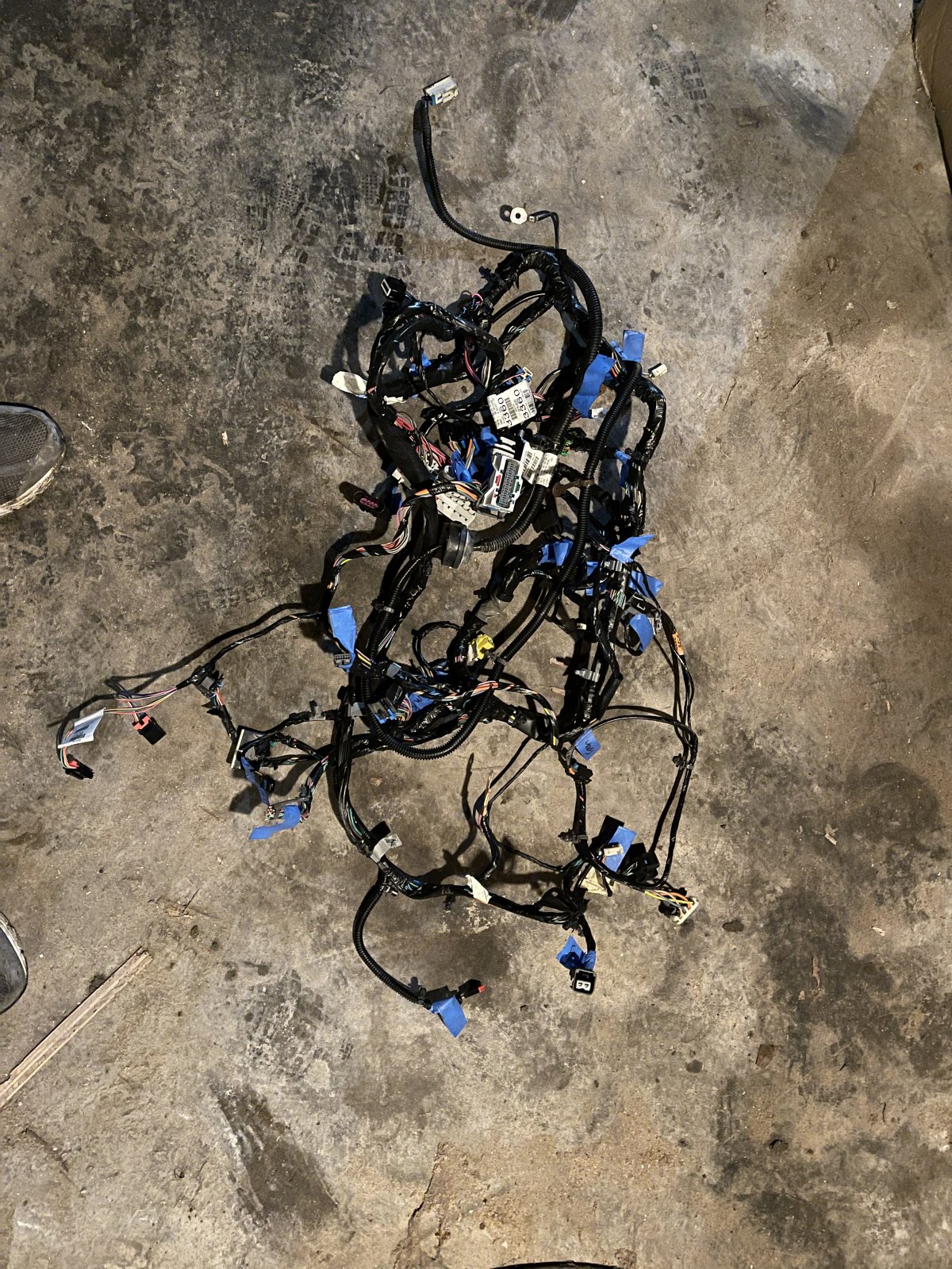

With the frame being several months out and the donor stripped in a weekend I have ample time to research the modifications I want to make.
I do plan on thinning the harness some time in February and want to try and get as many of my electrical mods incorporated at that time.

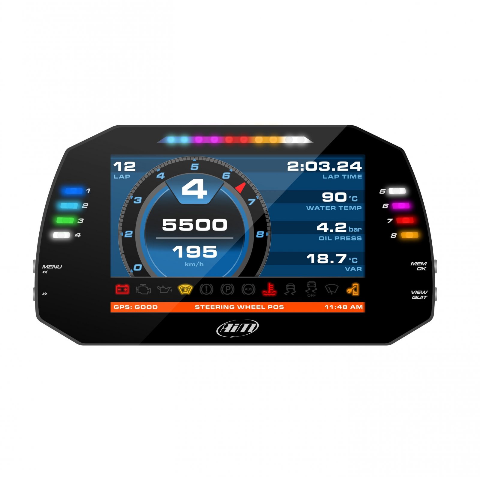

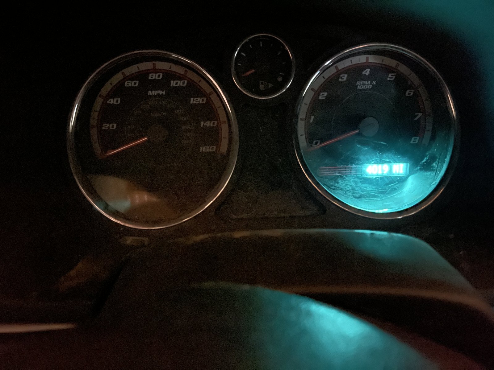

The biggest electrical modifications I'll be making is replacing the OEM cluster with an AIM MXG 1.2 Data Logging Race Dash.
The MXG reads the CAN BUS from the Cobalt to display all the same gauges as the OEM dash. So with just two wires spliced into the Cobalt's CAN+ and CAN- I'll get 90% of the OEM cluster functions.
Although reported through the CAN system, the AIM Dash does not have pre-defined values for various indicators light (like blinkers and hi beams). So unless I can find someone who know how to identify these values I'll have to wire those in separately. I've been talking with Brain74 who has pretty much the identical set up and he has passed on his wiring note saving me much time digging through the wiring diagrams.
In addition to the factory gauges, I plan on adding the following sensors which will all wire into the AIM Dash to report values.
Oil Pressure, Exhaust Gas Temperature, Tire Pressure Monitoring, Fuel Level (not using OEM sender) and am considering adding pressure sensors to the brake system.

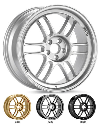

So onto the wheels, and specifically the bolt pattern.
I think I am most likely going to use Enkei RPF1 17x9s all around and will need 5x114.3 hubs.
At a little over 16lbs and a couple hundred dollars each, I don't think I can do much better.
As best as I can tell I have three options to got to 5x114.3
1. Drill the 5x110 hubs to 5x114.3
2. Use Adaptors
3. Change hubs to a 5x114.3 pattern
----Update: Option 4. Custom wheels or Drill manufactured wheels to 5x110. Suggested by Rauq and referenced website for the RPF1s.
https://www.fm-wheels.com/enkei-rpf1/enkei-rpf1-silver-17x9-5x110-22 ---- End Update
For #1, I don't like the idea of drilling the hubs partially because it makes me uncomfortable using drilled hubs in a track application, but mostly because bearings tend to be more of a consumable item when used heavily on the track. So I don't want to have to keep drilling out hubs when they need replacement.
#2. I could order some custom hub centric and wheel centric adaptors. I haven't made up my mind if this is ok or not. There are very opinionated people on both sides of this argument. I still can't decide if a 25mm adaptor would put any more stress on the bearings compared to a wheel with 25mm more of an offset. I don't think there are safety concerns with well made adaptors, just ware and tare and added rotational mass.
#3 would be ideal. It does not appear that that someone has found a prefect 5x114.3 hub for the LNF. The closest I've come across is an 04 Grand AM that has a 5x115 hub.
Searching through the forms it doesn't look like any Goblin owners have tried the Grand Am Hub.
Here are the spec of both the hubs.
Cobalt LNFGrand Am
Spline Quantity3030
Bolt Circle Diameter4.330"4.530"
Bolt Circle Diameter110 mm115 mm
Flange Bolt Hole Quantity33
Wheel Pilot Diameter65 mm70 mm
Brake Pilot Diameter65.4 mm70.5 mm
Wheel Stud Quantity55
Hub Pilot Diameter89.1 MM91.4 MM
Flange ShapeModifiedTRIANGULAR
Anti-Lock Brake (ABS) Sensor IncludedYesYes
Flange Offset39 mm36.9 mm
Flange Diameter137 MM145 mm
The question also remains as to how well a 5x114.3 wheel will work on a 5x115 hub. Again, very opinionated people on both sides of the argument.
Are there any other reasonable ways to get a 5x114.3 bolt pattern?
