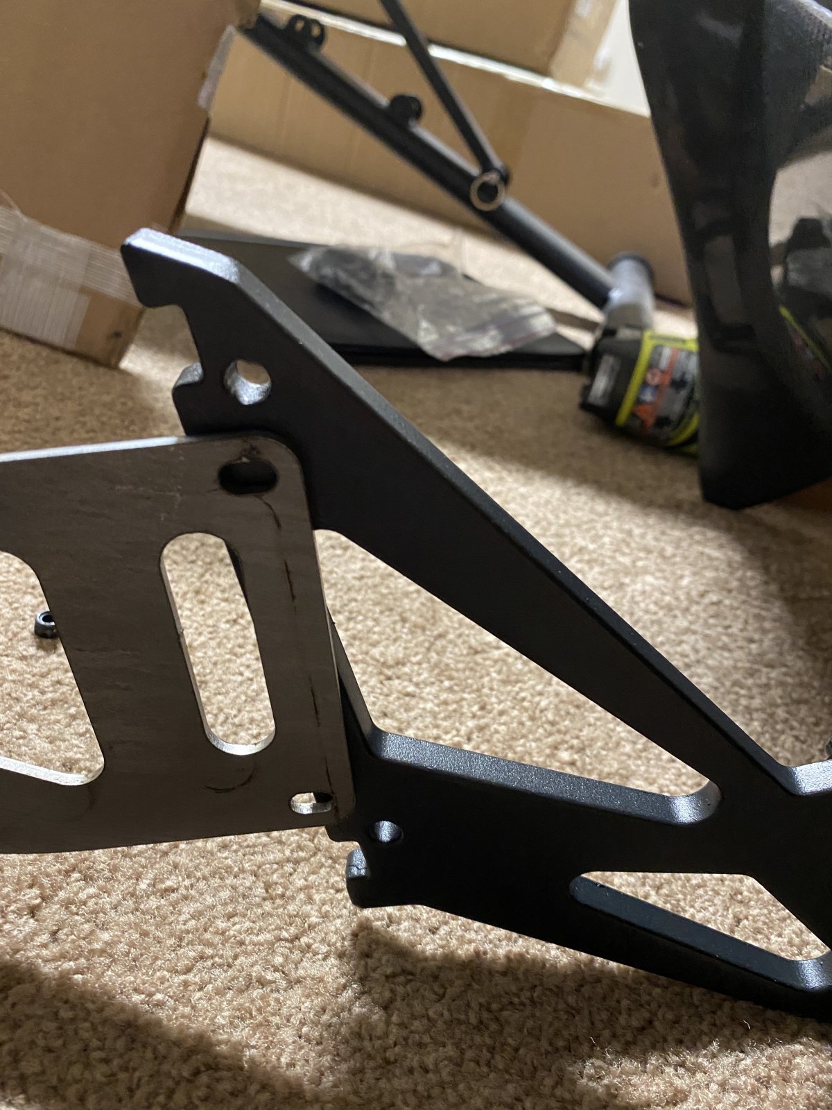

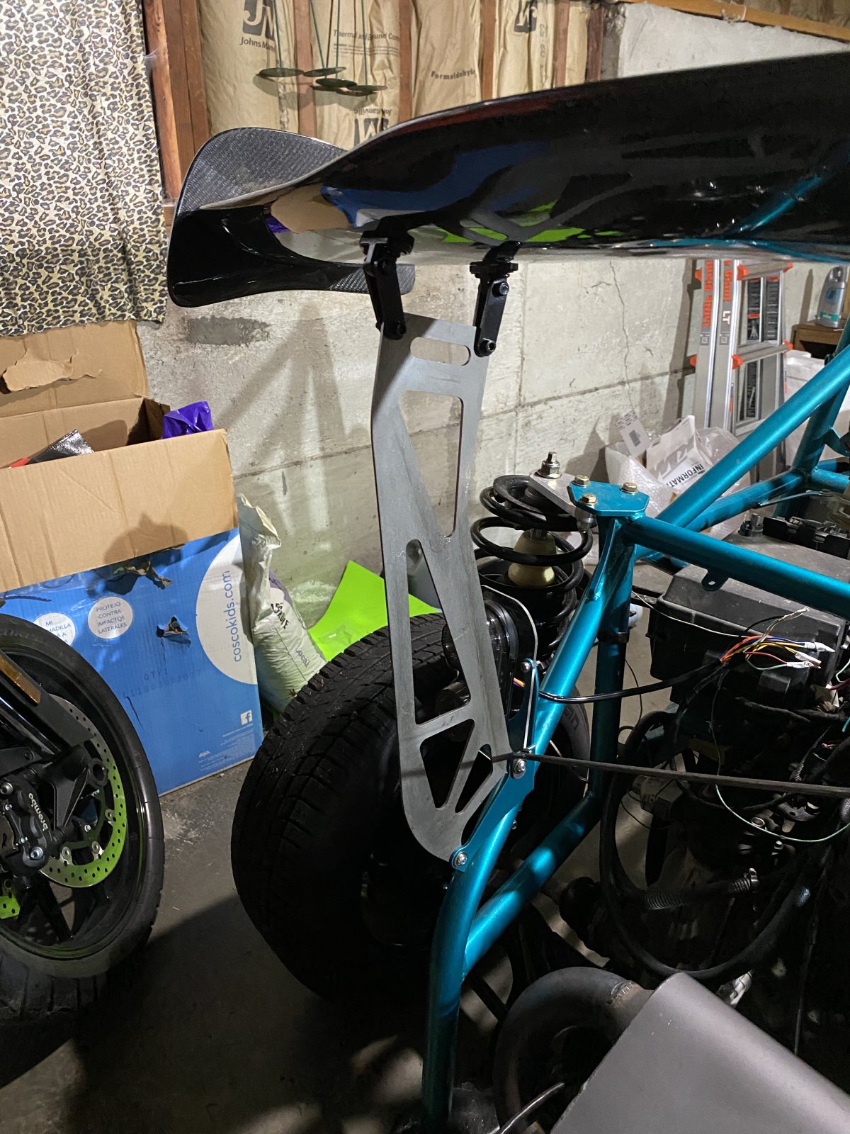

@Goblin Graber and @Ark :D The wing basically mounts directly onto the DF uprights. The distance between the supports is not exactly the same as the car, but it is close enough that there is enough flex to make it fit without issue.
If you try to use the supports that wing came with, the mount locations don't line up with the DF uprights, I could have built an adapter, but decided to skip that and mount the uprights directly to the wing.
20017
Here's a close up of how the wing mounts up
20018

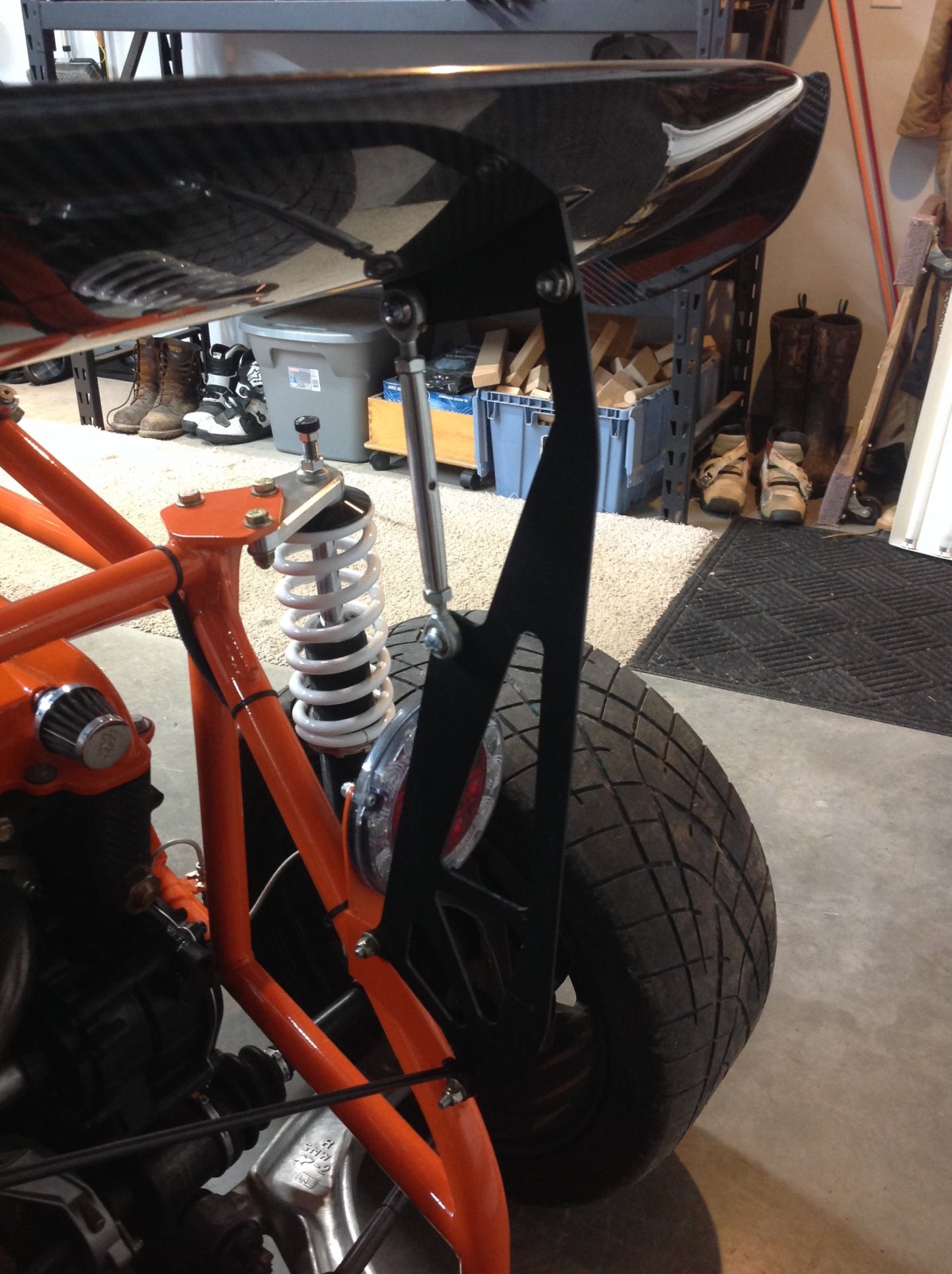

Man the color of that frame! Absolutely love it.
I grabbed an ebay wing for my car from a kid with a honda off facebook marketplace, oddly enough it bolted directly up to the df mounts with zero modification. Best $60 ever! It was a generic no name brand honda wing, I wish it had a part number on it. It's actually pretty nice.

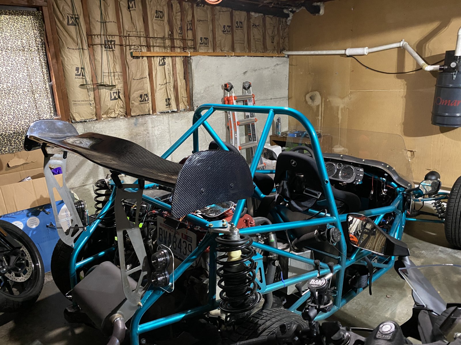

So after ~8 months of other life stuff coming in the way, I'm finally back to working on my Goblin. I got some drives in to start tuning the car, which is always fun. But have a few items to go on my list:
  • Clean up wires for the wideband
  • Install BCM kickplate
  • Figure out wiring for and install a third brake light
  • Add slider for driver seat
  • Tighten the passenger seat mount
  • MAF and VE tuning
  • Wrap installation - have the design all worked out, need to get the car up to the shop and get it installed
If I get the above done before the winter, then over the winter I will:
  • Install turbo kit - need to figure out a solution for a new exhaust to fit the larger turbo exhaust or find a way to step down the turbo exhaust to fit my existing set up
  • Set up to tune with turbo - mainly get the car to start, and stay on once the turbo is installed
  • Paint the brake calipers in red

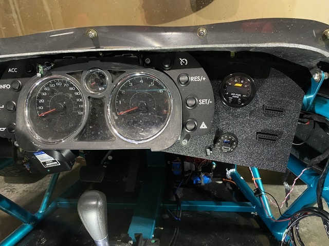

Anks329
Add a SAE power port to keep my battery tender plugged in and keep the battery charged up. Battery is kinda dieing, so need a replacement over the weekend.
Anks329
I've routed it to my dashboard area for now. I'm thinking of doing a wooden dash later this year, so will mount it nicely along with some other gauges and such.
