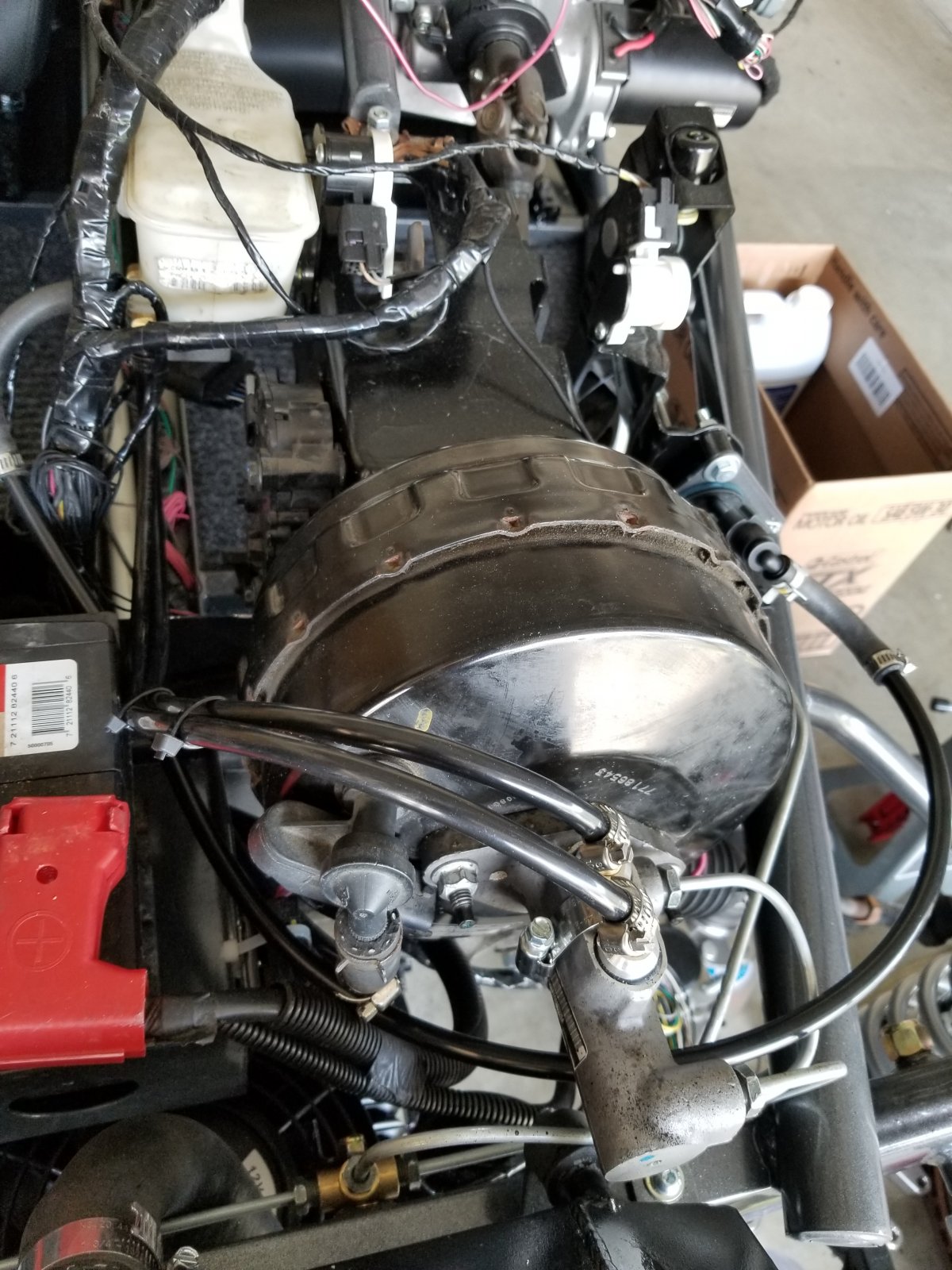

Amazon brought me some more 3/8" nylon hose so I could finish the brake runs and the clutch run in the front. Yes, I know you're not supposed to use regular hose clamps, but I did anyway. Don't mind the untidy wires, I haven't finished up wrapping the harness because I haven't gotten the first start yet, and I need to fix my bugaboo with swapping the headlights and turn signals, first.
I picked up some heater hose so I could connect the bottom port on my coolant reservoir to the coolant loop T on the engine. I got about as much coolant into the loop as I could without it circulating, about a gallon and a half. One thing I forgot about though.. on the bottom of my coolant reservoir, there's a small hole that's plugged with a red plastic plug. After I had filled the coolant loop as much as I could, I noticed the plug, so I pulled it out and coolant dribbled out. I put the plug back, went and checked my first donor's coolant reservoir (I could not use that one because the clip was busted off), and it's not plugged. Looks like it's there to make sure the reservoir isn't over-filled, so I'll wait until I get the coolant circulating, then I'll remove the plug.

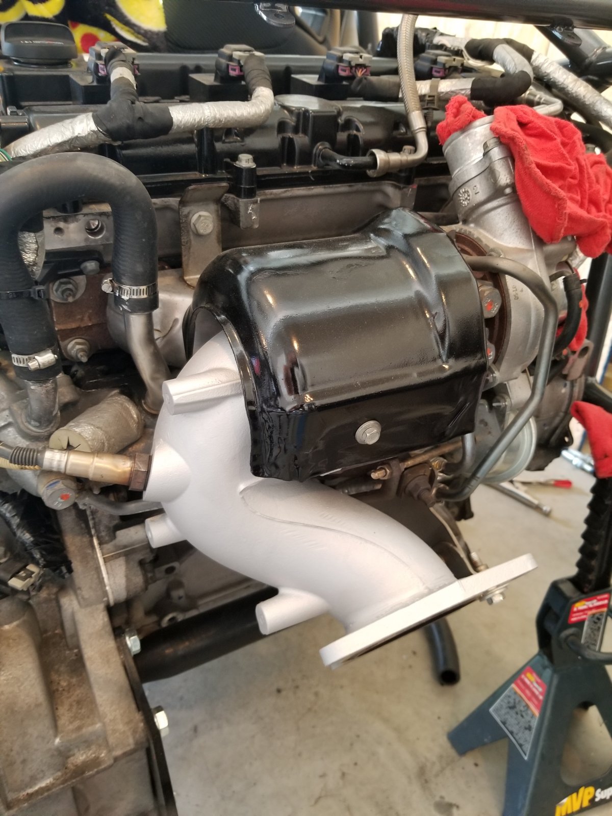

Finally, I sprayed my DF exhaust with the high-temp silver Krylon I got earlier today. That stuff is amazing ... it goes on so easy, and it's really hard to mess up, unlike the Rustoleum semi-gloss high-temp black I've used in a few other places. After I sprayed it, I looked at the rust-colored exhaust manifold, most of which is now exposed because I took the horrible-looking bottom part of the heat shield off of it, and I knew I had to take it off and spray it, too. The contrast between it and the muffler would have just looked awful. So, I did.
I almost wish I had painted the entire engine using this Krylon stuff. Maybe that'll be my off-season Goblin project.

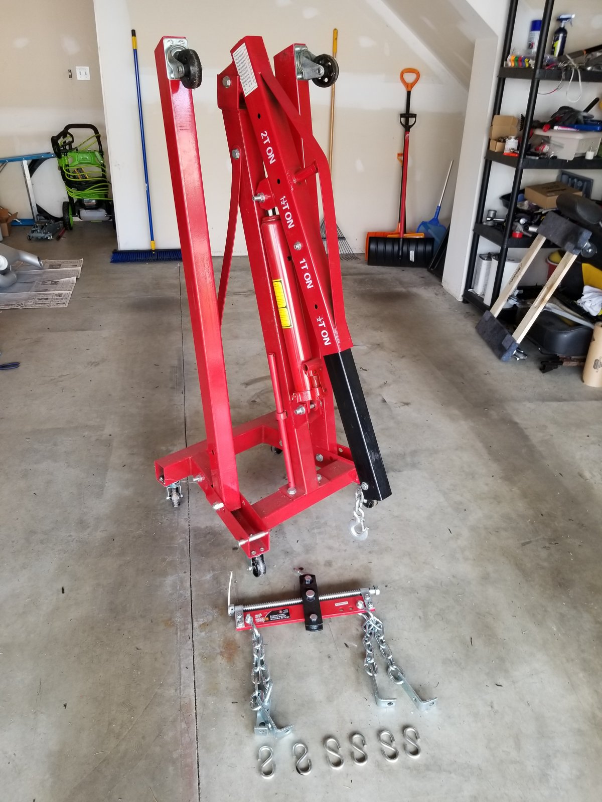

I won't be too upset if I have to buy a new battery, though. I decided to list my engine hoist and leveler on FB Marketplace for $200, and it sold in about 10 minutes. A sale isn't a sale until the cash is in-hand, of course, but that'll offset the new battery nicely.

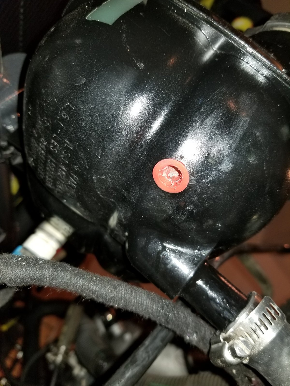

Don't fret about the clamps on the brake reservoir. Per Lonny, you do not even need clamps. No pressure there. Just a leak possibility.
Are you sure that hole and red plug in the expansion tank are OEM? I do not have one? Not sure what pressure the expansion tank might see, but that little plug does not look as robust as the filler cap. Or, is that really small and just the overflow from the filler cap port?
The hole is definitely OEM. Both of my coolant reservoirs have it ... the only reason it's plugged on the reservoir I installed is because I bought it from eBay, and it shipped with plugs in all the holes. Since I painted it black and it was full of coolant, I could not tell what the hole was for, so I looked on the other reservoir and it just appears to be there to prevent overfilling and/or for pressure equalization. Once I get the coolant circulating, I'll see if it still leaks.
Y
My understanding is: this hole is for pressure release purposes. It goes through reservoir and connects to the pressure release channel under the cap.
I had some leak from this hole. Was fixed by coolant reservoir cap replacement.

The plugged hole on the reservoir needs to be unplugged. It’s the coolant overflow.
