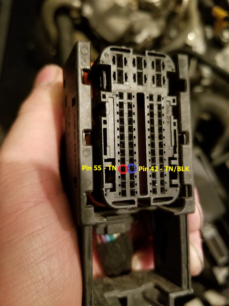

For those with SS/TC donors that are interested, pins 42 and 55 in the body-to-ECM connector are the high speed data wires, with pin 42 being tan/black and pin 55 being tan.
I have confirmed continuity between the pins above and their respective pins on the OBDII port, so that's one concern put to rest.

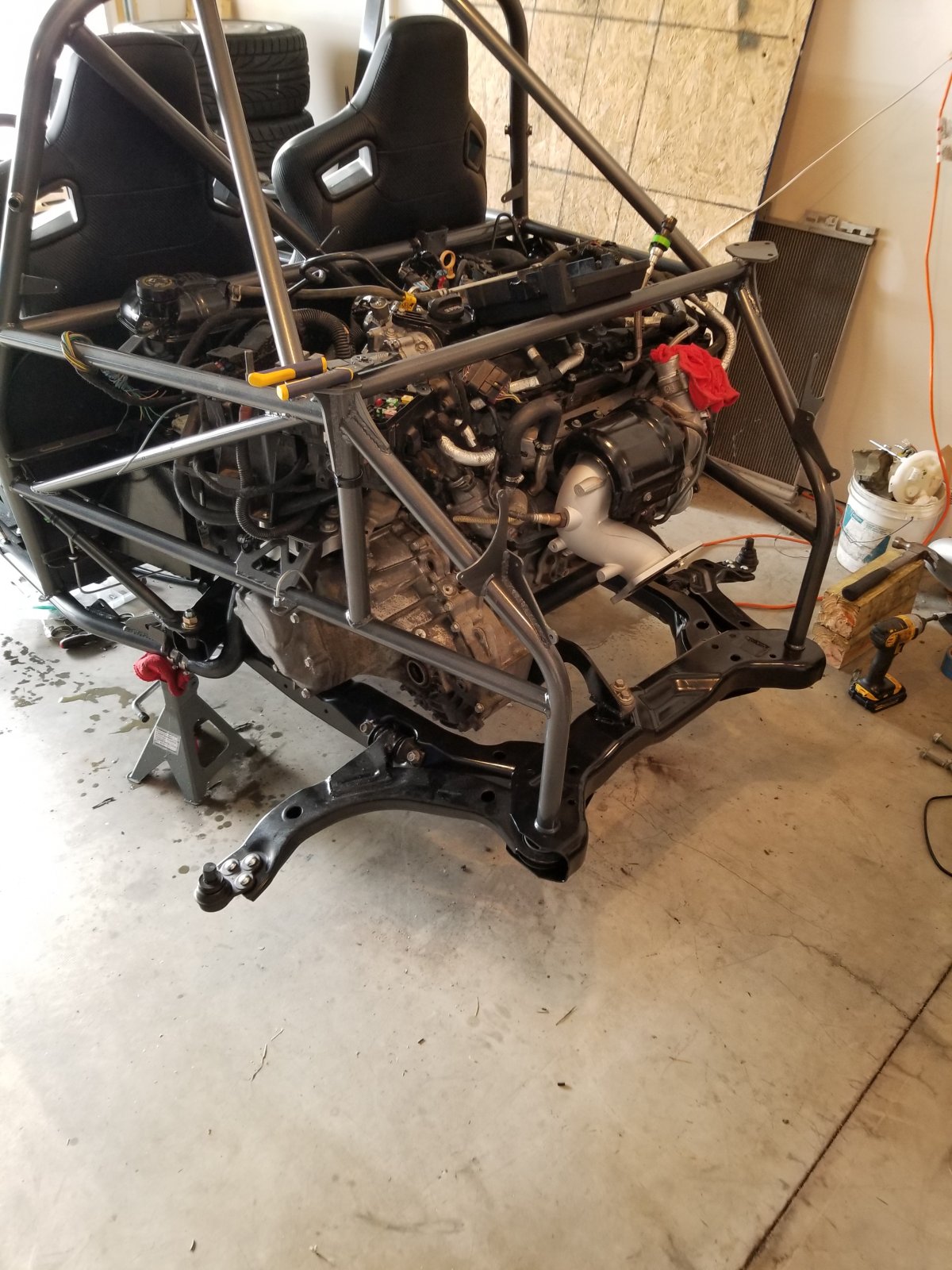

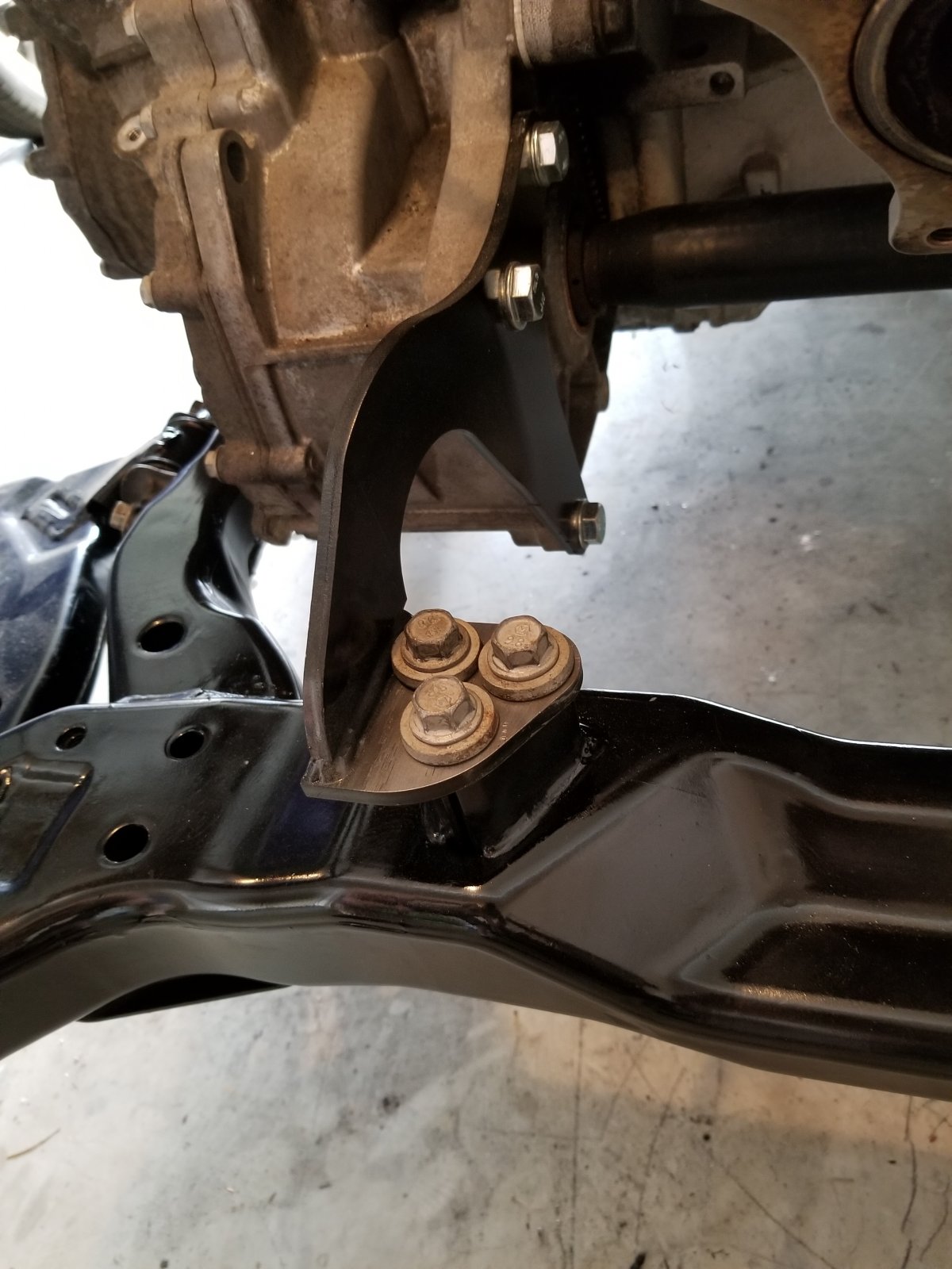

It took some real creativity with a floor jack, a furniture dolly, and some blocks of wood to get that puppy mounted up by myself. I got it done though. (I certainly hope I don't have to remove it to install the toe links, man would that stink)

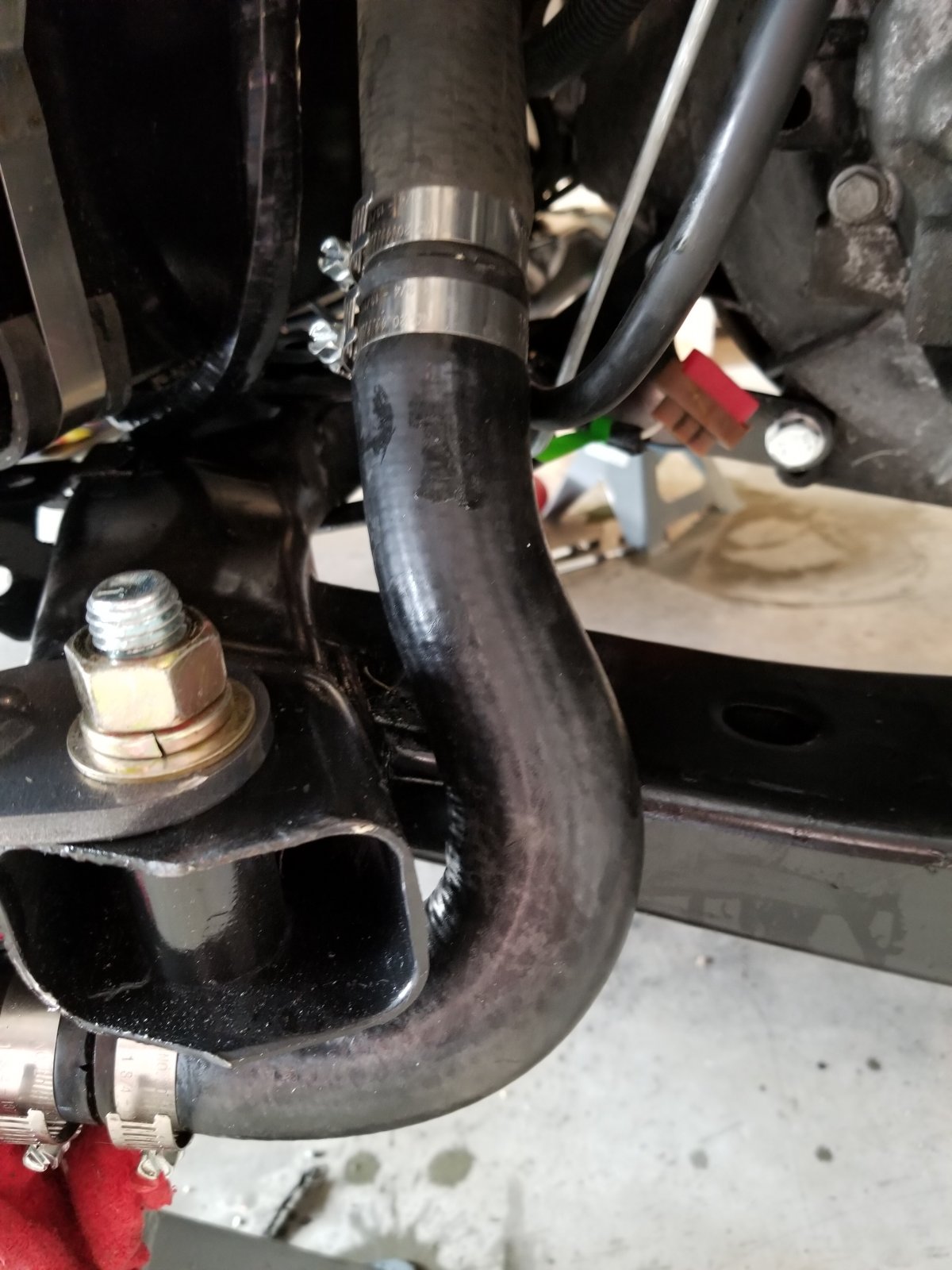

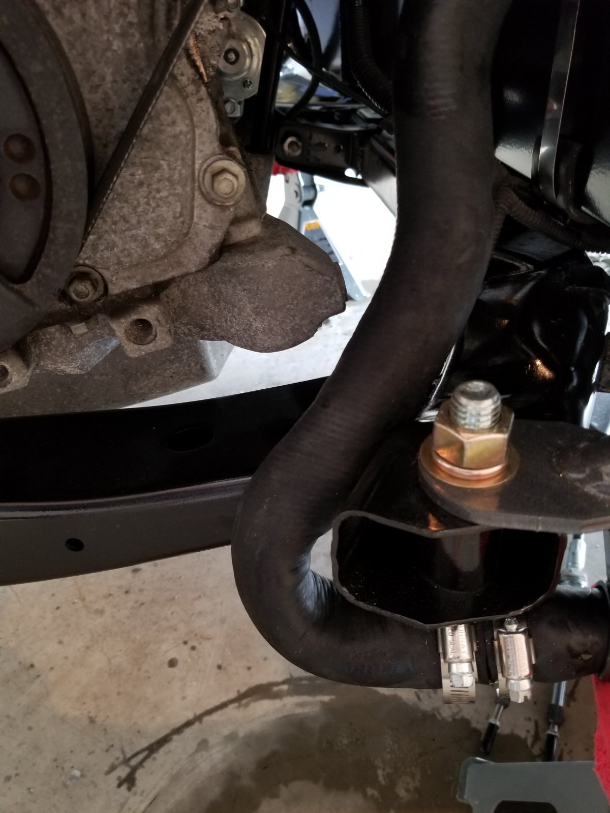

But of course, nothing I do with this project is without some heartache. For one, getting the hard mounts to line up properly was really tough. I had to lift here, contort there, etc to get all the bolts started, then I tightened them down. I didn't torque them down yet, I've had enough for today. Also, I managed to damage the driver-side heater hose very close to where it comes out of the frame. Coolant everywhere. I quick opened the release under the rad and saved what I could, but some was lost. No big deal. I was fortunate; the damage to the hose was far enough away from the frame that I was able to cut it off, jam the coupler in a little further, and tighten the hose clamps back up. I think if I had to pull more hoses, I would abandon ship. If I could do it all over again, I would mount up the subframe before finishing the coolant plumbing; those hoses are a little brittle and are right in the way.

on the motor/trans mounts. My solution was to keep everything loose. Cradle, engine mounts, trans mounts, everything And it just slips all together. I know you don’t want to hear that. :p
