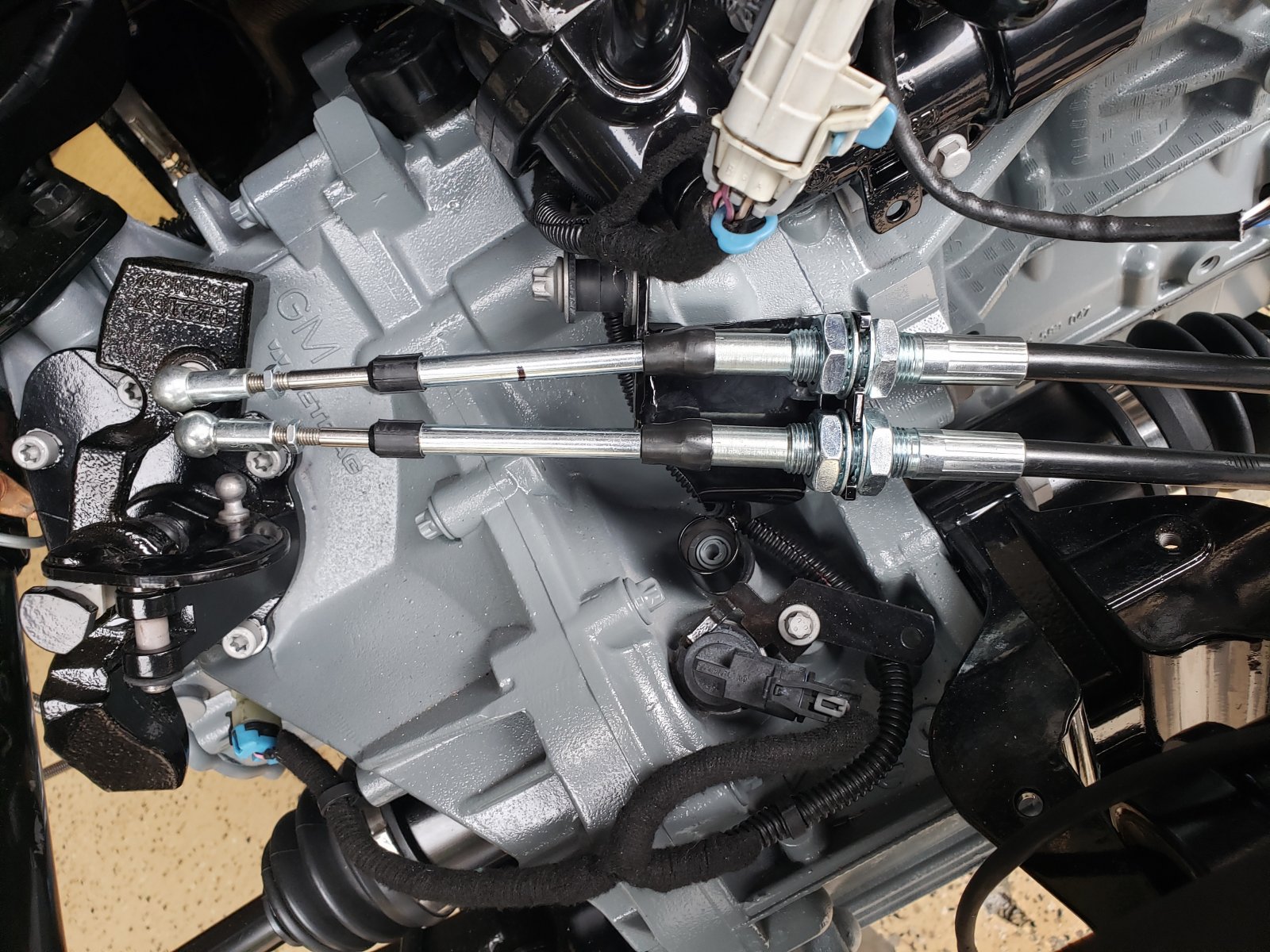

Still waiting on stuff like seats, tires, brake pads, led head lights, wiring harness, and other things but ended up getting covid on Friday so I’ve been sick for the past few days:( does anyone know how the shifter cable bracket mounts on the transmission? It’s a f23

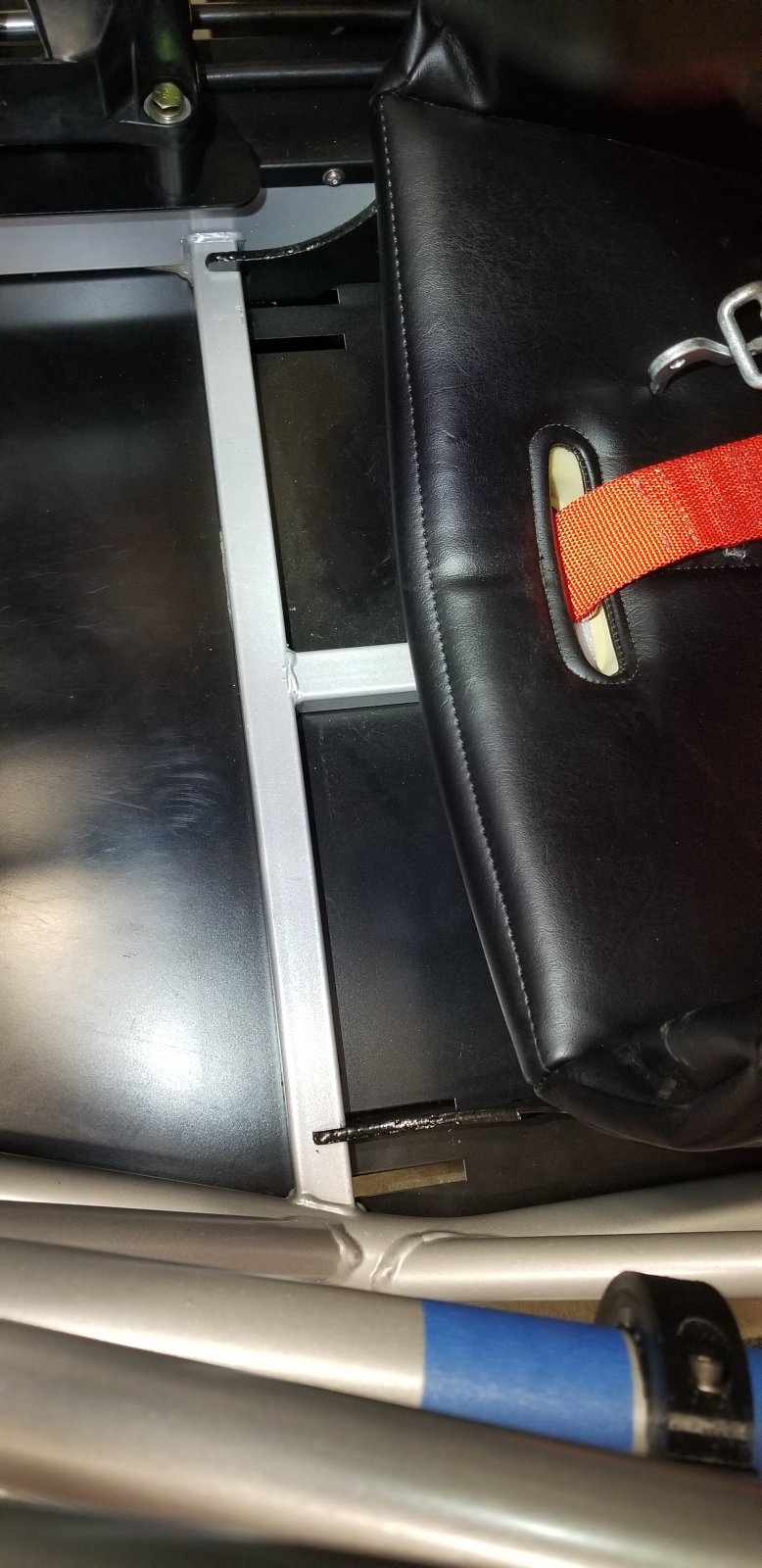

I had used the Speedway Budget seats, made by Kirkey, 17.5 wide seat.
I thought I had posted about installing them but i found that i hadn't.
Mounted using the DF seat mounts. Side mounted.
To get the drivers seat centered to the steering wheel, I used both of the left mounting tabbed brackets.
In the right side slots.

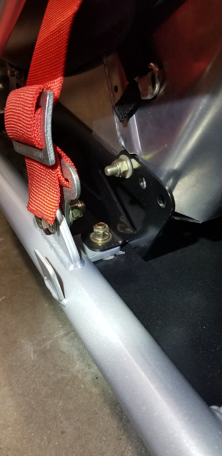

You may want to reverse the bold on the lap belt on the putter mounting point if you plan on putting side on. Once the sides are on there’s no room to get the bolt out.
Waterdriver
That is absolutely correct for anyone using the DF side panels.
I'm going a different route for side panels so it won't be an issue.

Dunno if you received a response. This is how i mounted my bracket. Not sure if it is correct as no one was able to verify mine.

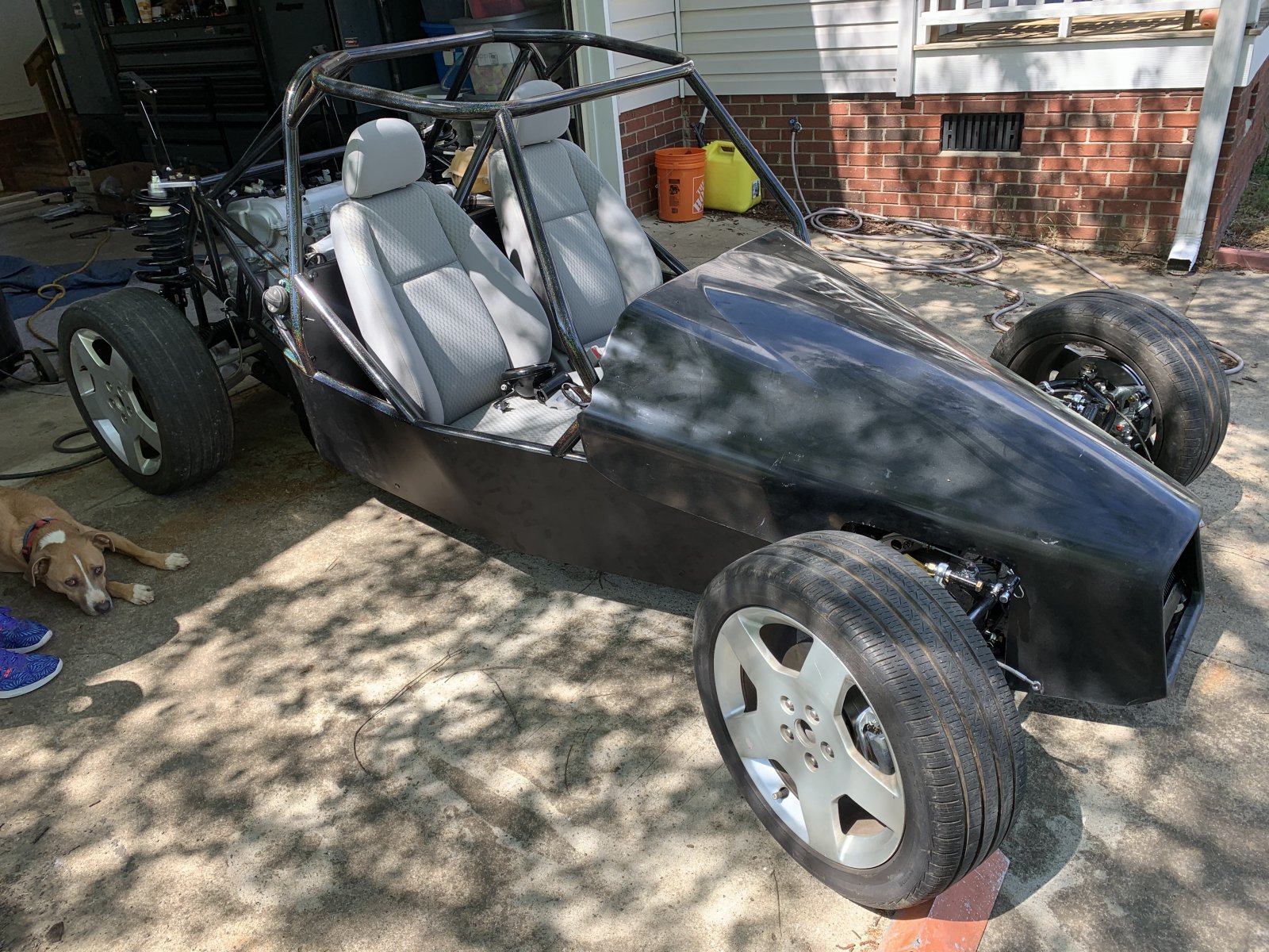

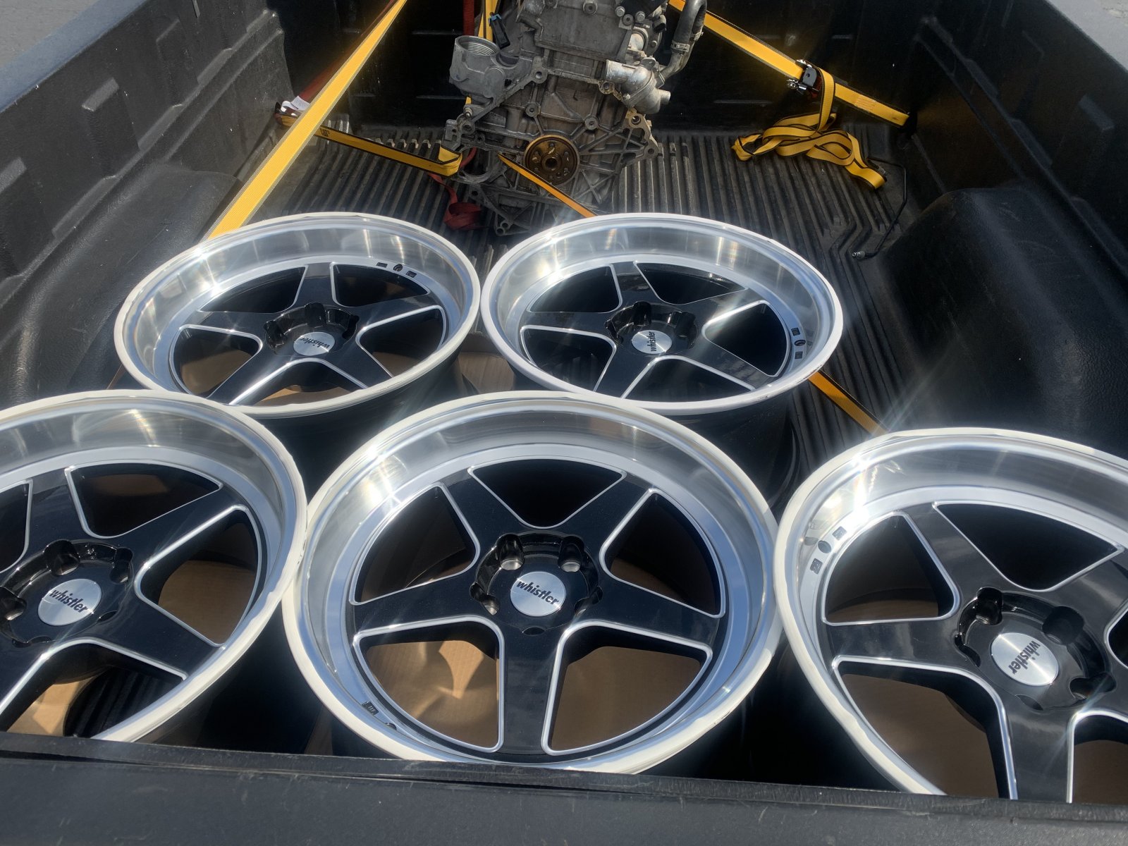

Sorry for not updating in a while, at a standstill till I get my harness back from dfkitcar. Waiting on solid trans mounts, missing the 3 bolt steering column mount, button panel, and missing the spacers for the instrument cluster. But while I am waiting on those parts I got my wheels and tires and seats
