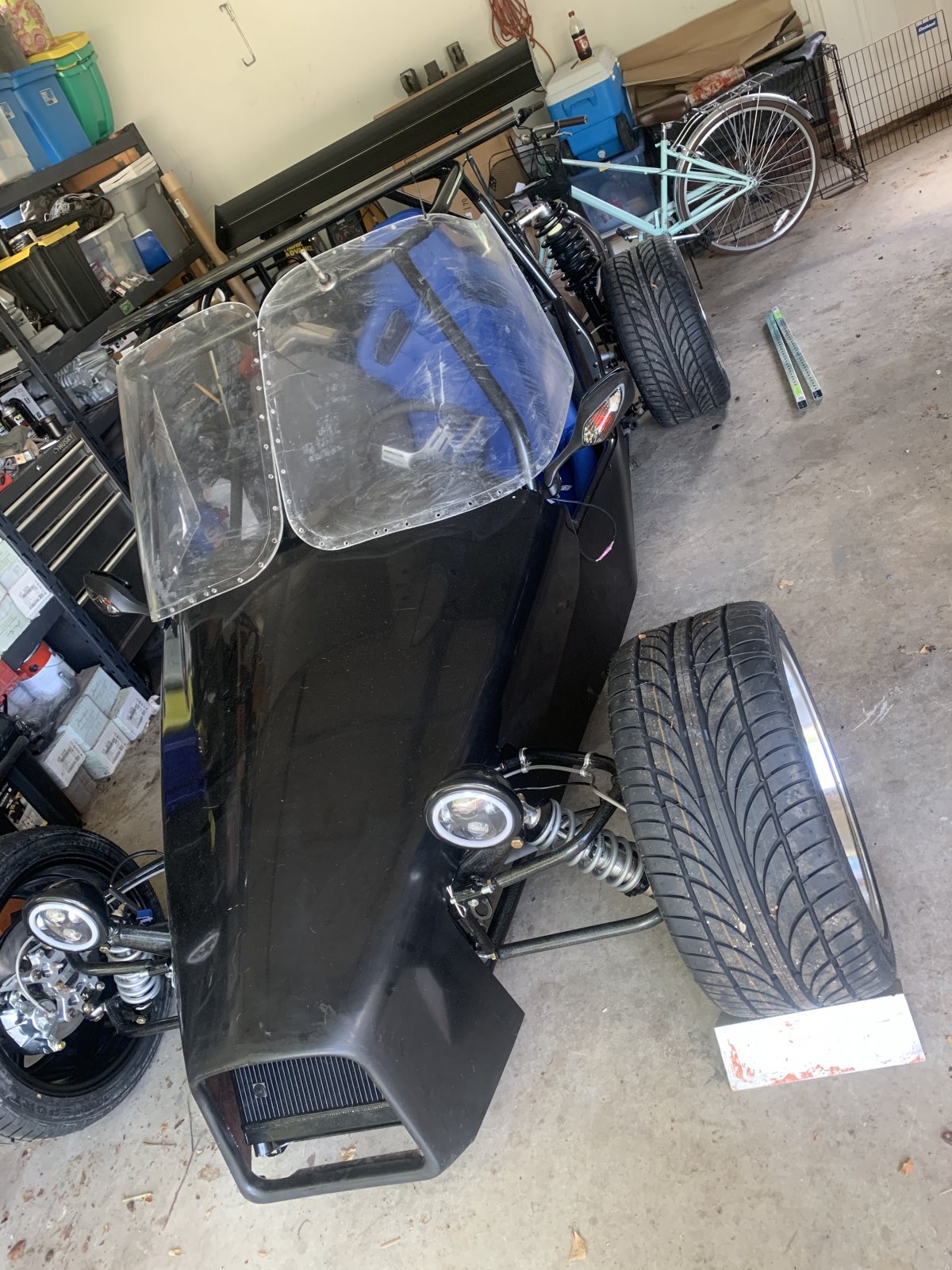

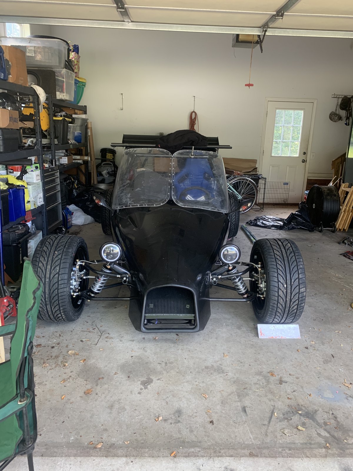

Working on a windshield idea gotta trim where it meets the hood and the sides

I notice the air temp probe sticking through the plexiglass. Assume you will be modding up a centerline bar? This will be very interesting to see how it turns out. :)
yup gotta make a lower bracket the shape of the hood which is gonna be very time consuming the windows are 5/16” thick

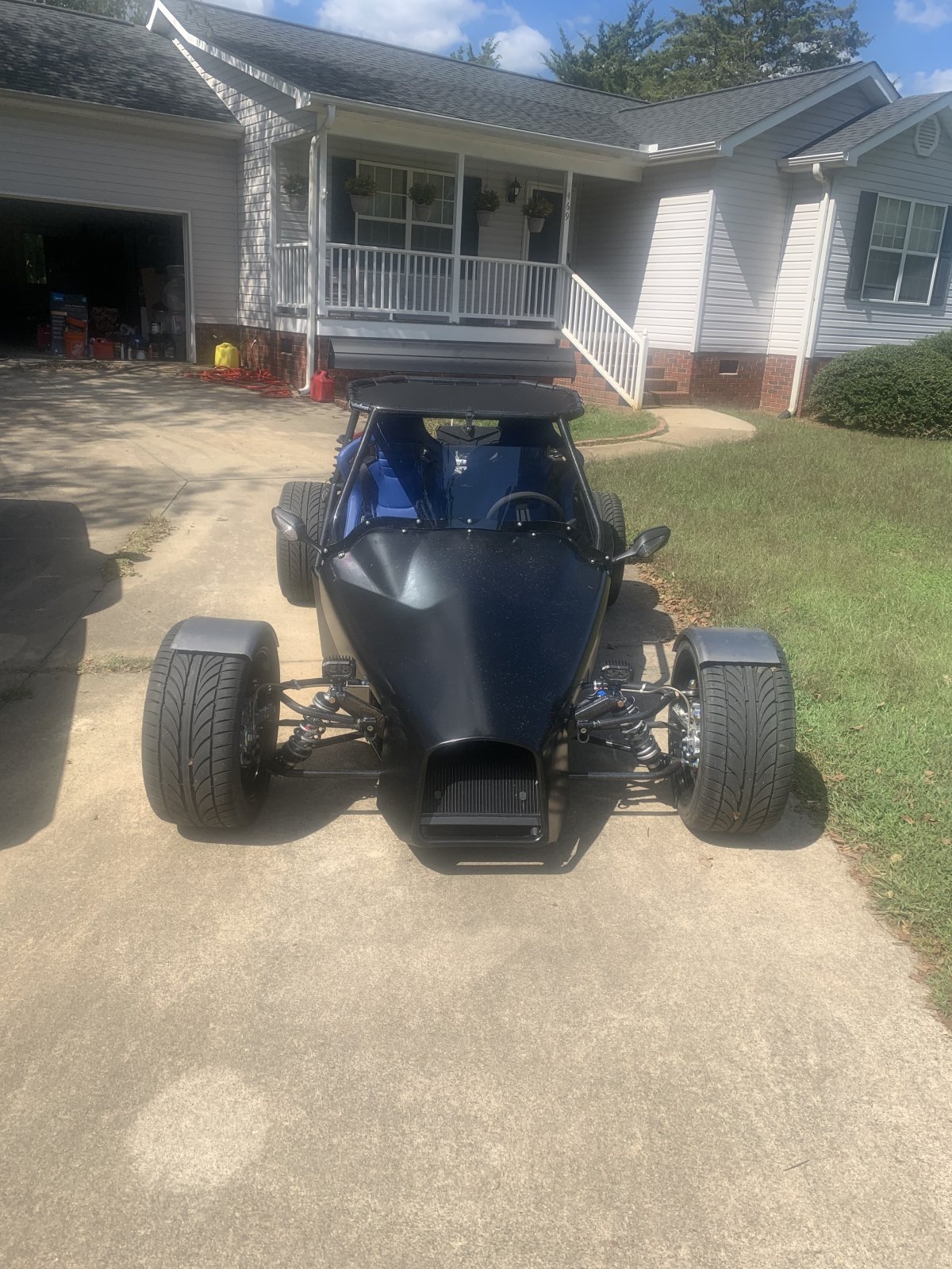

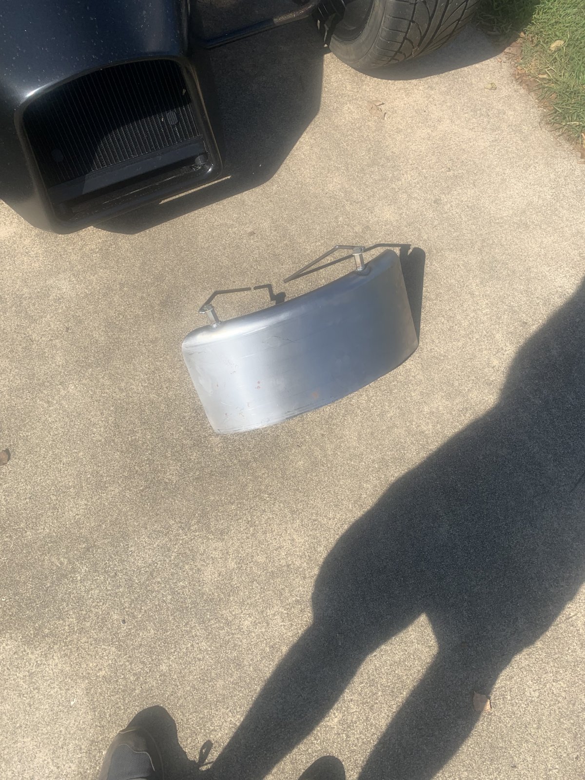

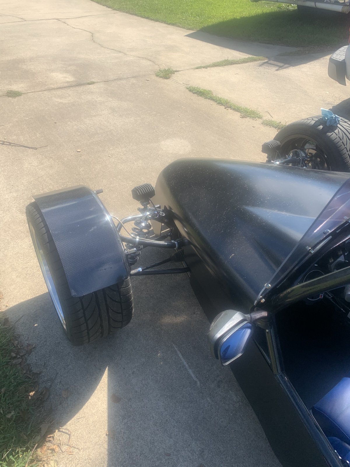

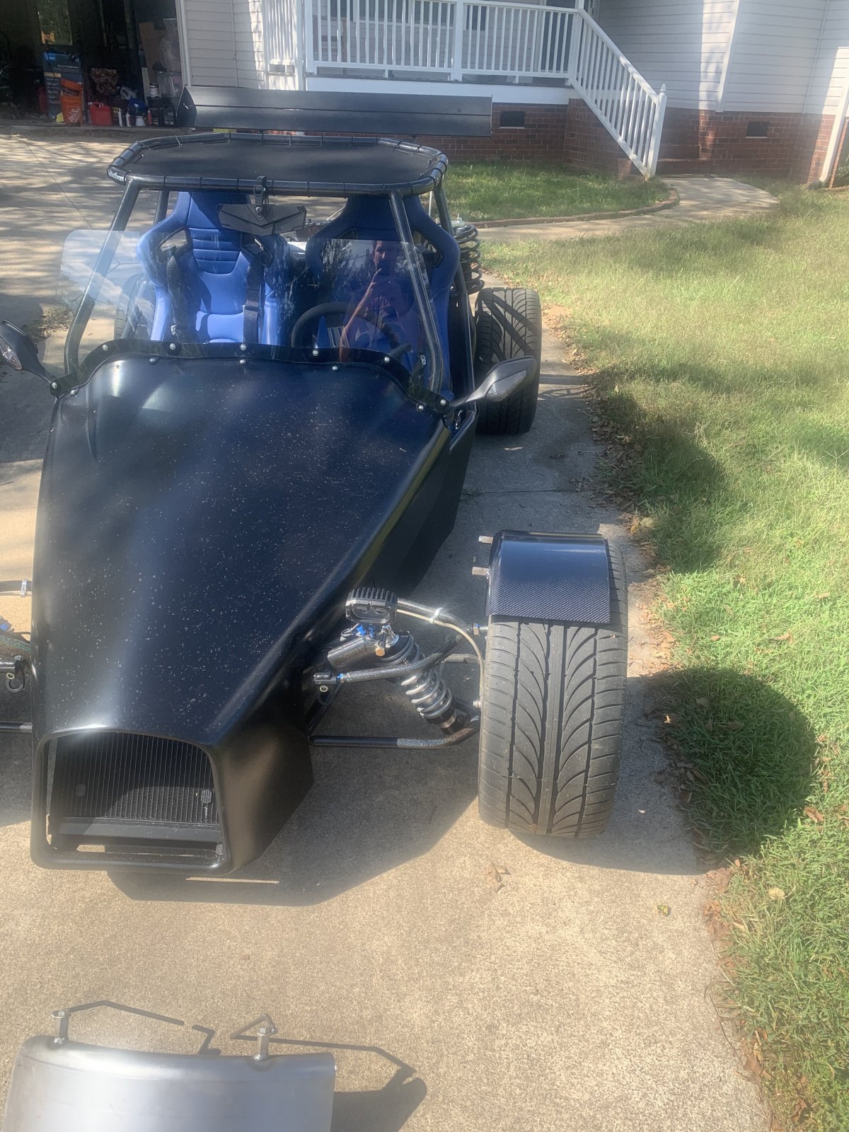

Making fenders for the goblin today

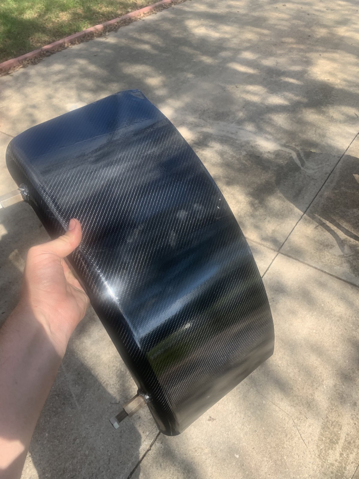

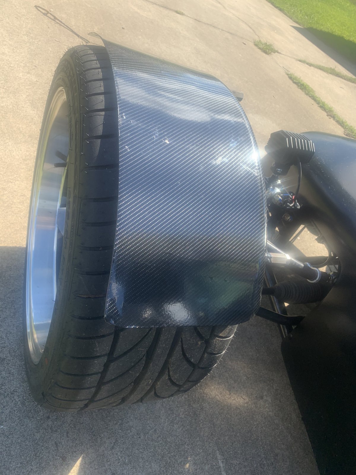

Wrapped in 5d carbon fiber vinyl

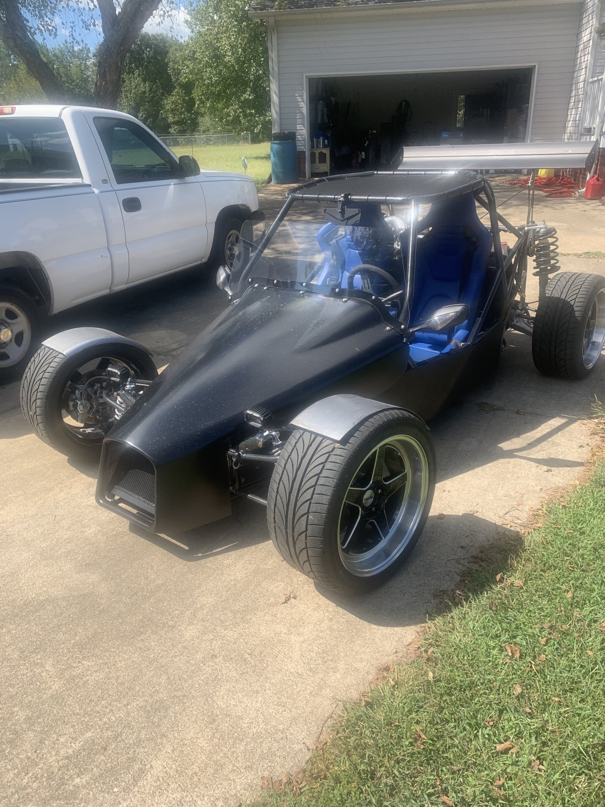

I’ve been so busy lately and haven’t had much time to do anything on it so this is what I decided to do today and also installed the sunbrella top

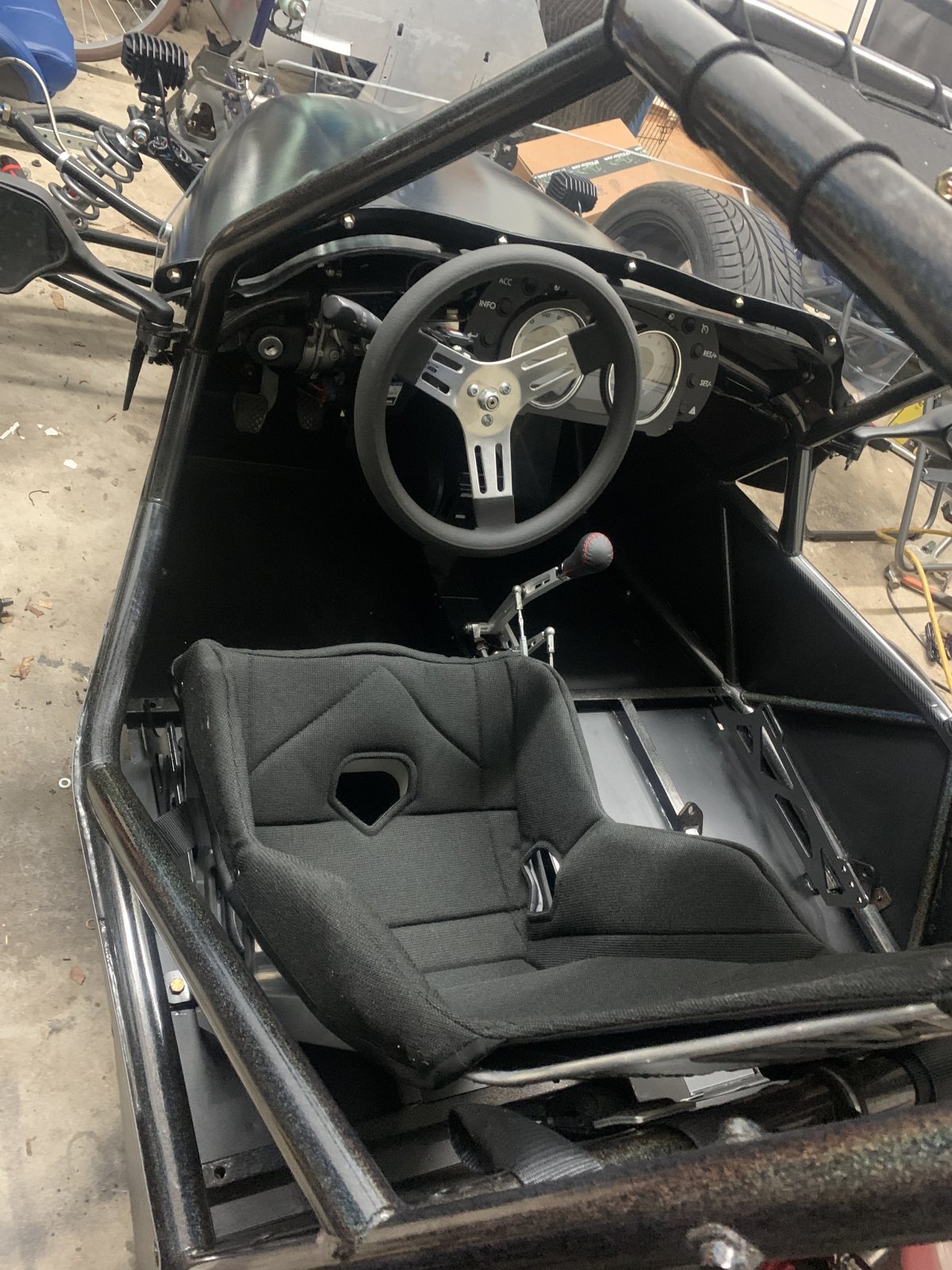

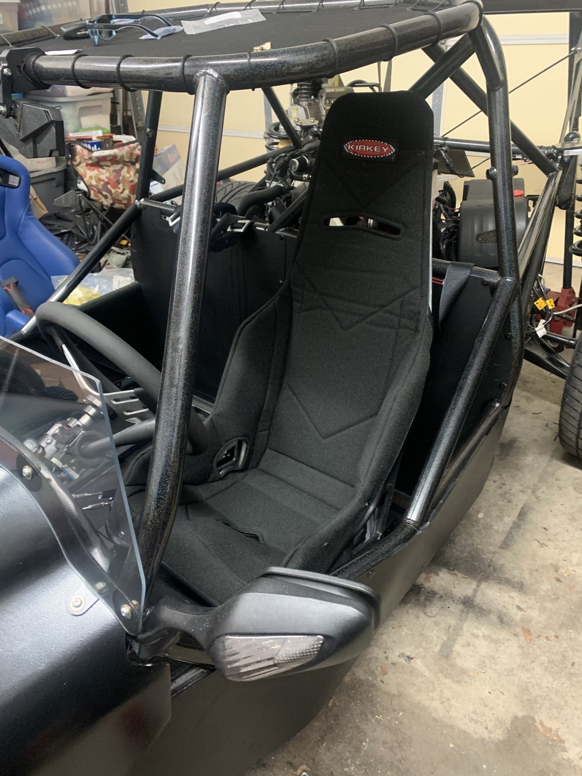

im also installing kirkey 55 series seats and the new shifter but the cables are sooooo long because it is the standard frame and I think the shifter is made for the extended Frame I think…. Any thoughts on how to secure the cables up away from the ground

The only thing on the shifter that's frame length dependent is the tunnel cap, as far as I know. I can't speculate on cable length because I've not installed my new shifter yet but I could imagine the front mounting point is moved backwards?
