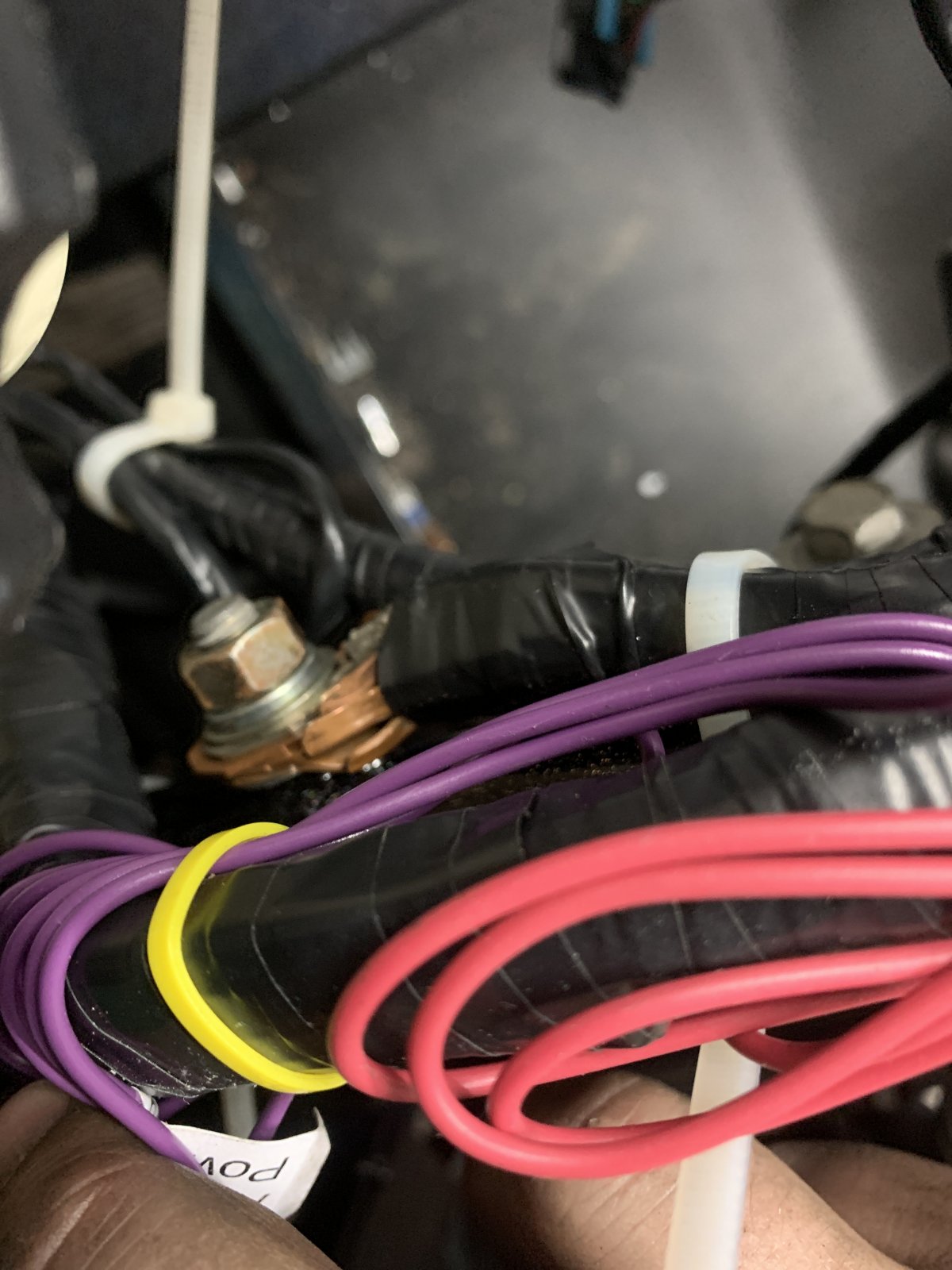

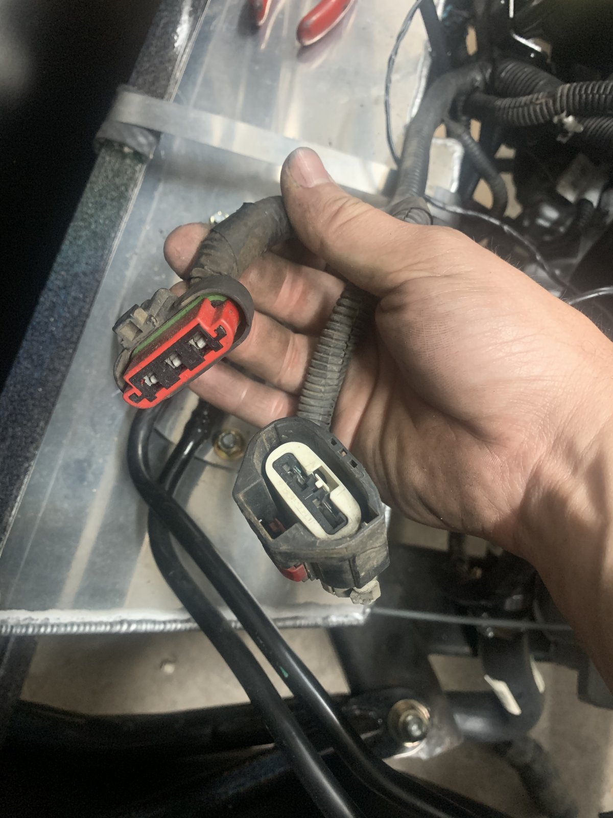

There are 2 plugs on the power steering. I forgot to plug one in on my first start. Got nothin. Plugged it in and it fired right upOk I also have a “power steering “ message on the cluster , but there is 3 8 pin connectors that look exactly the same.... does anyone know what goes to what?
Those 3 connectors are easily mixed up. The "power steering" message is telling you that you are having communication issues on the GM high speed LAN. I have had these issues. If you turn the key on, and jump the starter motor (Purple wire, below), will your car start? Mine does when the LAN is not working.Ok I also have a “power steering “ message on the cluster , but there is 3 8 pin connectors that look exactly the same.... does anyone know what goes to what?
The starter motor uses a purple wire on the solenoid... that can be hot-wired to crank the starter motor.What are some people talking about a purple wire?
there is a pink wire bundle right by the rear brake line T. And a purple accessory wire by the fuse box by the engine, but other than that I have no idea
