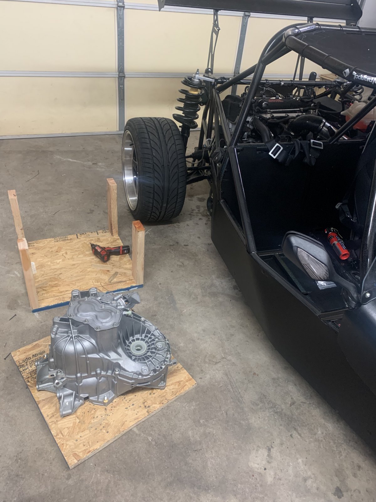

the new transmission arrived:) a much needed replacement.
thank you dfkitcar team
