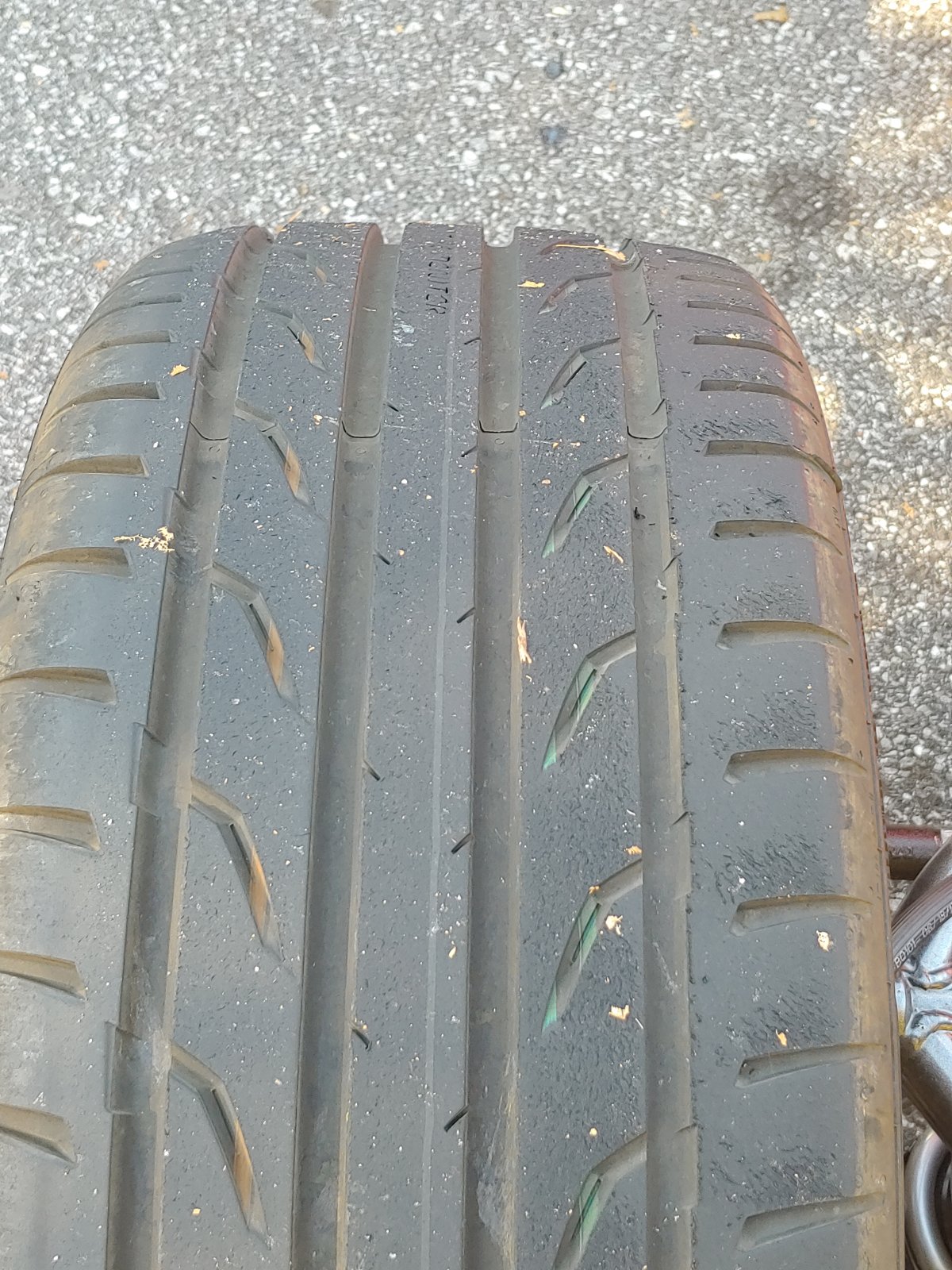

    3. I've been getting good wear on the rear tires. The fronts are the ones that are getting heavily worn on the inner half (see picture below). I haven't swapped front/rear just so I can keep track of the wear easier.

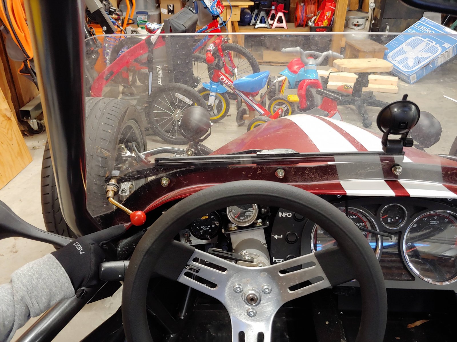

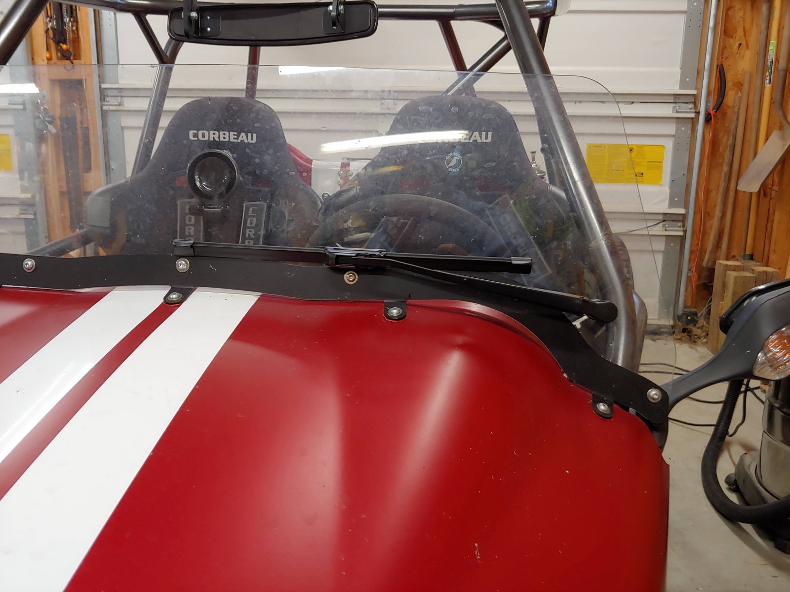

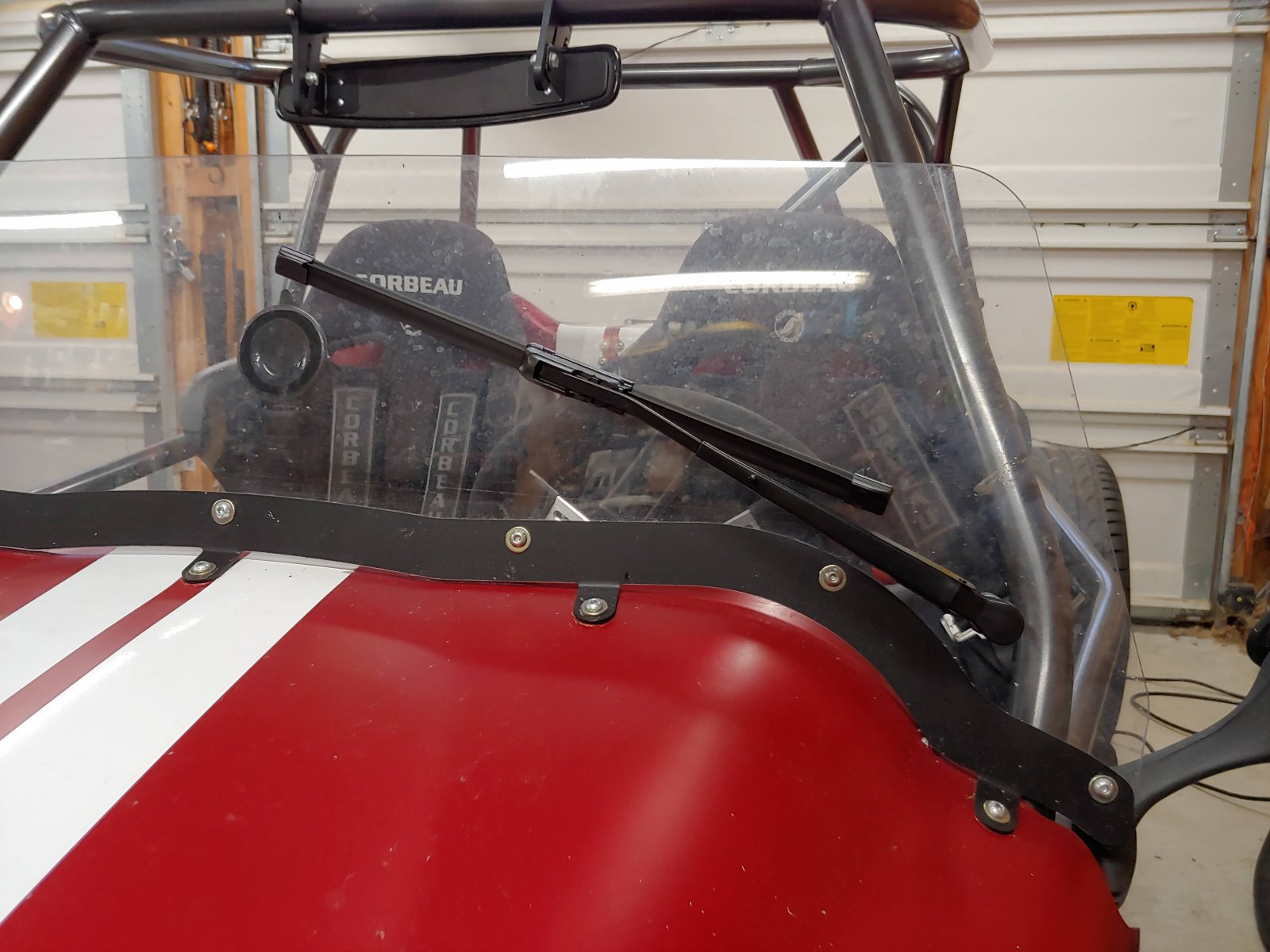

I finally gave in and decided to just install a wiper blade on the windshield. This should mean that every portion of the car is street legal in NC (if they ever want to finish my title). I had been planning on removing the windshield during yearly inspections but found a cheap manual wiper option from UTVs: https://www.amazon.com/Xislet-Operated-Windshield-Kawasaki-Instruction/dp/B07C1BZTVJ. I don't know if it's going to chatter while driving, if so then I'll just have the wiper on when needed but it has a strong enough spring it seems like it won't.
In NC you don't have to have a wiper, if you don't have a windshield but if an officer sees our partial wind deflector and calls it a windshield then it's required. The good thing is the requirements to be a 'wiper' are pretty relaxed. I talked with a neighbor who is a local Toyota dealer mechanic and he said it could be a stick and it would pass when he does an inspection. Granted he came from NY and inspections there have to catch more rust issues and are in general far more stringent than in NC. Other Goblins have dealt with how stringent the NY process is.
Disregard the dirty windshield, I just haven't gotten around to cleaning it recently. Because I mounted it low and beside the windshield bracket, it really isn't too noticeable. Yes, if I rotate the thing it will go off the plastic, I don't think that's an issue since I expect it to never be used. When I drove back from the mountains through light-heavy rain on the interstate I wouldn't have used it anyways. I have the plastic version of Rain-X on my windshield: https://www.amazon.com/Rain-X-620036-Plastic-Treatment-fl/dp/B00T9LR2BQ.

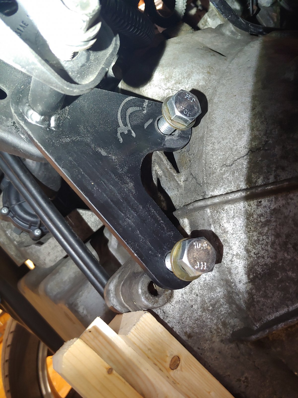

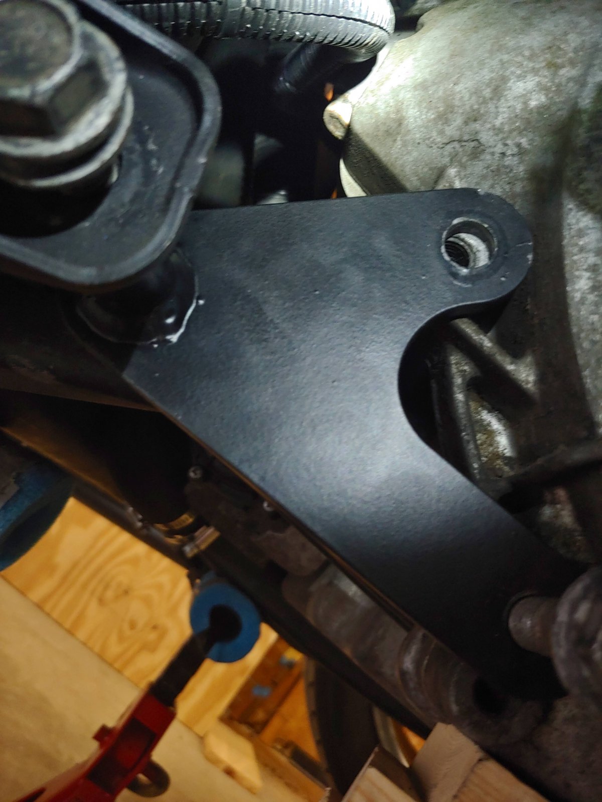

  • I got the front and rear transmission mounts installed. The rear one went very smoothly, the front one took some adjustment to get to fit, details below.

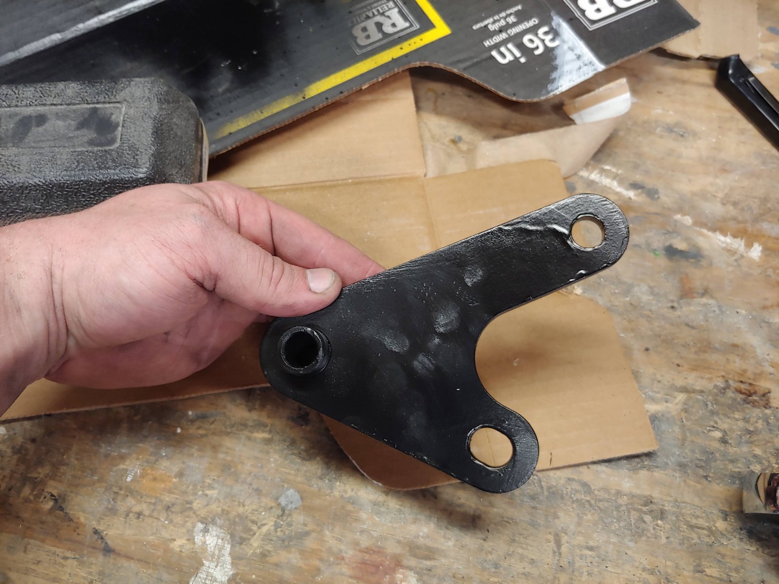

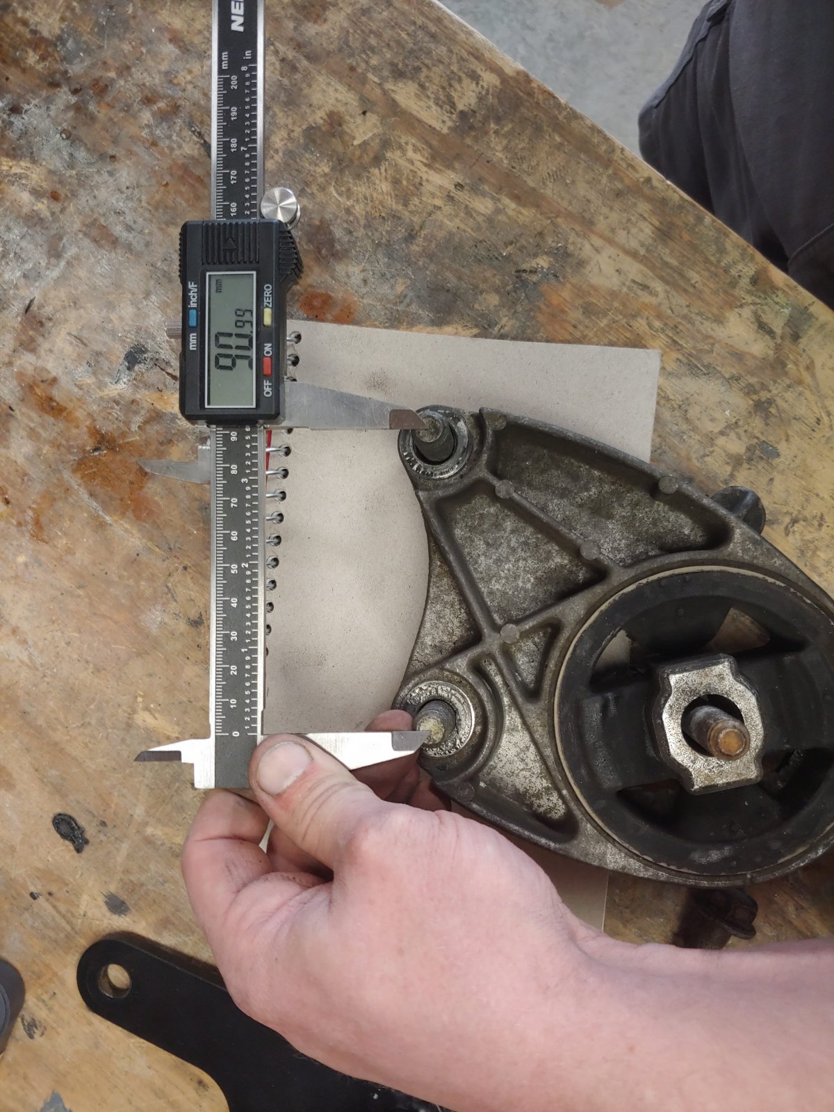

For the front transmission mount, the stock ones must've been held in by some corrosion, the 2 bolts to the transmission were extremely tight. I couldn't get them to budge with my air impact wrench, the same tool I took the axle nuts off with. I had to use my breaker pipe on my socket to get a 20"+ lever arm to get them to loosen. However when I tried to insert the new bracket, there was no possibility of all 3 bolts going in without something being modified. I could insert the 2 transmission side bolts but the subframe bolt was misaligned by this much:
21563

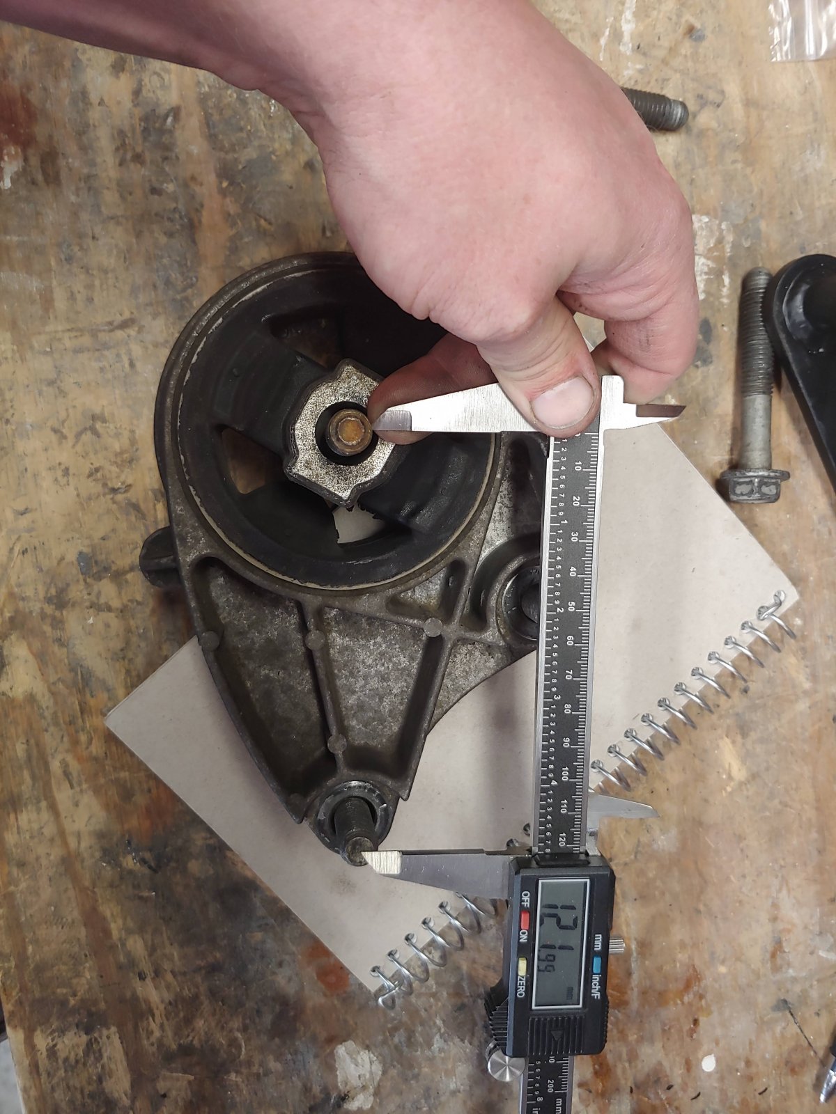

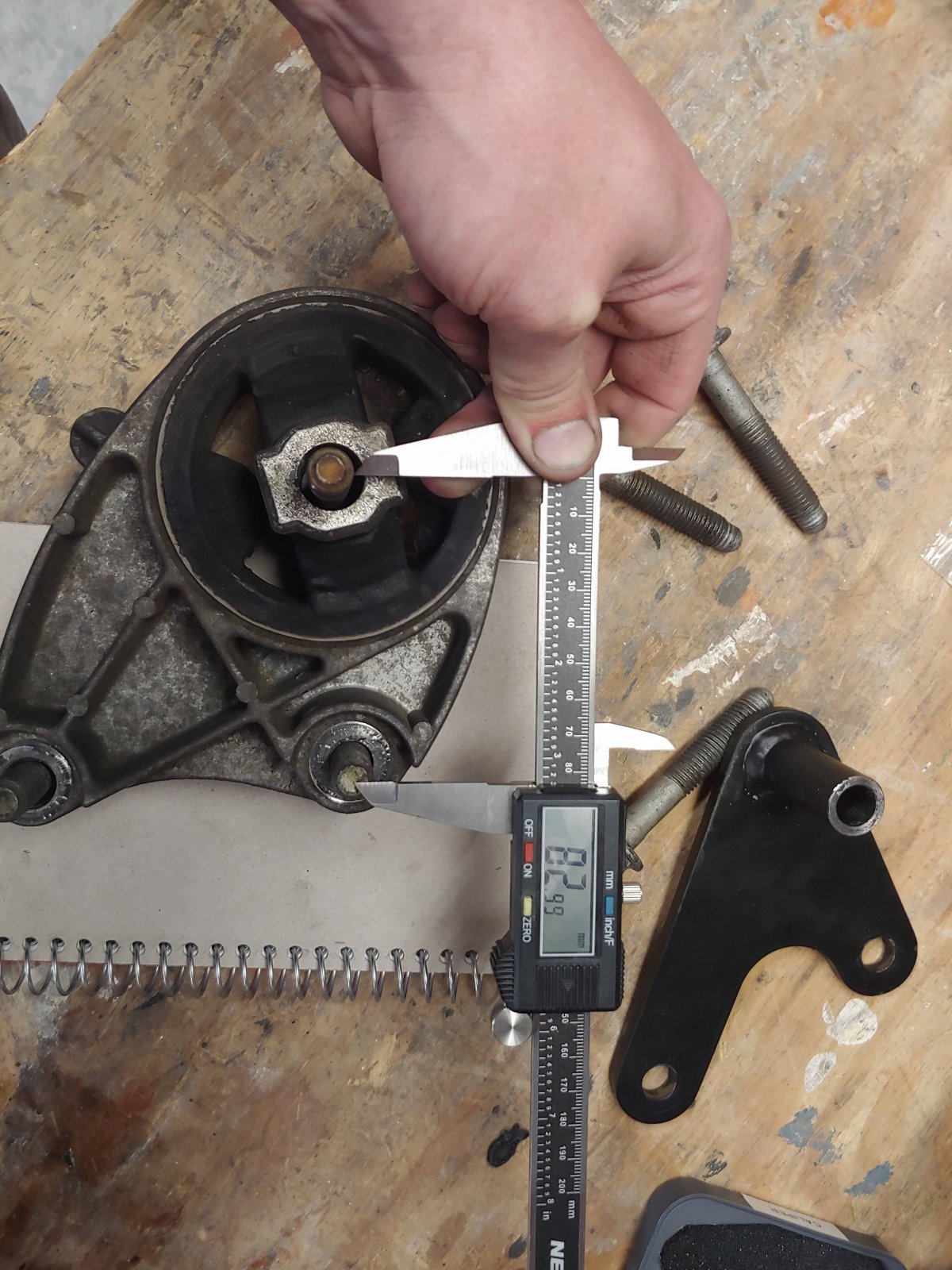

There is no play in the engine mounting that could shift it that much, I was jacking the engine high enough the whole car was lifting off the stands so I looked into the dimensions and here's what I found.

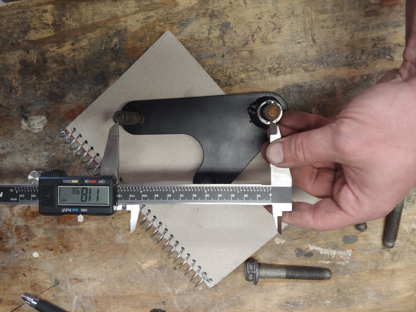

A - Stock mount: bolt center distance, subframe to upper transmission point: 83mm

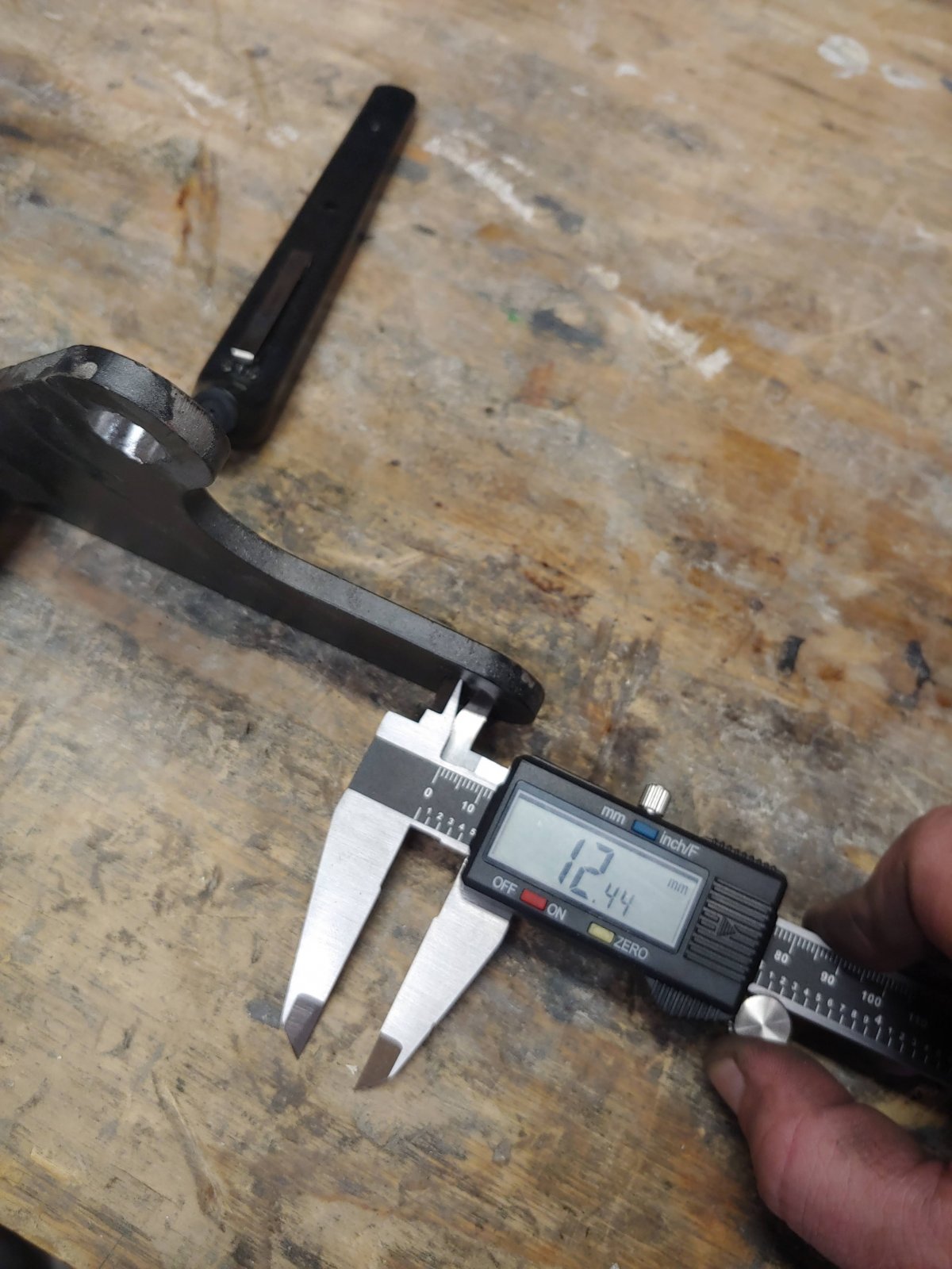

21564
B - Stock mount: bolt center distance, subframe to lower transmission point: 122mm

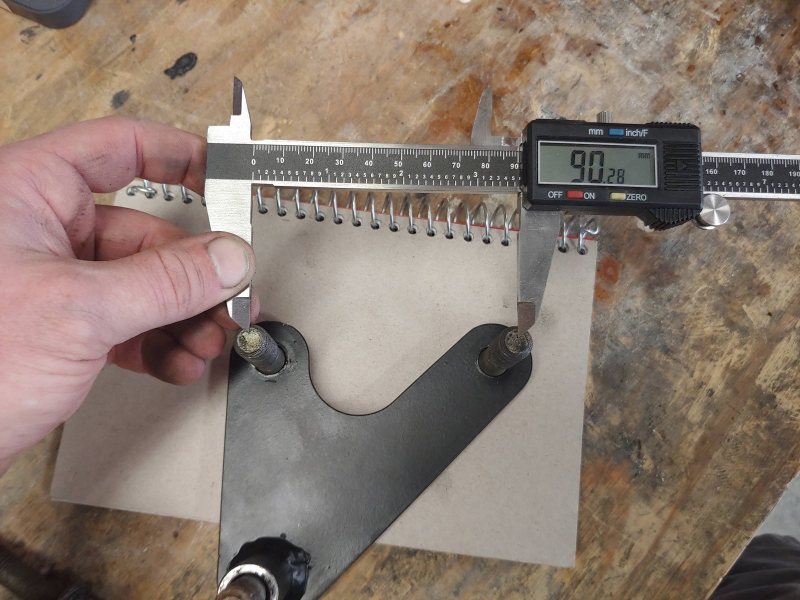

21565
C - Stock mount: bolt center distance, upper transmission point to lower transmission point: 91mm
21566
The stock mount has 3 different diameter bolt holes, upper transmission is a fairly tight fit, lower transmission is a fairly loose fit, subframe is an extremely loose fit.

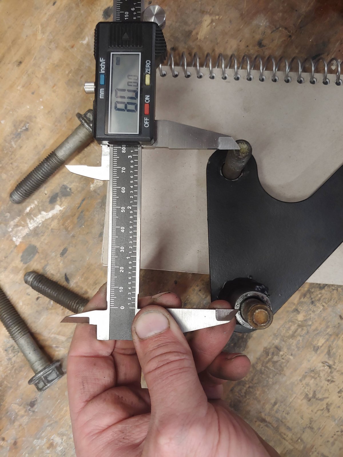

Next I measured the new bracket, same points:
A - New mount: bolt center distance, subframe to upper transmission point: 80mm

B - New mount: bolt center distance, subframe to lower transmission point: 119mm
21568
C - New mount: bolt center distance, upper transmission point to lower transmission point: 90.3mm
21569

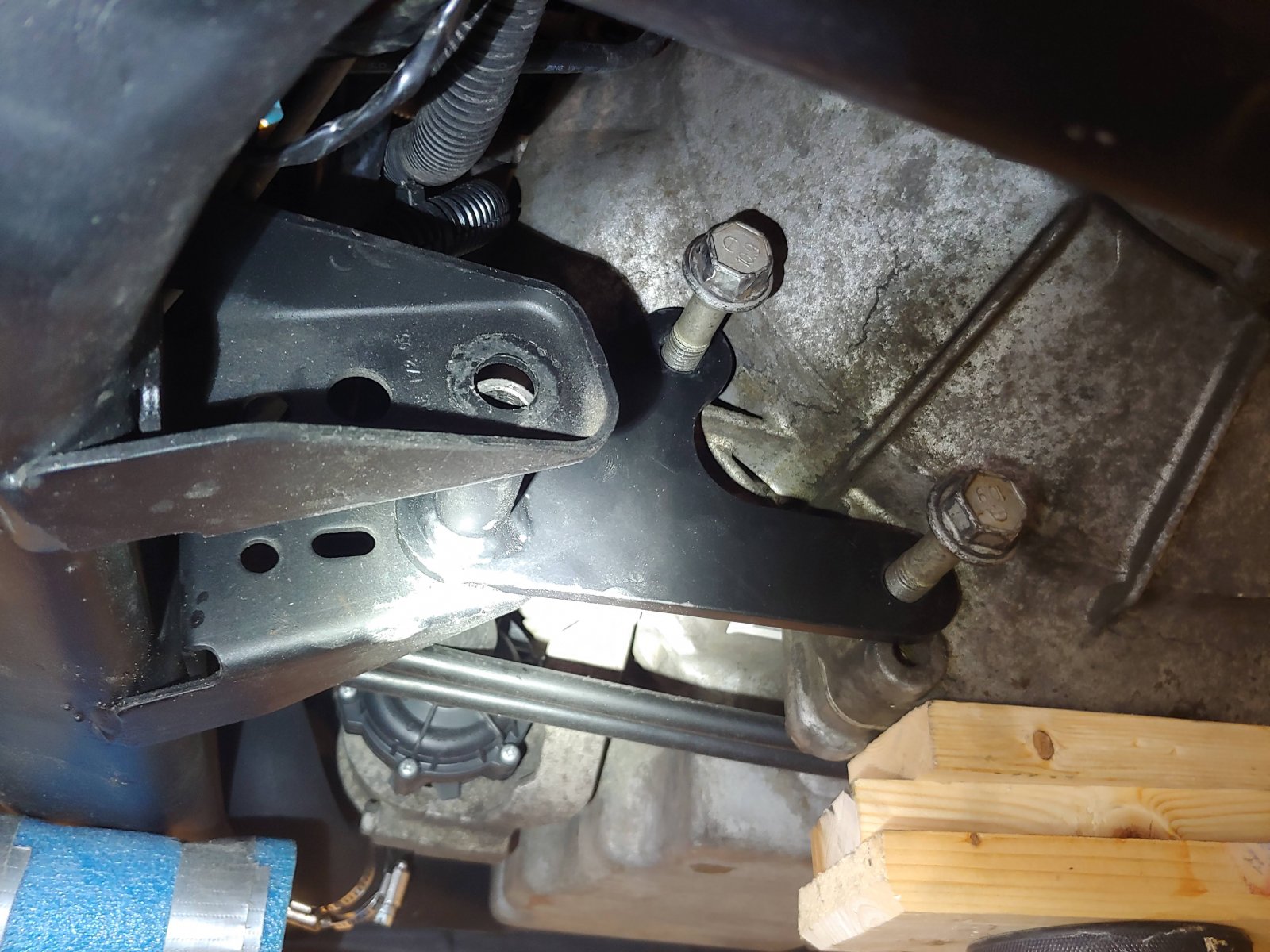

Given how the new transmission mount is designed, there's no way to move the subframe bolt point and I don't want to touch bending the subframe mounts to move them to match. I could insert bolts in only 2 places max, either sets for B or C dimensions above, but the C set of holes didn't give a solution. The good thing is using bolt holes for B meant that I could adjust the upper transmission point hole, check out the misalignment I had to fix here:
21570

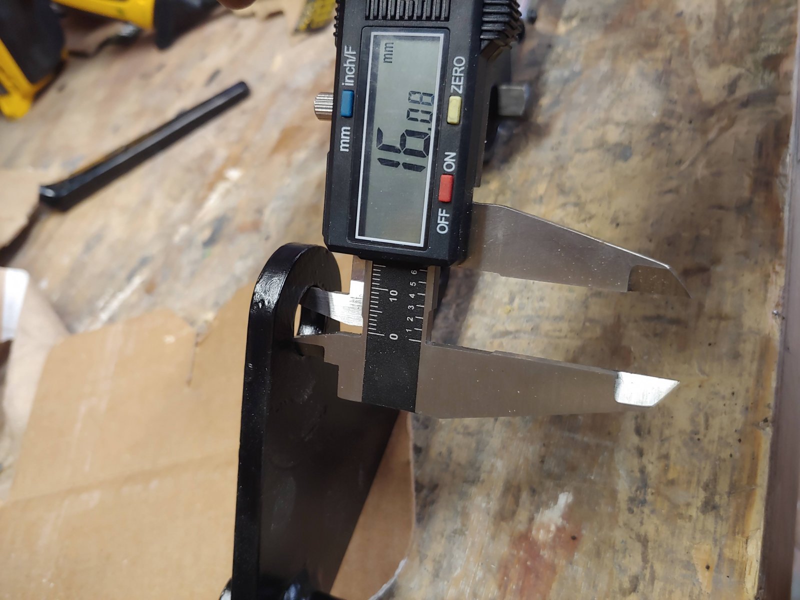

I know it's always better to have all bolt holes be tight fit, but the solution I used is to slot out the upper bracket hole. I see no strength issues with this fix. Holes were originally around 12.5mm, I'm guessing 1/2" punch or laser size before I painted.
21571
I slotted the top hole with a dremel to keep the same minor diameter but add a ~16mm major diameter to get opening to overlap the bolt hole on the transmission seen above.
21572
21573
End result with the slot, bracket fit in place. After the following picture, I pulled the bracket out to repaint it before final installation.
21574
I don't know if the front transmission mount dimensions changed slightly through the years or why the DF version was different for the triangle leg lengths but I got it to work with the slot I added. To use the mount without adjustment, I would've needed to tip the front of the engine higher; this is not possible since the side engine mounts fix the angle and on all side bolt points there is no upward tip option. The only possibility of moving the engine would be slightly front to rear sliding on the side engine mounts. Rear mount was loose during the front install, I torqued all the mount bolts down at the end and had no issues or binding.

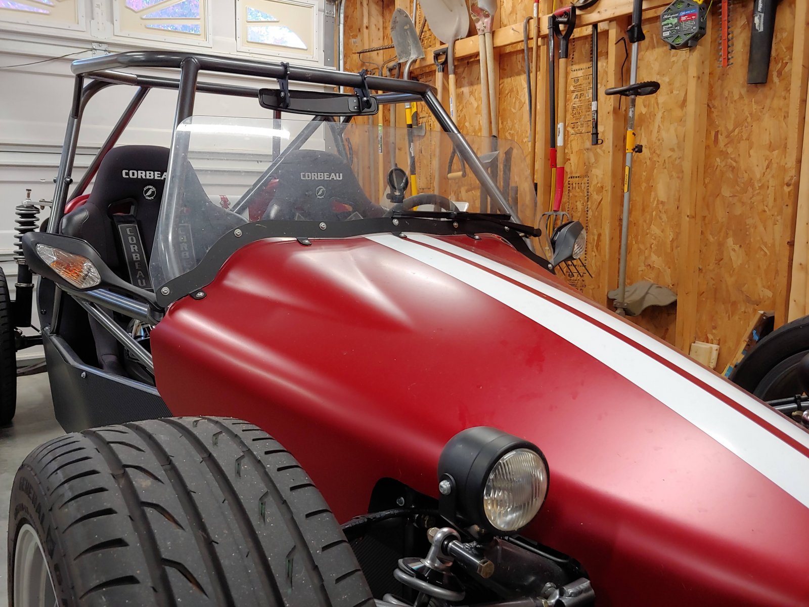

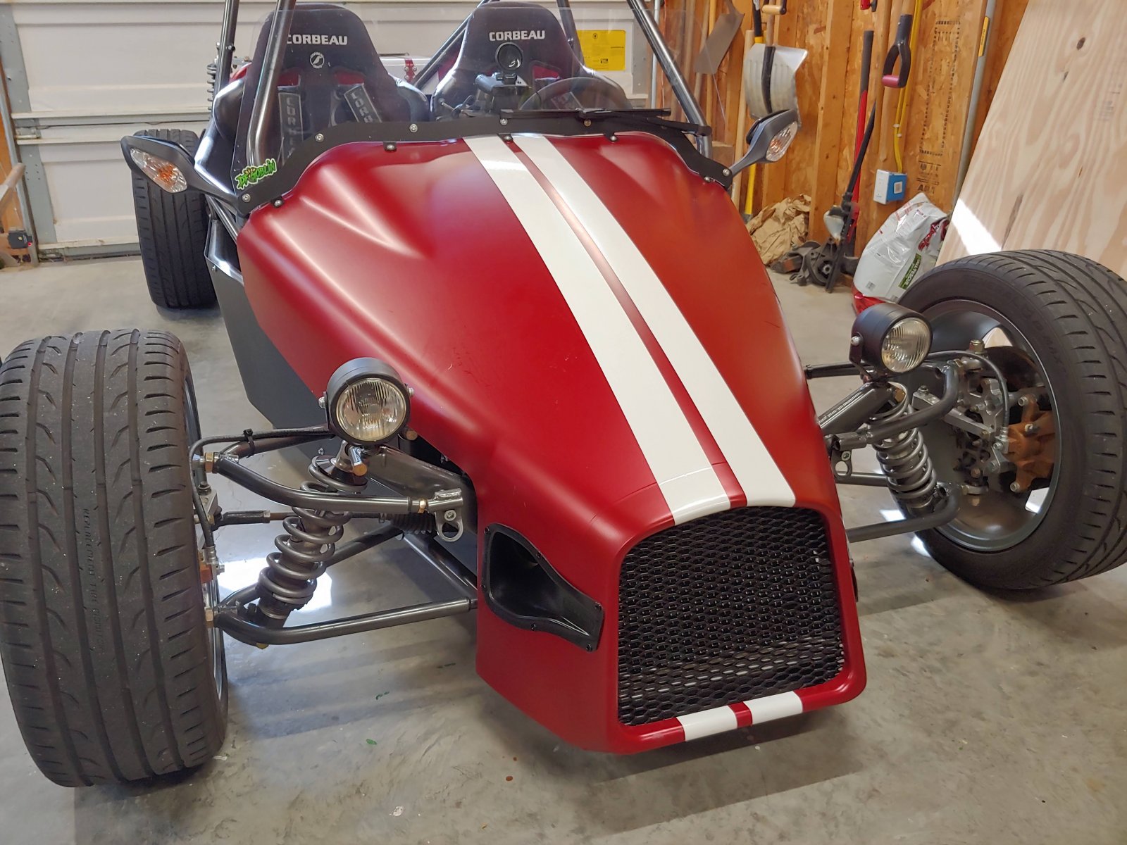

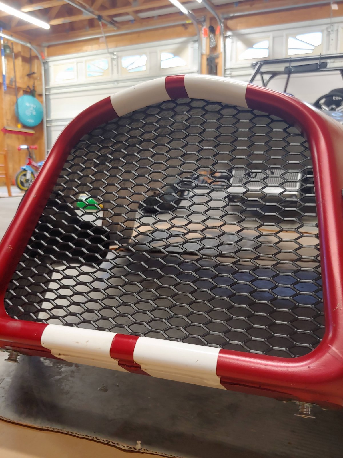

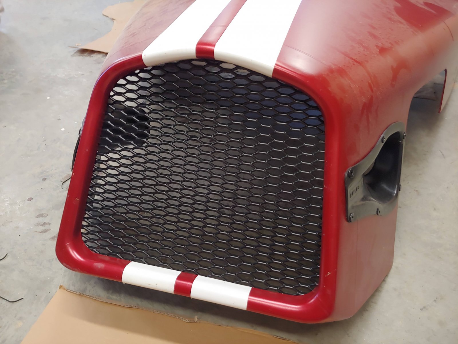

Small update , I added a grill to the hood. I epoxied some washers into the U at the front of the hood and used zip ties to hold the grill plastic to the front like I think I've read some others did. I went overboard and added a bunch of washers but didn't have to use them all (but I did use most of them). So far after a couple drives the grill is doing good. In my case the grill is in contact with the radiator at the bottom edge since there is so little room to the hood nose from the radiator but it's not a problem, just more strength.
23516
23518
jennam
That looks really good. I need to do something like that on mine.
