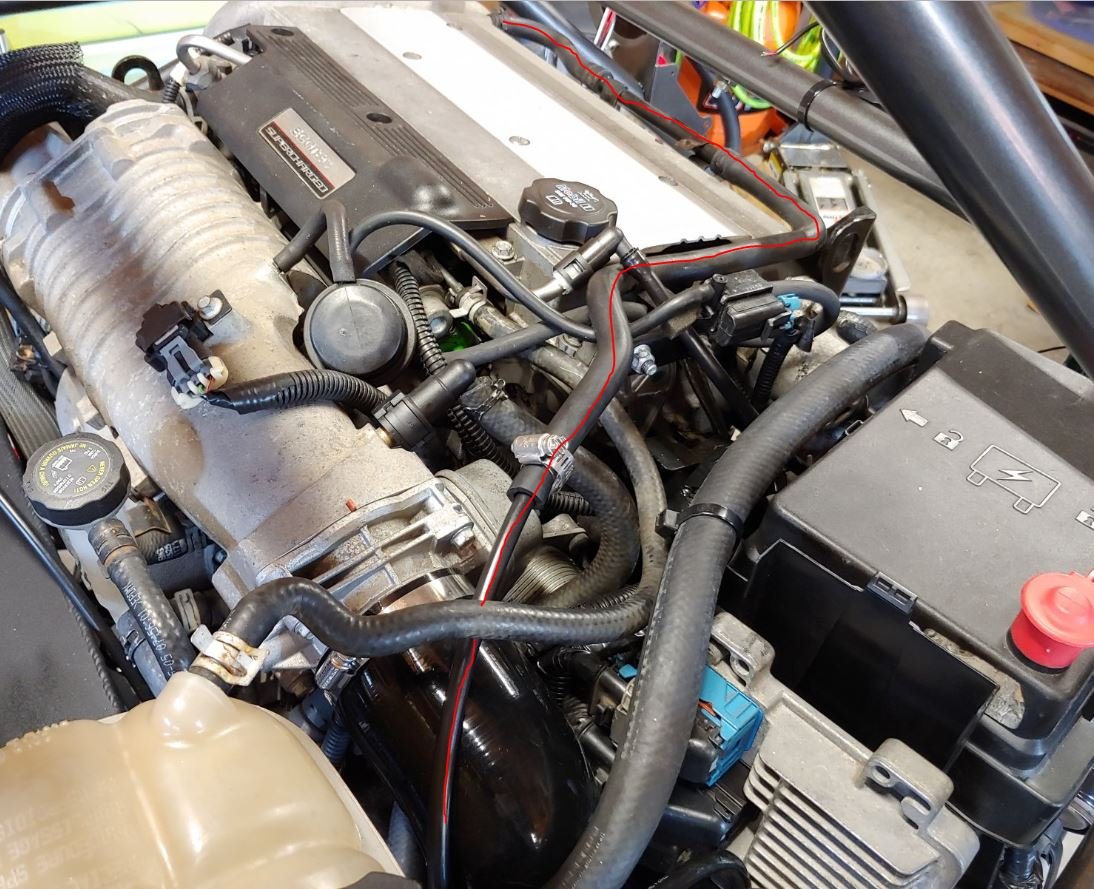

I've got a smoke generator setup now, just need to figure out where/how to best use it. I hooked it up to the line normally going to the crankcase vent valve (at the hose clamp point in the picture below, leaving the hose to the valve cover laying loose) and didn't have any smoke leaking out until I could see it coming out of the air filter. I think I what I need to do is pull the air filter off, put a glove over the inlet pipe where the air filter normally goes, take my hood off and then check everywhere.
15082
Hopefully I'll have some pictures tomorrow of the smoke test setup I made. I hope my misfire issue is as simple as a leak on the intake path.

I think I show the setup of the smoke machine I made in this video. Unfortunately, I didn't find any leaks, so I think I need to check for other reasons for my misfire.
