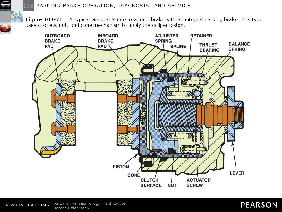

The solstice parking brakes self adjust every time you pull the parking brake lever.
The way it works is by unscrewing a threaded shaft out of the piston every time you apply the parking brake.
Under normal operation, it unscrews until it takes most of the pad to rotor clearance out.
In your case, the piston that pushes against the brake pad is threaded onto the parking brake plunger to tight.
This is not allowing it to unscrew.
You may be able to push and hold the brake pedal and at the same time pull the parking brake really hard to get it to start moving.
Once it starts unscrewing you will need to let off the brake pedal and start repeatedly applying the parking brake until it self adjusts.
With this style of parking brake caliper, if you ever need to put new brake pads you can't push the piston back in.
You will have to put a spanner wrench into the two holes on the piston and spin the piston back down on the threads to give the pads enough clearance to fit back in.

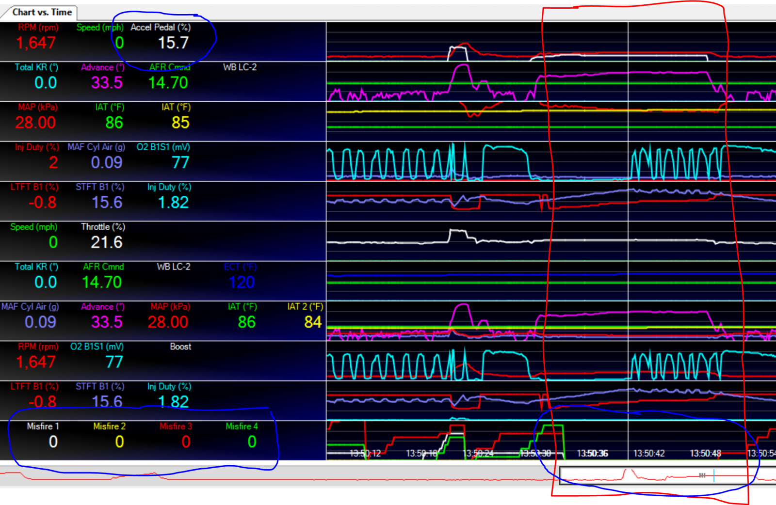

Screen grab from the attached VCM Scanner file. This was a cold start +5 minutes, occasional throttle at varying %.
14633
Any thoughts on where I should focus? I can grab specific data from HP Tuners but I'm completely new to the software, any pointers would be good. I'm sure I've missed something, I'm trying to write things down to reference later, or if someone more knowledgeable has suggestions.

It won’t show misfire off of idle. It may still have a misfire, but it is not “counted” via scan tool.
Since all 4 cylinders are misfiring, you’ll need to concentrate somewhere that controls all cylinders. I would start with a vacuum leak. Basically you have the vac for the power brakes, PCV/air intake and intake gaskets (I think there’s one more). I would go to the basics and take some spray brake or carb cleaner, start the engine and spray around this areas. If the engine changes rpm up or down, you have a leak.
I wouldn’t rule out cam timing and such, but start with the basics.
you also mentioned gaping the spark plugs. Platinum and uranium Plugs don't require gaping as you can damage the surface areas.

Un plug the MAF and run it see if that helps. I had one in my car give me fits. It was just dumb luck to un plug it while it was idling on 3 cyl. It cleared right up.

Which fuel trim are you meaning? It looks like there are short term and long term. This video also has the O2 voltage reports. I'm not sure what these values should be, let me know if something sticks out here. This is a couple sections of the 5 minute scanner file being played back so anyone can view it the same way I see it.
I'll have to check with the MAF unplugged. It's not running bad, the misfire at idle is not that significant to me, it does surge occasionally but overall it just sounds like a performance engine setup. Maybe mine is just barely not working right instead of as bad as some others have seen.
Looks like the engine was cold, which will give you awkward readings. Plus, when you hit the gas, you change peramiters, so it’s somewhat hard to tell. But, it didn’t have many current misfires, just history misfires.
Could you tell it was misfiring in that video?
fuel trim looked fine, to a tad rich, but nothing really stood out. I’ll watch it a few more times this evening, when I get in for the night.

O2 should be bouncing up and down all the time. 0 is lean to 999 rich. I would say “normal“ range at idle should be 400mv to 700 mv. You goose it on the road and you should stick at 999mv till you let off and/or it balances out.
STFT (short term fuel trim) is current “average“ of what you are seeing at the O2.
LTFT (long term fuel trim) is an average of what stft is doing. Gets real complicated how it gets its number, though.
fuel trim should be 0% + or - 24%.
- is lean
+ is rich
when you hit the gas at all, you change the ltft and stft “charts” and your reading will be all over The place. At idle is you best bet to diagnose most problems.

I've got a couple videos I'll be loading shortly but here's what I've seen today:
  • I ran the engine with the MAF plugged in, then restarted after unplugging, again plugged it in, and then unplugged. The first start after changing the connector (plugged/unplugged) was terrible but generally the 2nd start after the change was as expected.
  • When the MAF was plugged in, the current misfire count was increasing and resetting every 10 seconds (I think 10 second counts)
  • When the MAF was unplugged, it never registered a misfire on the counter while running.
  • The 2nd time I unplugged the MAF, it took 4 tries and managing the pedal/throttle to keep it idling. The 5th start was normal. I probably didn't cycle the key to off, just from on <-> start after it clunked out. the 5th start showed a couple current misfire counts but it didn't increase while running this time, seems like it was just a count of the clunking out. When I fully cycled the key and started again, the counter was at 0 and never increased.
  • The first couple starts the engine was warming up but it was into the 170+ range by the time I plugged the MAF back in and remained warm for the final unplugged tests.
  • The videos I took include some close ups near the exhaust to see if the misfire is audible, it's sure not significant to me but I don't really hear a difference between having the MAF plugged in or not.
Prior to the MAF checks, I ran the engine (with MAF plugged in), and checked around with a carb cleaner spray and tested a couple hoses and around the intake gasket area. There were no changes in the idle sound during these sprays.
I think this brings me to 2 questions:
  1. Does the current misfire counter work as I'll shown in the video when the MAF is unplugged and the engine is at idle? I know it didn't count with the MAF plugged in and giving it throttle so I'm wondering if I didn't actually find a result.
  2. If I can assume that the MAF being unplugged would still increase the counter, the MAF should be my problem. Is this likely cause the random misfire like I'm seeing? I can replace the MAF with a new one if it seems like the culprit here.
log files are attached, videos coming soon
I think you are running rich. The LTFT are near or sometimes maxed at -20% correction factor.
Do you have a wideband logging? I don't see one, but it would help.
